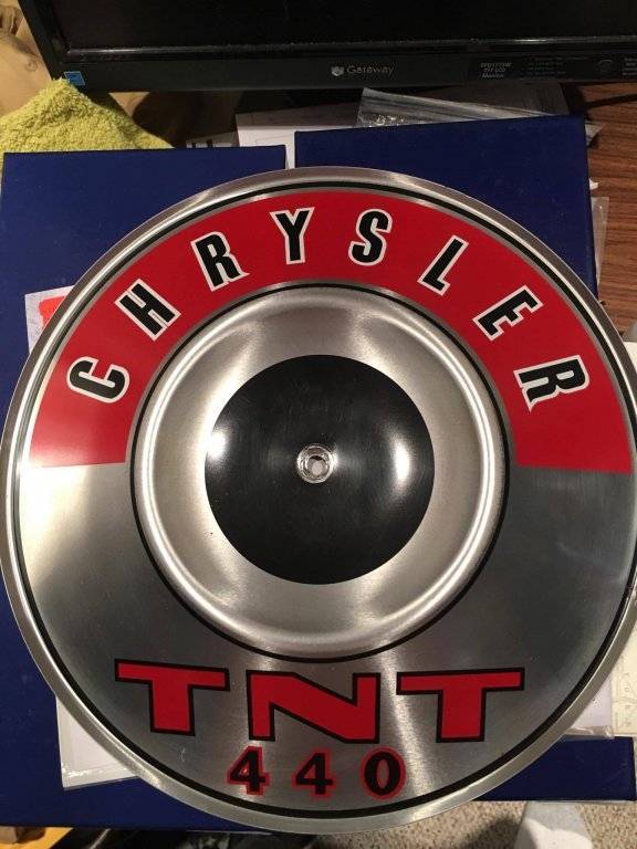

Coming soon to a Chrylser near me! What color should a '68 440 be? And, thinking I should have the tranny gone through.
Was also thinking I'd have the tranny gone through while the engines out. It is 48 yrs old and will have more stress from the 440. Anything recommended I have done to it during rebuild? Shift kit, new torque converter, or? I had thought about a lower first gear but can't find anyone with any real world experience having done that.
