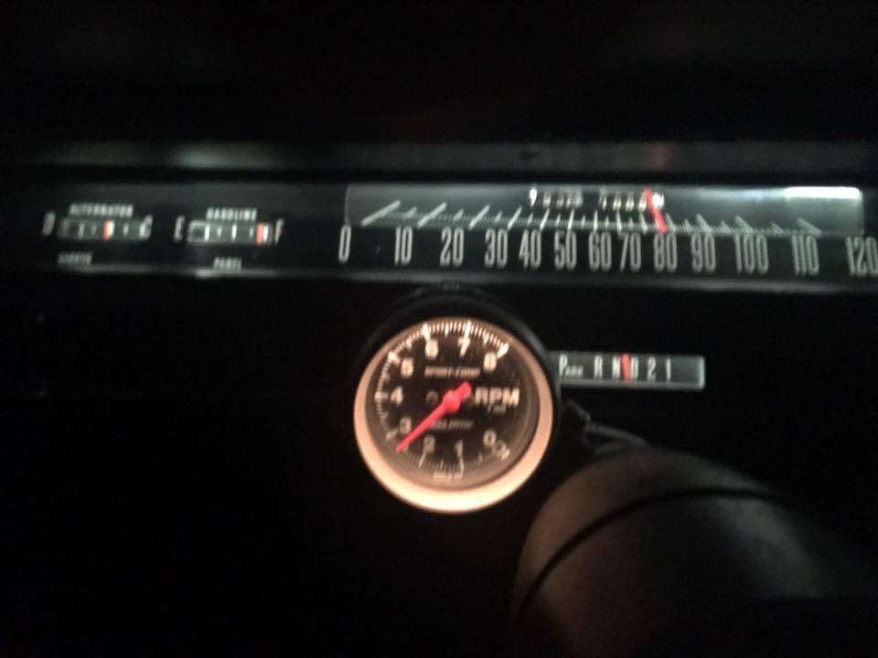

Not necessarily too small but not as big as your heads can use. That cam is pretty mellow in a 440. I would stroke the 383 or just design a package for it working around what you have. I like the tall rear gears, put a tach in the car and figure out what rpm you cruise the highway at and buy a stall converter a little smaller than that.
