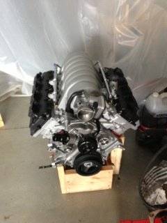

6.1 with 5.7 heads. That gives it 11.5:1 compression since the 5.7's have a small combustion chamber but still flow real well.
How many stages and how big of a shot of juice are you planning on?
