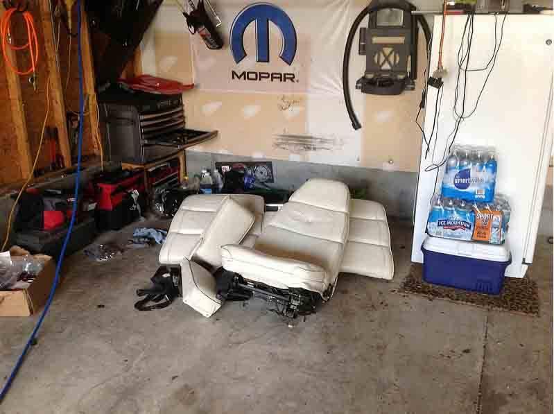

Well, I was beginning to think that it was just simply beyond my skill level but I think I got it. Holy **** I did it!
That's Polara71's interior on my garage floor. :icon_tongue:
