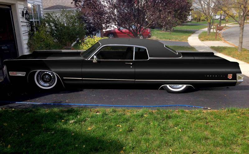

Its cool, but there seems to be one small problem......now what is it, what is it....OH yea. It sitting way too low.
