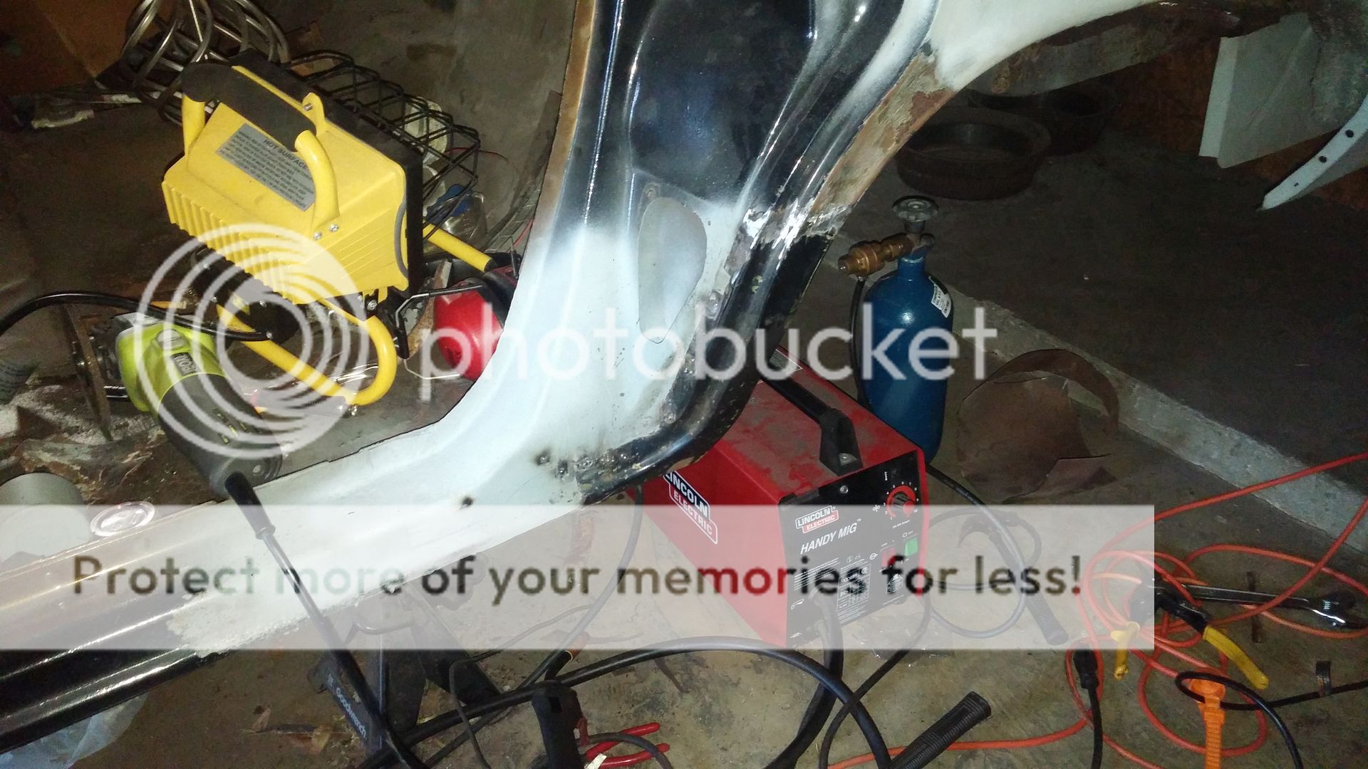

Good job maybe it will help get me moving on my body work, I'm past the welding, grinding on to blocking filling blocking filling blocking, blocking, blocking you get the idea. That is afancy work light you have.:poke:

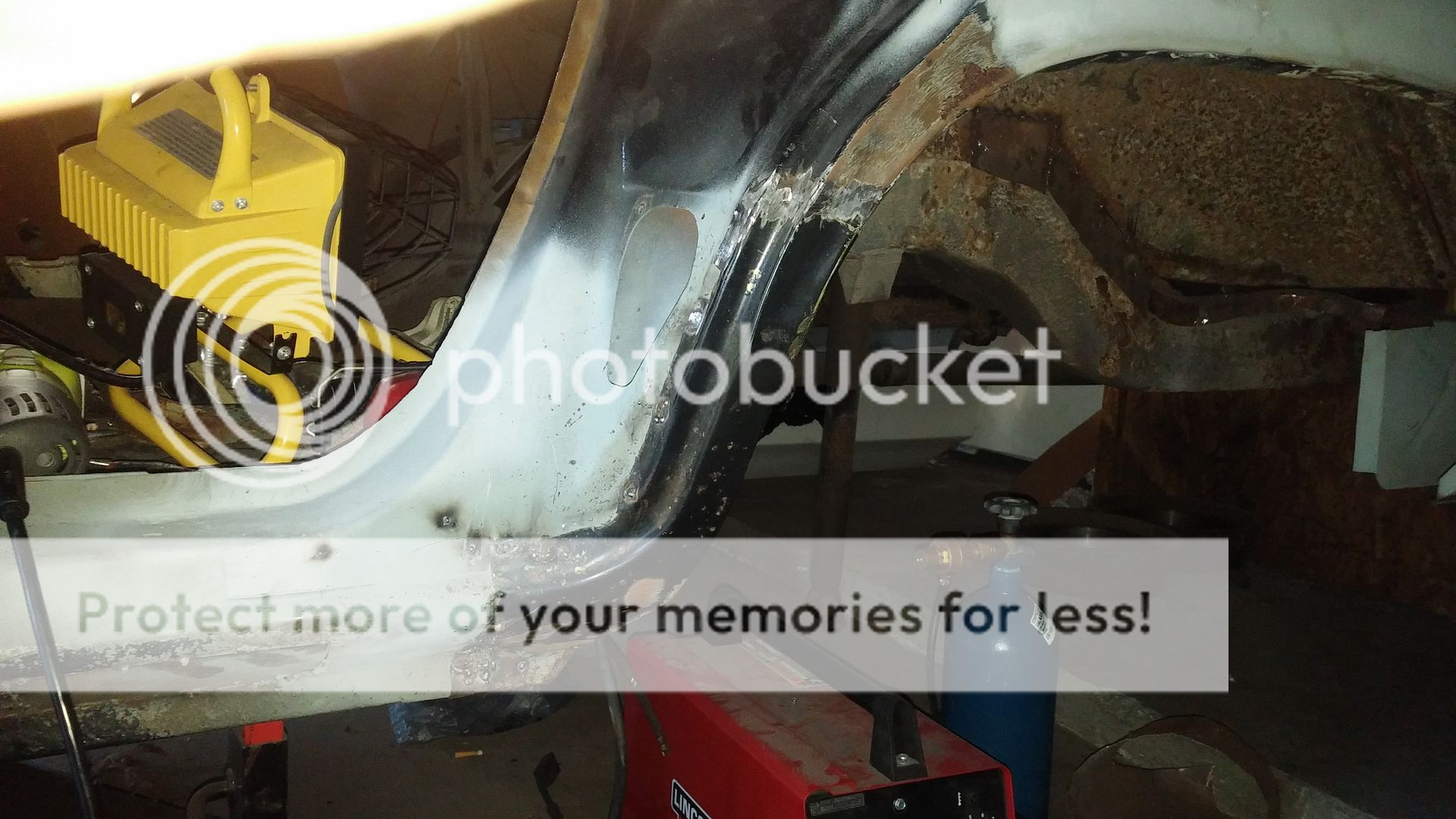

I'm just glad snap on was able to get it in for me :eek:ccasion14: . I picked up a proper light the other day.. Got tired of blowing bulbs from the weld splatter haha Though I'm sure I'll still use it.

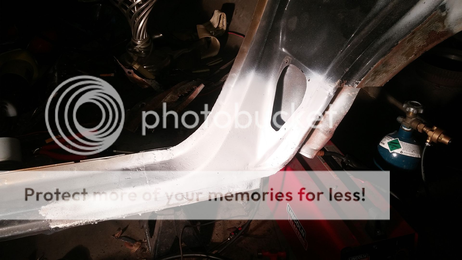

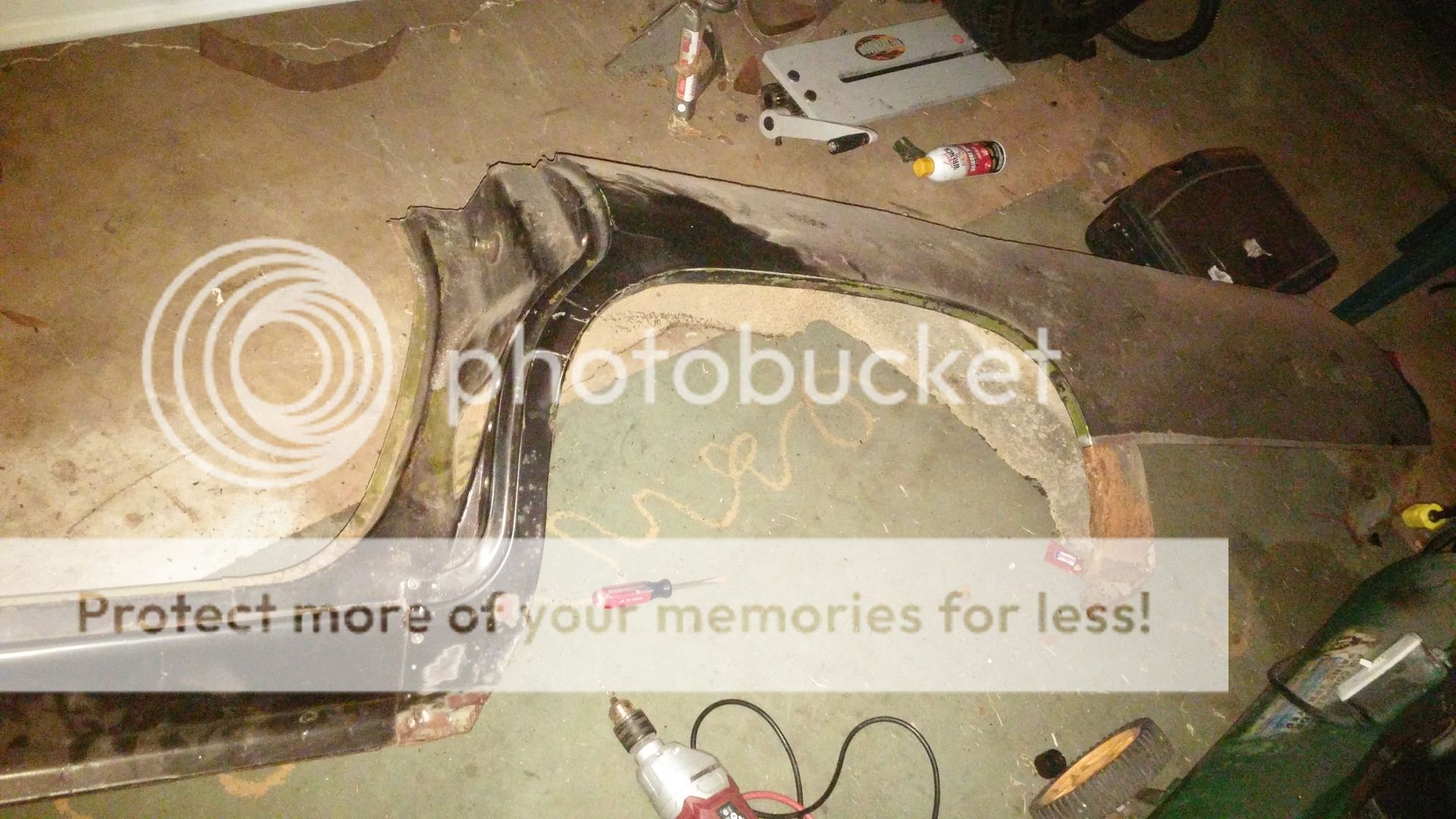

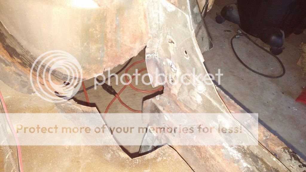

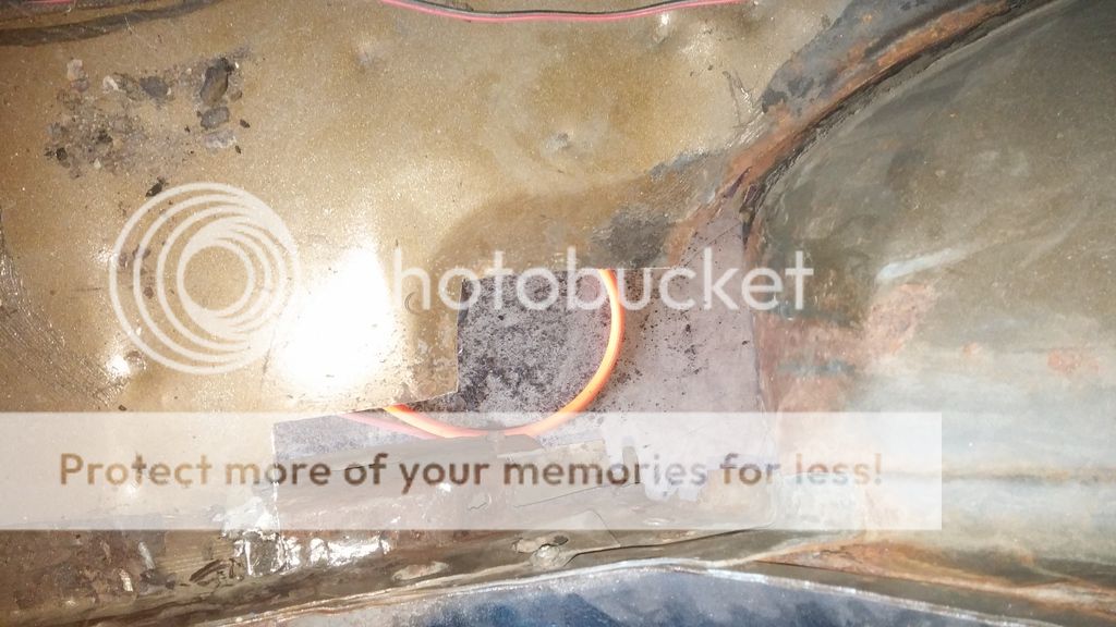

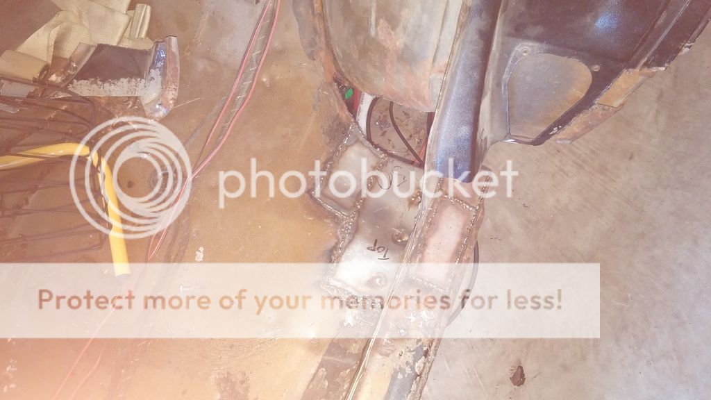

A little progress. This lower corner is pretty bad. Starting from the inside out. New metal welded on to the inner rocker end.

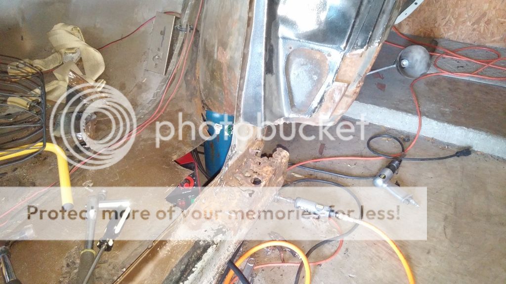

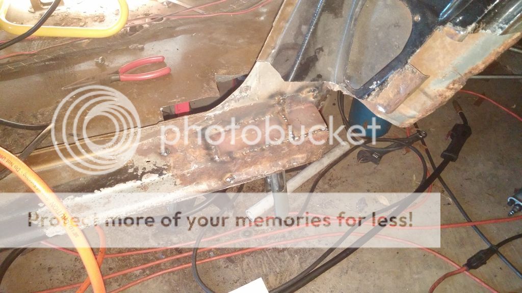

I had to trim more metal away from the dog leg. The top of the outer rocker is really ate up. More then I thought. I can peal the rocker away from the corner support a quarter inch or so. Not good!!

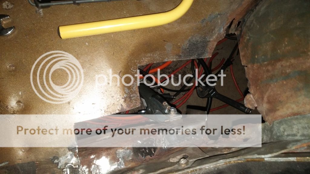

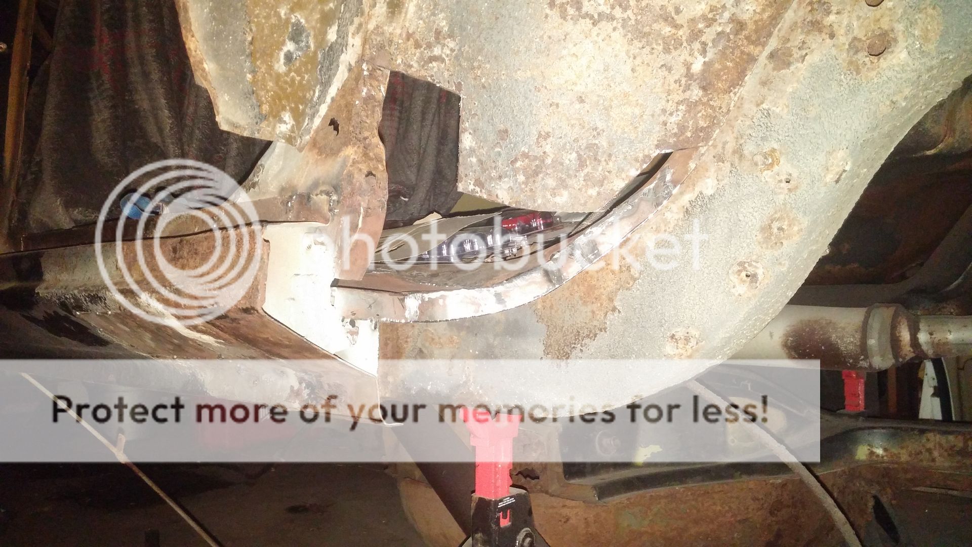

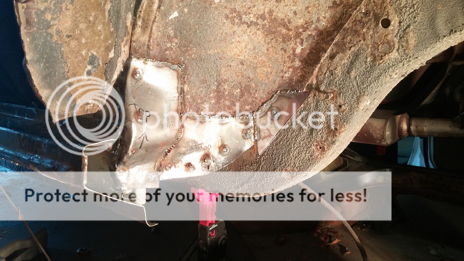

When I disassembled the car I broke the rear seat belt retractor bolt off in the welded nut. I couldn't extract what was left for the life of me. So broke out the sazall. Damn that was a nasty little bugger! Took me half an hour to cut the nut out. Can see the hole for it in the 2nd pic, behind the rocker under the welding slot to the right. Calling it a night.

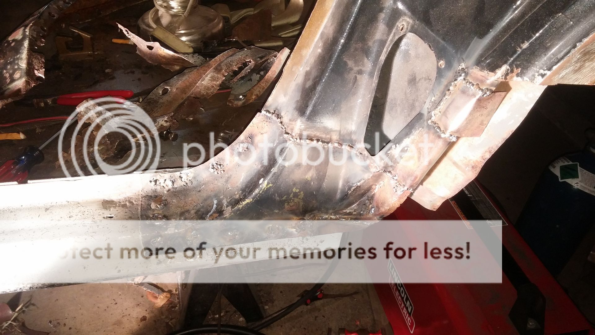

Got a new nut welded in for the seat belt retractor, as well as new metal being welded in. What fun

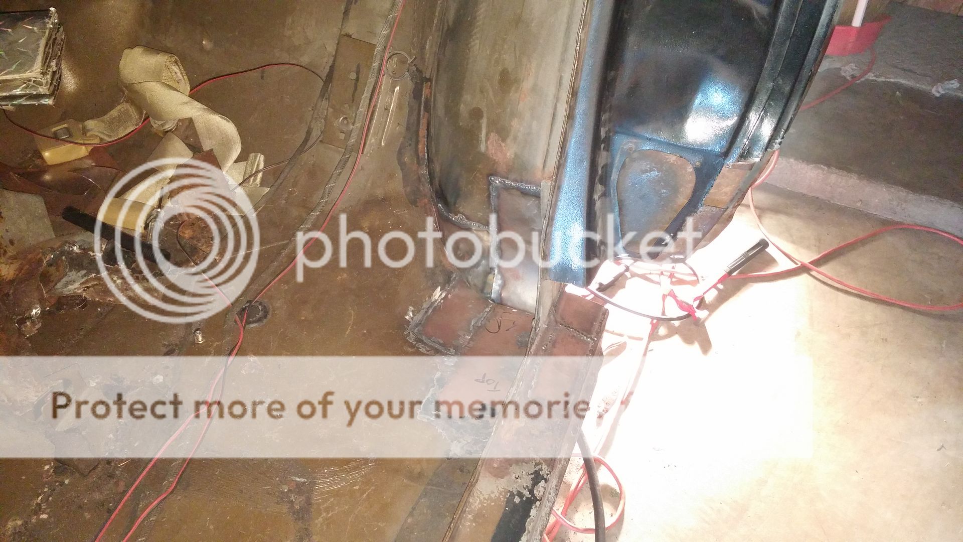

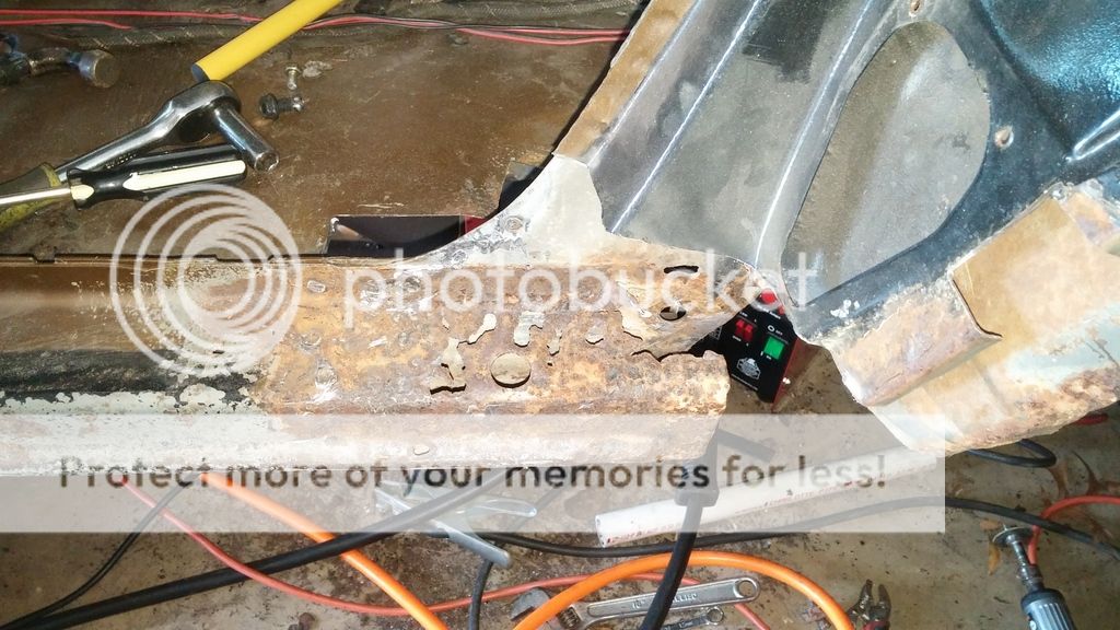

Jeezes, you're getting some real nice beads now.
It was REAL nice working on the thicker metal of the rocker! Could get a few real nice beads going. Sucked having to go back to the thin metal. One tack at a time yuck. Atleast I don't have to grind all those purty welds down on the rocker. Even though they will still be hidden.

Back on the horse this week. Finished the floor up, and ran some new metal up the lip of the floor. Welded in, and finished the patch on the end of the rocker. Now finishing up the inner wheel well corner.

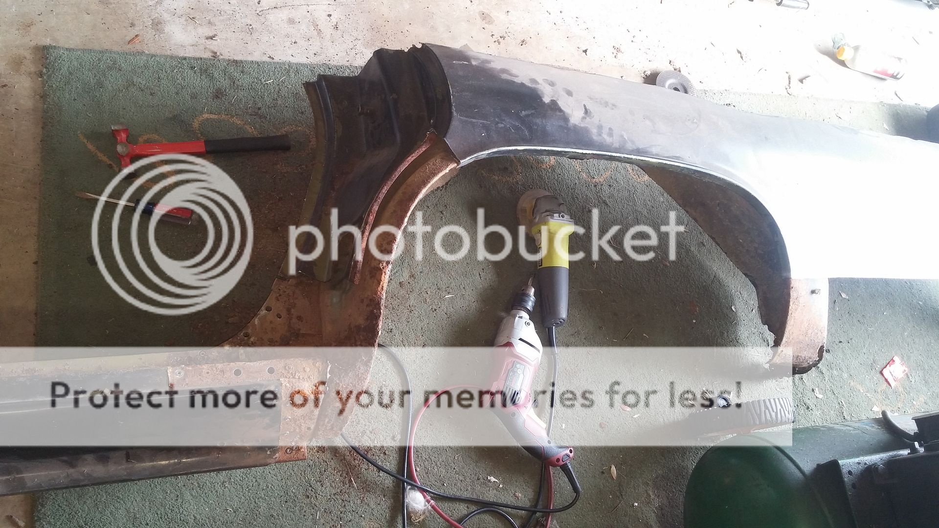

Was pretty cool getting formal parts from a company! The inline box is full of new fuel/vent lines. They look great! Need to be straightened out in a couple spots when the time comes (they were folded for packaging.) Also finally got a filler panel for between the rear bumper, and body. Came from the green Monaco that was on fire a while ago. Luckily this one made it unscathed.

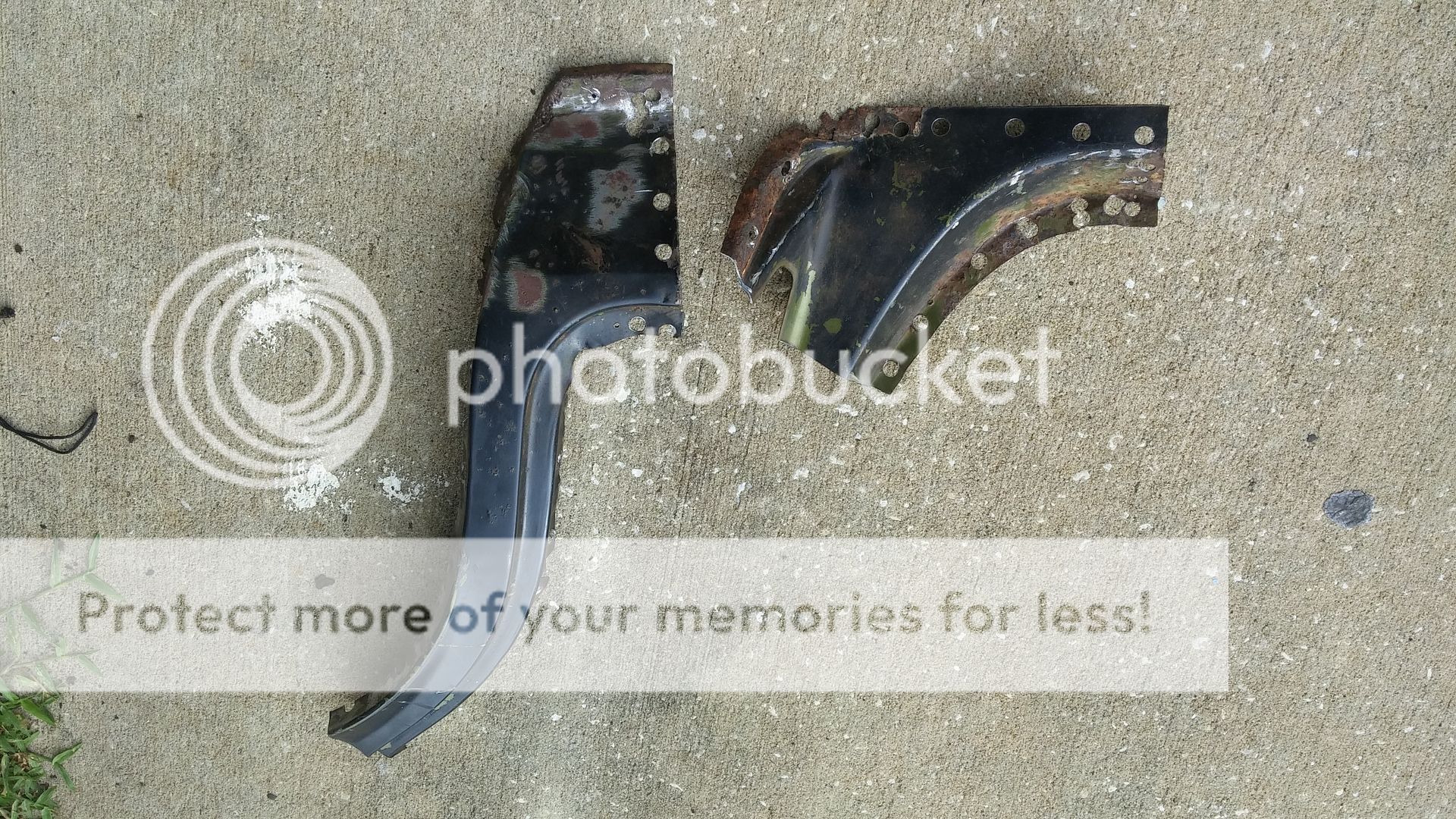

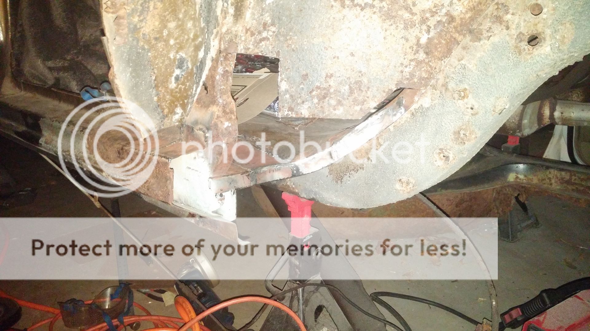

I pillaged the other metal I needed off of the other section of car I had. The dog leg really fought me the whole way. Luckily I won! The pieces had a little bit of rot down low that need replaced. But much better then what I had!

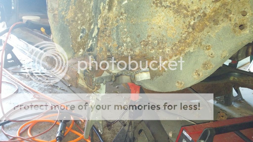

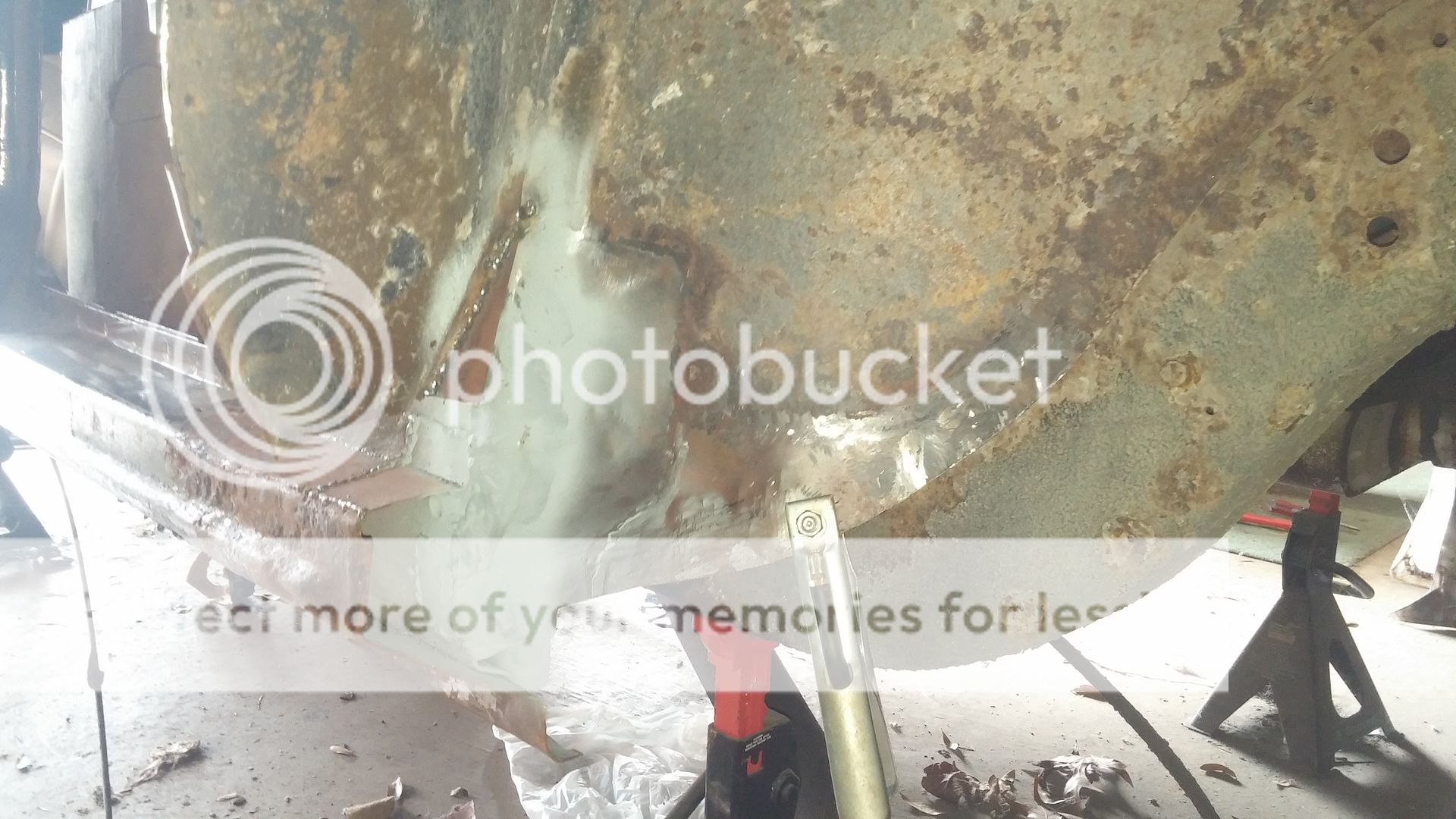

Got the inner piece installed, along with new metal added where needed. Ran the welder out of gas, and wire today. Hopefully pick up some more, and get the dog leg installed tomorrow.

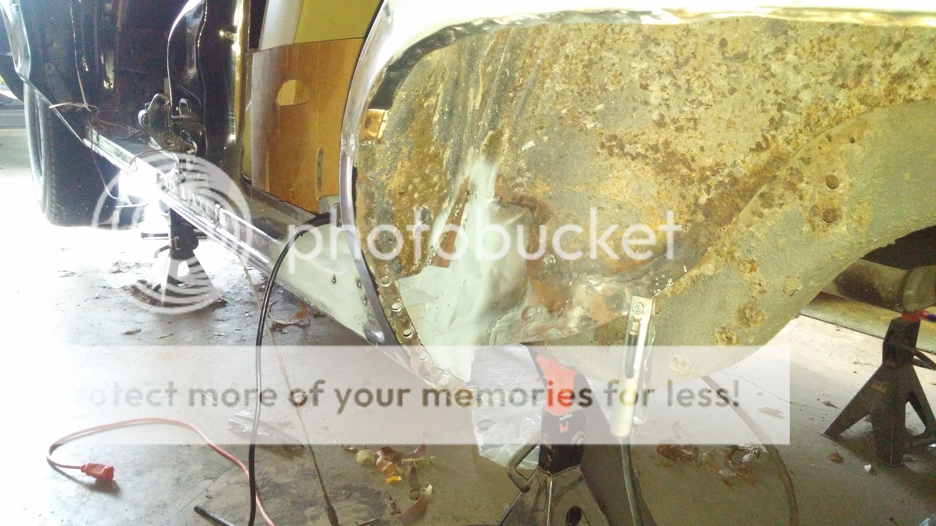

Got the dog leg on. Pretty happy with how its coming out. I'll finish grinding, and adding metal to it next weekend. Get a 4 day weekend coming up should be able to get a lot done. don't think the turkey run is gonna happen this year with the cordoba acting up...
