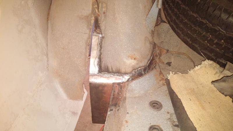

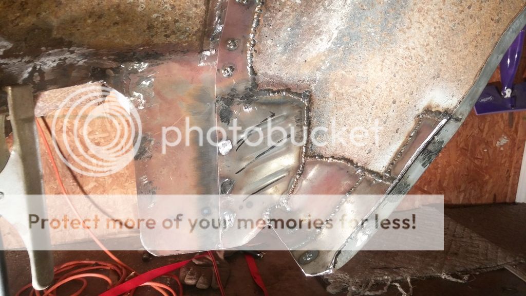

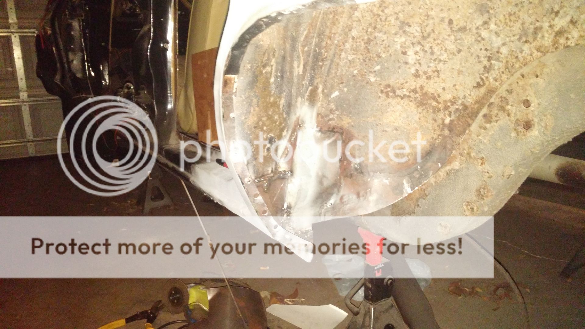

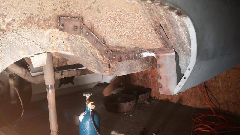

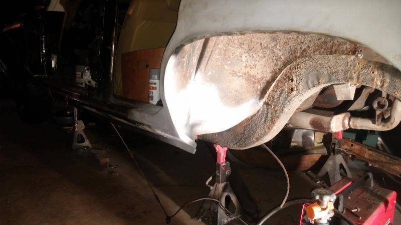

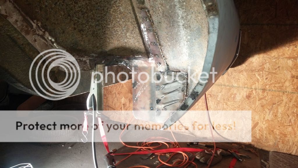

Looks great Zack!
I have to ask, because I haven't seen anyone use or recommend it, have you tried OSPHO? I have had pretty good success with it on my projects when rust is an issue. Its a cheap, easy to find (ace hardware) rust converter. It is a pain to deal with, but IMO works good. I haven't tried Rust Bullet, but have used the self etching rust converter paint from Wurth with some success if the rust was thoroughly cleaned first.
I guess I just asked a question that will bring several opinions... but would like to know what seems to have worked and what hasn't. A car with cancer like yours needs something to stop the spread, and I haven't found many that don't have some started already.
p.s. I'm not a blumo fan but do admire the work and love you put into yours.
