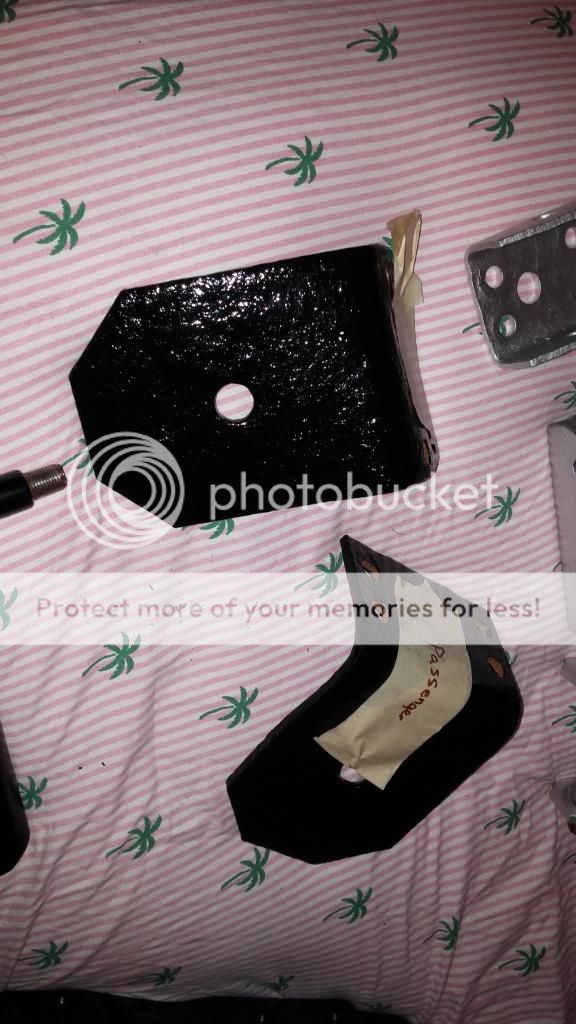

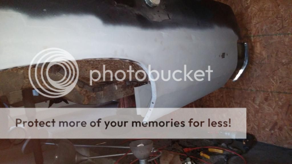

Was wondering, anyone know what these are for??
They are sandwiched in between the rear hanger, and frame. When I took the springs out, the drivers side fell right off, onto the ground. The passenger side stuck on, after prying it off (thinking it was rusted together) it turns out it was welded in the middle to the hanger. I'll just sandwich them back in when installing. But what he hell are they? Exhaust hangers? Mounts for a hitch?? lol

I used the 1978 FSM to research...it was the most handy for me, sorry I didn't use the 74 FSM.
Those are the factory hold downs referred to as the "body bracket" (page 17-8 of the 1978 FSM)...they were used to chain/ strap the cars to the carriers for transport. They are also specified in the FSM for use when towing the cars- there it is called the "shipping tie down bracket" and the clevis for the chain bolts through it. (Page 0-10 of the 1978 FSM)
All Formals have them- regardless of body style.
They are used by the demons that dwell in Formals to crack your skull open every chance they getwhen it's up on a lift. I spilled a lot of blood on those F%$#-ing GeeDee things!
