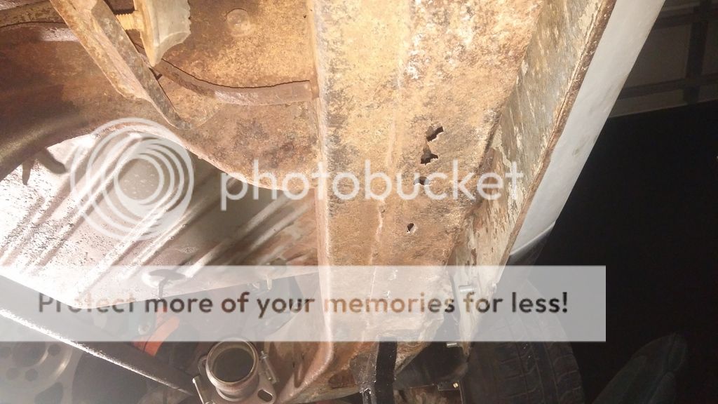

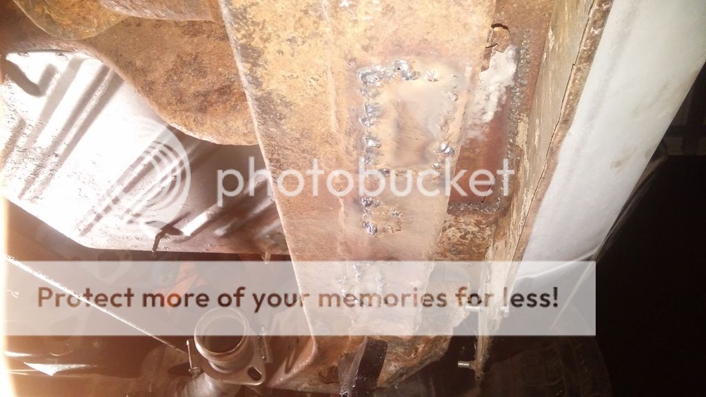

I spoke too soon about the stub... After some more needle scaling, I found a little rot. Luckily this was the only area with some small holes! Got em patched up. After that, got the front of the belly coated with rust bullet.

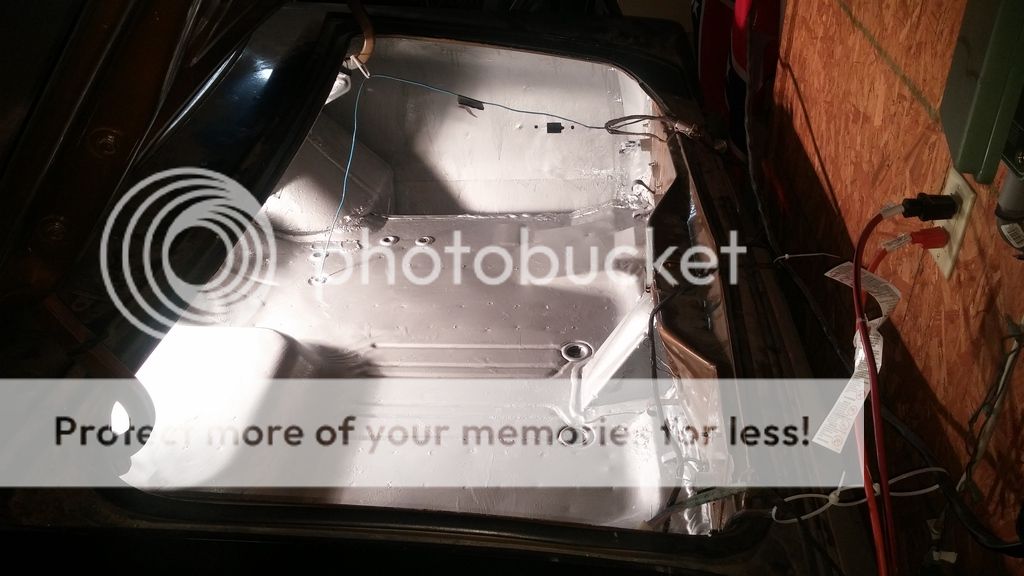

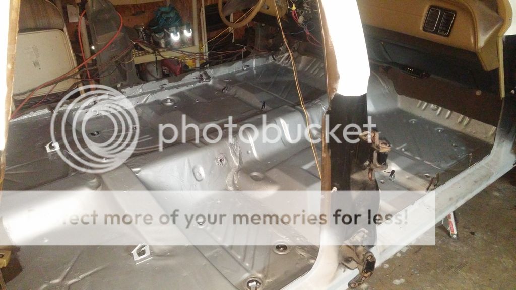

Got the floor cleaned up, as well as the trunk, and got it coated in rust bullet as well. I applied it VERY heavy here, in hopes of it seaping, and dripping into the new seams, and what not. Used up the rest of the gallon here.

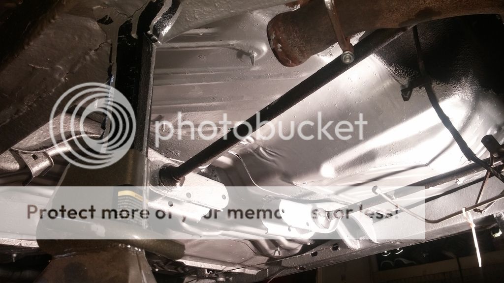

Then applied a little seam sealer where needed.

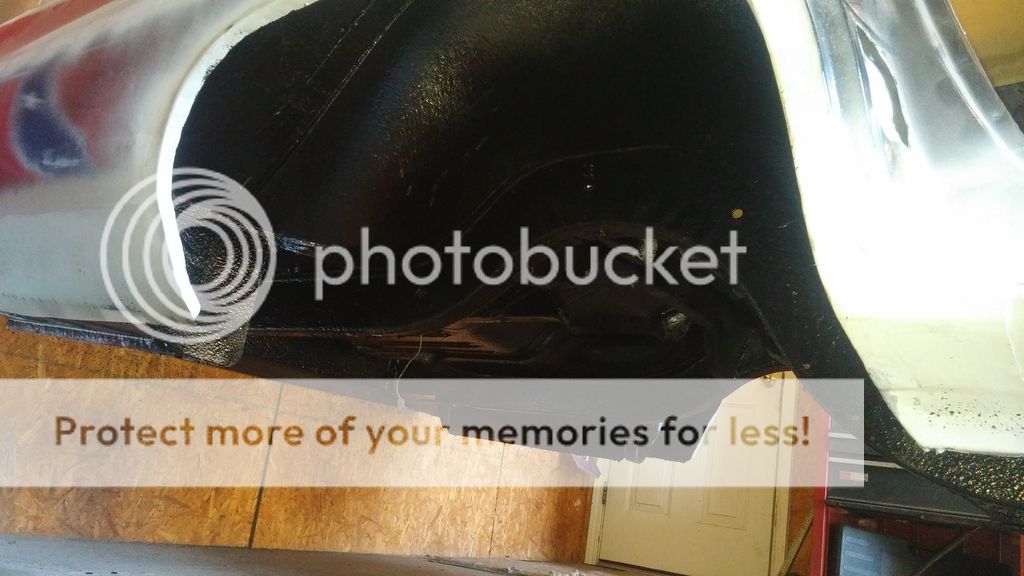

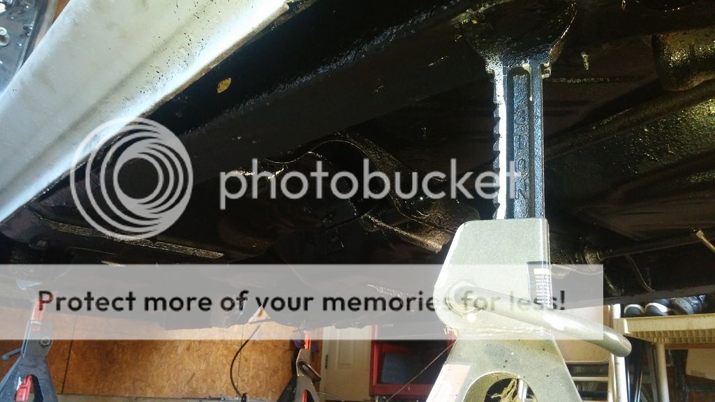

My undercoating, and schutz gun showed up. Sanded the rust bullet down a little, and sprayed the undercoating on today. Im pretty happy with it. Still have a can left for touch ups after final assembly.
