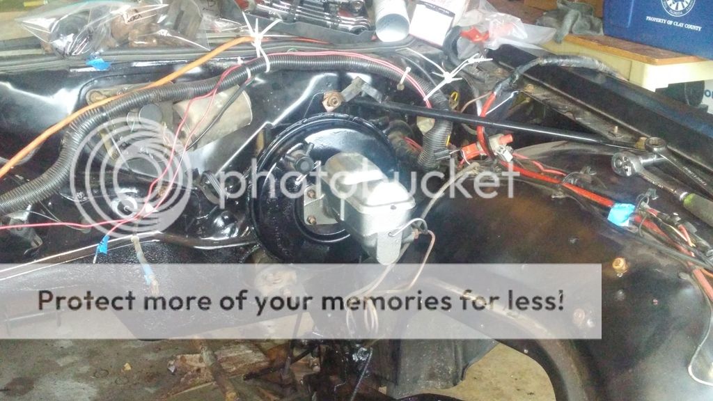

Get rid of that random red wire that is run across your firewall. Either route it neatly behind the factory harness so it can't be seen, or undo whatever you're trying to "workaround". There is good reason the factory doesn't route wires that way.
It was routed beter before the 360 was pulled. Its just the wire that runs from the water temp sensor, to the gauge.

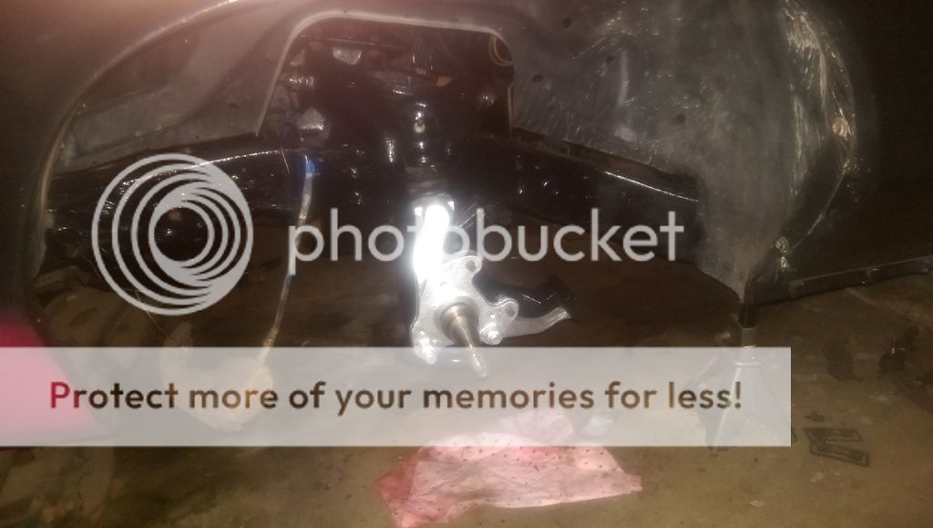

The pin that holds the steering shaft in the coupler rusted, and became one with the coupler. Had to drill it out. Welded up the goobered up hole, and drilled a new one. Still need to order a few more parts $$$

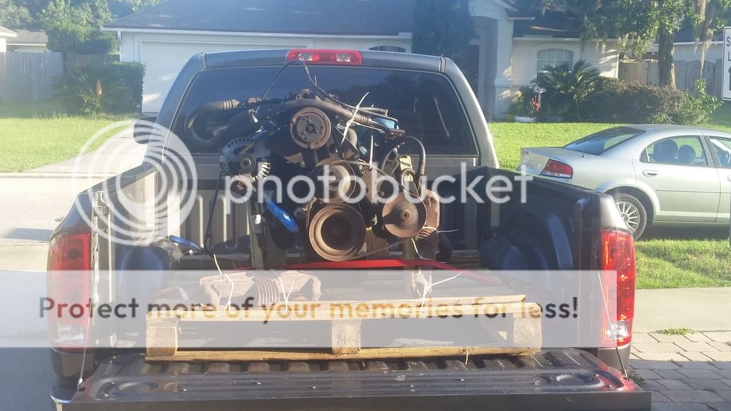

Saying goodbye to the old power house. 360 is headed off tomorrow.

The 360 will have a good home, maybe colder

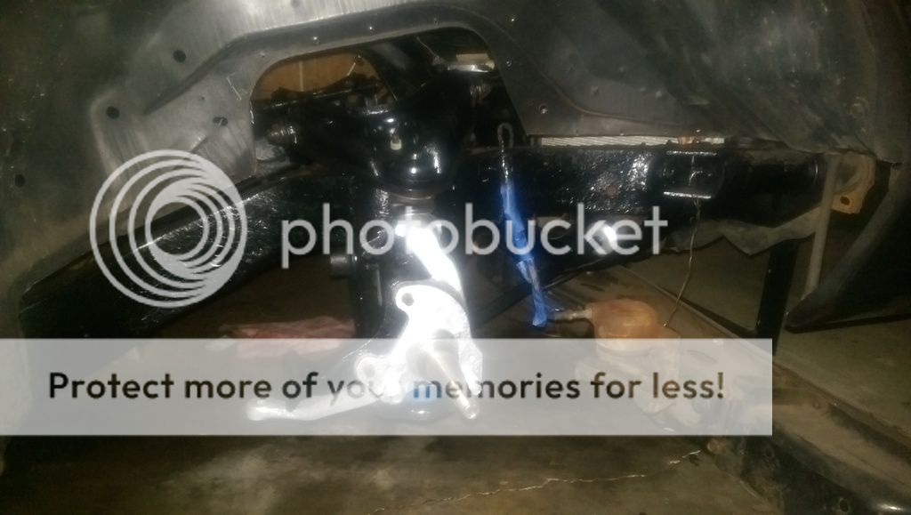

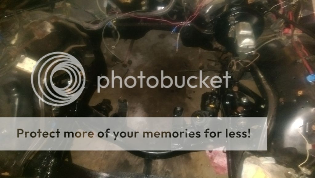

Did get my control arms back. Got some work accomplished! Looking much better after cleaned, and painted! Have a few straggler parts coming in this week. Excuse the horrible pics. The girlfriends camera sucks!! New phone won't be here till tomorrow.
Everything is new. Can't believe how much more $$ it was to do this front end over the Cordova's.
New steering gear didn't come with the hook ups for the hoses. Need to source some new ones, as I sent mine off with my old gear. Also want to order a new sway bar from firm feel to go with the new cop T-bars, and kyb shocks. That will be in a couple pay days.
