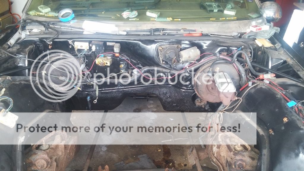

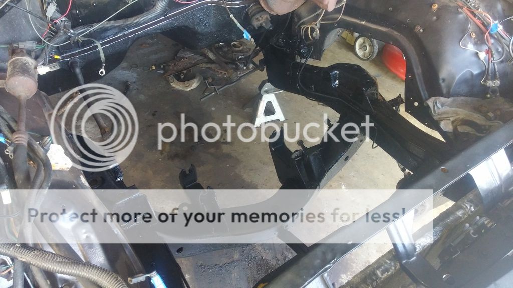

Doing a little detailing under the hood. A few before pics-
Modified the driver side mount, per the instruction in the shumacher conversion kit. The mounts are all the same on these year bodies (A, B, C's) but are in diff locations. The new hole is low. Won't be able to use the washers with the bolts as seen. Probably have to grind one side of the nut down to fit properly too.
Cleaned, and sprayed some new undercoating on the lower half of the fire wall. Also touched up the top half in a few spots. Frame is next. Lots of caked on gunk to remove.

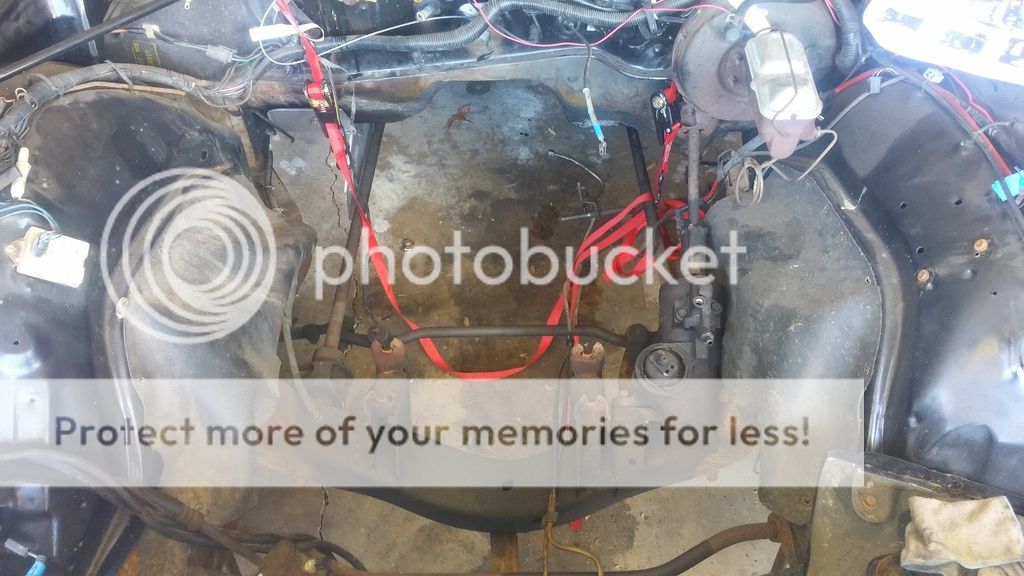

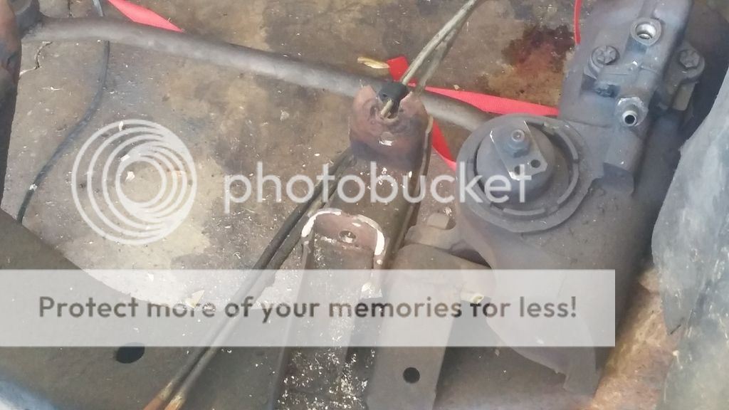

I got the steering gear removed, but can't seem to get the shaft off the gear. Manual says there is a pin in the hole holding it on, but I don't see a pin.. Anyone have any info?
Also, what do you guys recomend to bring life back to rubber? The dust shields are still in decent shape, but dry, and close to cracking. Been hearing of this stuff called sil-glide. Stuff any good?
There should be a roll pin that holds the pot coupling to the shaft on the steering box, spray some grease remover in the hole to get a better look. Do you have a set of roll pin drivers?
That makes tons more sense now. The book made it look more like a solid pin that went through the hole on the coupling. I could see clear through the hole, so was thinking maybe I'm missing the pin, and it was just rusted together.
No pin drivers here. Might take it to work, and see if we can get it out.
Thanks!!

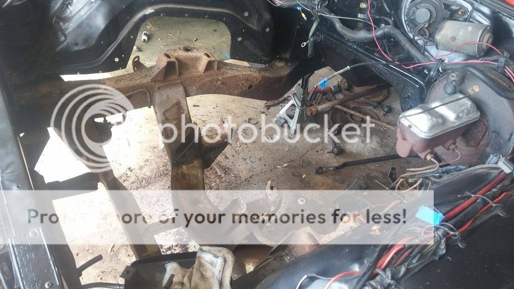

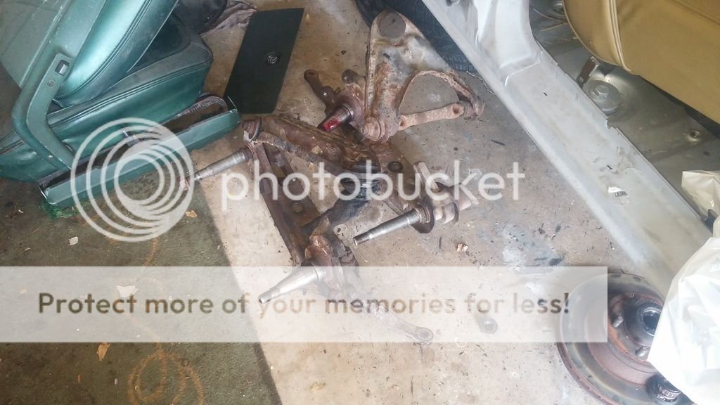

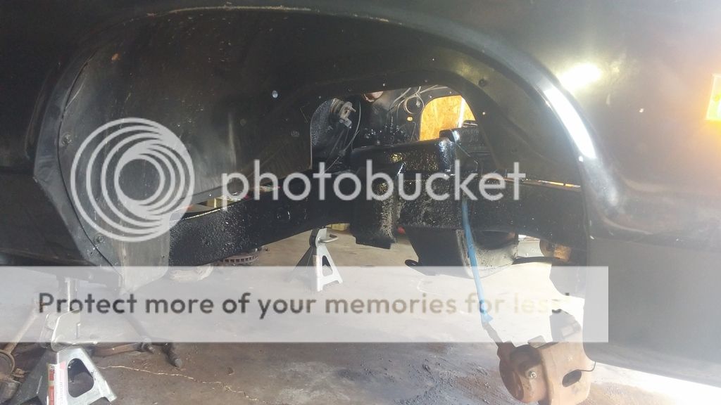

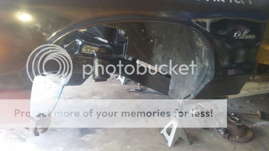

Holy hell! What a pain in the *** that was! Nothing wanted to come apart. I broke one of the t bar adjusting bolts, as well as every single cotter pin. One of the sway bar bolts broke too, had to drill it out.The ball joints won't budge. Had to take the contol arms, and knuckles off as a unit. Gonna drop em off at a shop to get seperated. Had to cut the shocks out with a cut off wheel.
The t bars came out with really no fit for some reason lol. The bad thing is non of the stuff is in that bad of shape. Only 2 boots were iffy. All the joints still seemed good, besides being rusty as hell. The control arm bushings are shot though.

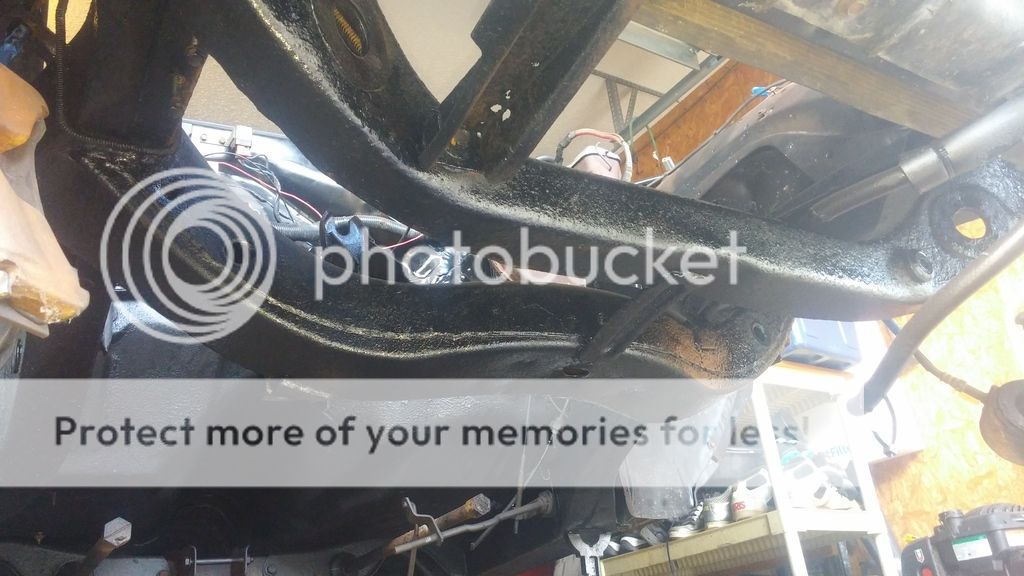

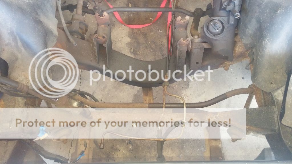

The transmission linkage shield rusted in half. Had to cut out the remains of it. Needle scalled the frame, and cleaned it. Then layed some paint down. Looking much better!
One of the supports that runs to the core support has a little rot. The bolts don't want to budge, and my patience for rust is dwindling so I left it lol. Its still pretty solid though.
