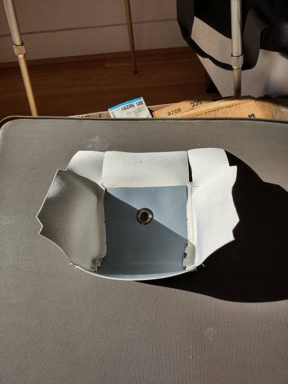

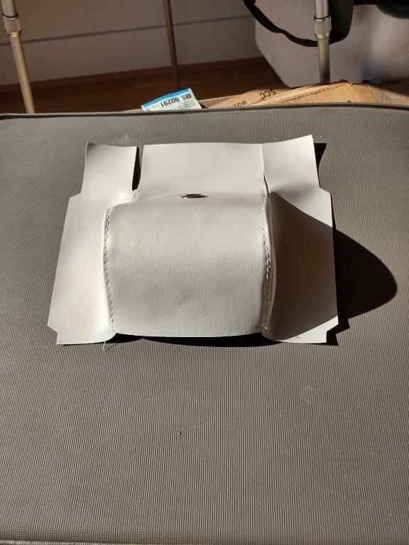

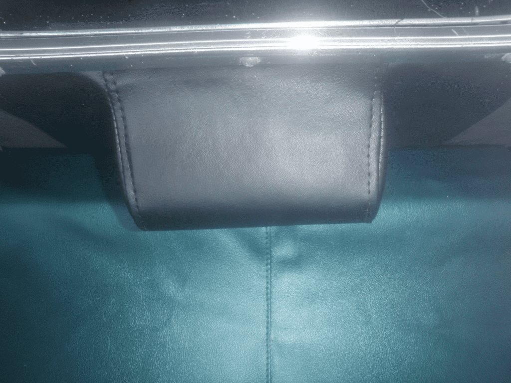

This is what I got 10 years ago from them. It's the only pic I have that shows it (view from top)...
Cam: I ordered the speaker cover from Legendary. I'll post a photo when I receive it.
Thank you again for responding to my dilemma. I would have been lost without you. . .
Rip
That is where I ordered mine. It is a soft black vinyl covering.
Well that soft flap cover looks more like what would have been available in 66/67. I worry about the clearance between it and the bow of the convertible top when it is fully down. Does it land on top of the cover or? I find it strange that will all my searches for photos of my 67 300 I have never seen what came stock on the car for a speaker cover. Anyone have a photo? Rip, I feel your pain on the power antenna. Big John had a tutorial on how to repair those, but I finally found one that worked nicely and replaced mine. I have a few of them now I think!
Well that's really interesting. I wonder if it changed from 65-66-67? Just looking at how far that protrudes out from the back of the seat, I think my convertible top bow would hit that. I have about 2 inches clearance from the back of the seat to the top bow when the top is folded into the well. 300 Rag, Is this your 4 speed car? I thought I saw somewhere that you had sold it? CamShaft

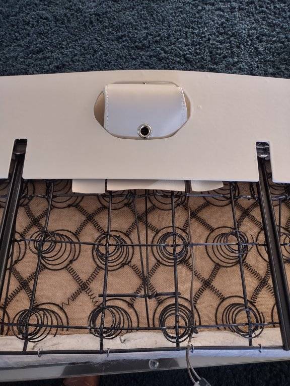

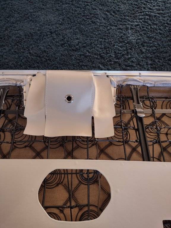

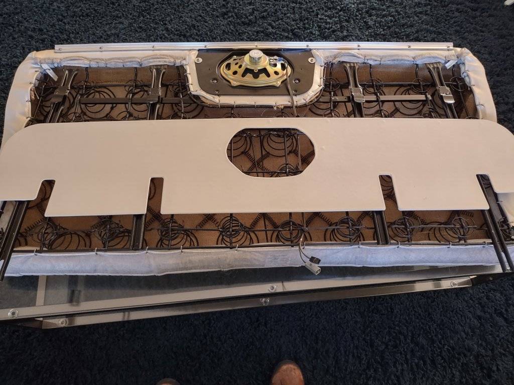

I'm working on the back seat interior in my 66 300 convertible. I have a panel that attaches to the back seat back where the rear seat speaker resides. I'm not sure how it attaches. A couple of photos are shown below. Does the panel attach under the long slotted trim strip? Or does attach on top of it?
I can't believe I've been working on this car for six years. . .
If you'd stop driving the parts car you might make some progress....:poke:
Aren't you finished yet??? Gee...
x2
Re- thinking. What does the rear seat support look like. On normal cars this “trunk wall” hangs in the car on hooks. Then you connect the seat back.
And the seat back when secured holds it in place.
