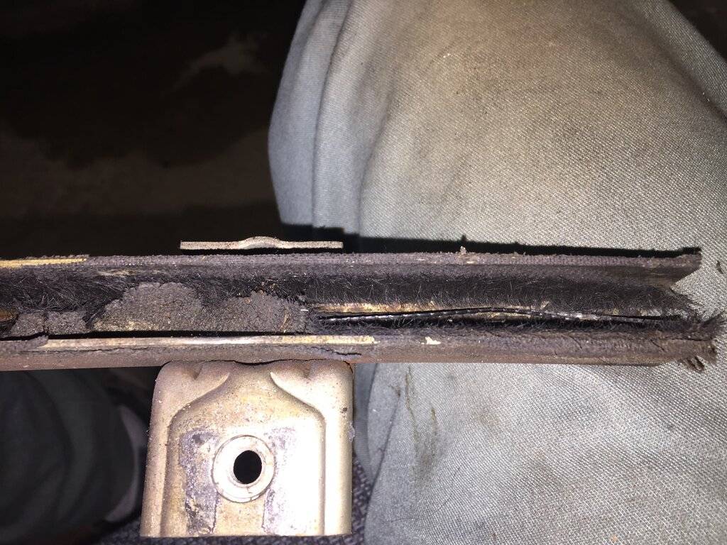

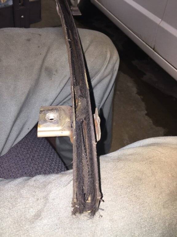

Yours appears pretty good. Check the fit between the front windows and rear and the rear to the top. After I reassembled the interior I noticed my right rear window was out of adjustment. Just trying to keeping from doing something I did. :)
IMHO, these 1/4 windows are really difficult to keep in adjustment

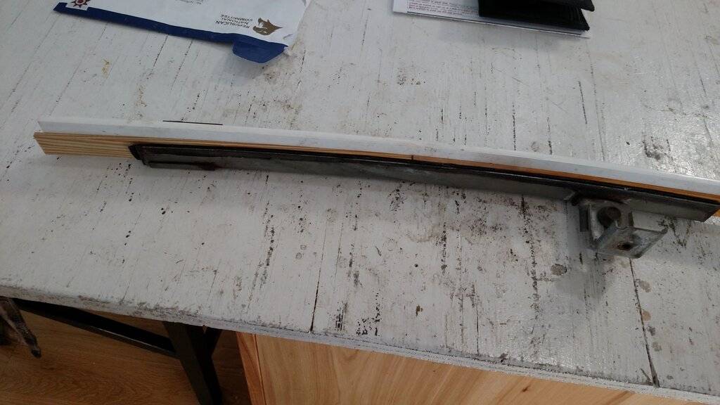

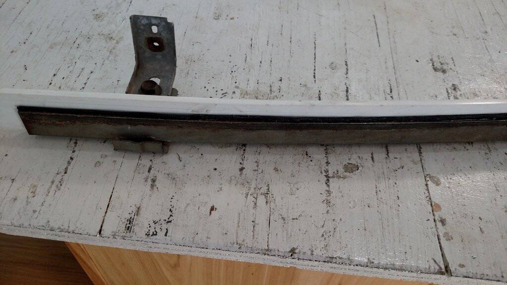

Here you go.
In reviewing the pictures, I see that I also used big flat washers to secure the wood strips in place.
Also including a few of of the original flocking...
The replacement material was different than the fuzzy style I had but works well.
View attachment 436603 View attachment 436604 View attachment 436606 View attachment 436607

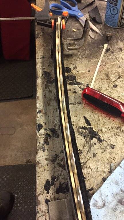

I got the new run channel material installed yesterday. Thanks to @mr. fix it , it was easy peazy japaneazy. Used a plastic trim piece and couple of paint sticks.

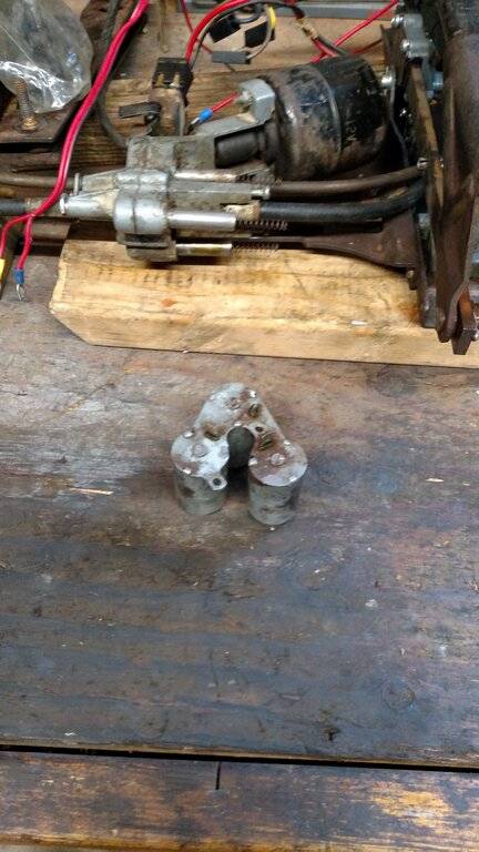

The Saga does continue. . . Trying to fix my power seat base. Determined I have a bad solenoid / coil. It is part number 1830-290. Used in both Chrysler and Imperial in '66. Does anyone have a line on this part - before I call Murray? Here is a picture:

In couldn't find that triple-solenoid anywhere, so I finally bit the bullet and cannibalized the solenoid from the power passenger seat in The Parts Car. Hopefully I'll find one later - maybe at Carlisle that I can re-install in The Parts Car.

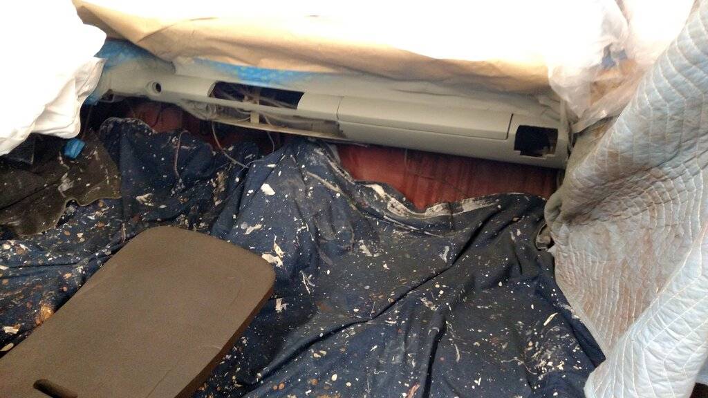

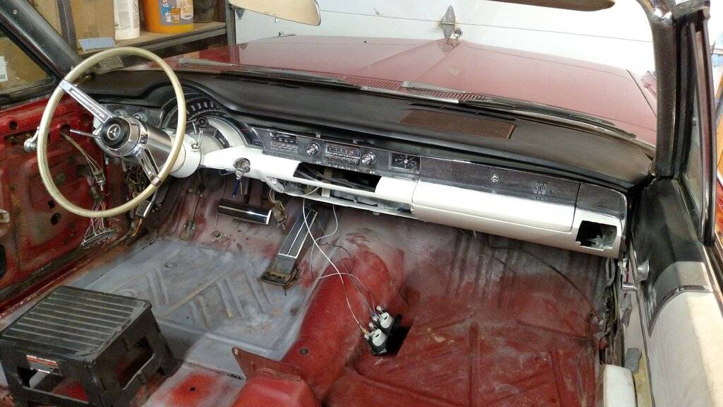

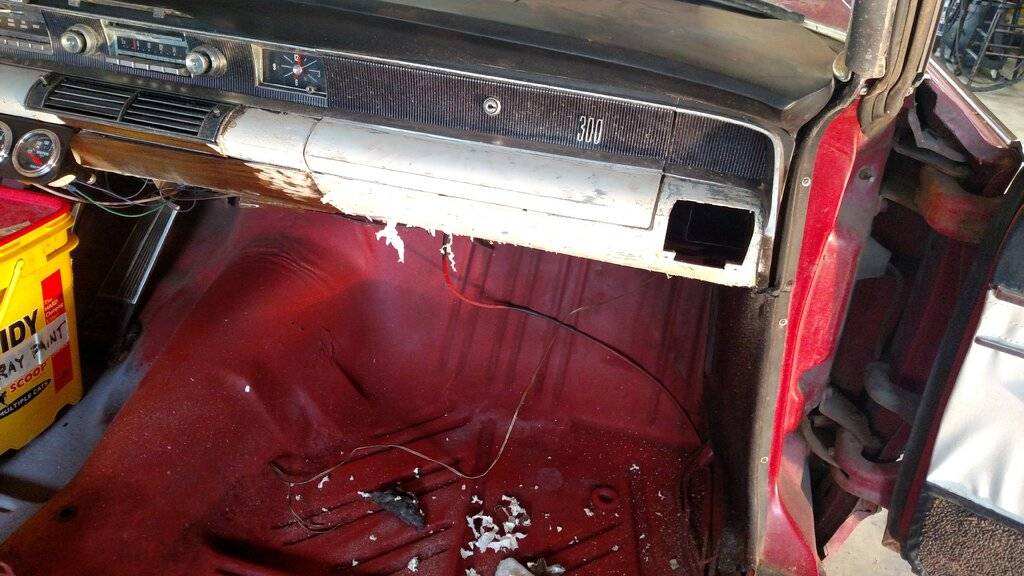

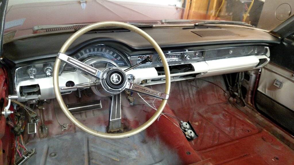

In my continuing effort to put the car back together for Carlisle, No. 1 son and I continued the attack on the dash. You all may remember this photo of the wood grain contact paper mess that confronts us. Here is the before / in-progress shot:

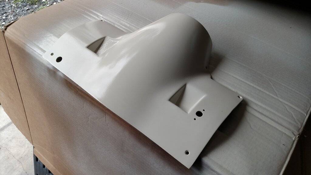

We pretty much had to scrape and sand the dash down to bare metal - a total pain in the gazorkma. Here are a few shots that illustrate the steps from the primer to the finish coat of Spinaker White from Kolor Korrect with a couple of final coats of SEM Gloss:
Now I just hafta put everything back together. . . Interior panels, carpet, back seat, front seats. . . Wax on. . . Wax off. . .

Pearl White was the color of the seat upholstery and door and back seat trim panels. Different paint on the panels altogether, requiring a two stage paint process - base white followed by a coat of Pearl. Except for the gloss finish (which we fixed with SEM Gloss clear, Spinaker White is a dead-on match to the paint used originally on the dash.

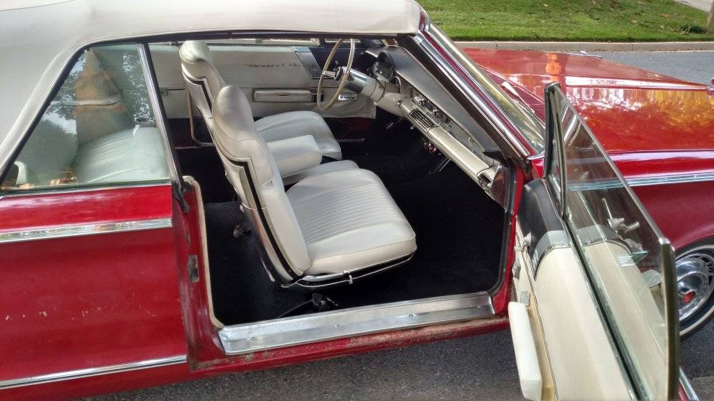

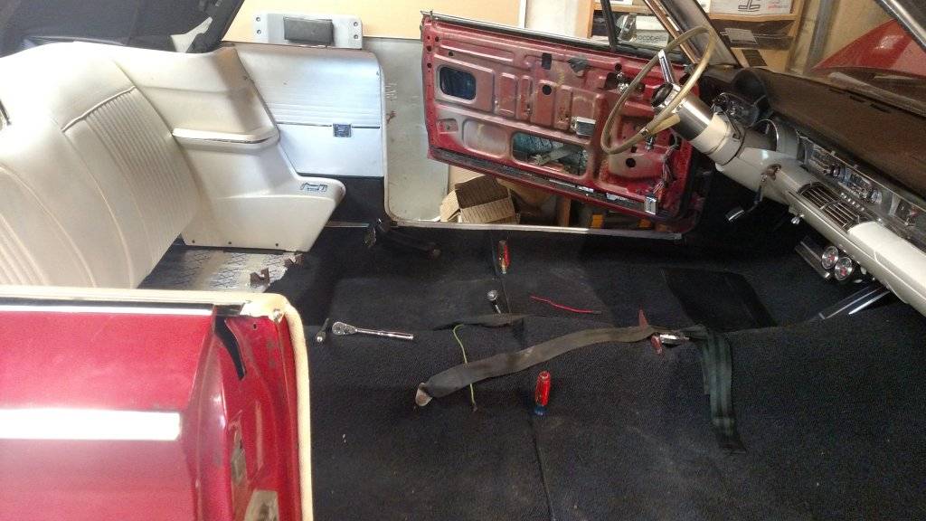

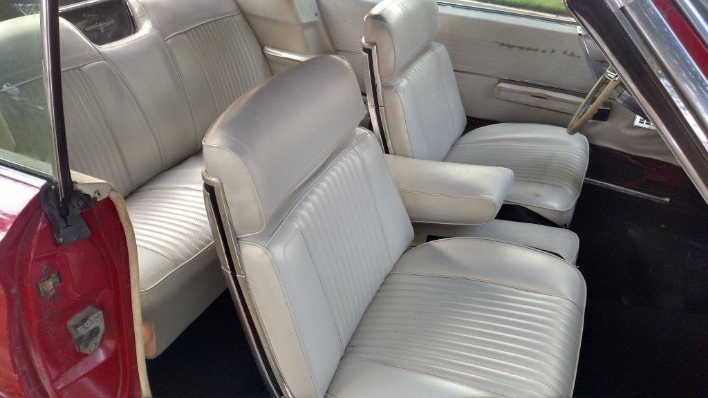

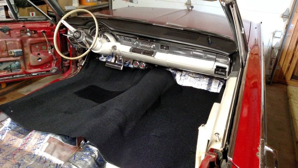

I just realized I never completed documenting this stage of my progress with the re-assembly of the interior. At the time (last year), I was on a mission to get the car ready for Carlisle. So here are a few shots showing how it all finally worked out:

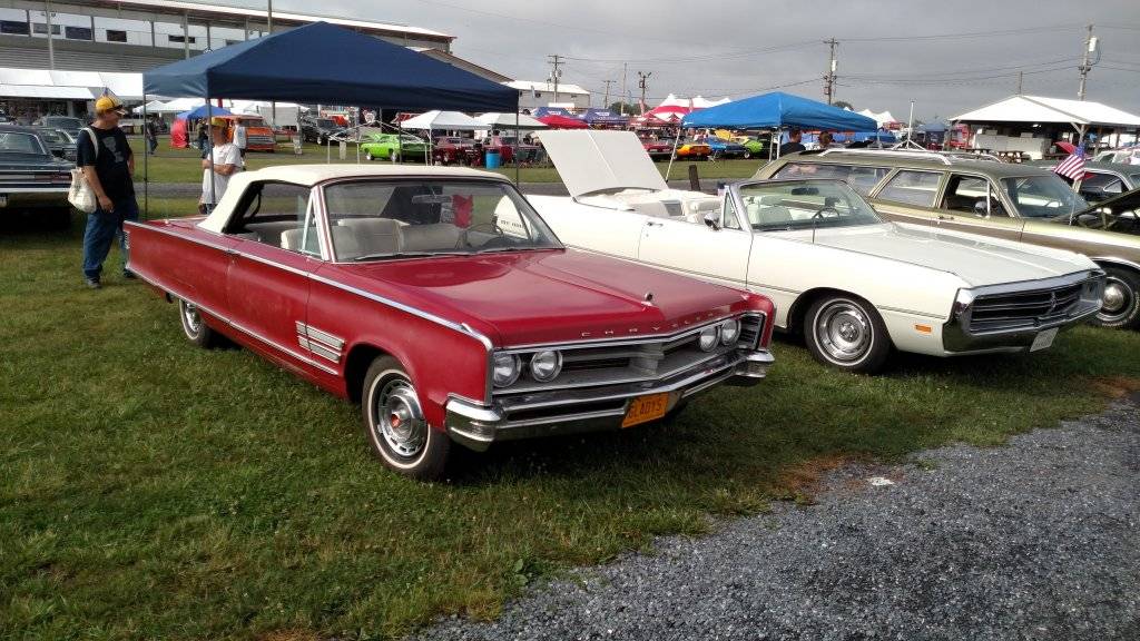

And we did make it to Carlisle. I don't wanna say this journey has been some kind of an immaculate conception, but originally, I was sure I would bring the car to Carlisle in 2016. . . As you can see, I made the mistake of parking next to David Hill's gorgeous 300 convertible, making my car totally invisible. . .

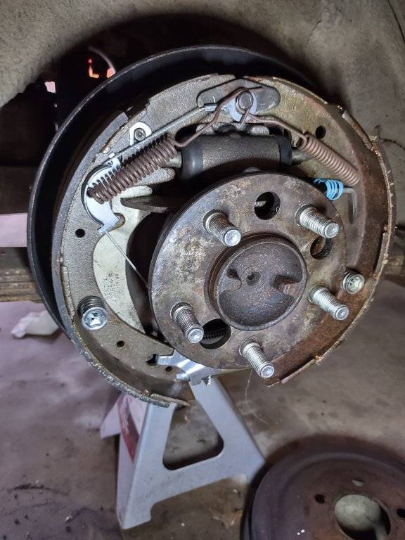

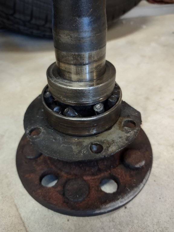

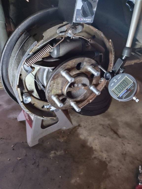

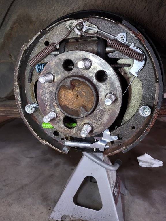

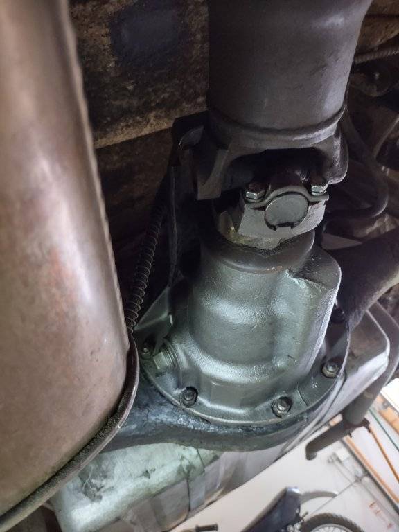

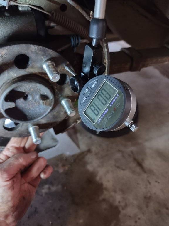

The Saga never ends. Spent a lotta time repairing a left side blown up axle bearing on the '66 convertible. While we were in there, also replaced the brakes and the hardware. Also installed a 2.91 Sure Grip diff. Here's a few photos of the carnage.
I should also put a shout out to Craig at @mobileparts for hooking me up with all the NOS brake hardware, including new NOS drums.
2.91? Jeezes, Rip..... :poke:
Yeah. I replaced the peg leg 3.23. It was a good gear, but the car always felt like it needed to shift one more time after settling down in third gear. I'm hoping the 2.91 will help to cure that.
