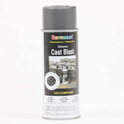

Nice work. What color/brand of paint are you using for the suspension components?
Sorry, I think I misunderstood the question when I read it from my smart phone??
Anyways the major components are the Rust bullet black and silver.
The cast gray colured paint is marketed as "Cast Blast"
I bought it online from Dell City . net.
A number of restore guys like myself have used with good success.
Gives the steering linkages a nice clean cast look which offsets the parts from being all black.
here is a link to Walmart as well.
I know I didn't pay this much for it though.
http://www.walmart.com/ip/Seymour-Cast-Blast-Iron/19249805
