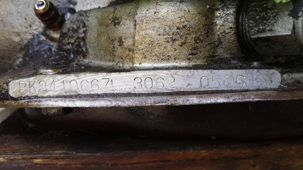

Can someone please dummy up the explanation of transmission numbers? The on line information is apparently to smart for me and the 10000 day calendar has always been a head scratcher.
What does all this mean?

The PK is the kokomo plant, 3410667L is the part no. early 70 used until Apr 27 1970, 3062 is the date Dec 15 1969 and 0506 is the daily sequential no, # 506 built that day.
Look on the bellhousing to see if your vin is stamped.

The first section is the important number. May not be on that trans guide, safe bet is big block motor home will have 4 pinions and big drum.
Wow that was built on a Monday during the holiday season. Amazing it lasted this long. Then again at 506 could have been later in the day when the hangover was over.
