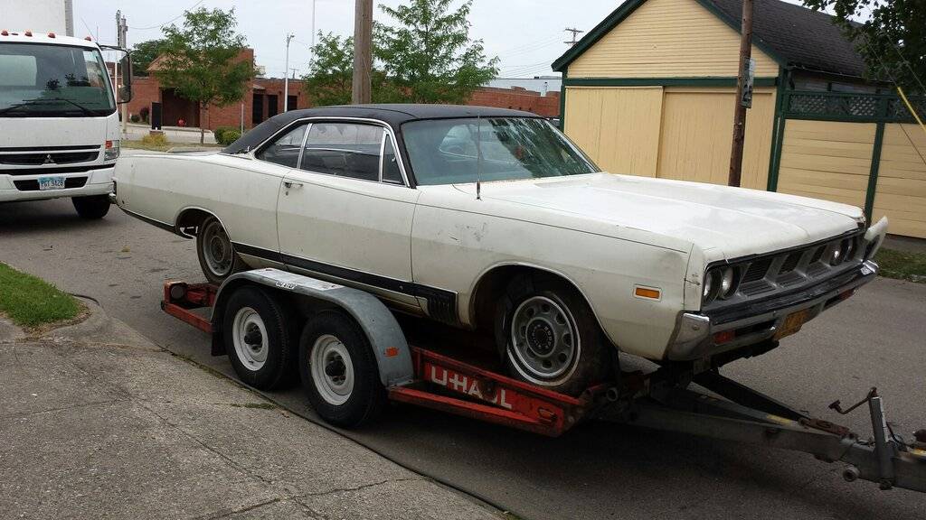

Gotta make sure the trailer cg is forward of the axle centerlines. Even a semi trailer will behave poorly loaded heavy on the tail. Like Dave said, hard to adjust weight of a car on those short U haul trailers. Watching how much weight is in the trunk or interior will help.

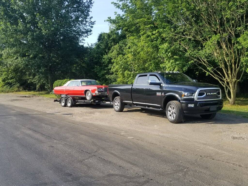

Long trailers are very nice to tow with.View attachment 438140 View attachment 438141

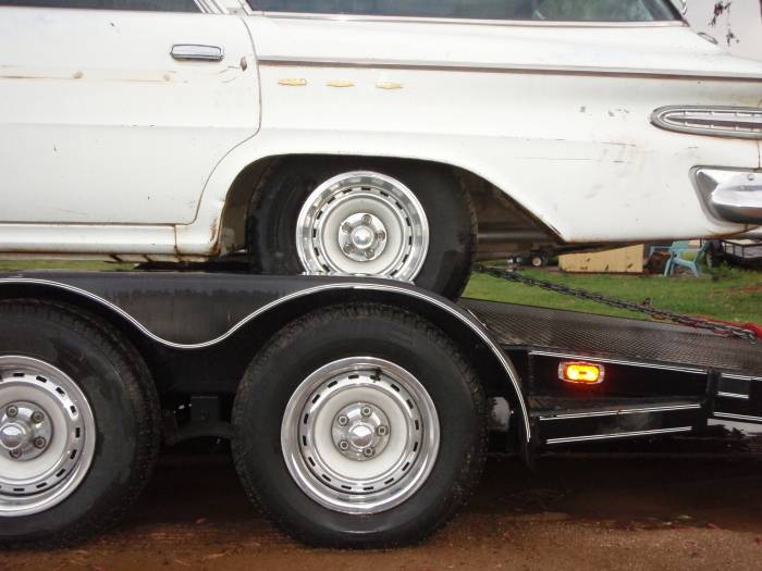

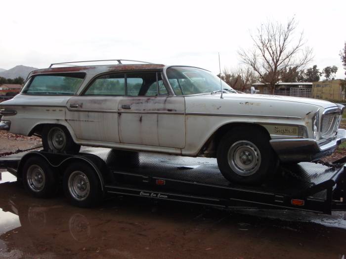

My trailer is a 20 footer with the axles set pretty far back. Even with a large car the weight is forward enough that I've never had any issues. I've even towed a few cars backwards with no problems.
Yes, and with long wheelbase diesel trucks too!Long trailers are very nice to tow with.

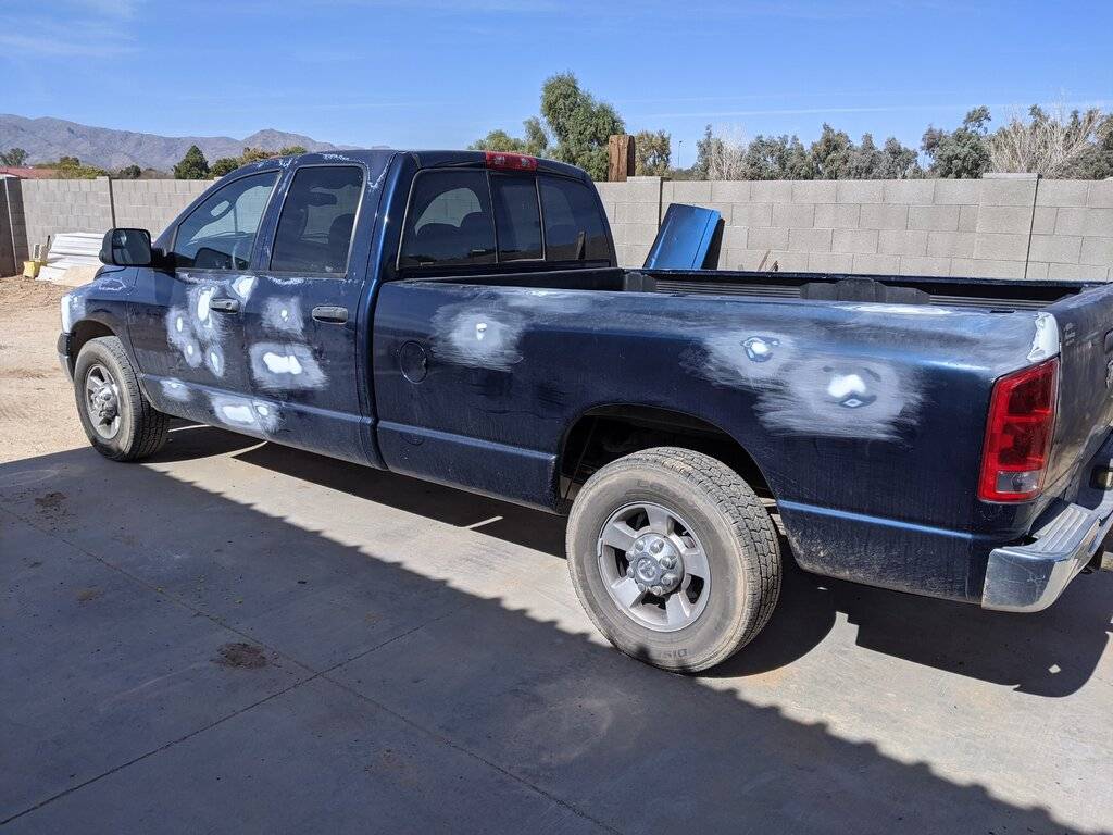

I do want to mention that while I had some small dents to fix since it's an Arizona truck not a spot of rust!Exactly! And it will look much better in a week or so.
