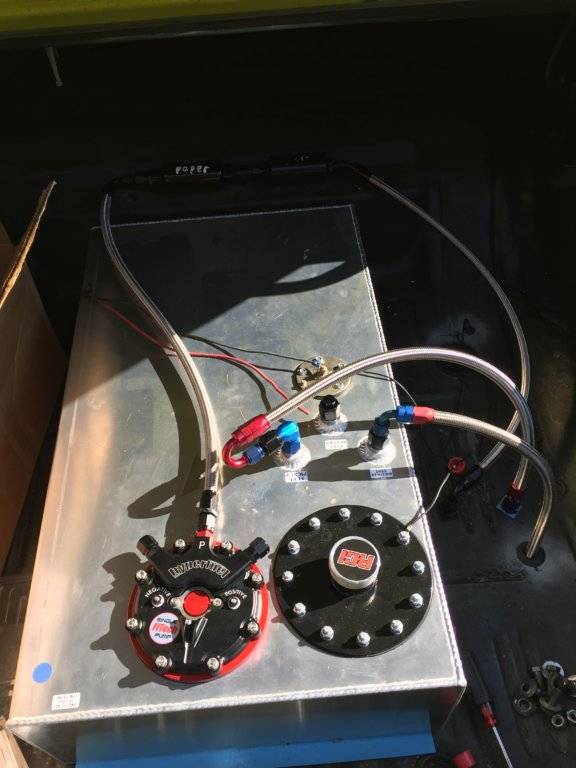

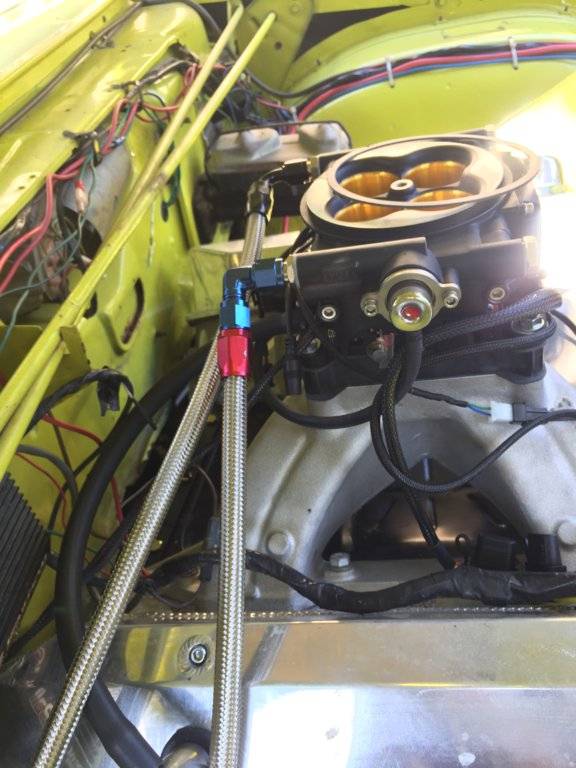

I've gotten some work done in the past few weeks.

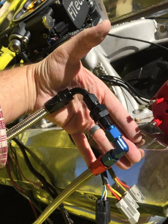

I routed the fuel lines.
I placed the coarse and fine filters. Nothing is strapped down just yet.
The supply fittings are black. The return is red/blue.
It's better than trying to chase them down along some 20' of body to figure out which is which.
-dad
Then, I purged the lines to get any trash pushed out of them.
By the way: labels on the fuel cell have yet to be moved. Remember, I'm using the original pickup for the return. This is because the pickup has a tube that allows fuel to return under the surface. That minimizes aeration.
In order to keep trash out of the throttle body, I jumpered supply and return.
No pressure yet, just flowing fuel with the pump and some carefully-attached jumper cables.

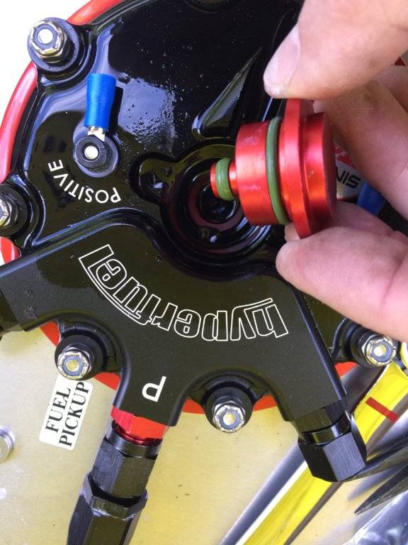

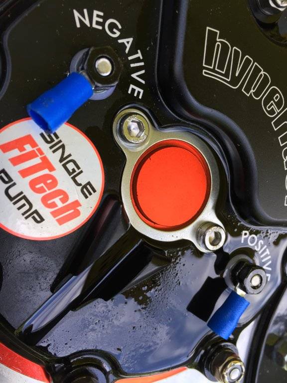

What's this???!!!
The pressure regulator was removed from the fuel pump in order to have a pressure regulator at the throttle body. In its place was this pretty red plug. It's leaking and we don't even have a pressure regulator in line yet. Here's why:
The dadgummed o-ring is too low-profile. I replaced it with the original one that came on the unused pressure regulator. Leak fixed. I flushed the fuel cell and lines with the cheap $20/gallon unleaded "MS-109."

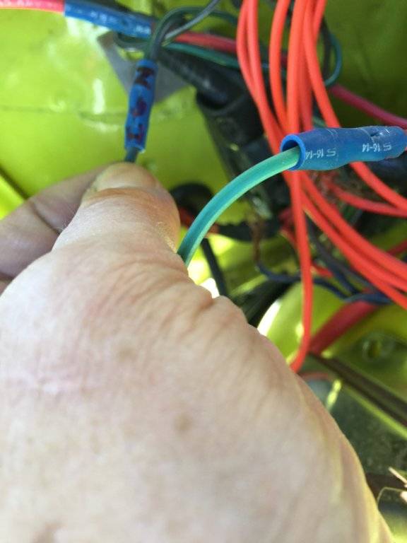

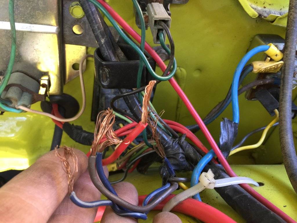

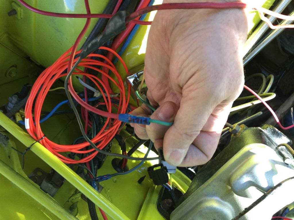

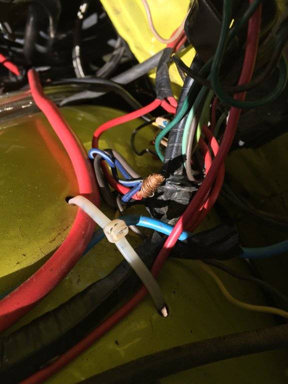

It's a good thing that I've been into electronics since I was a little boy.
Out with the randomness and unprotected battery connections. I've put some temporary labels here and there as I unwind this mess.
Oh, by the way - many of this vehicles' ORIGINAL wires don't match the colors called out on the schematics for either 1966 or 1967. They often used what they had. Reminds me of a technician who was looking for the light blue wire under the rocker panel of a Ford Probe. He lifted the rocker panel cover and found it. It was right there with all of the other light blue wires. Every stinking one was light blue in that particular harness. The factory must have had a special on light blue wire the day that car was made.
I'm going to draw schematics of what I do. We're losing the external voltage regulator. We're losing several unused wires. We're simplifying where we can and getting hardcore where we need to. More to follow!

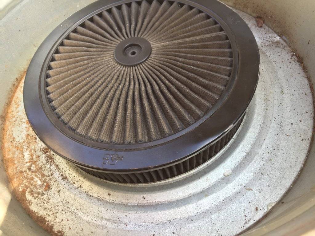

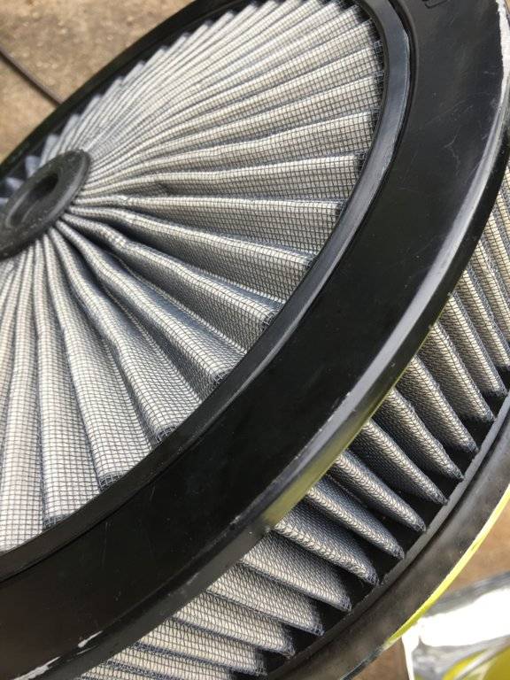

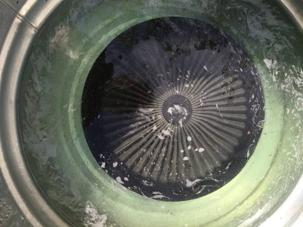

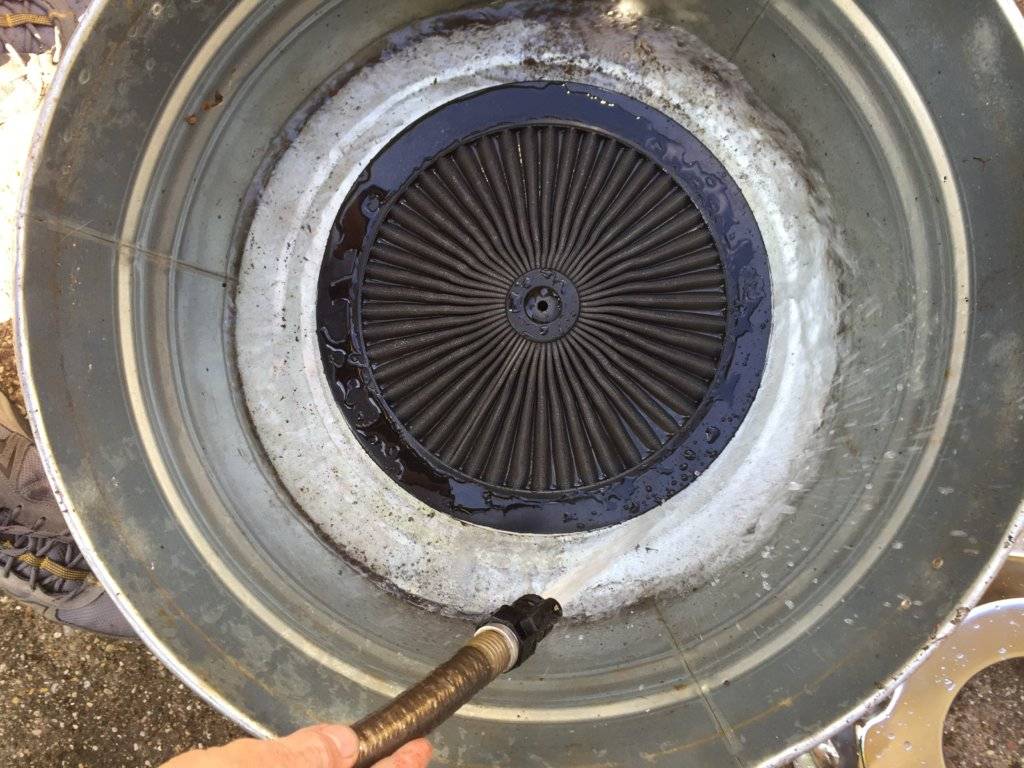

The cheap stuff. They were out of club soda. So, I got off-brand denture tablets. A couple dozen, some water, and some oxygen-cleanser.
