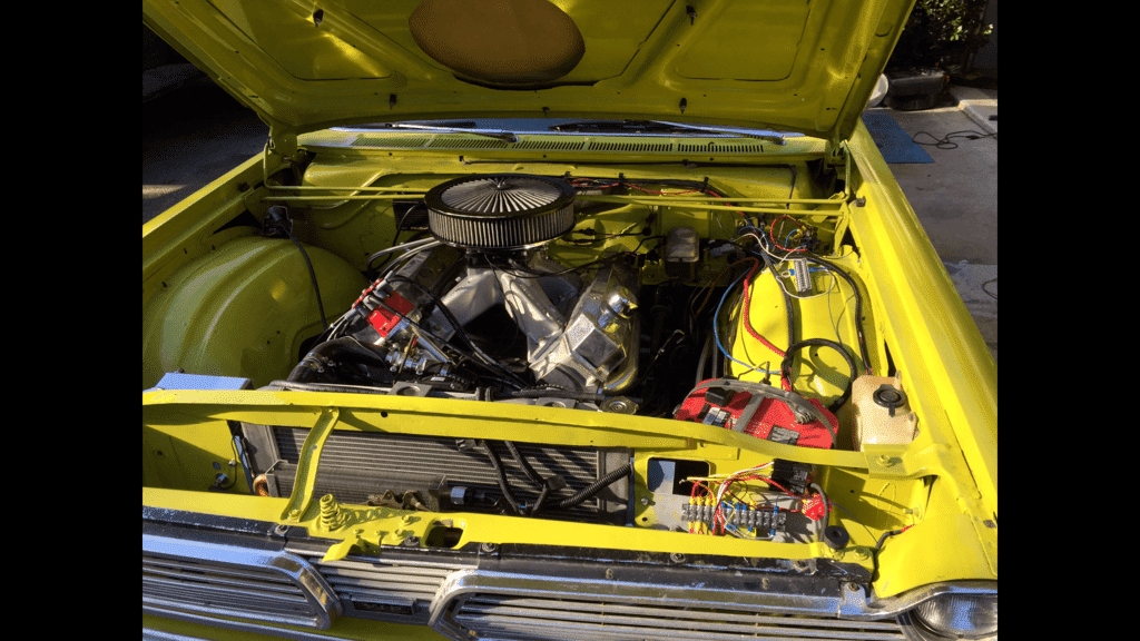

Two steps back. Wiring is close enough to get an attempt at starting the beast. Hiccup:
The fuel pump stuck and blew a fuse. I temporarily hard-wired it and got it spinning. After that, it’s behaving well. New electric motors sometimes need a good swift kick-start.
Hiccup!!:

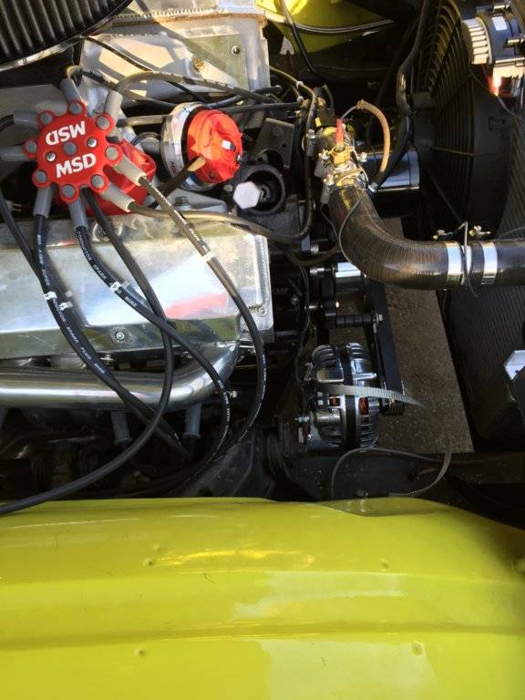

Apparently, the Crane Fireball ignition module, which ran fine from magnetic trigger, won’t make spark at all when we’re triggering it from the “points” wire. It’s potted in epoxy and not readily repairable. That’s OK. Summit racing has a new store in the DFW metroplex now. We plan to get a new MSD ignition box tomorrow. Sigh. So close.
One other thing that I’m noticing is that the oil pressure gauge didn’t bump at all when cranking. We did prime it and got oil flow before final assembly, so, I’ll be keeping a VERY CLOSE EYE on oil pressure as soon as it’s turning under its own power.

Well, I turned on the ignition and triggered the Crane Fireball by touching a grounded wire to its input. There is very certainly spark at the coil. So, it’s looking like the FiTech may not be “seeing” the MSD Pro-Billet magnetic trigger. I can find very little help online about the pickup polarization, so, I tried reversing it. After all, it’s just a magnetic pickup. No change. I have the FiTech set to “VRCoil” and everything is wired rather nicely.
One clue, upon cranking, the FiTech RPM reads 0. That’s not exactly what I would expect. I’ll read up and sleep on it. I may get an oscilloscope after it tomorrow. Mess with me....grumble grumble.

I had to run my MSD pickup thru a GM HEI module on my ancient Holley Commander 950 Pro system. The ECM needed to see a square wave tach signal and the mag pickup makes a sine wave. The HEI module converts sine to square.
No idea if this is relevant to FiTech.
Kevin
On my Sniper, I'm running an MSD Street Fire triggering a pertronix 1. I have the tachoutput from the MSD going to my Sniper. I believe fitech and Sniper are similar. Are you attempt to control timing right off the bat?
Kevin
I had a similar thought, good call :thumbsup:
I also had to use the Cap Adapt and adjustable rotor to rephase the rotor.
On the Holley the ECM needs to see the pickup signal about 10 degrees early so it has time to calculate the timing and then trigger the 6AL.
The distributor timing mechanism is locked out.
Kevin

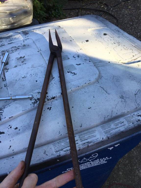

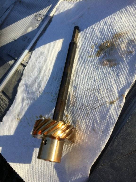

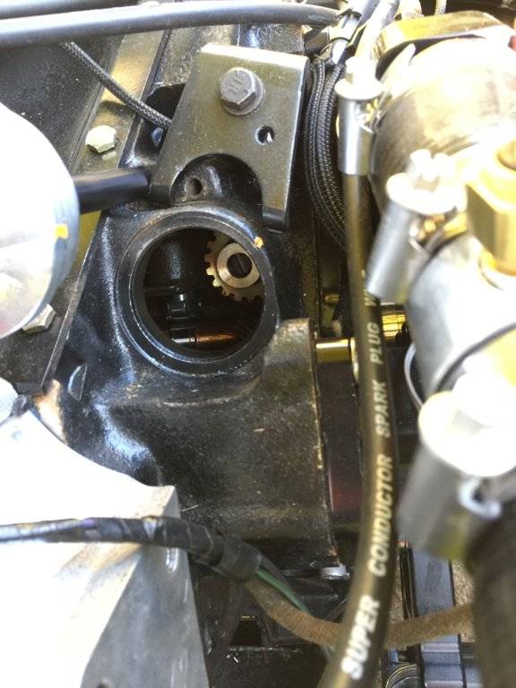

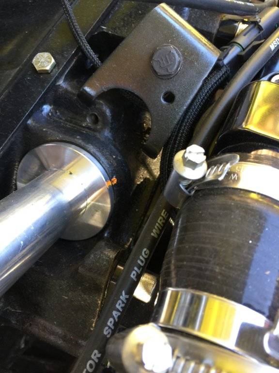

Here’s how I primed it:
I pulled the distributor, taped up some killer blacksmith tongs, reached in and plucked out the drive gear, inserted a long 5/16” octal aluminum shaft, spun it with a drill motor going CCW. Got good pressure. Re-located the distributor, routed wires, gave it a spin.
