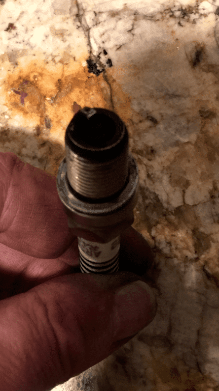

It’s probably putting too much fuel into the prime shot. I didn’t get it to start today. I pulled the plugs. They’re brand new. Honest. Two steps back.

New plugs. Some changes to the initial settings. Got it started. Warmed it up to the point where it could start to learn.

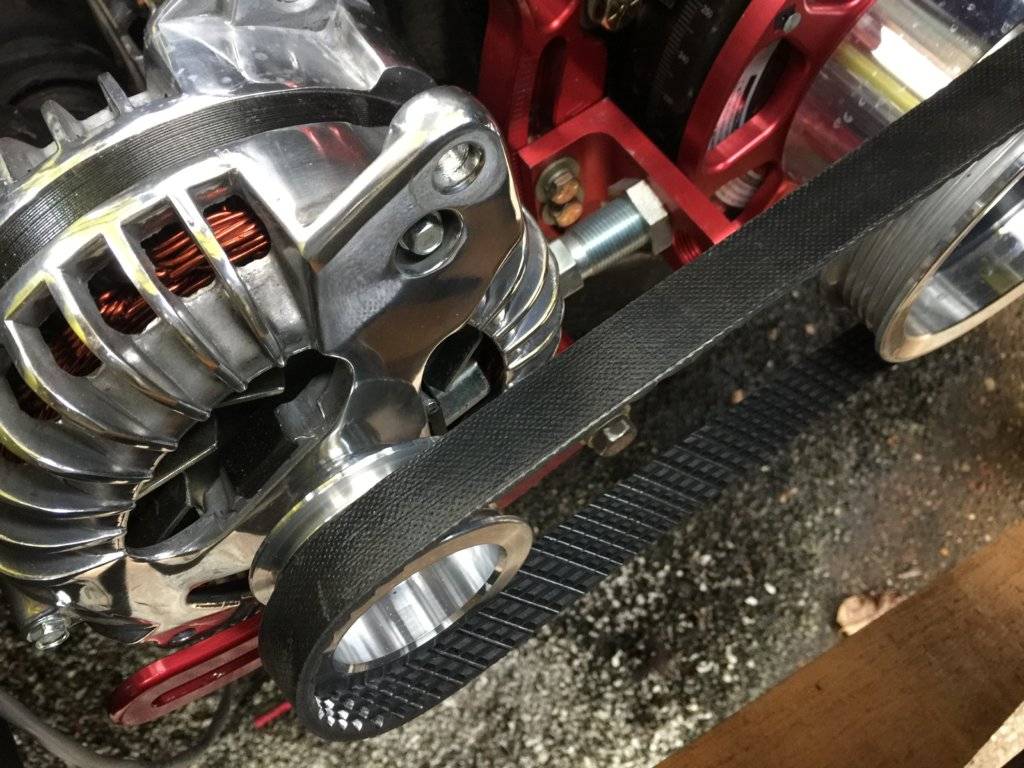

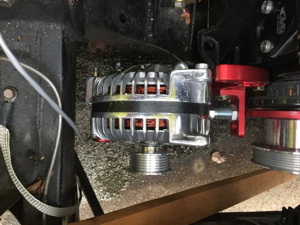

Here’s the rub:
It does fairly well clear the crank trigger.
And the pulleys line up OK.
Belt just fits. Clears the frame.
What’s the problem?

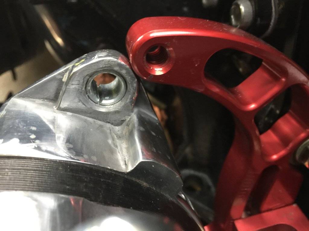

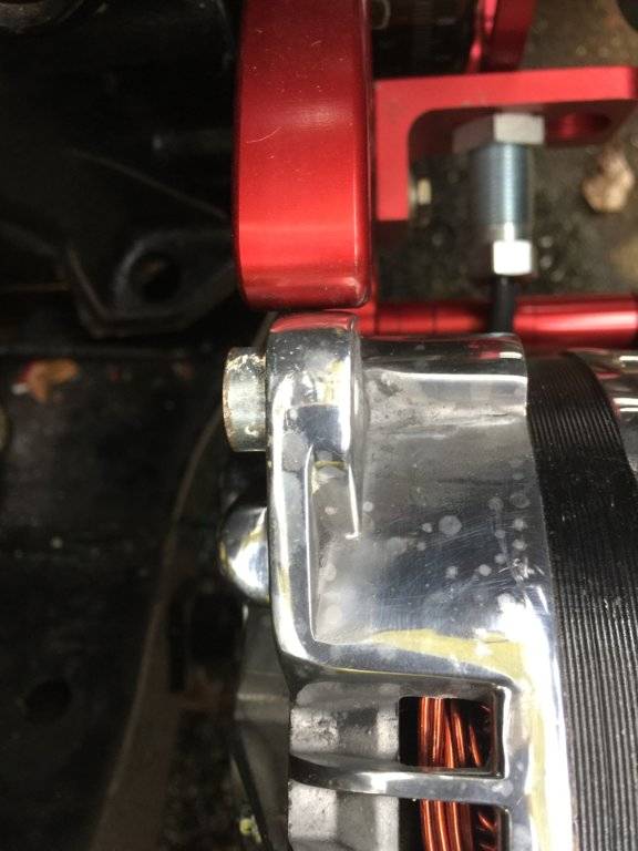

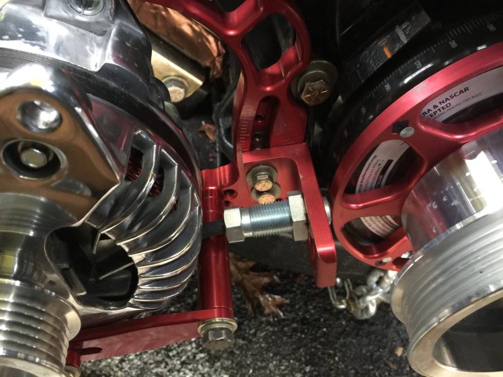

Ahhhh...
..there’s a problem alright.
I’m going to build a pair of rigid plates. One will have two 3/8-16 clearance holes. It’s going to be placed in the front of the alternator ear and mount point. The other will have two 3/8-16 threaded holes. It’s going to be behind these points. Hardened bolts (cap screws, actually) will hold these two points together until the cows come home. I may also make a third brace to keep it all referenced to the block. Attention, mr. Alternator. It’s going to be my way- or the highway. I’m just not taking any prisoners anymore.

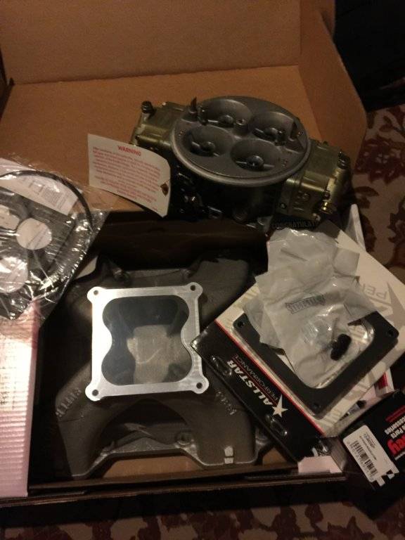

Merry Christmas, son. We’re going to need a bit more plumbing and a much, much bigger-mouthed breather/filter. The FiTech will make an awesome pump gas setup for another vehicle. This massive beast is a 1050 CFM Holley three-stage dominator. It’s actually got a stage between idle and main jets. It’s a 4500 series, so, a proper manifold is a good thing. There’s a noticeable difference in the breathability and air speed of the 4150 and the 4500 series carbs. This manifold will work the 4500 just right.
HUGE BONUS!
We’re going to initially set the carb up using an AFR meter and the very high dollar Unleaded fuel. Then, we can switch over to leaded fuel at a third of the price! Yes! It’s much, much easier to find and comes in very high octane ratings. Once tuned nicely, we’ll plug the O2 port and the carb should only take minor tweaks from there.
Kiss any dreams of streetability goodbye. It’s now very much a purpose-built beastie. It’s going to be freaking amazing. I’m downright sure of it.
