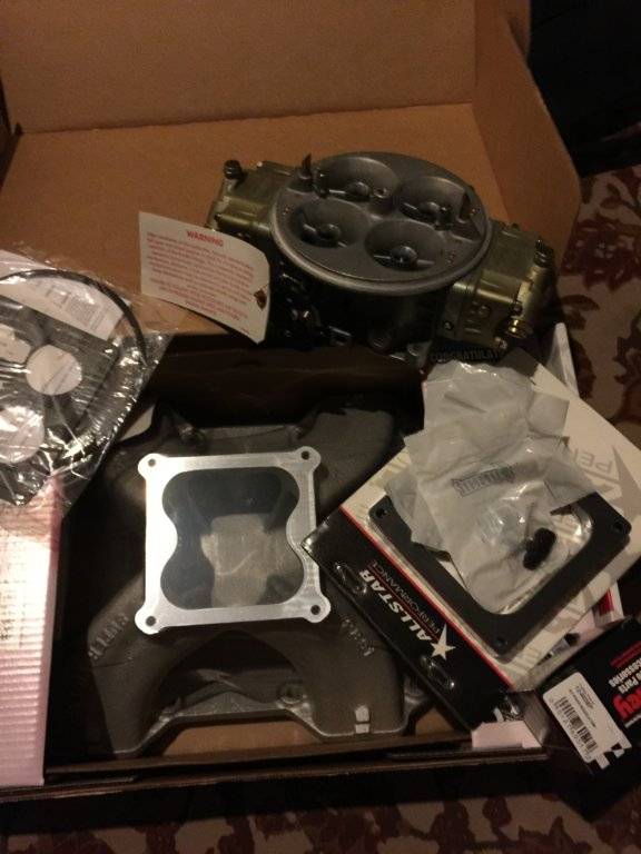

Actually, as I read more and more (and more!) about the FiTech, I came upon this little gem. The EFI-8 1200HP unit has been flow tested by afficianados and found to flow around 835-850 CFM when normally aspirated. That’s plenty enough to spin up 493 cubic inches to about 5500 RPM. There’s just one little problem. This engine was designed for a shift point of 6500 to 6800 RPM. It’s just barely starting to breath well at 5500 RPM. As well, I’m just sick and tired of washing down the cylinder walls with fuel.
So..
Merry Christmas, son. We’re going to need a bit more plumbing and a much, much bigger-mouthed breather/filter. The FiTech will make an awesome pump gas setup for another vehicle. This massive beast is a 1050 CFM Holley three-stage dominator. It’s actually got a stage between idle and main jets. It’s a 4500 series, so, a proper manifold is a good thing. There’s a noticeable difference in the breathability and air speed of the 4150 and the 4500 series carbs. This manifold will work the 4500 just right.
HUGE BONUS!
We’re going to initially set the carb up using an AFR meter and the very high dollar Unleaded fuel. Then, we can switch over to leaded fuel at a third of the price! Yes! It’s much, much easier to find and comes in very high octane ratings. Once tuned nicely, we’ll plug the O2 port and the carb should only take minor tweaks from there.
Kiss any dreams of streetability goodbye. It’s now very much a purpose-built beastie. It’s going to be freaking amazing. I’m downright sure of it.

BTW: we chose to not go with the 1150 CFM model. While it certainly may have worked well, 1050 is quite sufficient and may even help a little with torque development.

We should fire it up this weekend. Dallas now has a Summit hub, so we got the Dominator there. It is my understanding that the 3 circuit carb is a better design (for racing, we have the tech to tune it, however. -dad) in general, but i will check with my dad for his opinion.

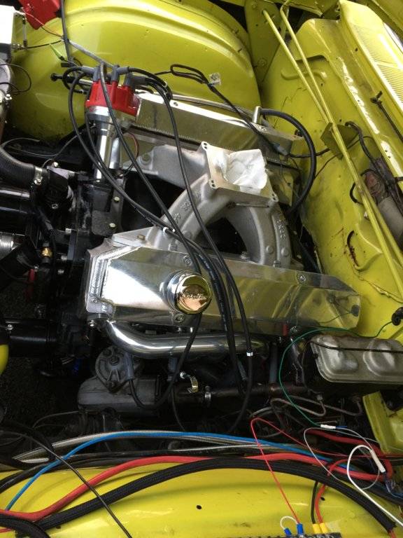

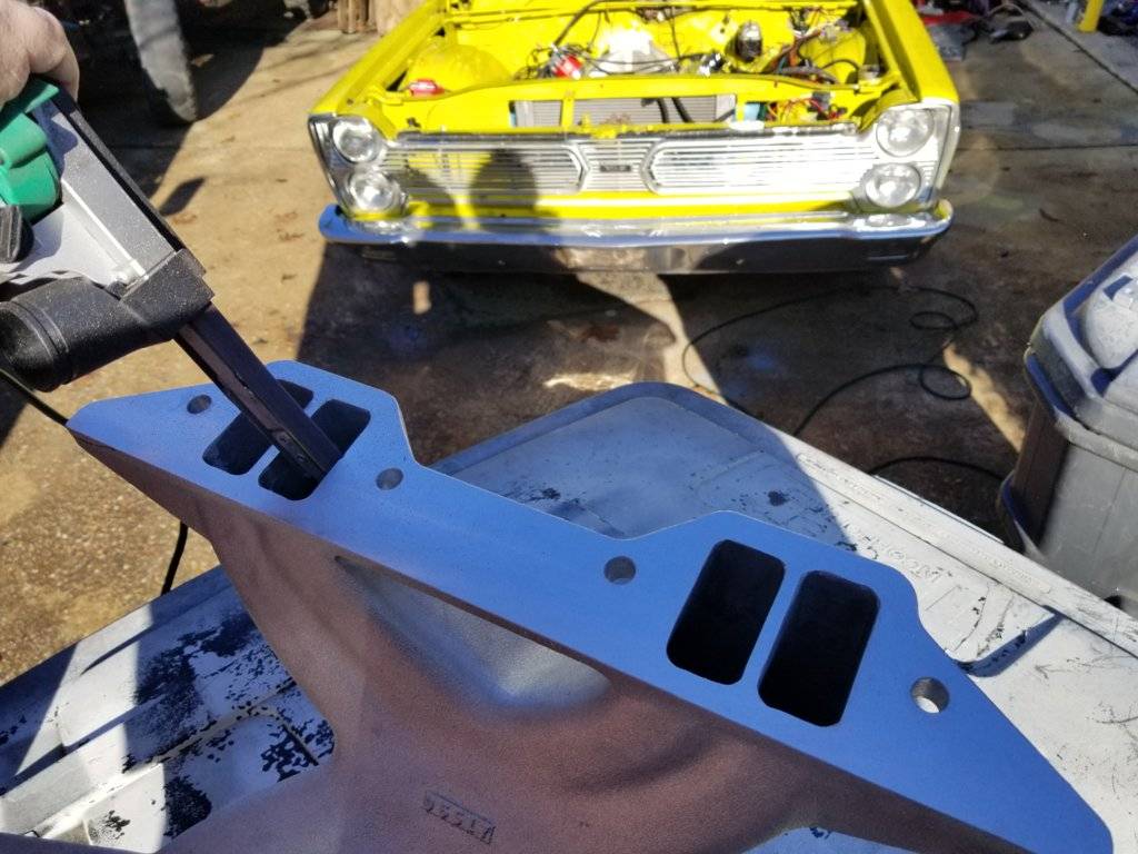

Gasket matching new intake:

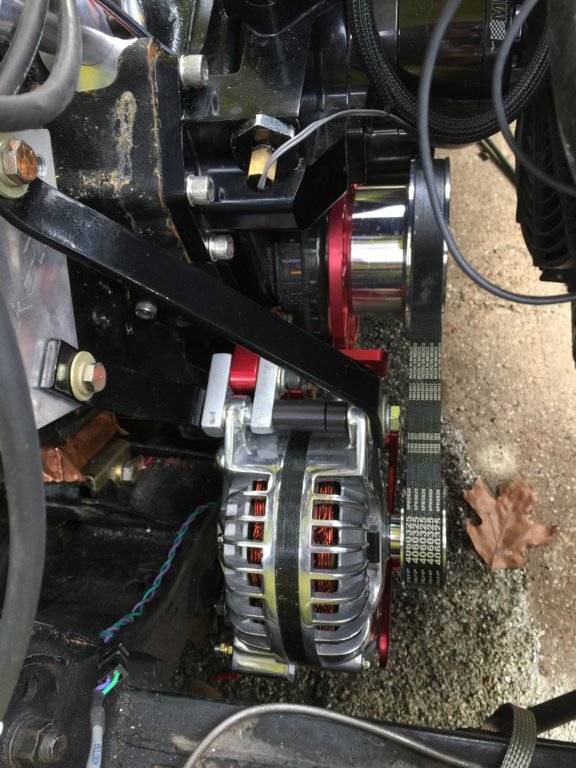

Alternator mount. Strong..
..like bull!
We need to re-wire the fuel pump, flush the fuel lines, wire the alternator and it should be ready for a start. The oil got trashed by the FiTech’s propensity for fuel dumpage. It’s going to be changed. Transmission fluid checks, fuel cell straps, brake check & bleed, and some street tires. Then a test drive or two and it’s exhaust system time. We’re making some real progress now.
- dad

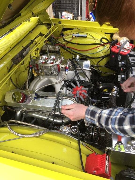

Dylan's home for Christmas? Or did you get younger in the second pic:poke:. Isn't it great to have a second set of hands to help do something on the car.

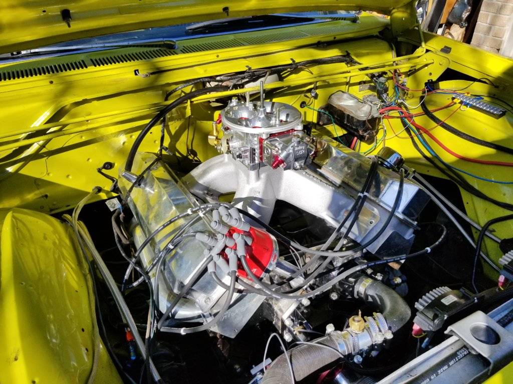

I'd love to live in your neighborhood, hear that fire up, and I'd be like a kid that heard the ice cream truck!
Look great!!
Did you notice how far back the motor is set on these cars? My valve cover almost hits the seam on the firewall.
What is on your hood scoop? Is it a hood support that goes on your carb stud kinda thingy?
Nice work on the alternator.That car is a beast!

It's just a spacer between the scoop and hood for support.
I noticed the engine spacing. Especially after taking the damn thing out four times. The bell housing bolts are a real pain! :)
I've done my Polara four times also! I remove the trans mount and lower the tailshaft to access the bolts, and as long as I have the column shifter, all that linkage too. Yeah, it can suck! And I'm going to do it all over again!
