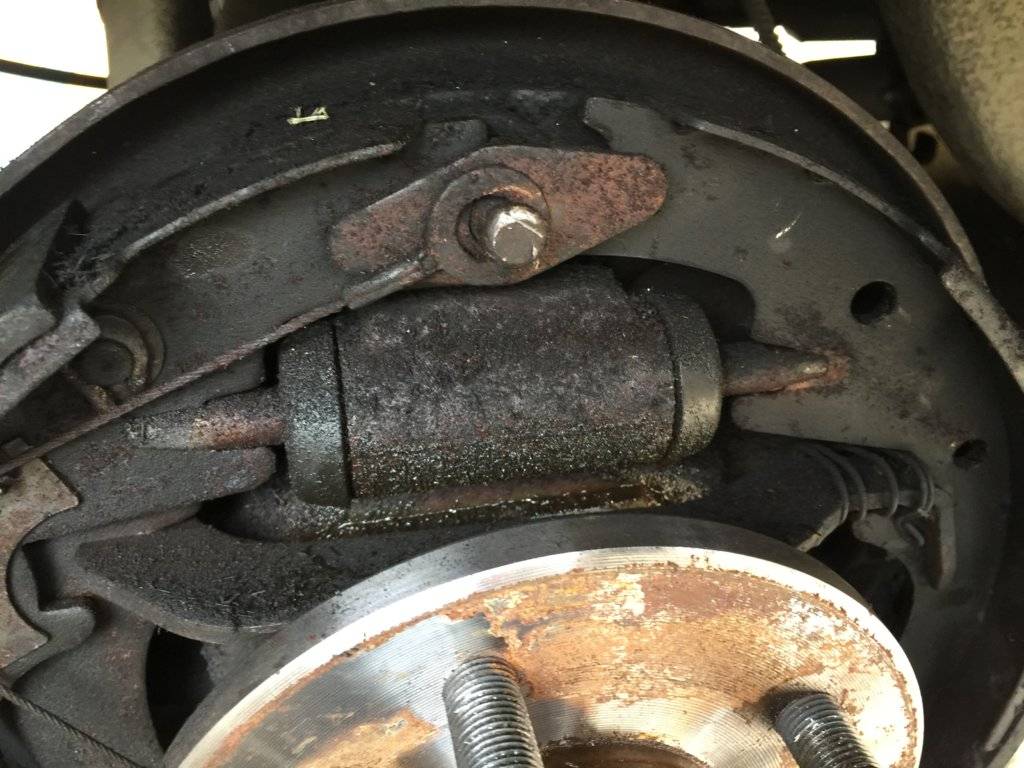

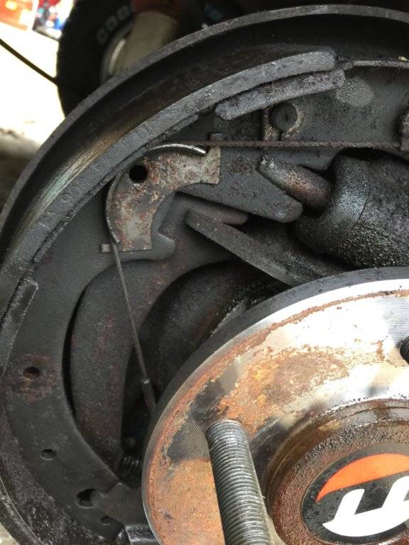

11x2” brakes.

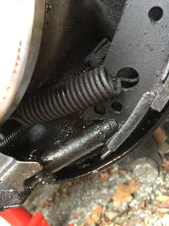

Right rear wheel cylinder leaked brake fluid and it ate the rubber of a brand new drag radial. Sigh..
It took a few hours of investigation to piece the needed parts together from parts intended for various other cars. We’ll know in an hour or two if I’ve actually managed to pull a rabbit out of the hat. As for the destruction of the drag radial, we’ve already gotten new wheels and street tires for a bit of break-in driving. It was while putting them on that I found the real source of the brake leak. If you were following along earlier, you may have noticed that I falsely believed that I had found “the” leak at the proportioning valve. Fixing it was “one step forward..”

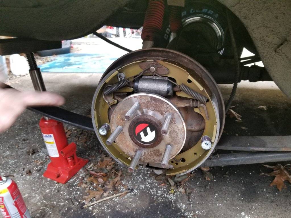

We wound up re-using the bulk of the hardware, but (and it’s a really big but), the drums and shoes are brand spanking new!! The general consensus was that 11x2” brake parts are virtually unobtainable. I found them in stock at Summit and we were able to pick them up last night. Yeah!

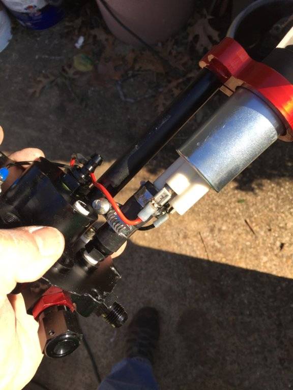

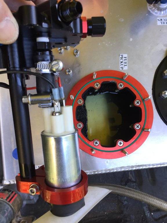

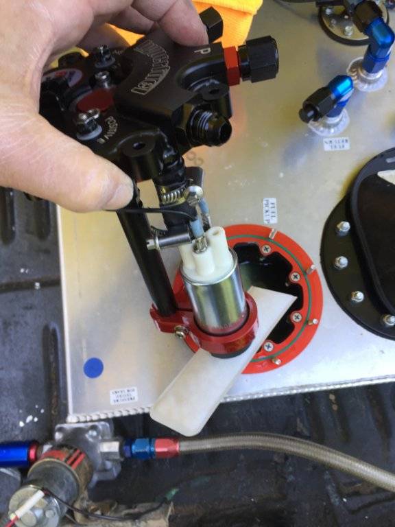

Remember this? The FiTech pump was overrunning the little Holley pressure regulator. New fuel pump, max 15 PSI. It’s now regulating to 6.5 Lbs. Just what a Holley wants. It’s a Walbro 5CA401-1 with an added pre-filter.
The hose clamps had to be changed from what came with the pump and positioned magically to mitigate interference with the red mounting ring on the fuel cell. I also had to use a different port from the original one because the new pump has an outlet tube that is just a little further out from the center. I moved the hose connector in the fuel manifold body and it fit like a champ.

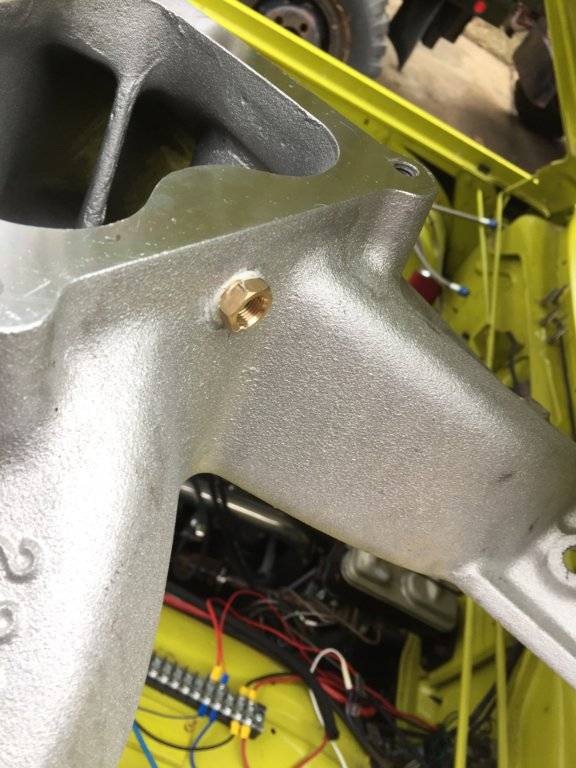

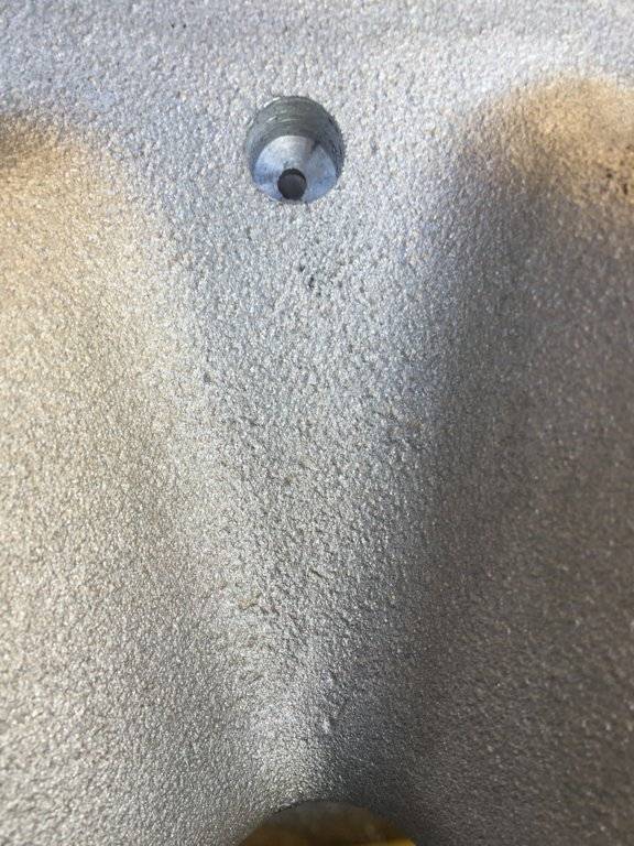

There’s always time to take an opportunity. Drill/tap time. You all have a 1/2-18 NPT tap, don’t you? Did I mention that I have a tool habit?
“Why the hole?” you ask..

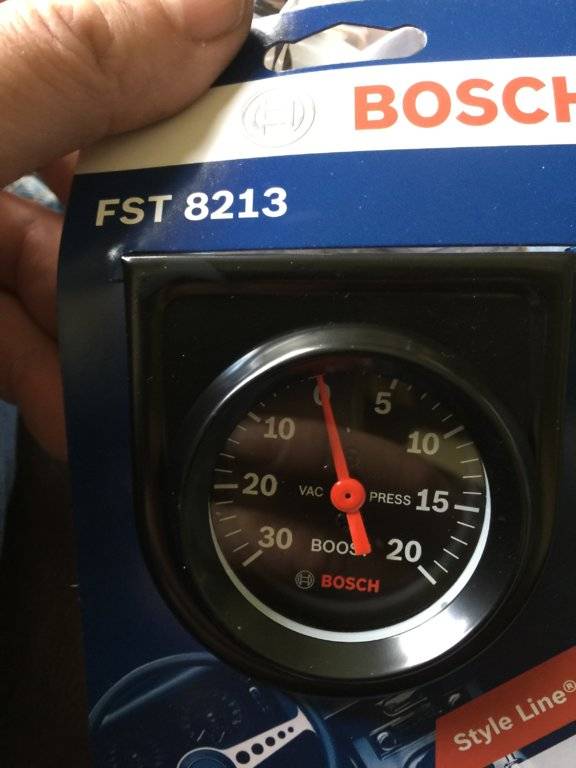

Vacuum gauge is going in. It’s cheaper with the boost option. Bosch makes a fair gauge for a fair price.

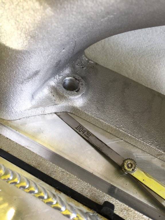

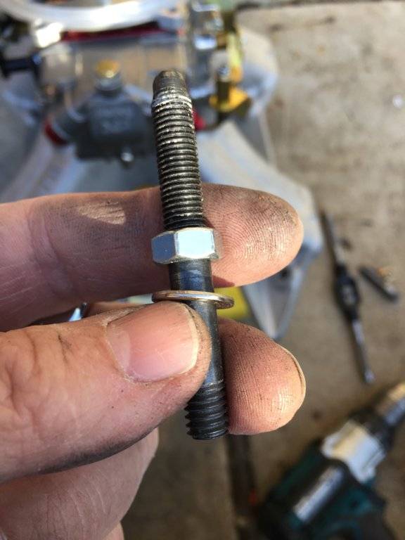

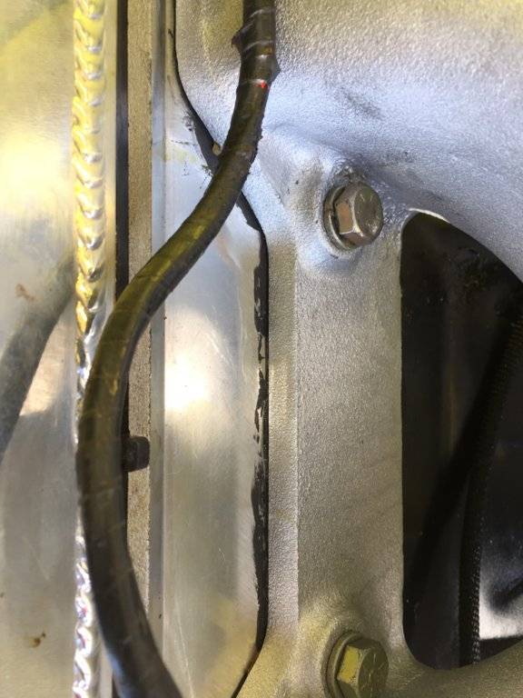

Here’s the core problem behind the intake leak:
This one spot has 0.004” clearance. The rest of the intake is nicely on the heads. I don’t have a machine shop handy to cut it properly. So, it’s getting a new valley pan and some gaskets.

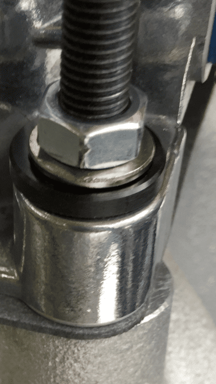

BTW: The carb studs were just a hair too long. It needs washers or spacers under the nuts.
See? The nut’s stuck in place on the last thread.

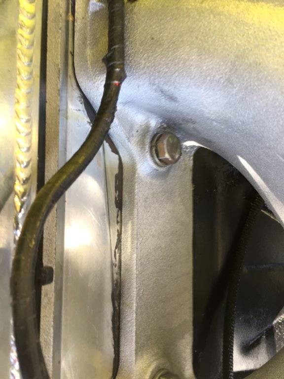

Here’s where the vacuum fitting is going.

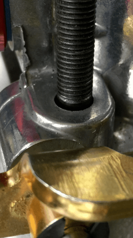

Here’s the stud peeking out above the carburetor flange.
Here’s the solution for stud thread engagement limitation.
