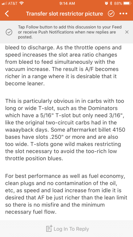

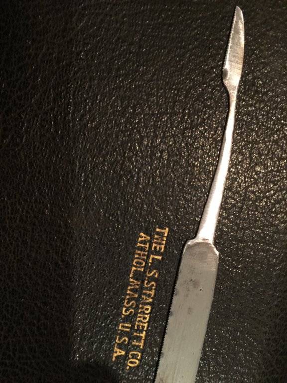

This is a modified hacksaw blade. It’s now just barely .002” thinner than the idle transfer slots. From posts on carburetor forums, it’s looking like Holley often cuts them a little short and occasionally a little long. This is particularly seen in the 4500 series carbs. The carburetor that we bought has noticeably short slots. I’m going to try to fix that next time I have it off the engine.

I’ve purchased two-circuit metering blocks for the carburetor. The two-circuit system will let the car see some street use for engine seasoning. I’m going to modify them for lowered idle channel metering and emulsion bleed setup before I even put them on the carburetor. It’s been a long time since I’ve made significant carburetor mods. I’m having a ball with this new internet stuff. I used to have to do all of this from scratch. I’ve bought myself an Innovate Systems LM-2 data logger with two O2 sensors. I’ve gotten a TPS and mounted it on the carb. I’m adding a MAP sensor and I’ll break out my old analog output accelerometer. There’s now a wealth of information at my fingertips.

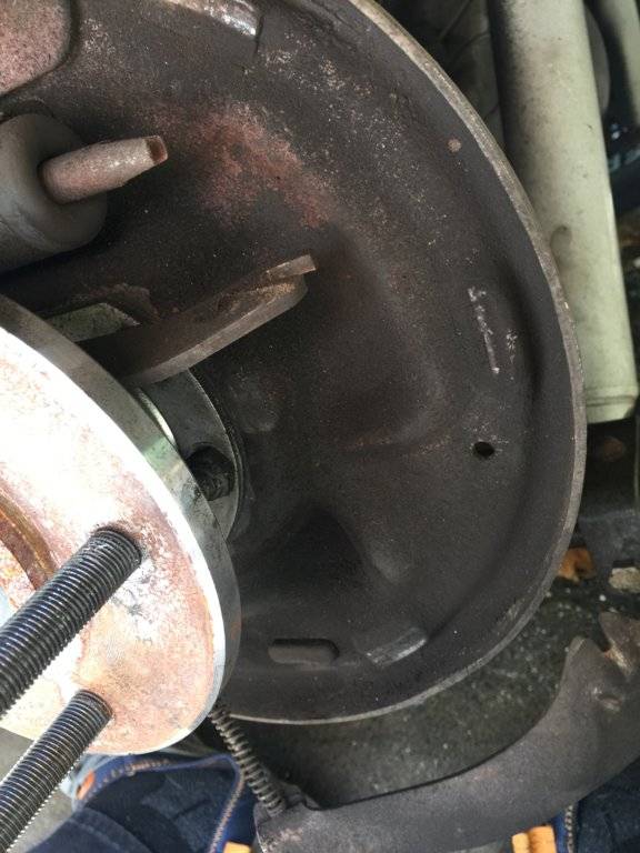

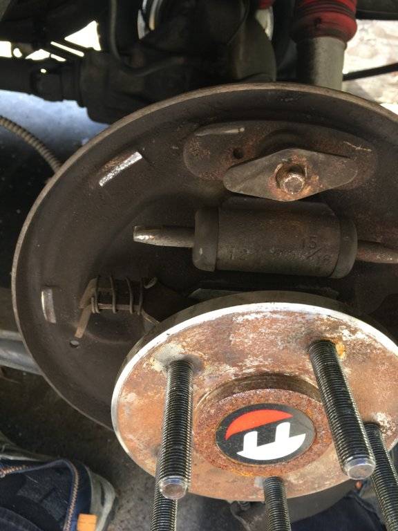

Dylan - see these bright spots? Except for the one on the wheel cylinder pushrod (I’ll investigate what made that one!), they’re relatively normal. This is where I will put a thin film of (“disc” brake) silicone grease. Not much, just enough. It’s going wherever there is metal/metal motion. This includes the pushrod slots, the spring contact points, wherever metal moves against metal. Remember, use just a thin film. It’s also very important that I don’t contaminate the friction surfaces with any amount. Gloves and moderation are key.
- dad
Wheel cylinders:
Place catch pan remove bleeder so that you can get wrench space for line wrench. Note: I often crack bleeders if I’m having a tight fit when trying to pull the drum.
Loosen line fitting. Remove wheel cylinder mounting screws. Remove line fitting, protect the line from contamination with a plastic bag and bag tie or similar means. Remove wheel cylinder. Get new cylinder and use red rubber grease (castor oil grease from Castrol is magical) on rubber boots for years of dry rot-free protection. Put rods in boots, start line fitting. Bolt wheel cylinder in place and tighten line fitting with line wrench. Install new bleeder.
Works for me and protects line fitting and line from damage due to trying to fit line with wheel cylinder stitched down tight.
- dad
