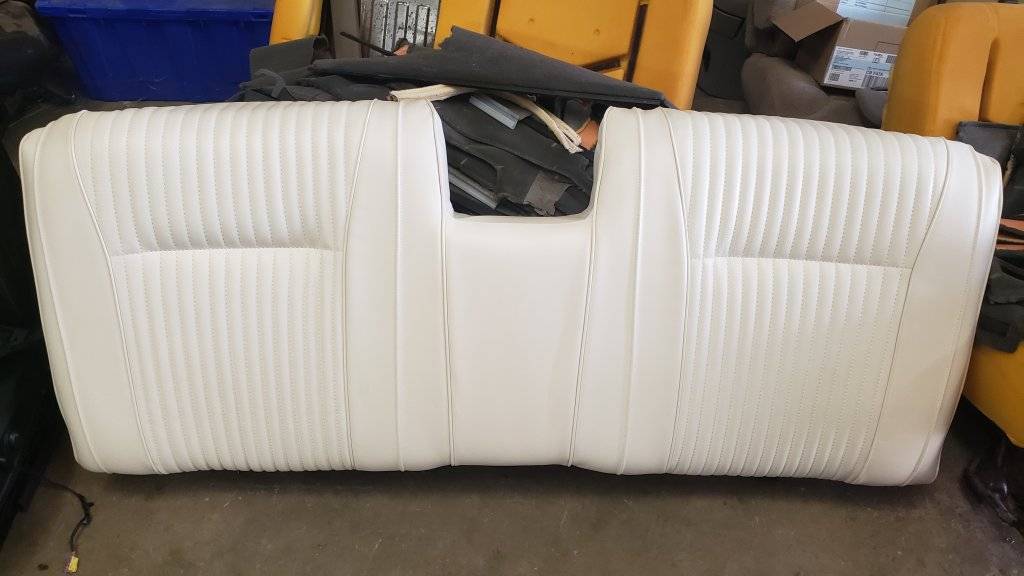

The front and back seat in my 300L didn't match. I think the front seats had been recovered some considerable time before the back seat. Either the front was wrong to begin with or the front seat had yellowed with age. Either way, once you saw it, you couldn't unsee it.
They are pretty close now. Front seat was painted and the rear seat wasn't.

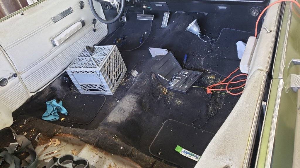

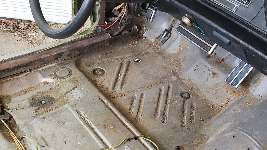

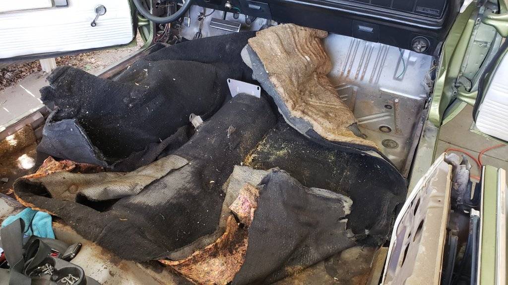

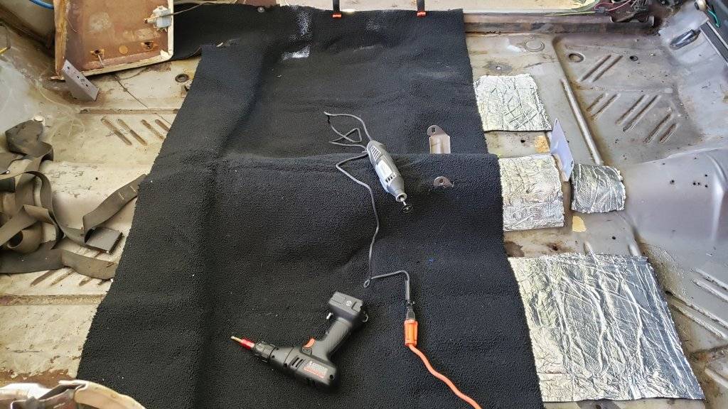

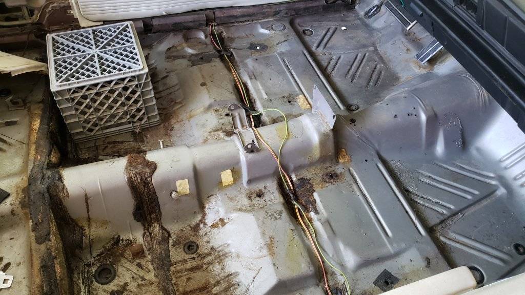

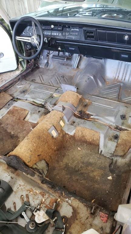

I removed my seats in June to have them redone by a man here in Fresno. So, this past week, I finally started on the carpet removal.
First I replaced my HVAC control; unfortunately, to no avail, it still doesn't work.
But, the carpet is all out, and the lack of rust blessed my soul!
You can see in the fourth picture I had a missing body plug. There was another gone from the rear section too. I replaced those today. Tomorrow, I will, hopefully, start putting in the deadening pad and then the carpet.

Use an old soldering iron to make holes for seat belts and seats.

Finally got my interior done in the 300L. This has been a bit of a struggle for me... It seemed like everything that I touched needed much more than I figured on. I'd say I have 2 or 3 times more time in it than I figured.
The whole process kind of started last year with replacing the foam in the rear seat bottom and then got going again this summer. I replaced the foam in the bottoms of the front seats, new carpet, rebuilt the door panels with new board and painted, repainted the package tray and fixed the clips along with adding a new felt piece under it, the console got new carpet trim, repainted the plastic and fiberboard side pieces for the rear seat, and dyed the faded front seats to match the rear.
