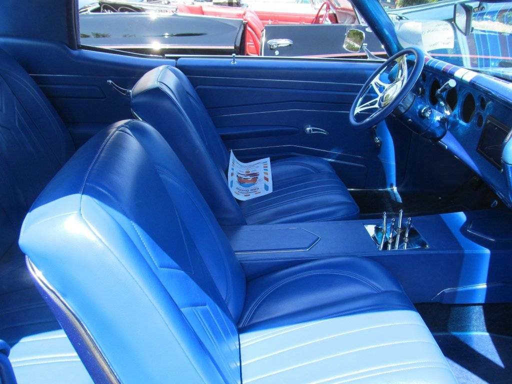

Here's the Monte I saw his work on:

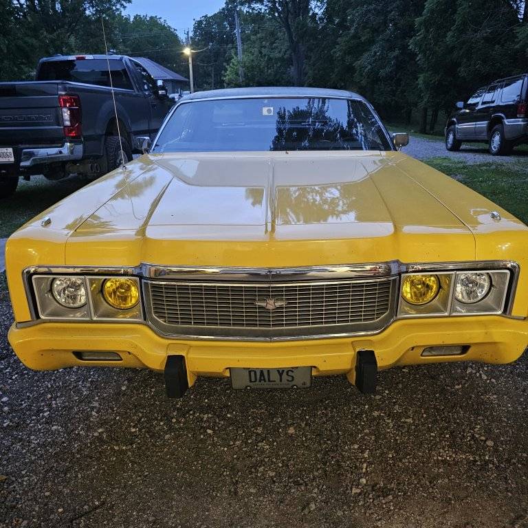

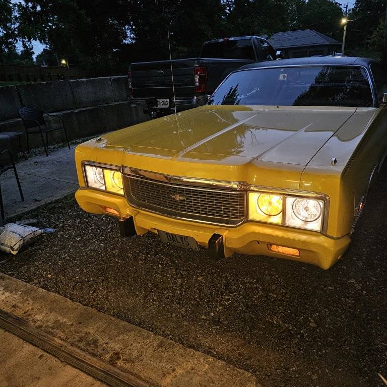

Found a set of Octane Lighting headlights I had ordered a long time ago for my old 69 Coronet. So I put them in the Newport. The car was due for some new headlights as the old ones wouldn't aim for **** and two still had yellow over spray on them from when the car was painted 15-20 years ago.
I'm not 100% sold on the yellow highbeams, but they do perform better then what was in there and the all aim and display properly now.
Not sure the car needed more yellow, lol.

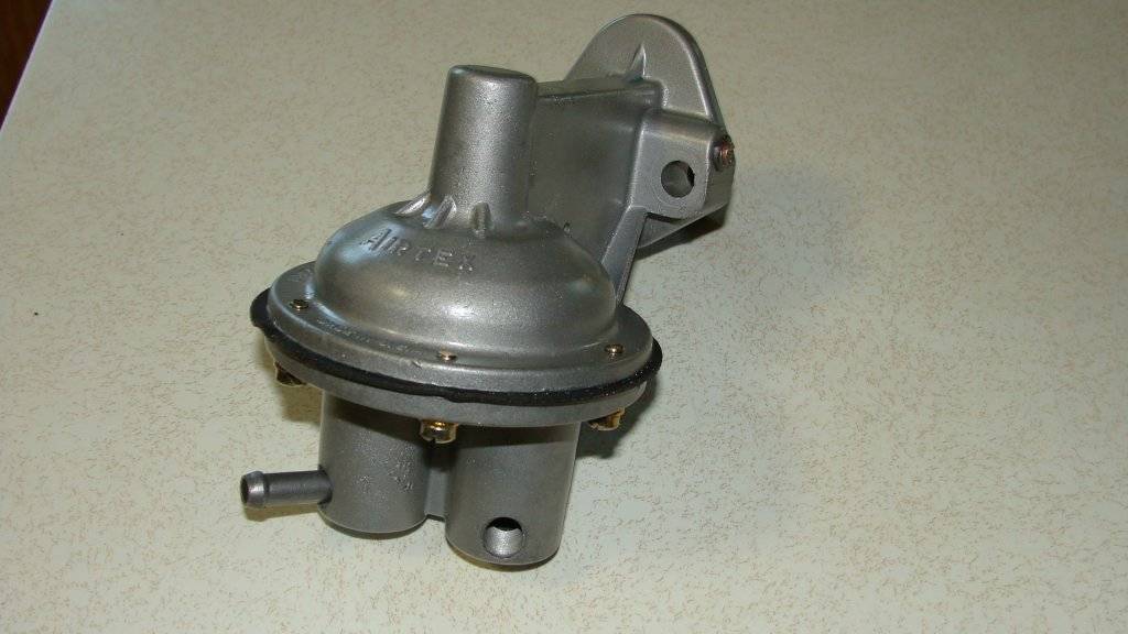

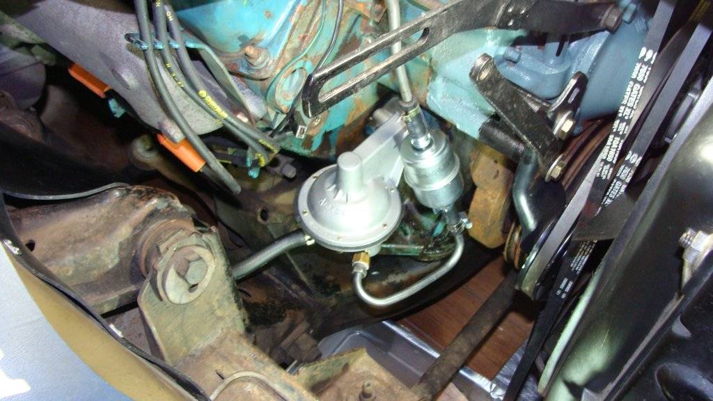

I have the TNT engine and fuel pump was original, sent it out and had it restored, "Then and Now" did a fantastic job $115. Don't be in a hurry.

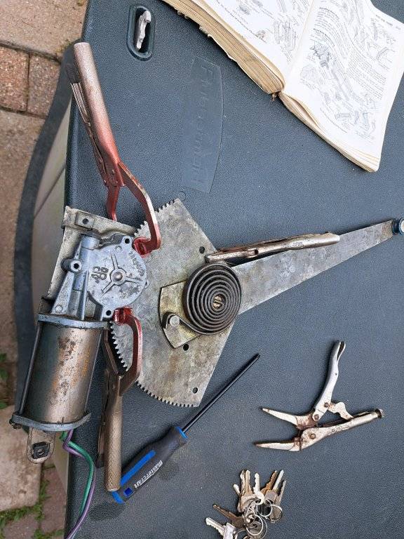

Garage is still a month away from being finished.
So in the meantime I had to replace Grace's drivers power window motor in the shade in the driveway.
No bench vise either...just a bunch of vise grips to clamp her down..
Went for a rip afterwards-- with the windows down!

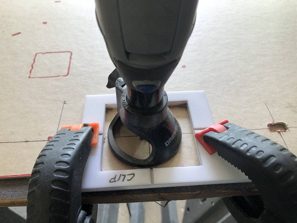

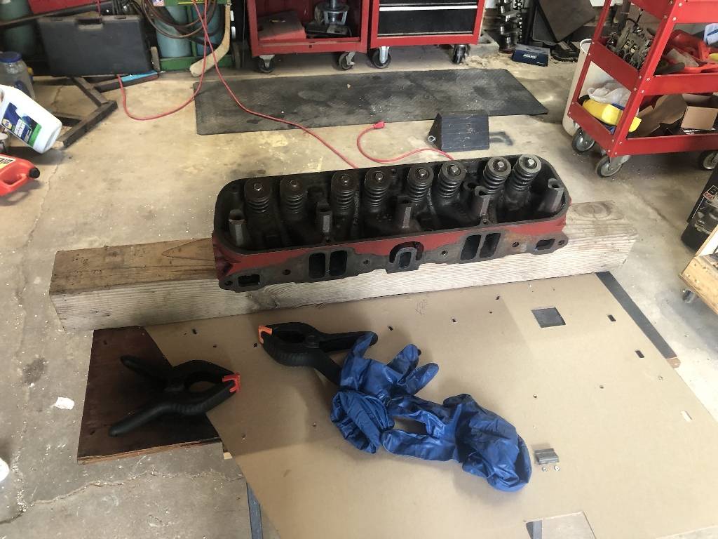

I took a needed day off today, so I didn't do much. I've been working on my 300L door panels, trying to get them back in shape. It started with wanting to paint them to freshen them up since the white really needs it.
When I took the panels off, I was annoyed to find the plastic rain shield had been left off the front doors and while there was plastic behind the rear panels, it hadn't been tucked in and that held water against the cardboard. Sigh.
So, having done it once before (I have a thread on it) with my '70 300, I took on the task. I'm trying to use what I learned the last time... A slightly different method to glue the metal upper panel on using construction adhesive, and I'm using a Dremel with a router base and a 3D printed template to cut the slots.
Today I cut the last front door panel and marked it for thee slots and holes. Rears are almost done. Not as much as I wanted to get done, but it was something.
I'll add this to my other thread once done.

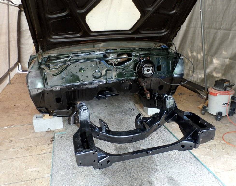

Today I put the steering gear in, but this was yesterday:
Firewall and underside cleaned up, lower part painted (brush) with some really good black stuff that really sticks and is tough. Upper part shot out of a can, 2k epoxy primer, base then 2k clear. Just gotta find some place to press in the lower control arm stuff and this should come together pretty fast.

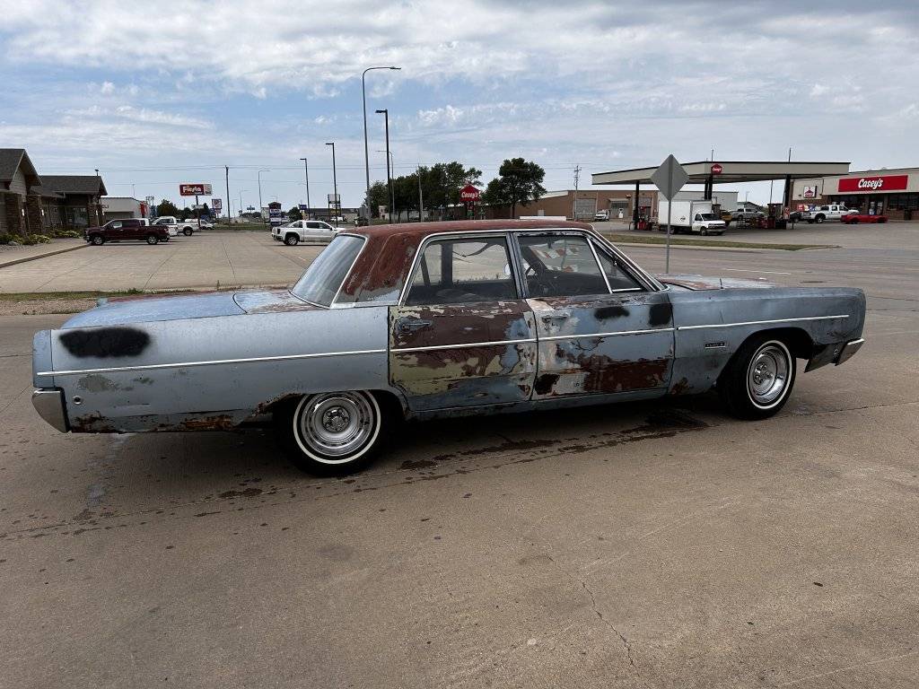

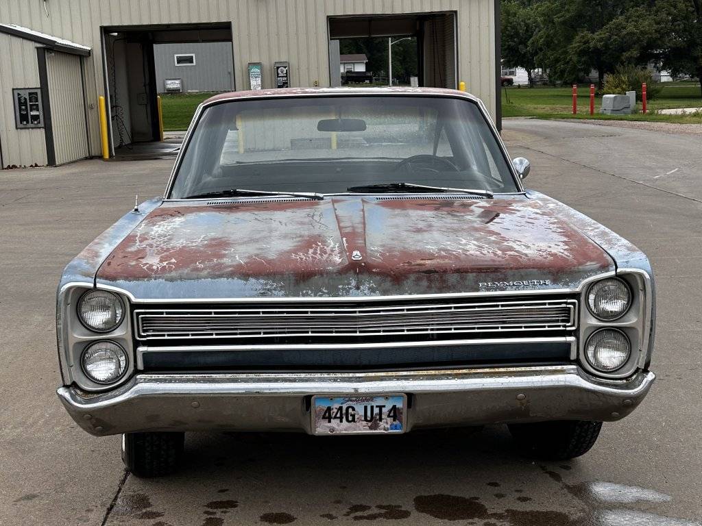

Verified that I incorrectly installed the park rod in Elwood, my 68 Fury II 4 door sedan. Drained the pan after receiving confirmation that I need to drop the valve body.

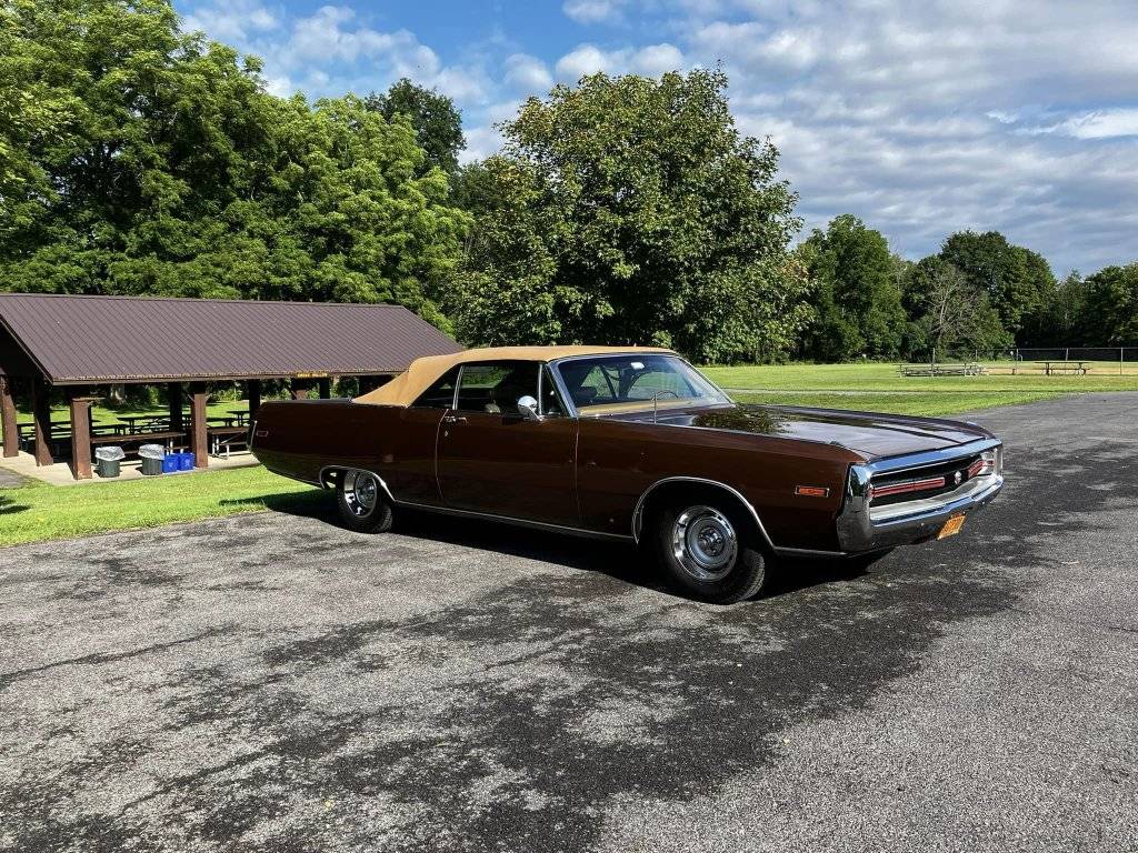

After a week of moving my mother inlaw into her new digs in the senior apartment, I managed to get out to the "Cars and Coffee" yesterday that they hold in our local park. Not a big turnout as there were two car shows going on not too far away, but as always, it was a nice time.
