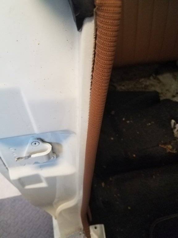

Windlace is in....

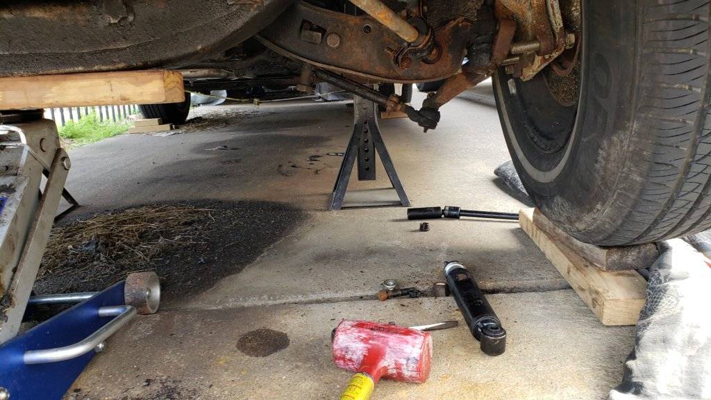

took apart the whole front end just to make the shocks have enough room to come out
putting in those KYBs. man they were a sonofabitch to fit.

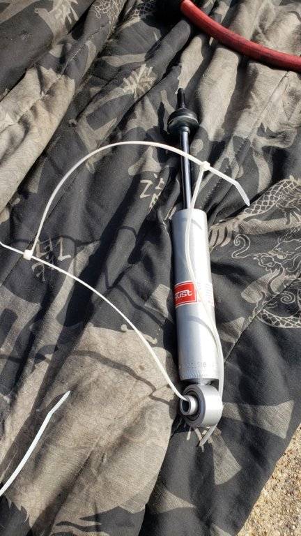

here is one about to be zipped down compressed. i forgot to take a pic of a zipped one.
Yeah, I struggled with the first one I put in, the second fell into place after zip tying it!
And here I thought it was just me, I put KYB’s on my 77 last summer, one went in with no problem, the second one was an SOB, like you guys I had a zip tie, curse a lot and it finally went in. What the heck?
