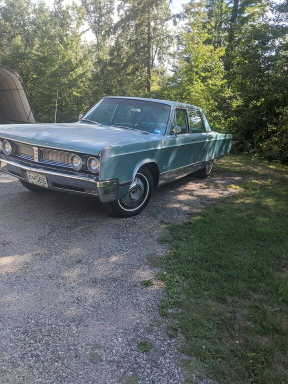

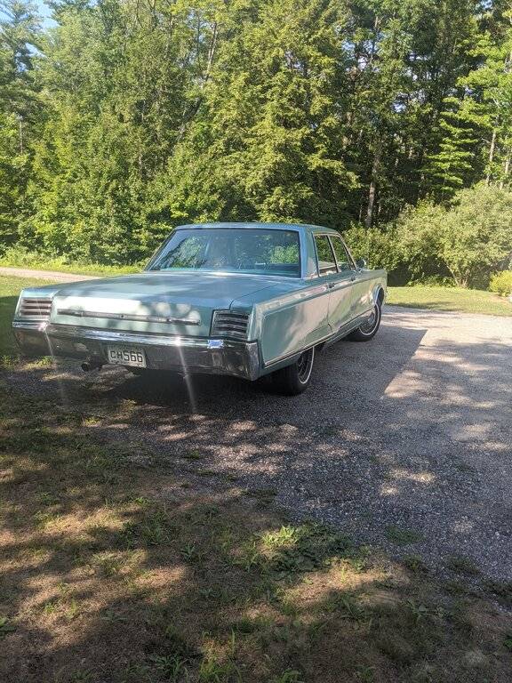

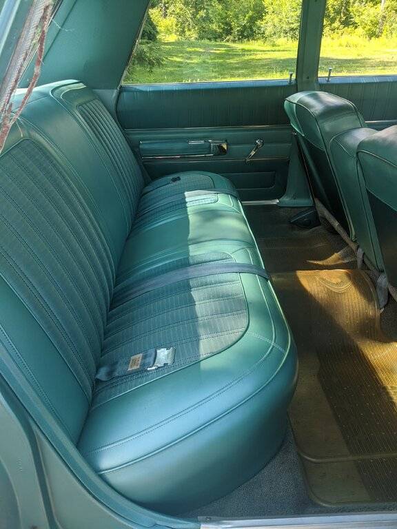

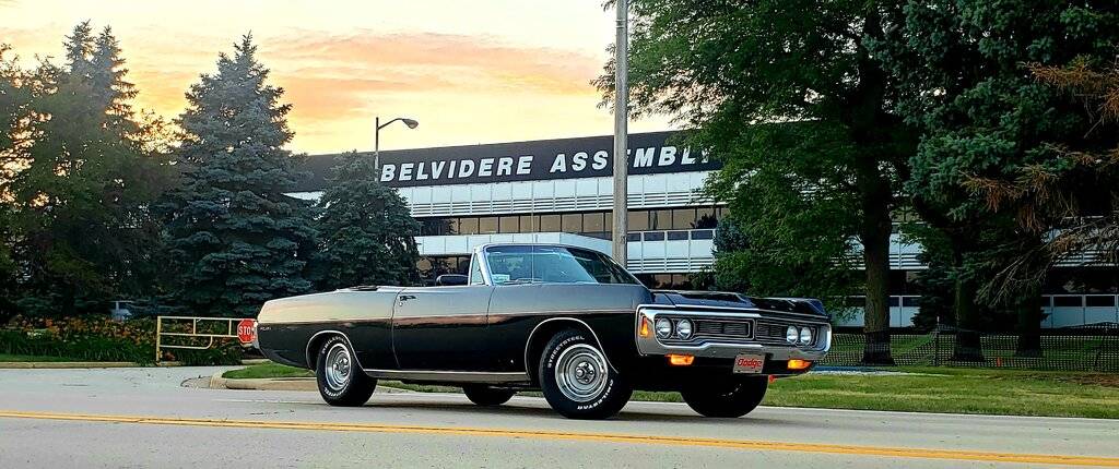

You want me to show off my car?? Absolutely! This is my fourth 67, although the others I had 35+ years ago. As you can see, the paint is shot, owner #2 left it sitting outside. I'm planning on switching to front disc brakes, so I changed over to 15 inch wheels. Factory options include A/C, right side mirror and am/fm. Great cars, all of themView attachment 387212 View attachment 387214 View attachment 387215
This is one of my favorite colors for these cars.

That paint is nicer than anything I have! Nice car.

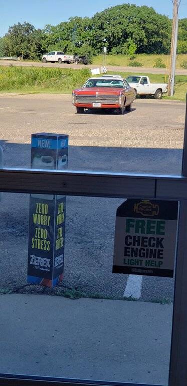

Send Ginger to the alignment shop this afternoon after replacing upper/ lower ball joints, upper control arm bushings inner / outer tie rods and sleeves Pitman and idler arm. I’ll do Lower ball joints and control arm bushings later.
I’ll pick it up tomorrow morning.

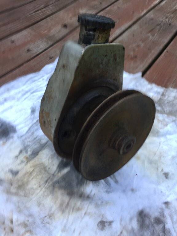

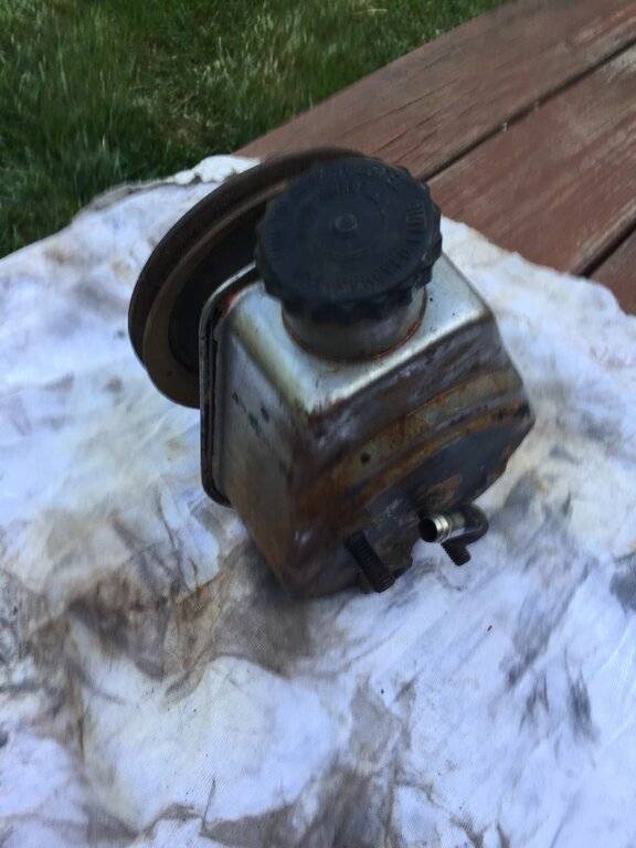

Since I had a little extra free time I wanted to clean up the power steering pump I got from Murray.. The one that’s on the car now has a heavy wine to it, so I thought it easier to replace then rebuild.
Question, what is a good paint to use on this pump? I know it’s tough to find a paint that can withstand Power Steering fluid but what say you?

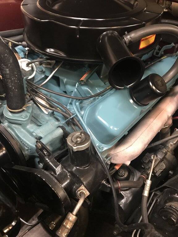

I used the Eastwood underhood semi gloss black. It is a fairly low build paint that looks close to the original parts that may have been dipped. It does scratch easily similar to the original. I hav also used dupli-color semi gloss engine paint. It’s not too thick if you are careful. Air cleaner is Duplicolor. PS pump is Eastwood.

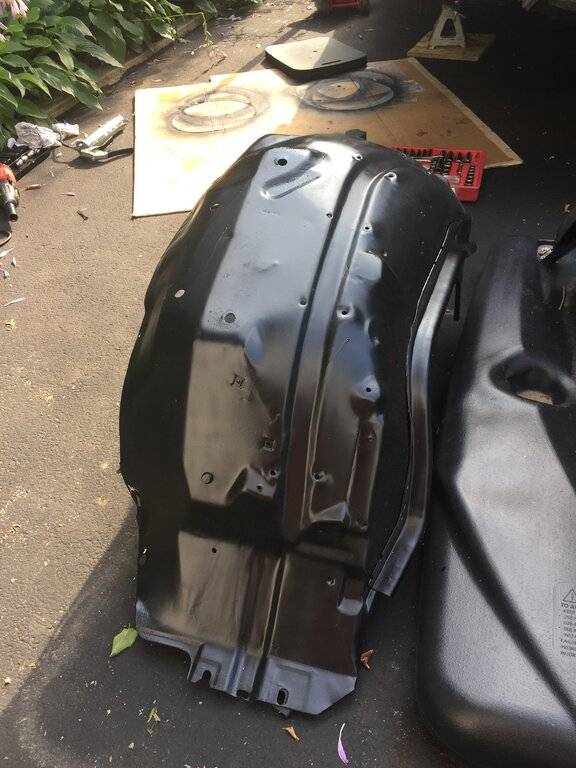

Pick up Ginger from the alignment shop this morning, took her for a spin and she tracks straight and true, look Ma! no hands. Since I’m at a bit of a stalemate with the transmission. I decided to do a little freshening up on the front suspension. Installed some new bump stops top and bottom on the control arm, aftermarket ones as you can tell.. The lower bump stop rubber were completely missing and the upper was trash, as expected. After all that I started tackling the passenger side inner fender well that I had taken out earlier in the year to install the refreshed power antenna.

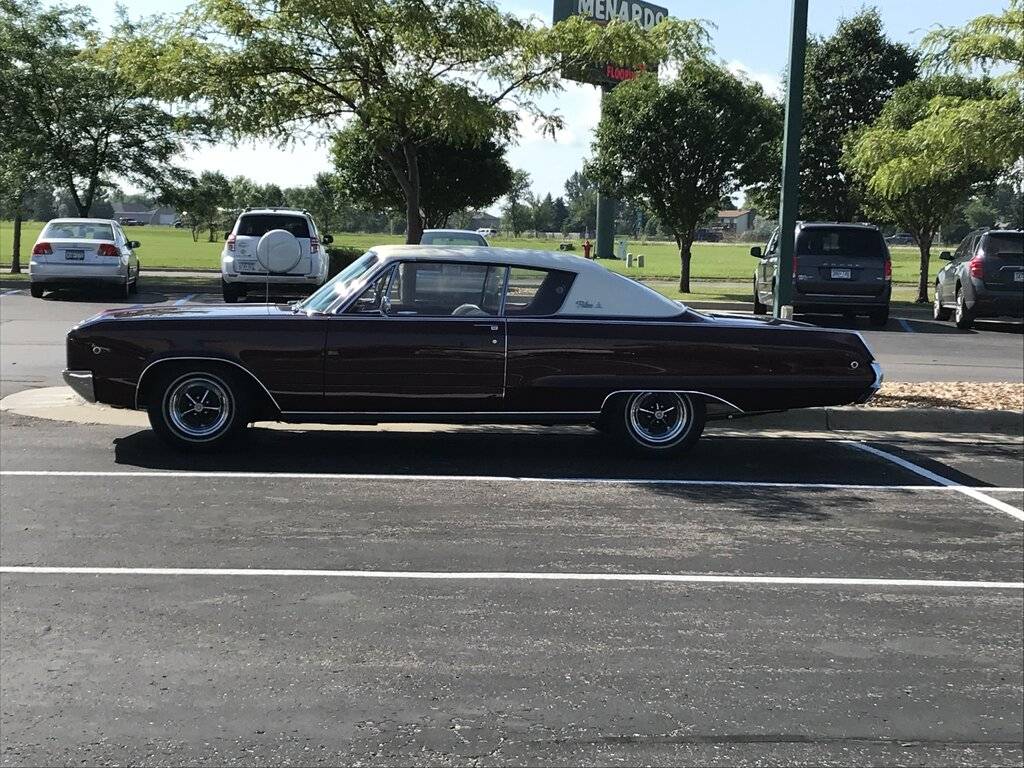

Drove it to Menards and Fleet Farm today. Took a picture of the stance with just under a 1/2 tank of fuel and full fuel. I also have about 50 lbs of tools and road supplies (oils, antifreeze, carb cleaner, brake cleaner...) in the trunk.
3/8 full
Full

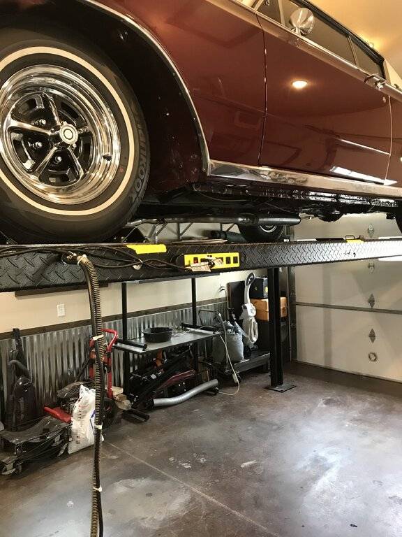

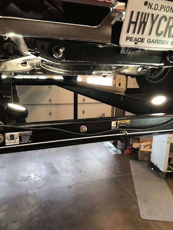

Added power to my lift to keep from crushing my extension cords under my lift. Put one on each side to power my work lights. I can’t keep batteries in battery powered lights. I found that a light on each side gets rid of the shadows. I wanted to permanent mount some lights on the inside rails, but doesn’t work real well with the moving jack and drip trays. Also this winter I may put my work bench under the lift and is a good source for power.
