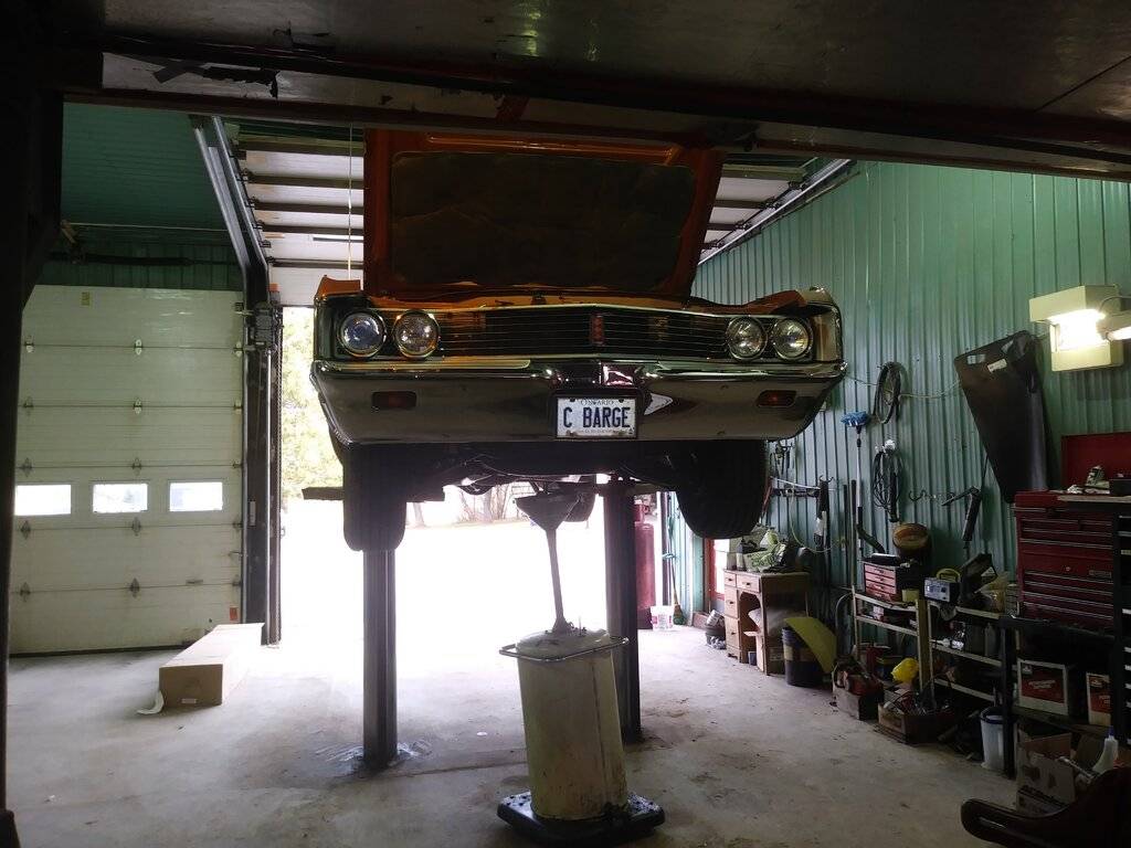

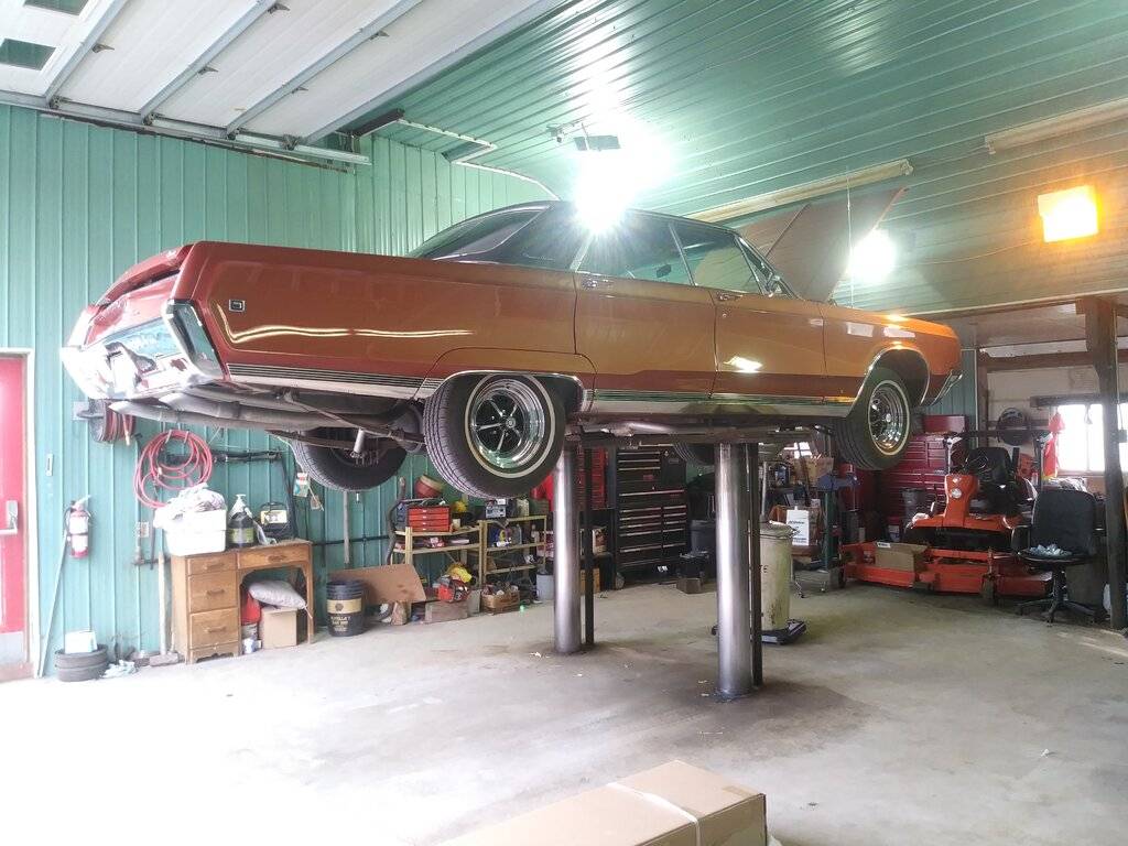

Out with the old and in with the new motor oil and filter. Tire rotation, adjusted front wheel bearings and drum brakes.
Yes the vintage in ground 2 post hoist works just fine..old school!

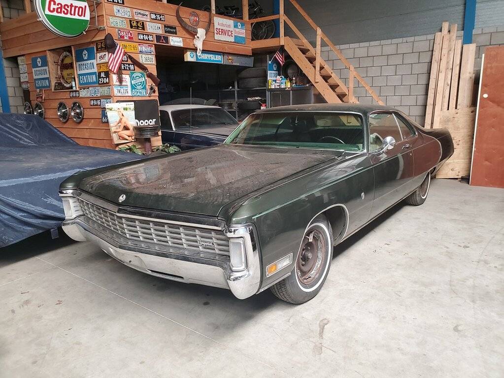

Wow, nice score, congratulation on your new ride. Do you know some history, i.e. how long it's in Europe?
If i,m correct it,s here for 2-3 years , it was bought and put in the barn when it came here , the owner does have a lot of cars , it was never driven here , still have to fix a few things , leaking exhaust manifold ......and a few other , put the new carpet in today....and it need a good cleaning .
There was a new carpet in the trunk but the old was allready out , i don,t think its the correct carpet because there,s no hump for the seatbelt cover....??!!

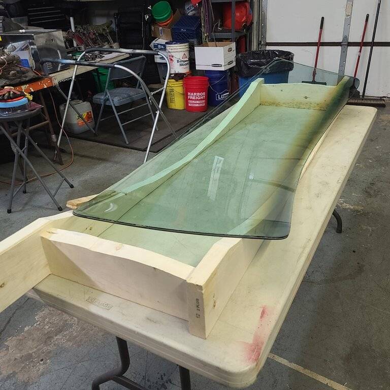

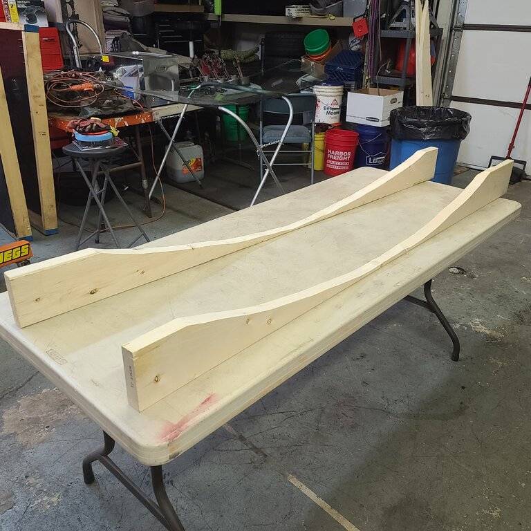

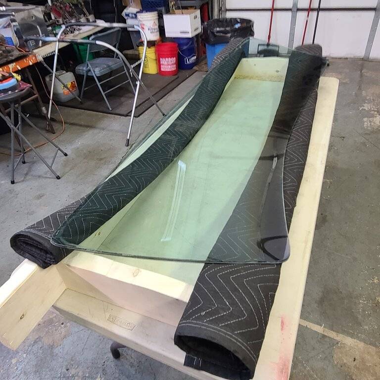

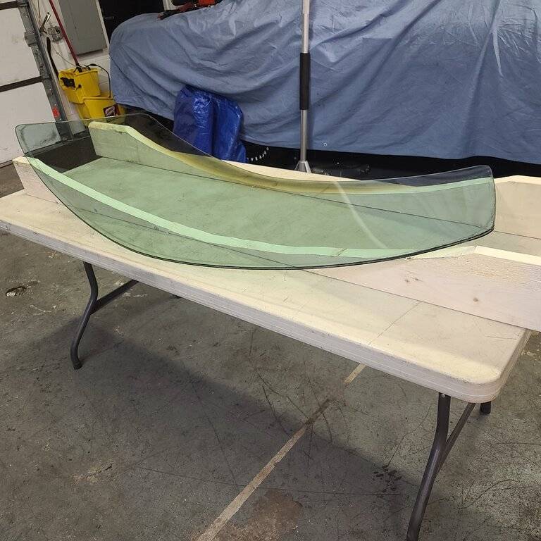

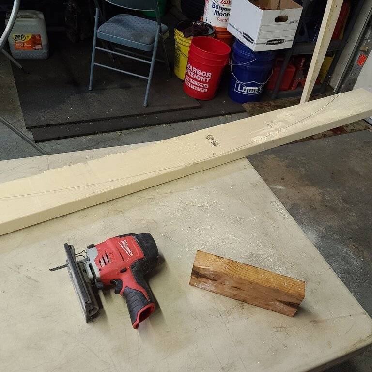

Made this jig out of 2x6's to support the windshield that will be used to replace the damaged windshield on the 71 NYer.
This precautionary step hopefully will help prevent the windshield from cracking while applying any amount of pressure with the random orbital buffer to remove the light scratches and imperfections.

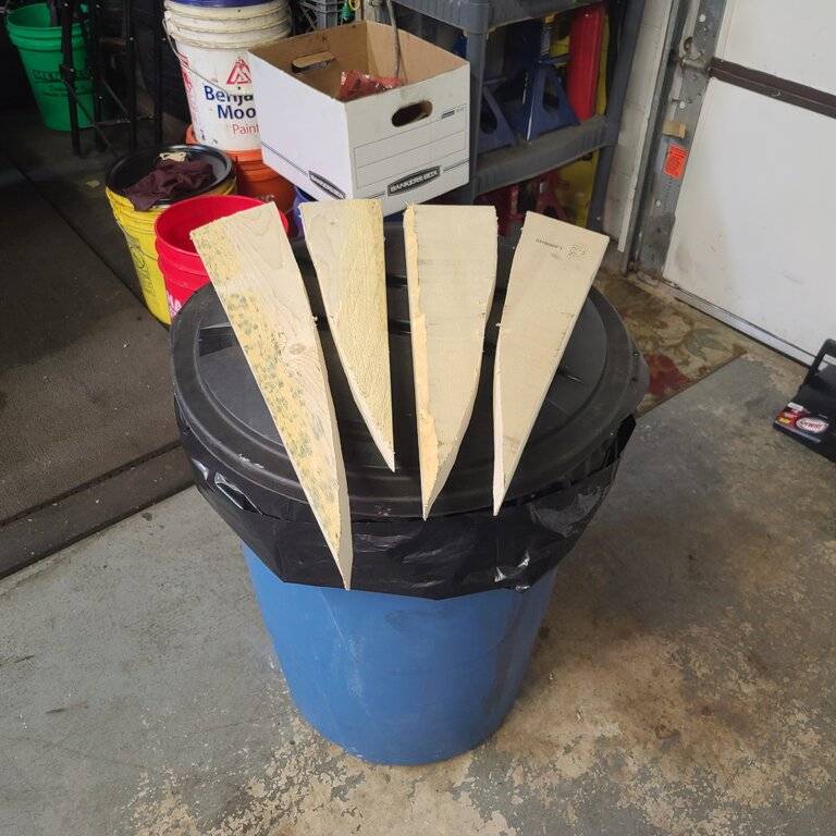

So. . . All the scratches are on the inside of the windshield?
Yes. When I bought it at the Rockford swap meet, it wasn't in a car at the time.
It looks like something had been placed on the windshield while it was being stored while laying flat. I can only guess that is why there were scratches on the inside of the windshield.
I am keeping the scrap wood that already has the not perfect, but close contour of the windshield.
These will be used on the same jig. I just need to flip over the jig I made, and position these where needed, to do the front side of the windshield.

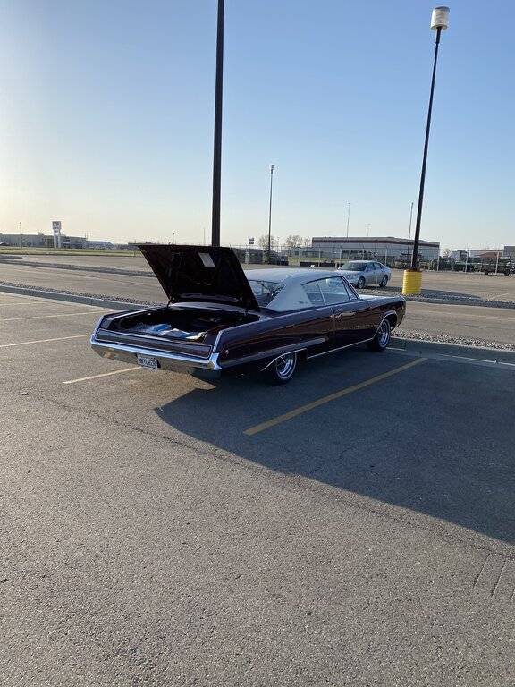

Took the “truck” to FleetFarm to get a full tank of gas, fill my gas can, and buy a couple bags of mulch and top soil.
I probably had about 350 Lbs plus a full tank of gas. Oh and about 30 Lbs of tools. Maybe it is time to think about new springs. Sure did ride smooth though.
