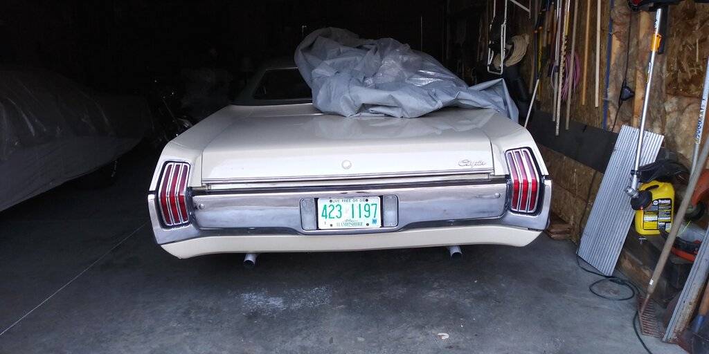

new rear bumper

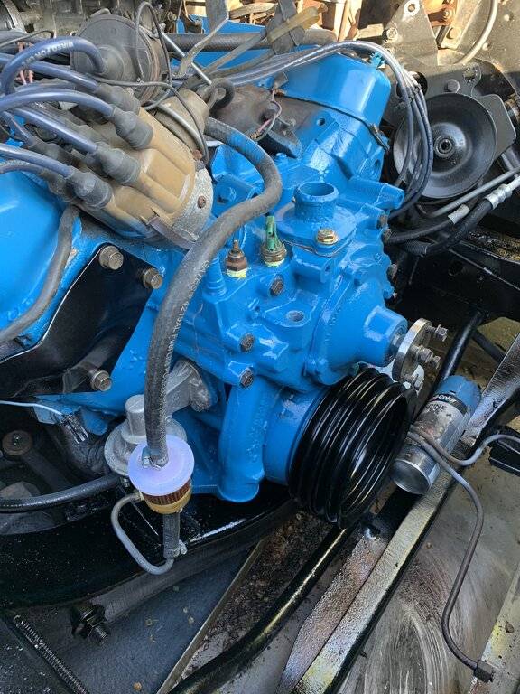

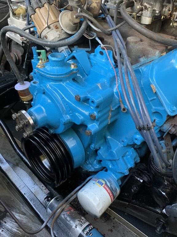

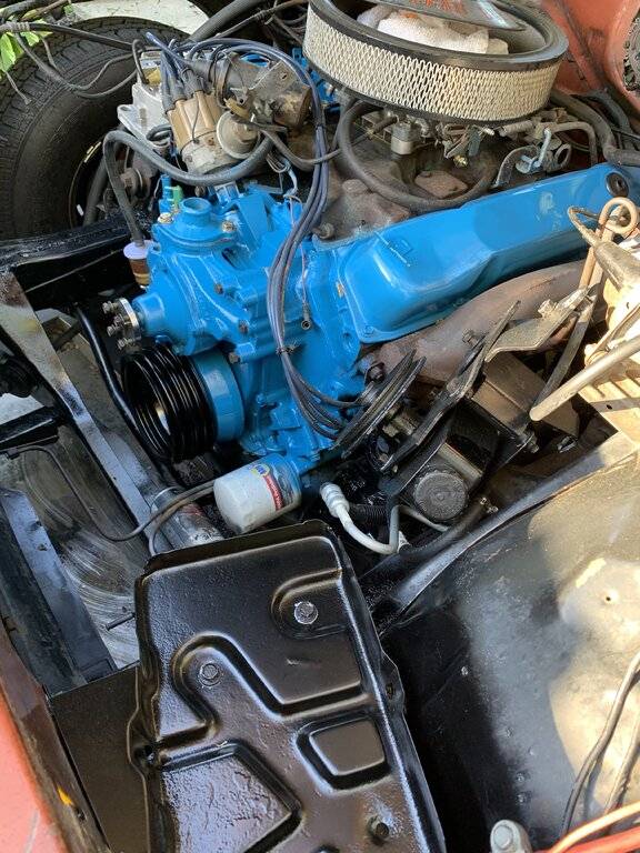

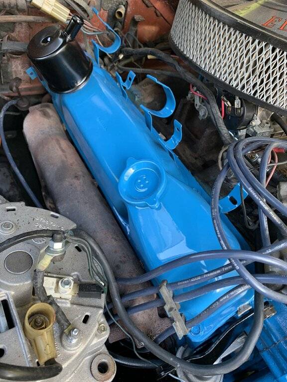

Been tinkering with putting the powder coated parts back on and paining what I can on the motor.. still lots to do, but slow and steady wins the race right!
