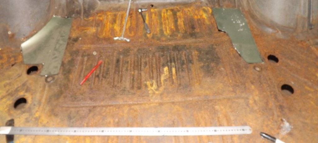

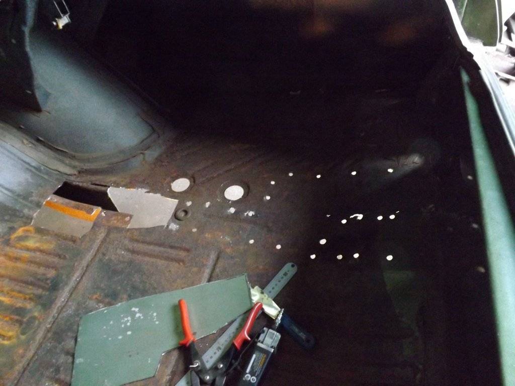

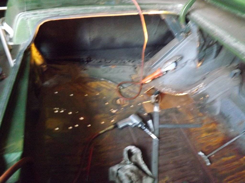

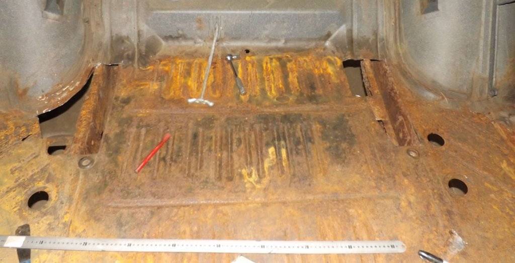

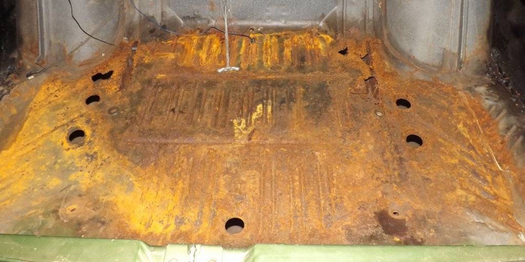

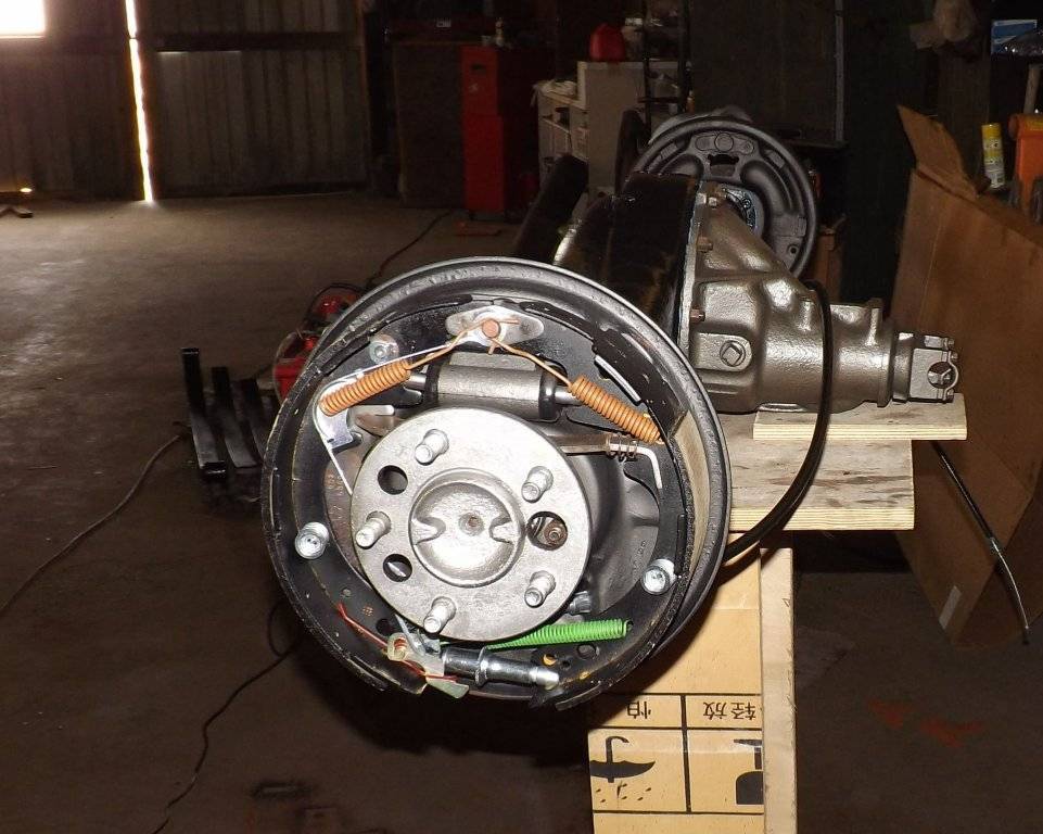

Ok guys, I have been workin away as usual, nice warm day today so finished the rear axle assy and put the painted drums back on. It is now pushed aside for later. As for the truk floor, I began working on that today, pics are self explanatory.
They don't look nice but they are solid, only need some clean up and a bit of minor repair before sealing and fitting.

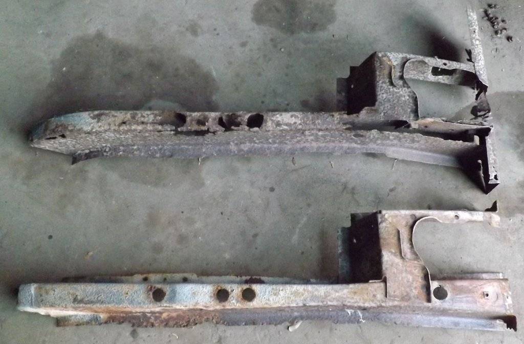

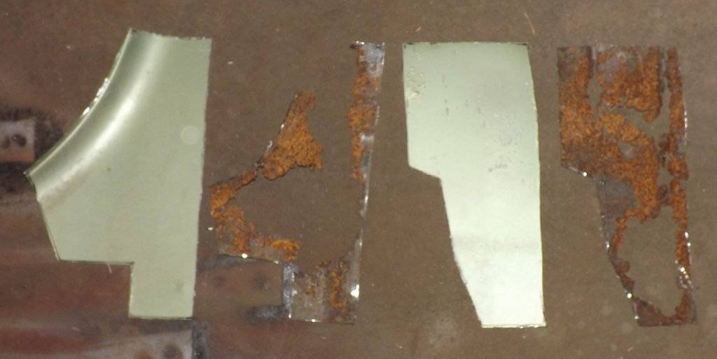

I got the passenger side chassis rail out, I put the replacement next to it for a comparison of what it should look like. Surprising considering the trunk floor only needed two small patches.

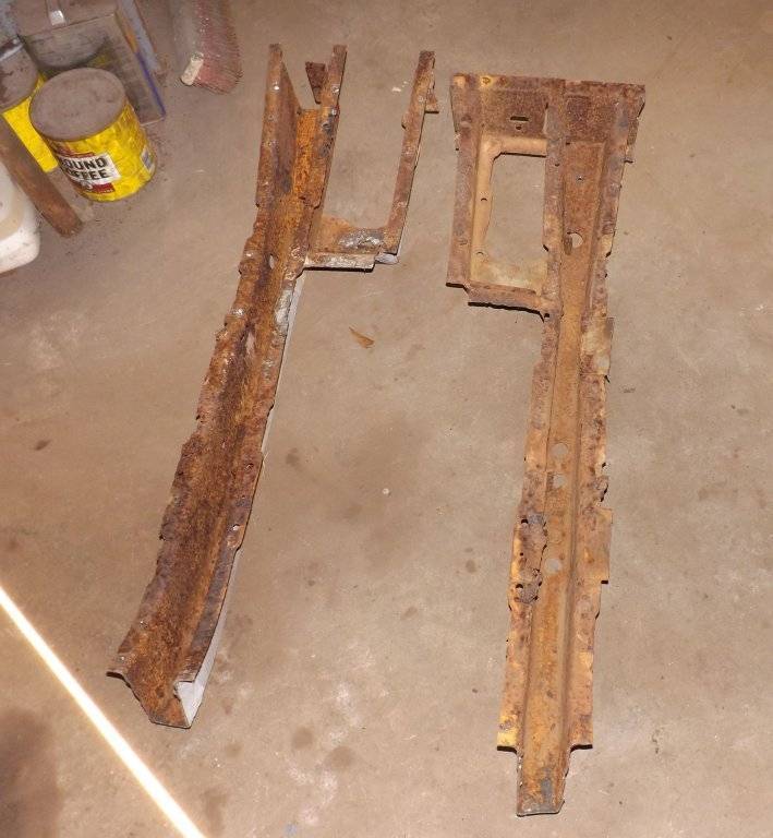

So here is the other side out today, it looks worse than the other, if thats possible. The trunk floor held together though, always a good sign.
if a fella had a metal brake and couple other tools those wouldn't be hard to make up by the looks of them....
