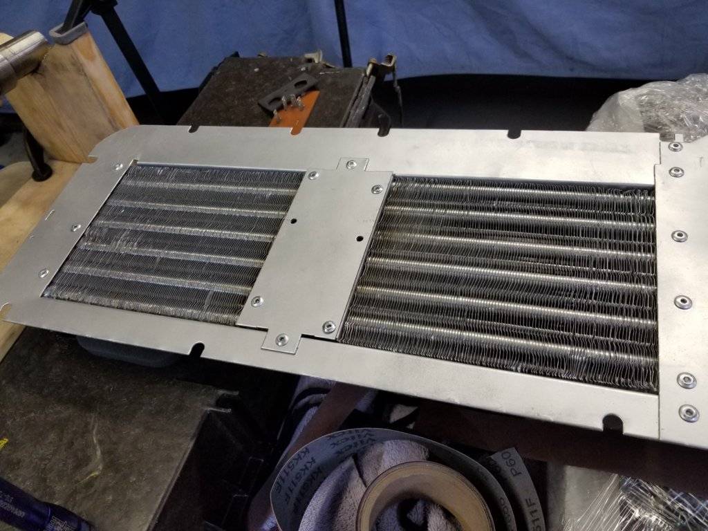

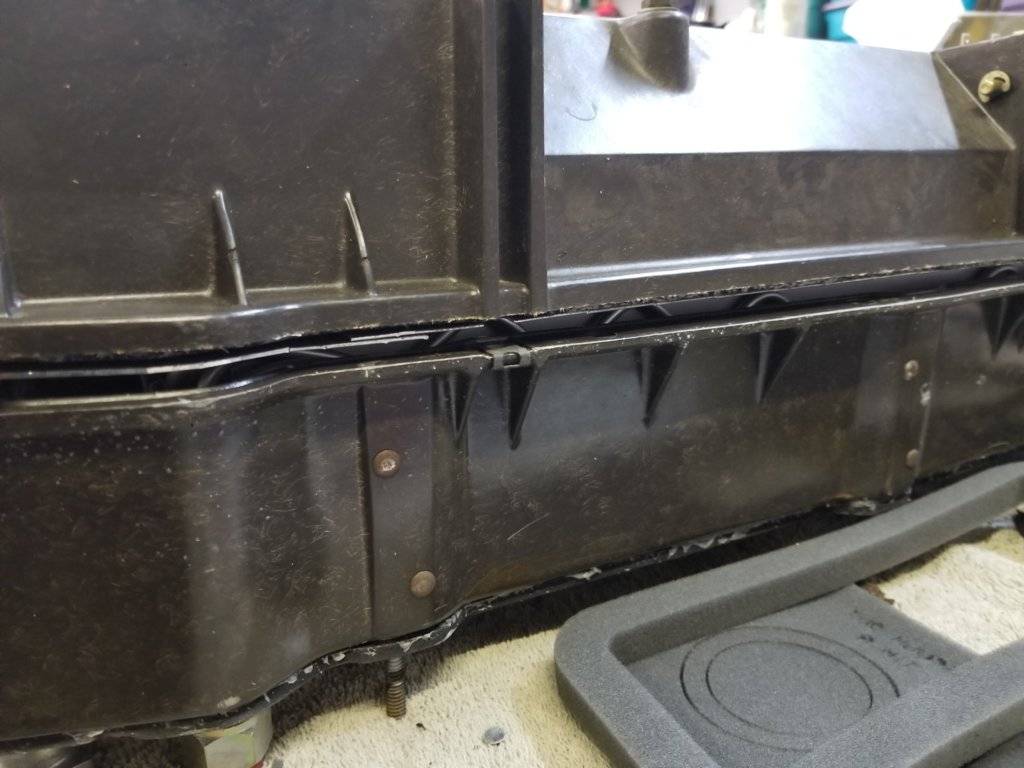

The heater core was delivered from AC Global yesterday. I was glad to see it arrive and was anxious to get to the shop today to put it in the heater box, as it was the final thing to do before putting the box back into the car.

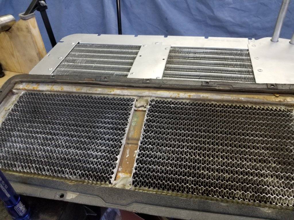

I was pretty bummed when I found out the two boxes wouldn't seal with the new heater core in place, leaving a gap of approximately 1/4" between the forward and inner boxes. I removed the new HC, and put my old one back in just to check the fit, and to see if there might be something else I'm missing. But with the old HC in place, everything fits properly and the two boxes would seal the way they should.
Finding the reason for the problem fit, being that the new HC unit from AC Global has end plates and a center plate attached to the base plate which is supposed to be flush to the box and in addition the plates are riveted on, which adds to the height mis-match for the box to seal properly. The same section on the OEM HC is recessed below the plate.
I've sent them a message to notify AC Global of the manufacturing differences between their product and the OEM unit with pictures, that can probably help them see where to modify the HC5777 product they are selling.
I wanted to get this news out here for two reasons, 1) to let FCBO members know the HC5777 won't fit properly, and 2) to keep everyone informed as to how AC Global responds, after knowing there product needs to be re-tooled to properly work on our cars.
Being an American made product, I am hoping they make the corrections needed so we don't have to buy junk from China.
I'll repost with a new thread when I hear back from them.

I don't think they had a complete interior housing to test fit their evaporator and heater core within - that is maybe the problem - they didn't mess up on the evaporator and it does indeed fit inside the inner portion of the interior housing assembly correctly, but the heater core must fit inside the outer cover of the interior housing assemblyand it doesn't quite make it. I think they tried to simpify the heater core design, but that didn't work even though it is beefier than the original one because it is a little too thick.

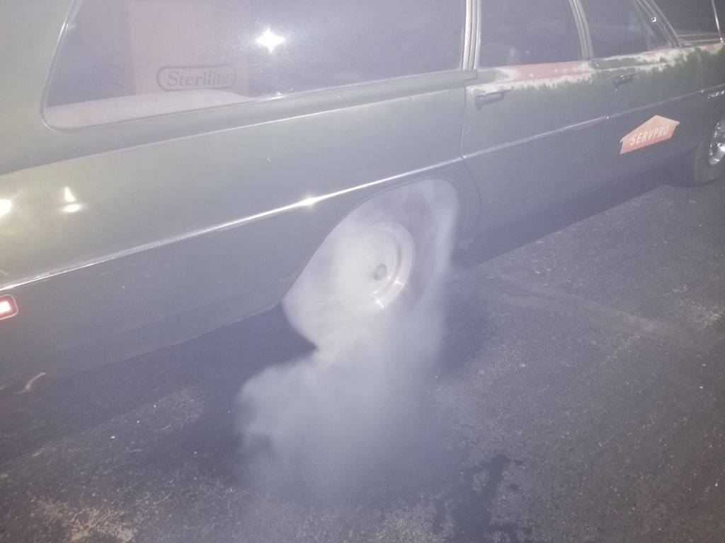

Even with the slow down in the economy, today turned out to be a good day. Wyatt came over and after we dropped off the seats at the upholster for Medina where I had my Imperial front seats done, we headed back over to my shop and got the stub frame back onto the New Yorker. Now that its back up on the hoist, and the floor is clear, the engine reassembly will start.
My neighbor came over and had a few beers with us as we were finishing up everything, and helped to roll it up the ramps to the hoist.
Afterwards we realized we ran out of beer and it was already dark, we figured may as well call it a night. But just before Wyatt left he laid out a 120' patch behind the shop in his Servpro wagon just outside the shop door.
The entire shop was filled with the smoke and the burning smell of his back tire. I only got one pic, but that was a good way to end the day IMO!
I'm sure he's got some better pics as we stood there an laughed.

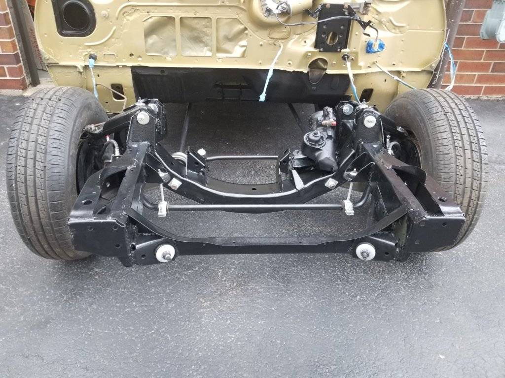

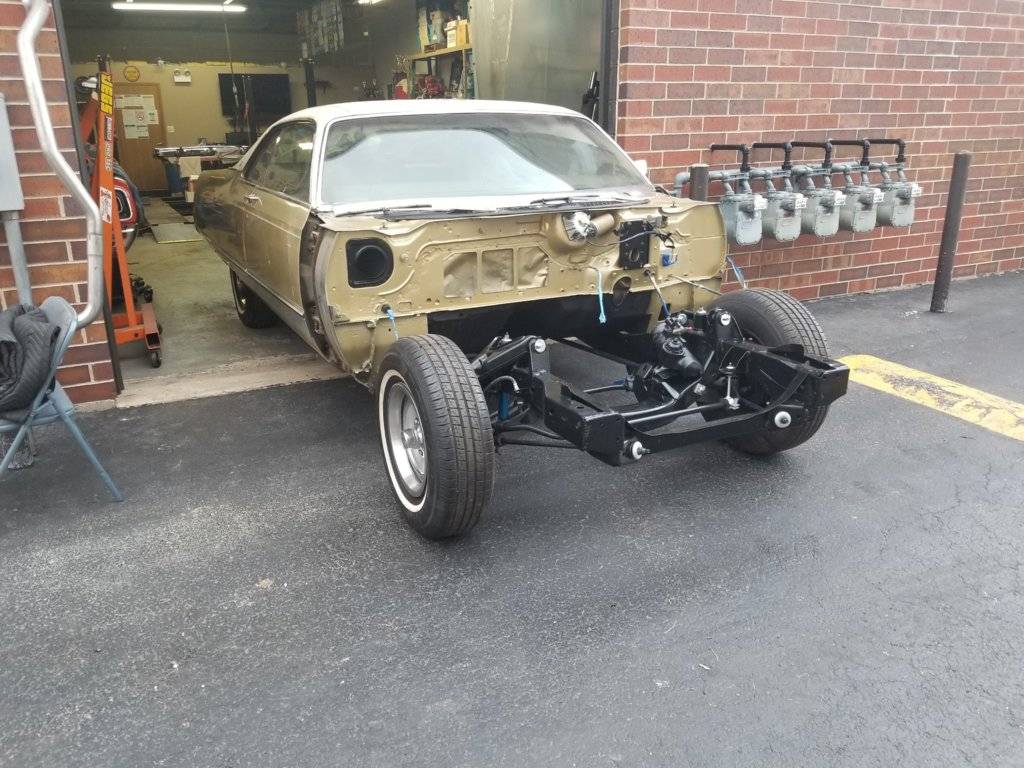

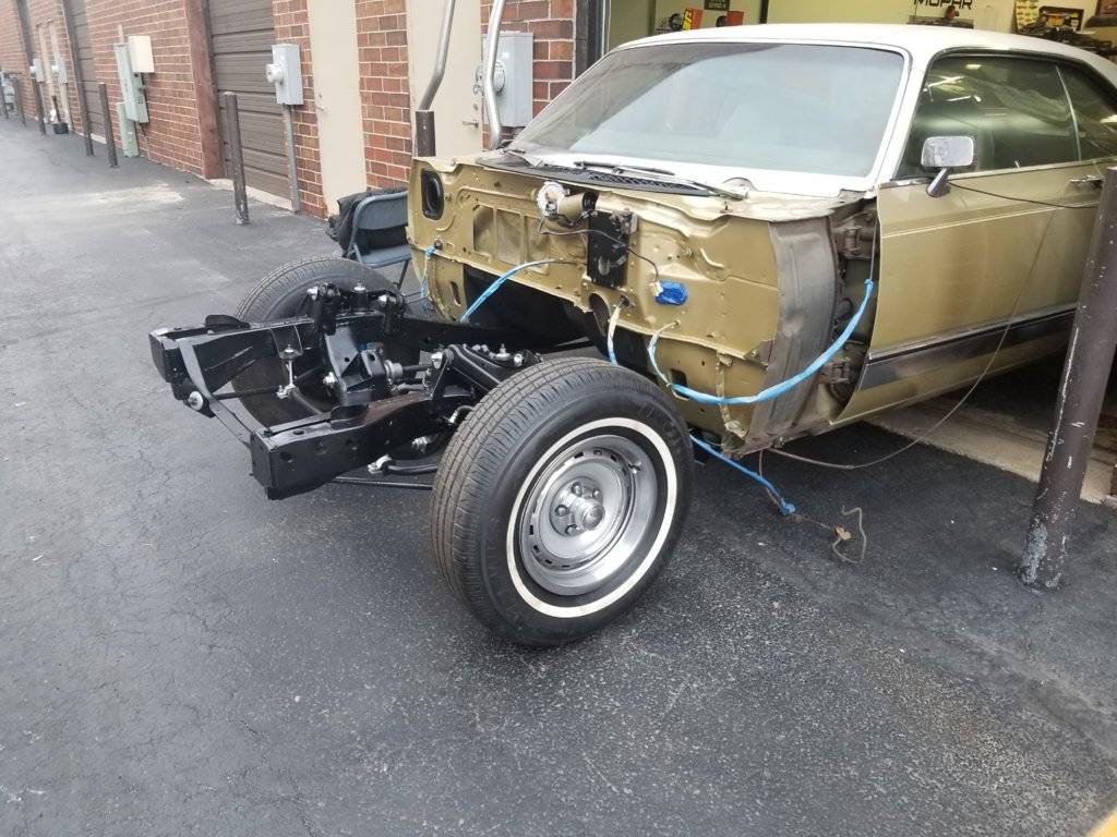

You've got to feel a little relieved with the stub back under it again!
