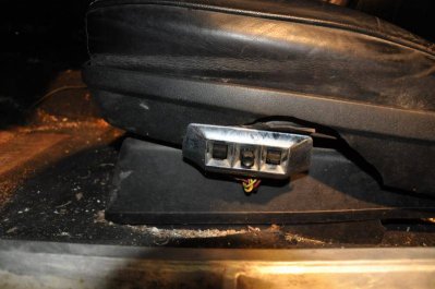

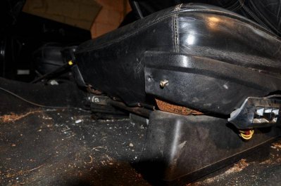

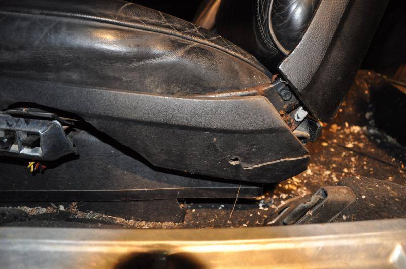

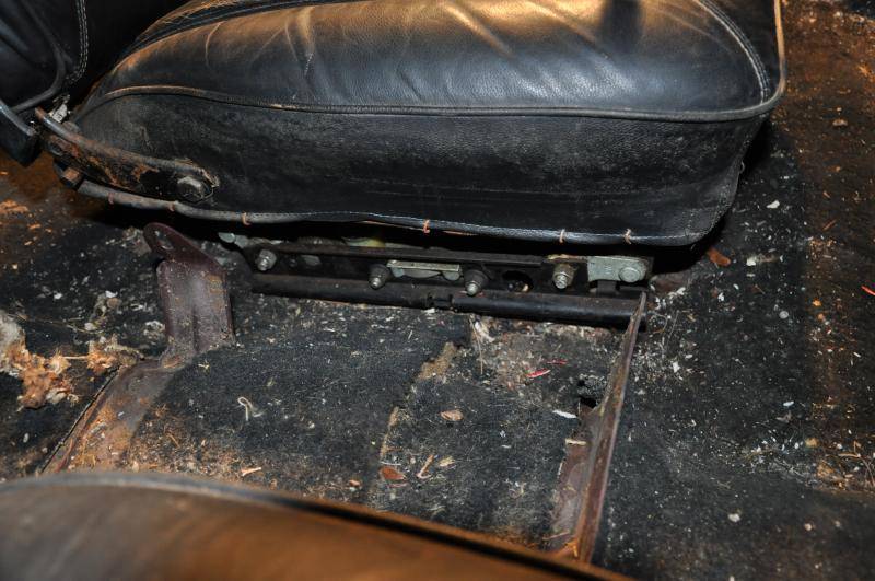

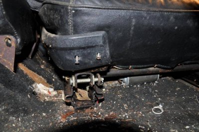

I tried to remove the seats today but I'm not sure how.
I removed the panels. Unfortunately, the left outer one was crushed...

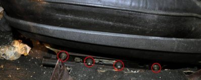

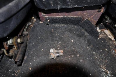

I can see 4 screws in the inner side. Are these the right ones to remove the seat?
On the outer side are no screws to remove the panel...
How do I remove this damn seats?
Instead of removing the seats I removed everything behind them...

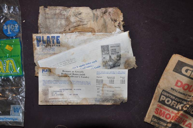

Todays loot
I'm still hoping to find a paperbag packed with dollar bills ;)

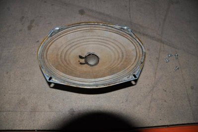

The only speaker in the car...
Looks like new to me :O

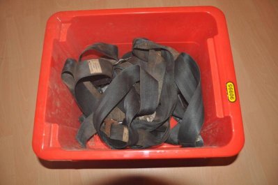

Whats the best treatment for the seat belts to clean them and make them nice and smooth again?

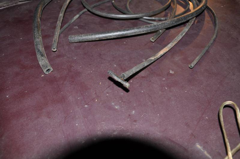

These rubber hose were lying loose in in the car... I don't know where they belong...
If it is the same as my 300, you have to remove the two brackets under the car first. One straddles the rear of the transmission, the other straddles the drive shaft. You will find at least three seat bolts under there. I just went through that ordeal on Saturday, PIA!
