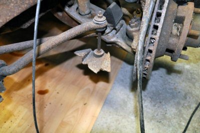

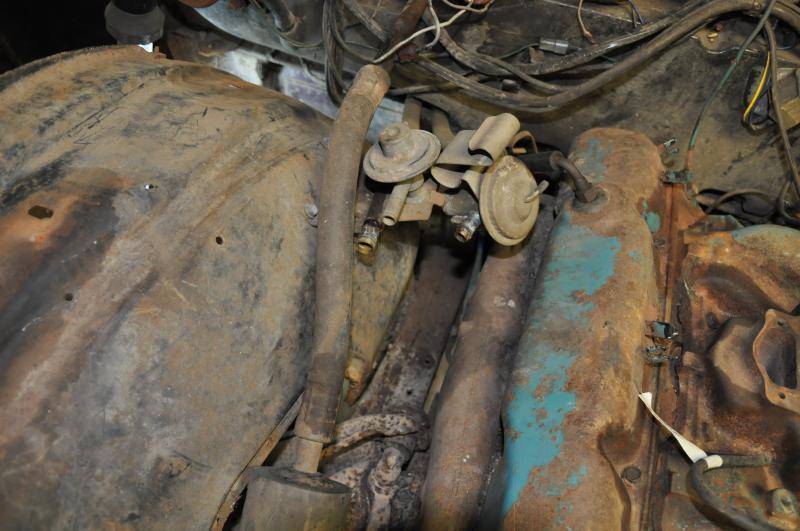

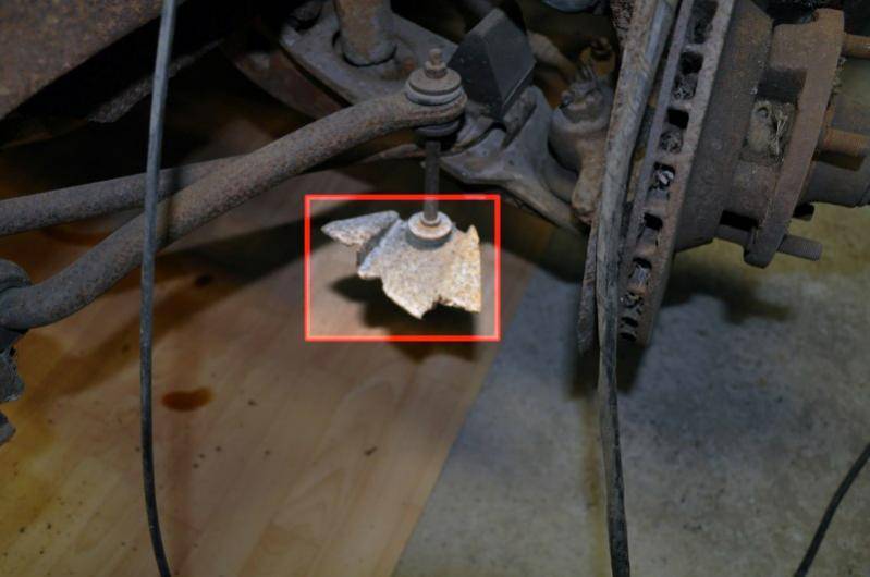

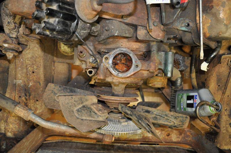

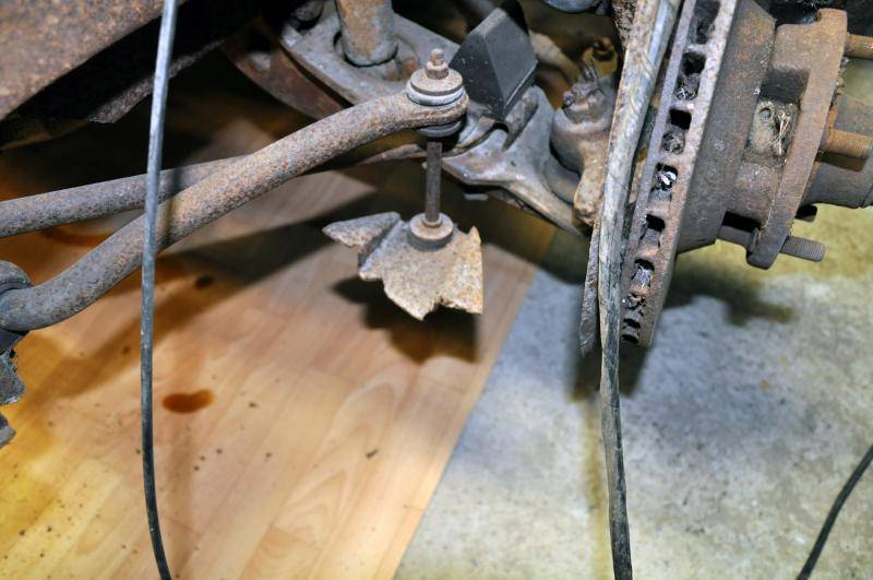

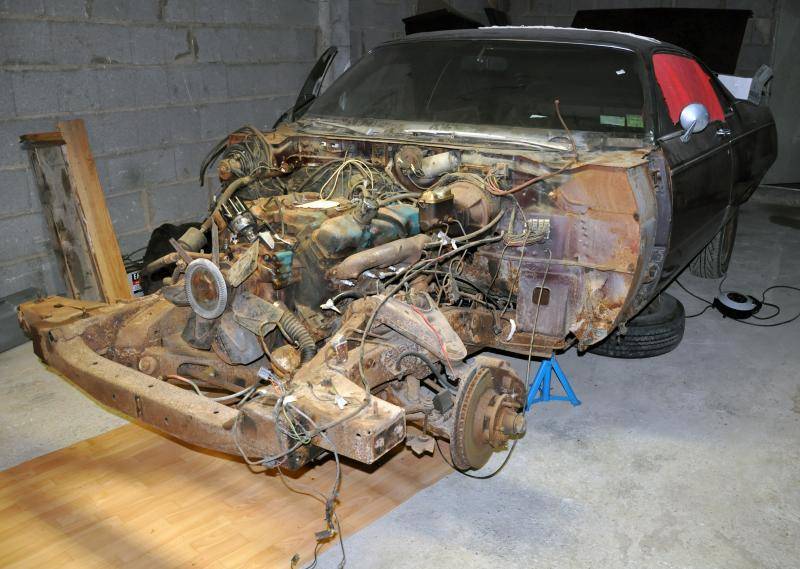

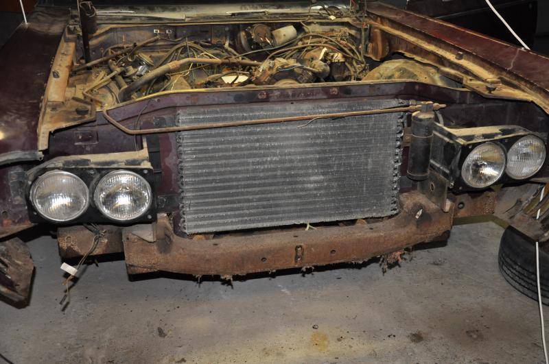

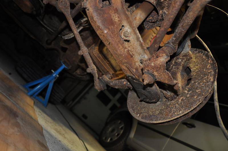

I did some work on the Imp this weekend since over 3 weeks! I stripped the whole front, because I decided to remove everything and redo every single part. There es serfacerust+ on every single part...

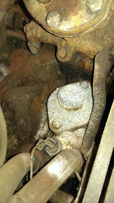

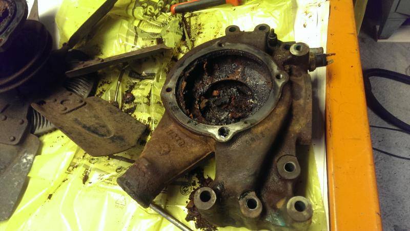

And I found this on the left side:

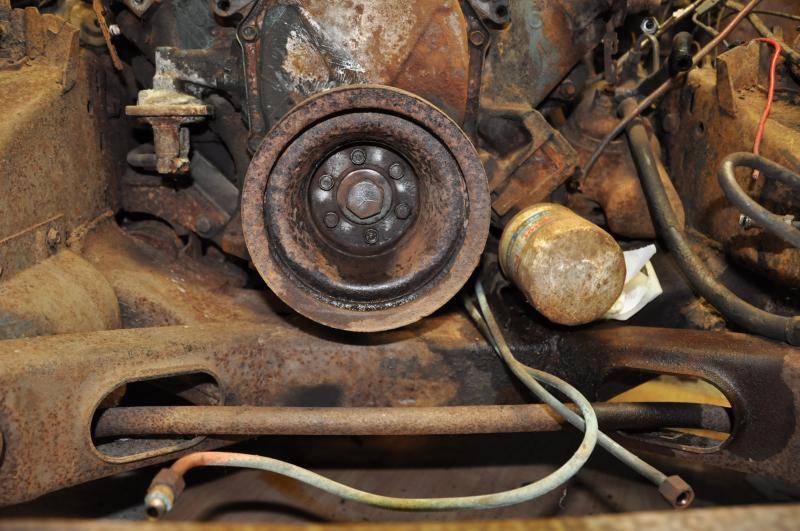

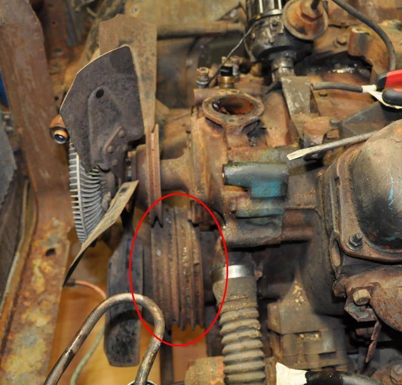

Just to be sure, the big nut on the big pulley is where I have to put the wrench to crank the engine right?
I was told the engine turns over but when I tried to crank it, it was completely stuck...
You can turn the engine using the crank bolt Julian, I'm not sure but I think is's a 1 1/4 or 1 3/8 head. If it does not tun easily then add a litle 50/50 trans fluid and acitone to each cylinder and after sitting for a day or so ...... With a bar and socket try rotatingthe crank one way ... then the other. Hopefull it will loosen up and turn.
Welcome to the club, I had visions of getting mine running then working on it, the more I looked at it the worse it got.
Finally it all came apart.
Yes, the big bolt in the lower pulley, remove all the plugs first.
Alan
Yes, the big bolt in the lower pulley, remove all the plugs first.Alan
Ok, I will try to crank that again with no plugs. No compression makes sense, but I think I should have a bit movement already!
If this will not work I'll do that 50/50 thing! Whats the best way to get the mixture into the engine? Do I have to remove the heads? Maybe I better wait until the engine is on the engine stand?!

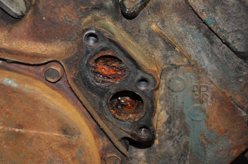

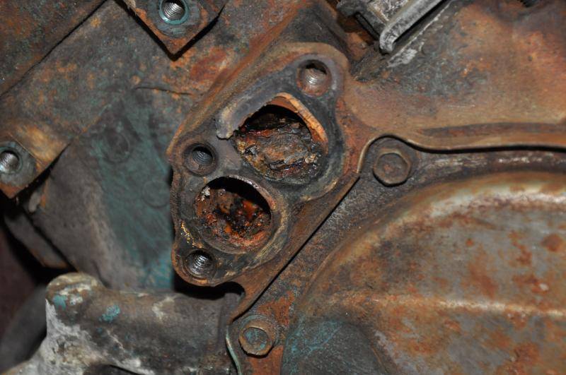

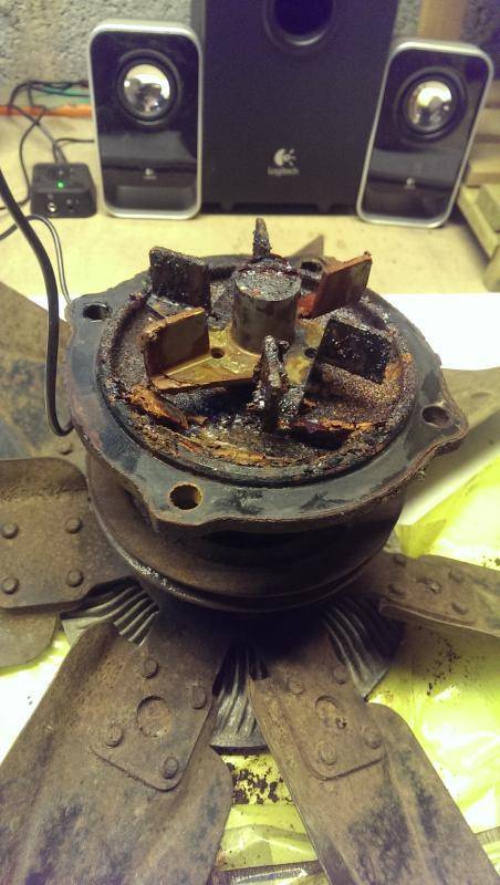

Does someone know a good way to clean the cooling lines inside the engine? they are stuffed with old coolant I think...
Also 50/50 trans fluid and acitone?
OMG....
The only salvation is for that to be taken down to the bare block and sit in an acid tank for a week.
And I know that ain't gonna happen in Germany.
That's more than iron oxide rust. That's a stew of built up rock hard minerals. Like trying to dissolve granite.
