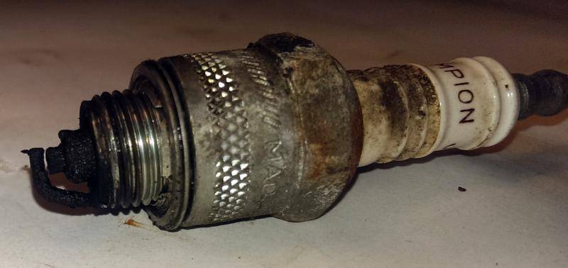

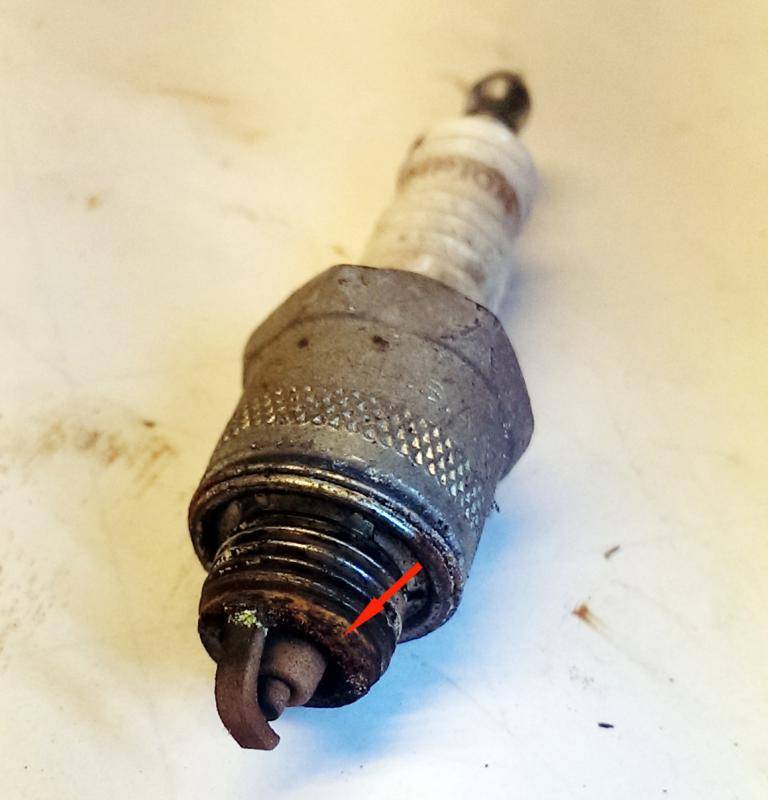

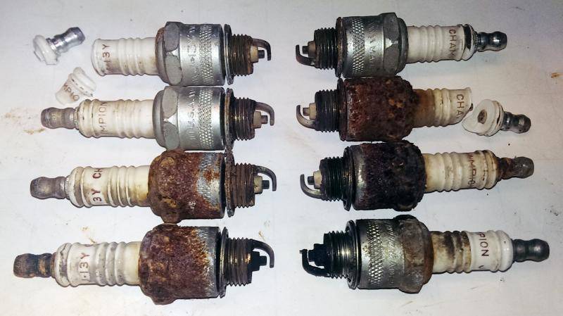

I removed the spark plugs and tried to turn the engine over. After a little left, right, left, right it moved, but only approx. 30° and then there is a crunchy noise...
7 of the spark plugs electrodes look good but have a little rust on them and one plug is really dirty... people say that the spark plugs are a window to the engine, so what does that tell us?

The crunchy is most likely air escaping past rings riding on rusty cylinder walls, I'm sure it will be fine those are tough old blocks/engines running without oil and water is probably there worst enemies.
