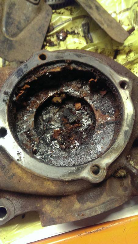

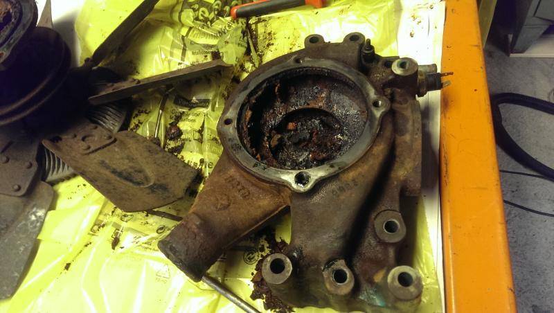

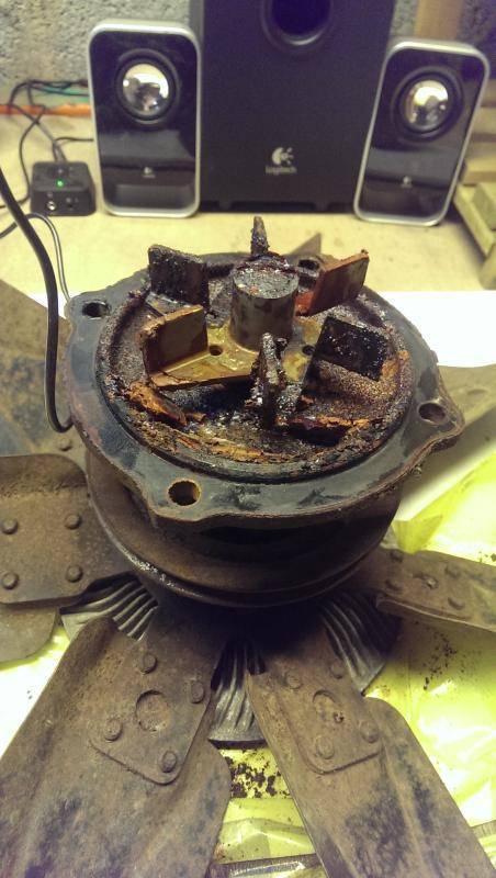

the water pump was filled with that damn stuff too... It's not like "cement", more like "thick crunchy yogurt" :tard:

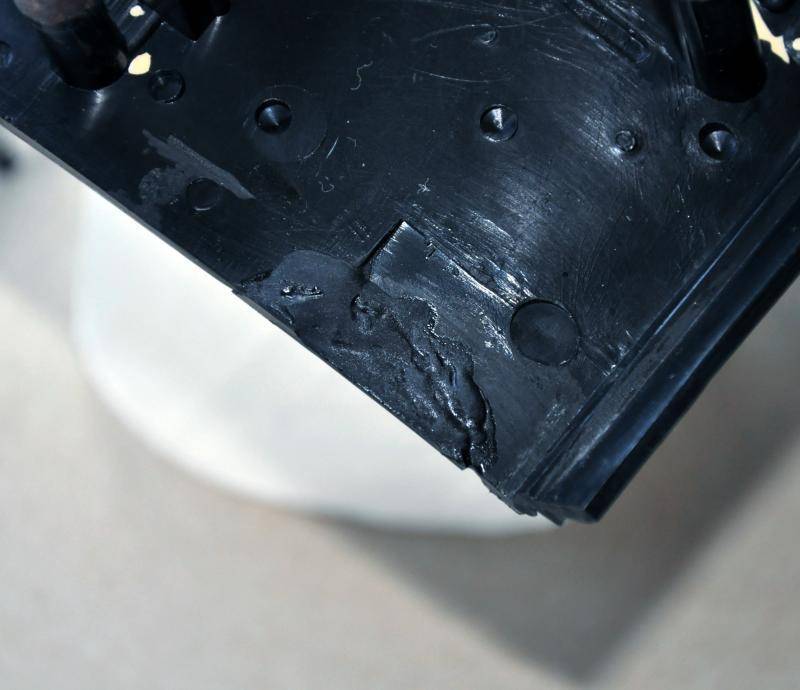

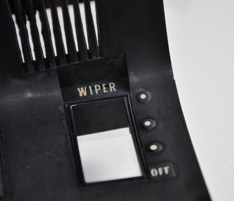

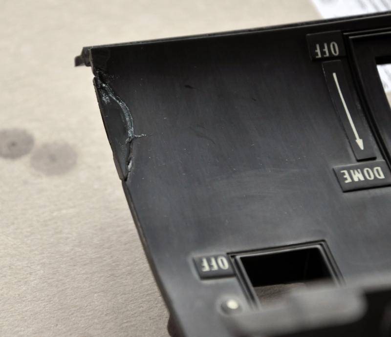

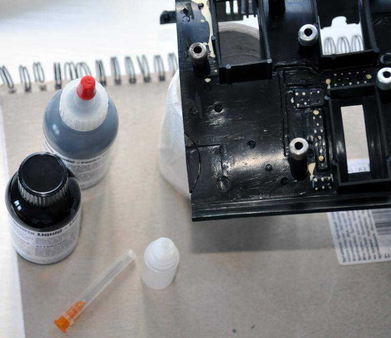

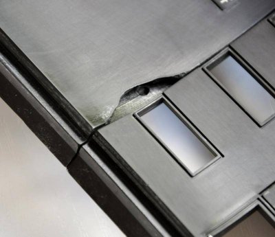

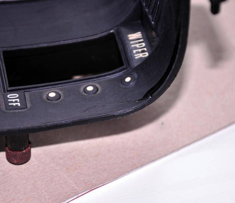

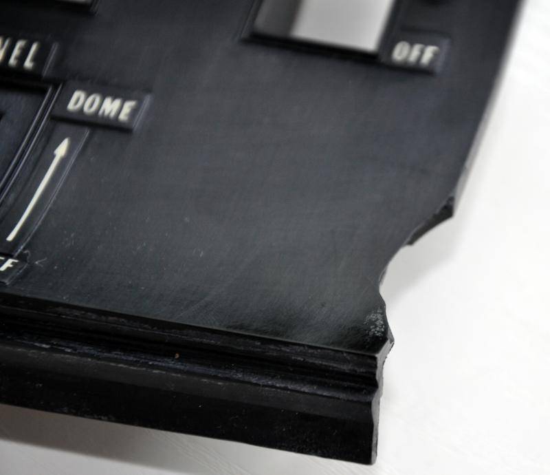

I tested the PlastiFix tonight and this stuff is awesome!
Here are a few pictures:
After a lot of sanding, it looks really great, but still need more sanding I think...
Very nice job, Vodka.
I found out something about PlastFix the hard way.
The activator is so volatile it evaporates in six months even in a sealed bottle.
Use it or lose it...
Posted via Topify on Android
Thats good to know, I will try to seal the bottle better to preserve the activator! Maybe this will help

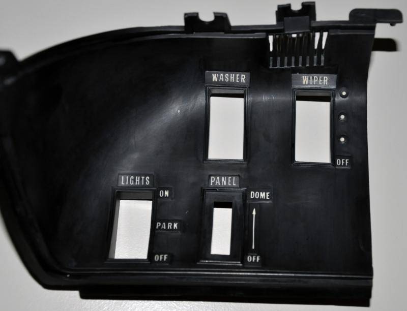

I will paint the instrument cluster with semigloss clear coat. Does anybody did this before? I'm a little concerned because the heat and cold expansion could cause cracks?!
