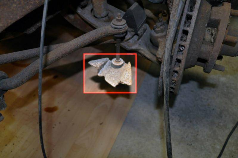

Hi Julian,

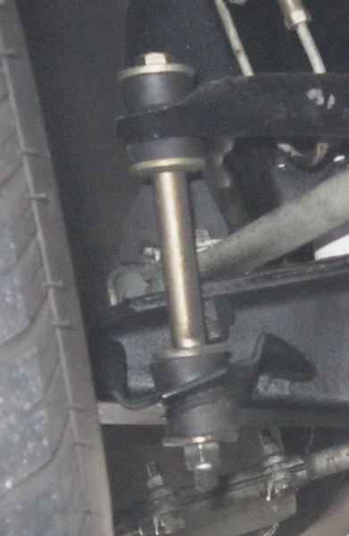

that metal plate broke off of the lower control arm and turned 180°. It is usually welded to the front of the lower control arm and receives the rod connecting the sway bar.
Thanks Dan! That's what I thought. It's a very low milage car but some things I found are confusing me... Like this...
Supposed mileage is meaningless without records to back it up, but after extensive storage in bad conditions it doesn't really matter anyways IMHO.
Bet that got broken off in transport. They hooked to that and it broke.
No, there are no "new" breaking points. According to the rust it was broken when parked :/

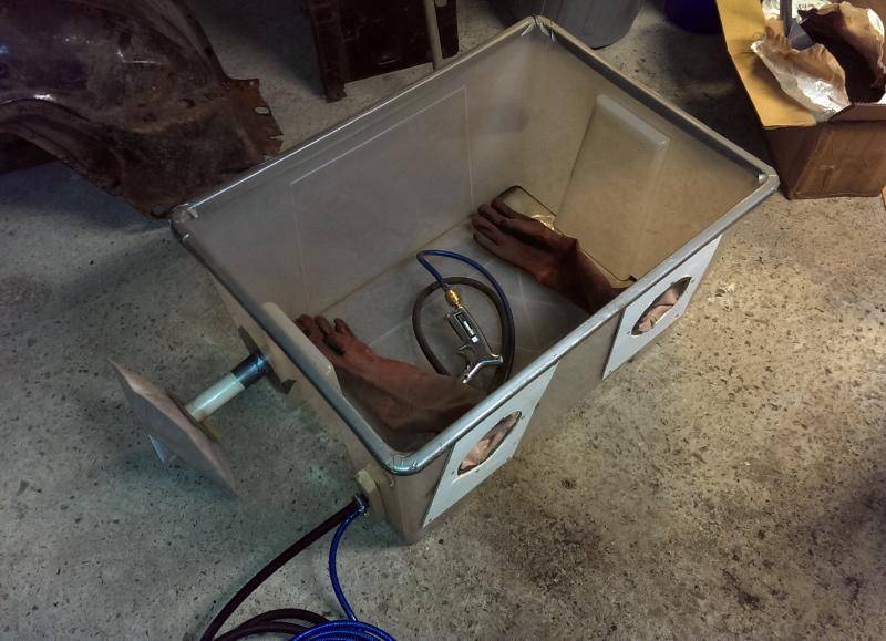

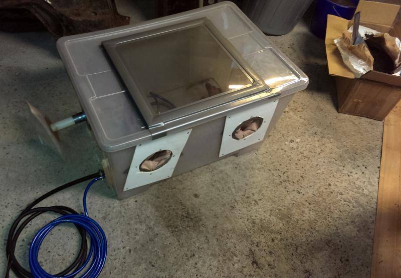

Stinginess is the mother of invention ;) It's Cheapo v1. I'm planing v2 right now, because the biggest ikea box is not big enought! But for now, it's great! :)

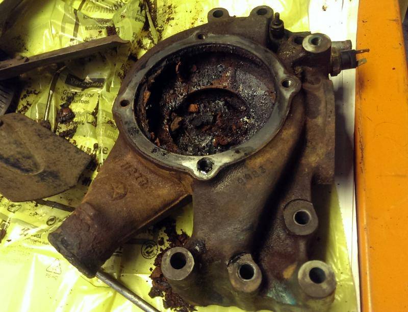

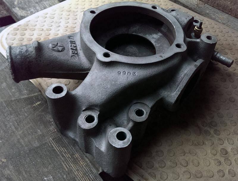

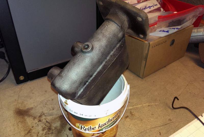

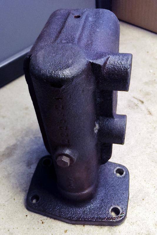

I started to clean the master cylinder too, but it was a mass without draining it.
Will continue on that tomorrow.

went through the whole thread, great job on the carb, love your blasting cabinet, keep the pic's coming. good luck
You're probably better off replacing the master cylinder rather than spending a lot of time reworking it. The bores tend to wear along with the rubber seals and you will play hell getting the bore good enough to use. You'll pay as much for the repair kit (if you can get one) as a rebuilt or new master cylinder anyway.
Yes, I know it's expensive getting parts shipped to you...
Big_john, You do realize that will just motivate him to rework it any way :poke:.
Great progress Vdk, love the blasting cabinet! I broke down and spent the money on a Harbor Fright unit, but wouldn't have had I seen your post first.
Stan you should have figured out how resourceful Julian is by this point. Julian, I see you're going to be at this for quite a long time if you're going to insist on making the tools you need for the resto but it'll make the thread that much more interesting and entertaining. Nice work brother!
$150 for a reman Cardone master cylinder / booster combo sounds ok, but is not in stock at Rockauto.
Maybe my cousin can bring one with her when she visit me in summer...
I think you'll be better off getting a new one.
I'm going to clean it anyway. A rebuild kit is available for "just" ~$50 here in germany. I will give it a try. If it doesn't work I can still buy the reman cardone unit.
