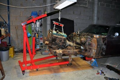

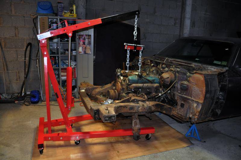

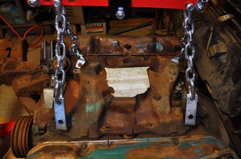

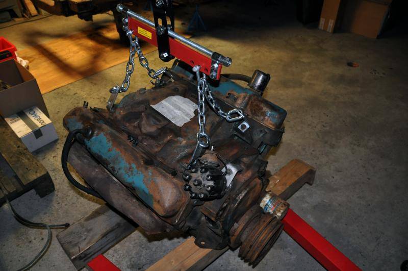

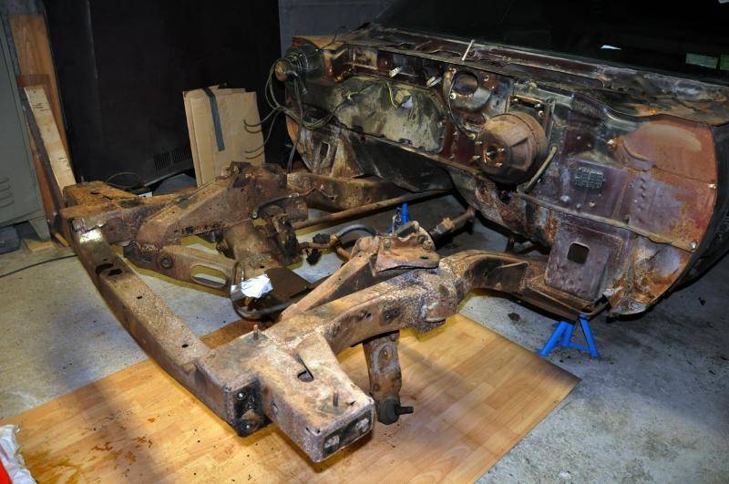

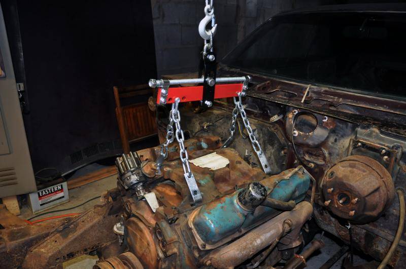

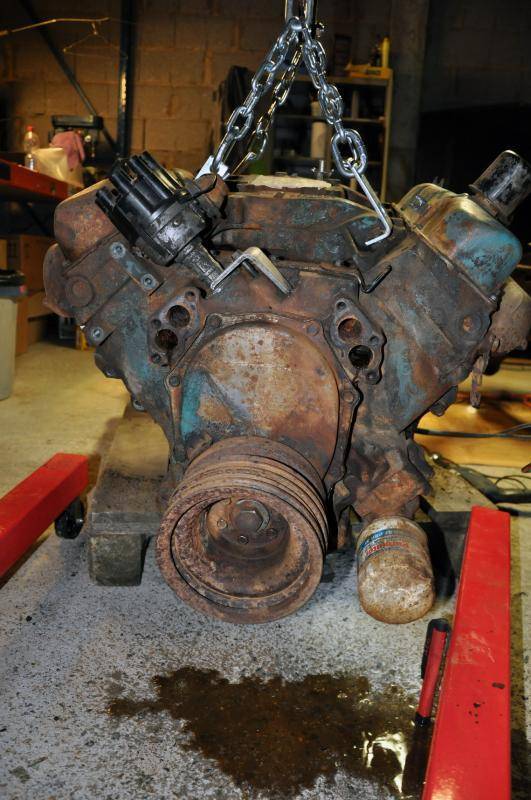

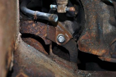

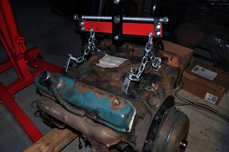

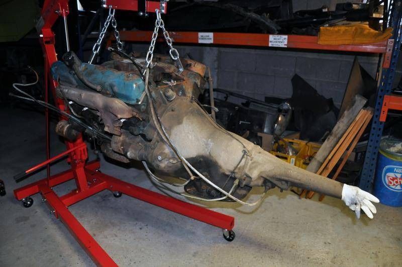

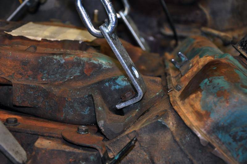

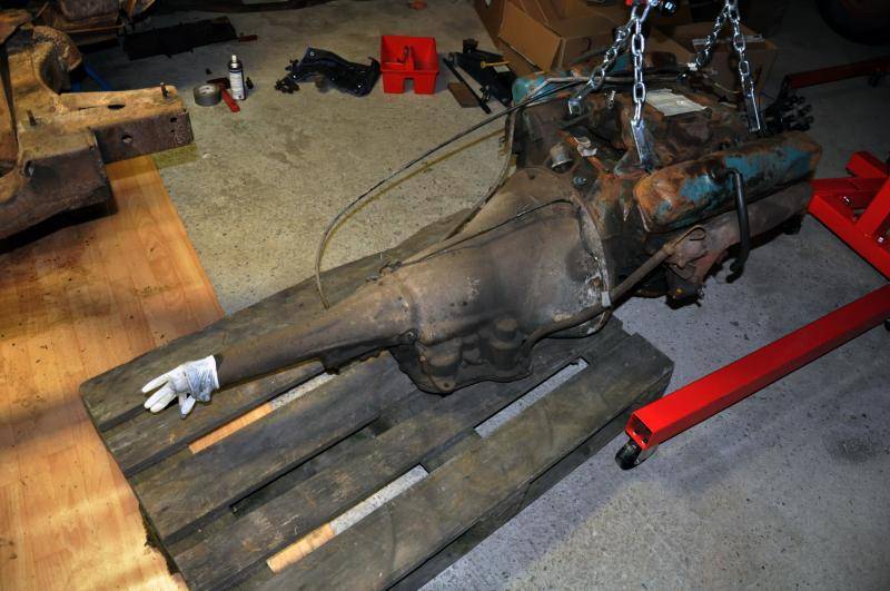

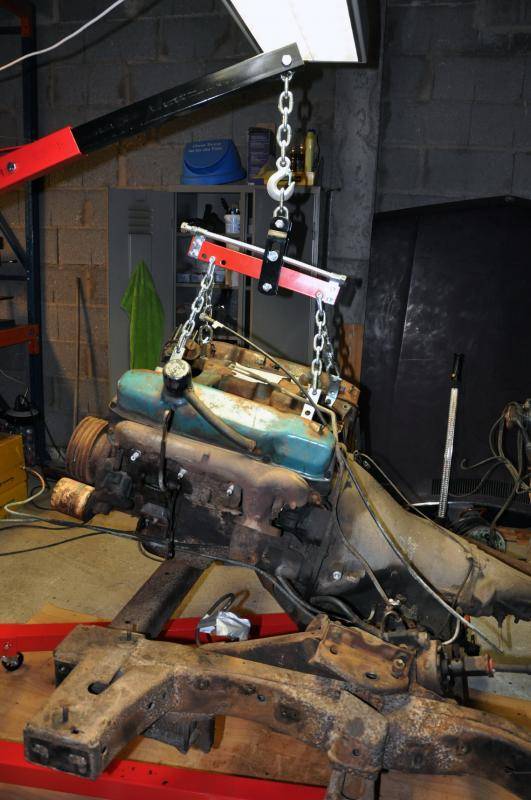

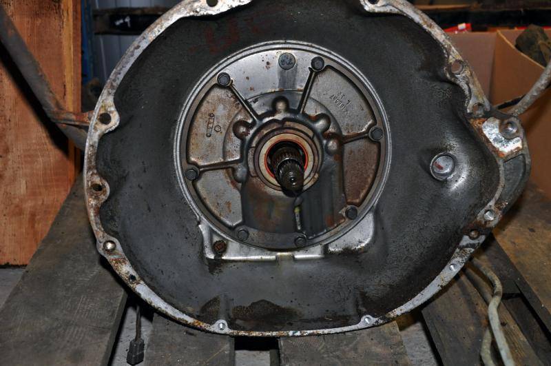

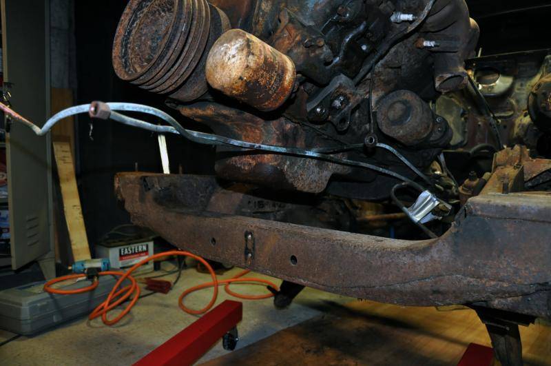

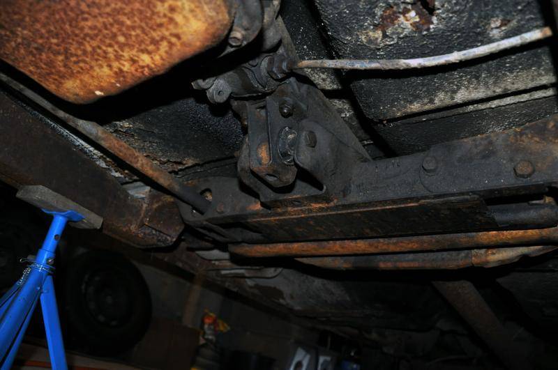

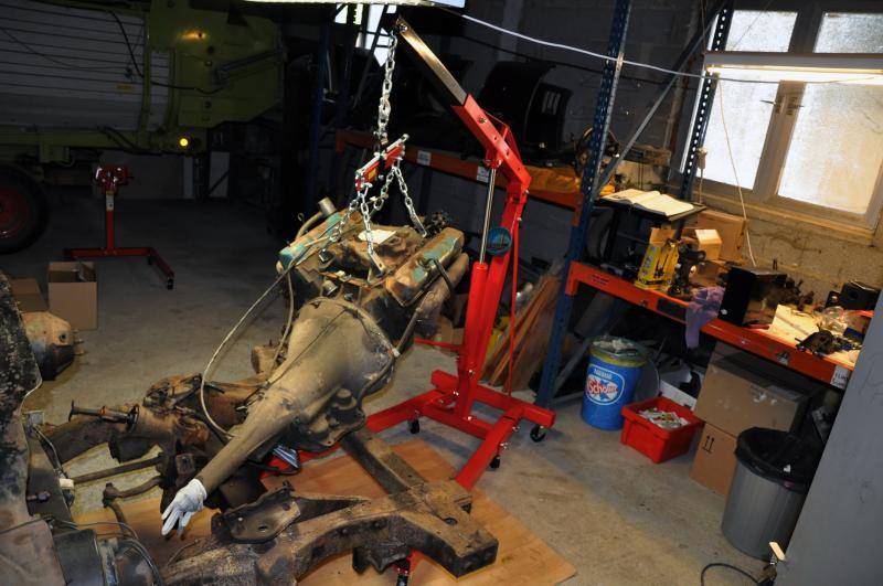

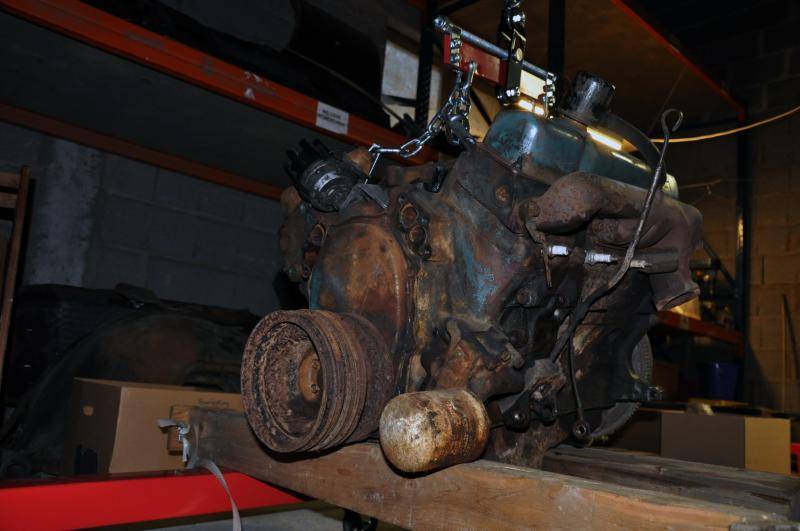

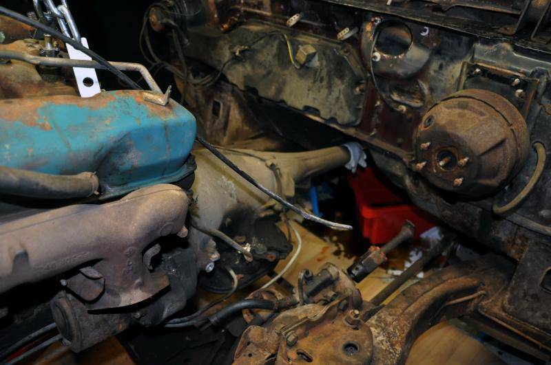

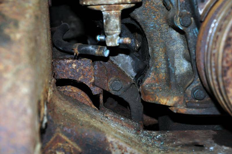

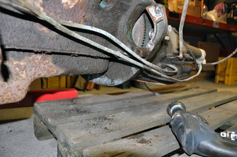

I Pulled the engine today. Just a few complications, nothing big. I had to remove the whole bracket of the rear engine mount to get enought room for the oilpan to get over the K-Member and I had to remove the complete right front engine mount to get enought room, too. But after that, it came out easy.
I created a environmental hazard with ATF, but no big deal. A bucket of sawings selved this problem.

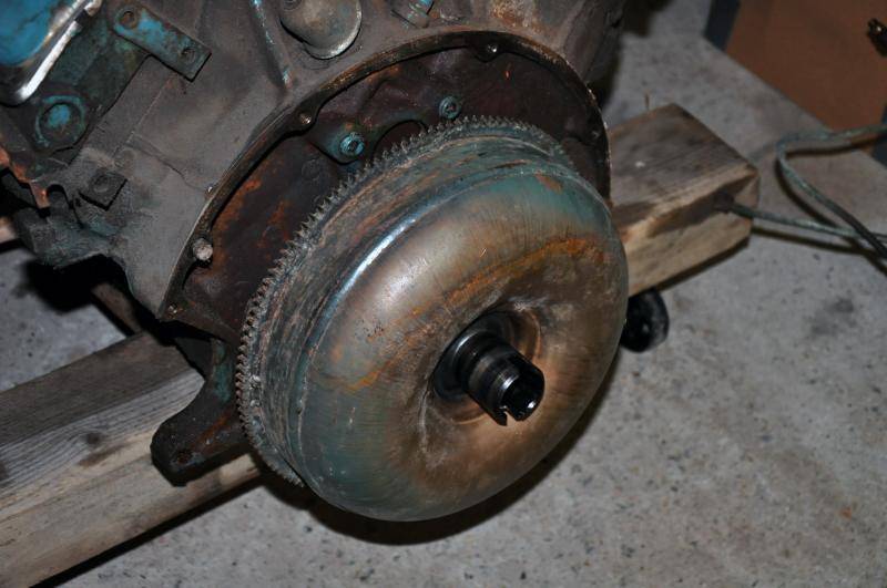

tomorrow, I will take the engine apart to inspect how bad it is inside.
And now a lot of pictures:
engine01.jpgengine02.jpgengine03.jpgengine04.jpgengine05.jpgengine06.jpgengine07.jpgengine08.jpgengine09.jpgengine10.jpg
One good sign for me was all the coolant, that came out of the engine block! Means, not the whole cooling channels inside the block are stuffed with this screwed up coolant gum!

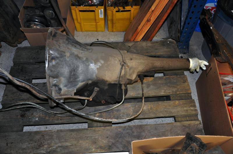

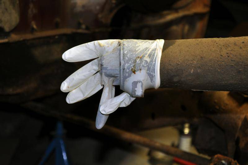

I like the five-fingered-condoms on the U-joint and the trans seal! Great idea, actually. Looks like you are coming right along on the Imperial.
Good stuff Julian, I'm excited to see what you find on the inside.

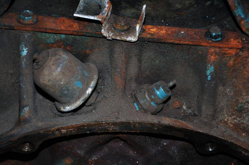

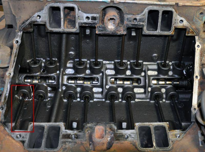

Me to! I took off the intake and the valley pan already. It's VERY clean inside, no gum, no slick... But I found a little rusty trickle on cylinder 8 that comes from the velves and go down to the lifter :/
