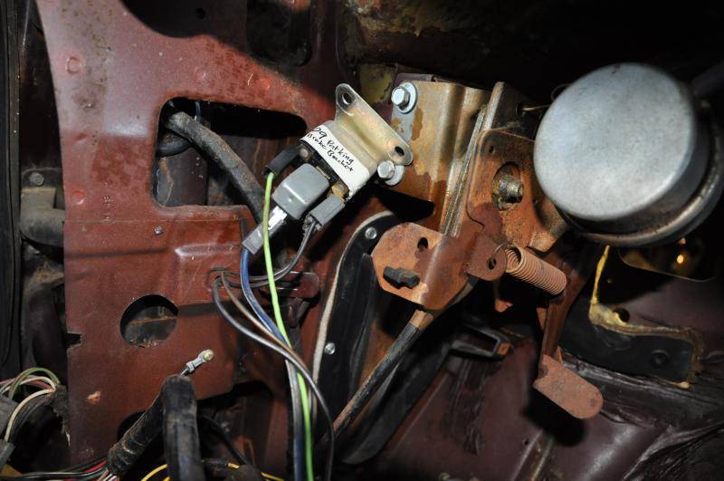

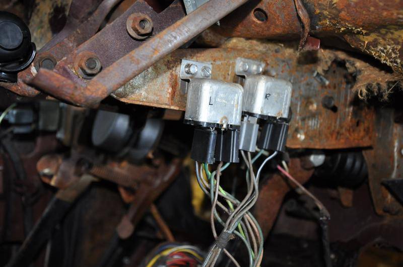

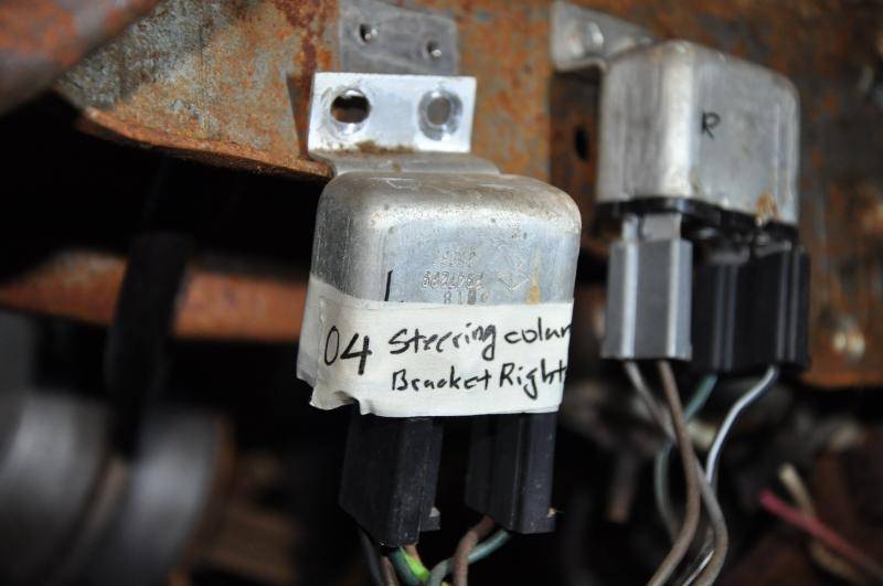

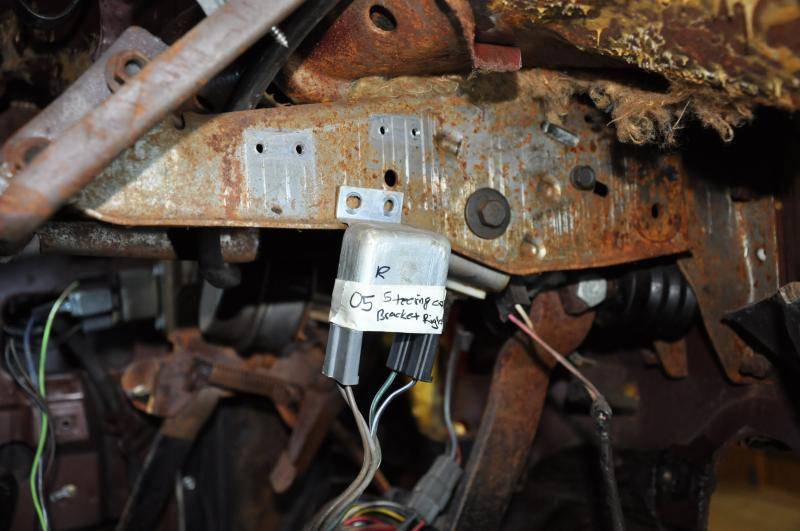

Can someone help identify and name some under dash relais? I made pictures of them and tagged them with the place I took them from but I have a list in which I write down every wiring harness connector with a consecutive number.
These two guys:
And this one:
I'm not sure about the two relays on the column brace. Your manual should shed somelight on them in section 8....... wiring diagrams.
The last one is the relay for the headlight doors. same one in my 300.

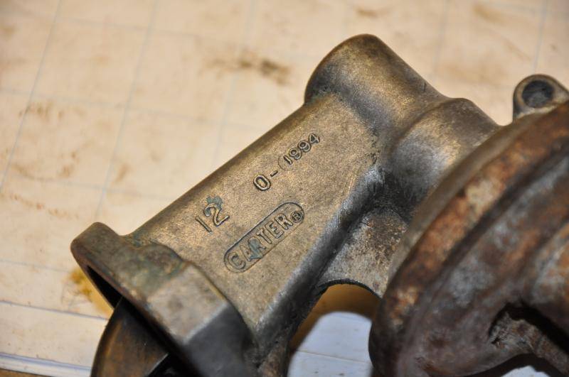

I found a date code on the fuel pump that indicates that the car was not abandoned in 82 when it was registered the last time...
