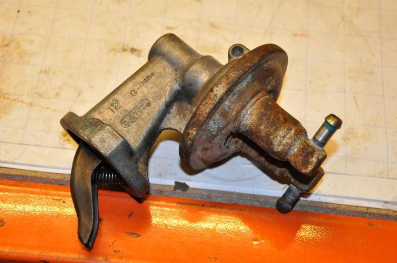

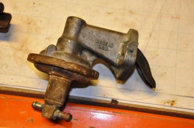

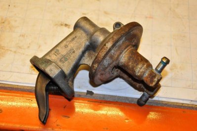

That fuel pump is not original (not painted) engine color I don't think carter was around in 1994 they had already been sold off to weber, but anything is possible.
I think that's what he's saying: the car wasn't totally abandoned after it was parked. The date code shows that someone tried to get it running in the '90s.
It was paintes in turquoise but the paind came off when I brushed the dirt off. A rest of the paint is still there, around the "2", the "R" and the bolt holes!
My guess was, that this is a dacecode, but maybe it's not?!
Nope by 1994 almost all auto parts were being made in china and with the paint on it probably original. Alan is right date code would be stamped at the time of assembly not cast in.
