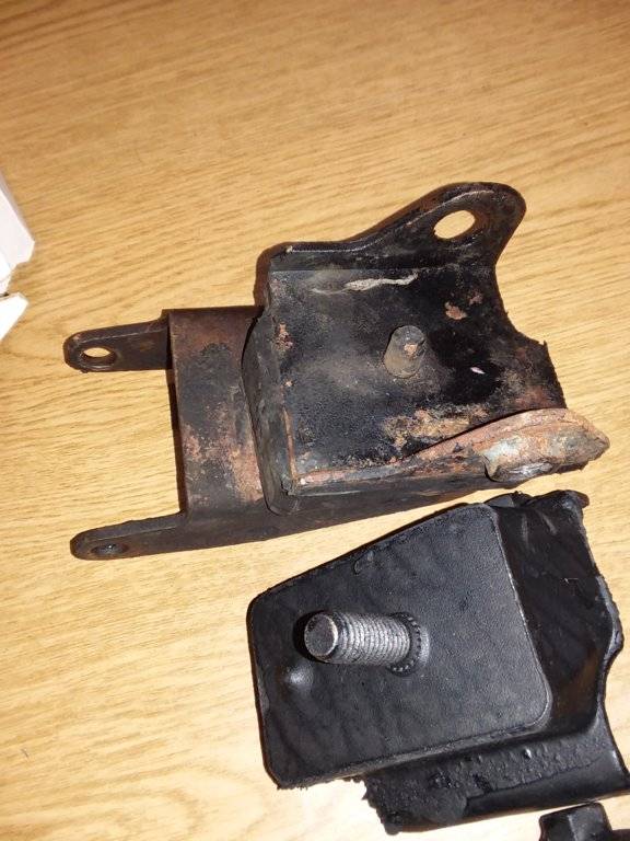

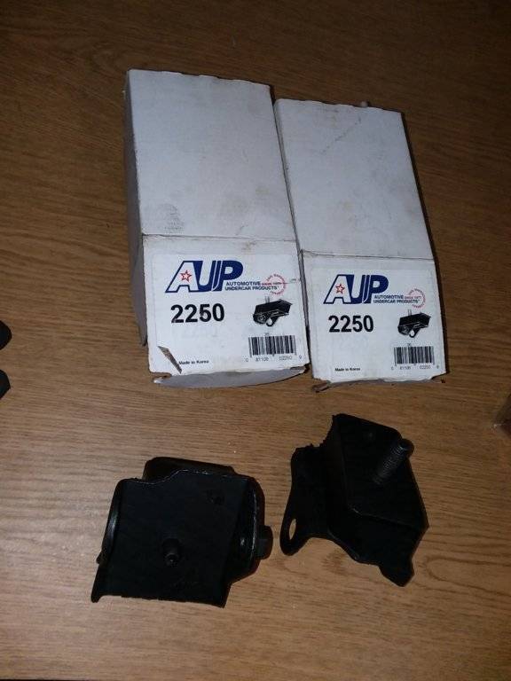

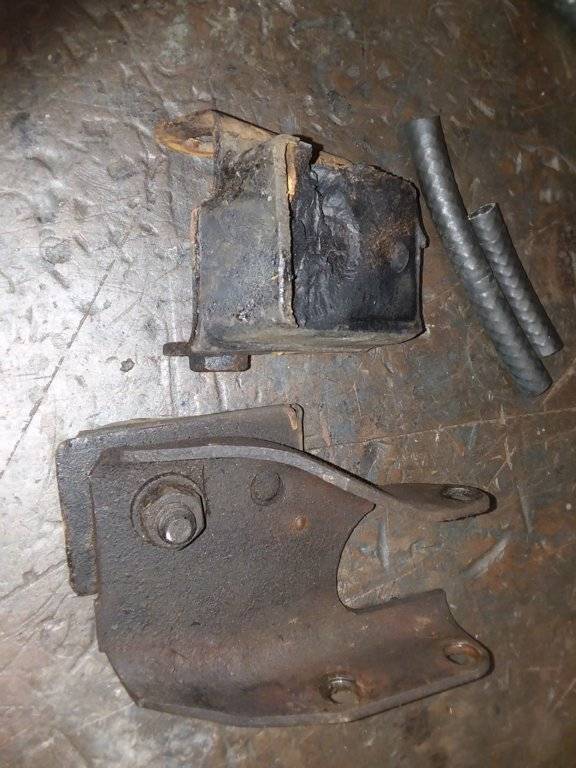

Motor Mounts (came with car, made in Korea)
Usual crack at top of left side mount

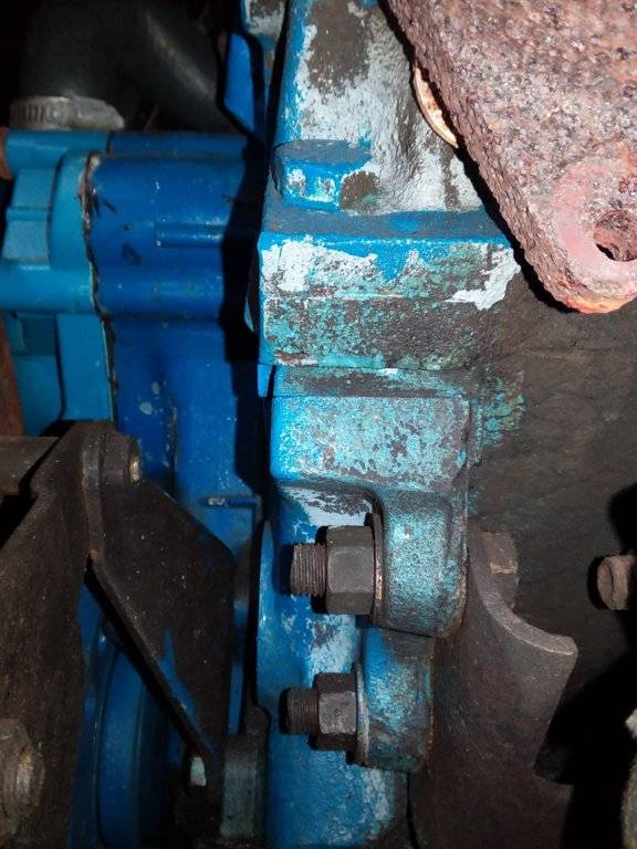

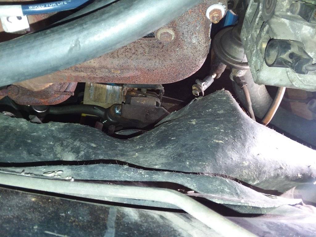

LS Mount is buried behind steering gear and pump bracket. Need engine lifted to get access.
Front nuts of LS mount. Both mounts are behind engine block lugs.

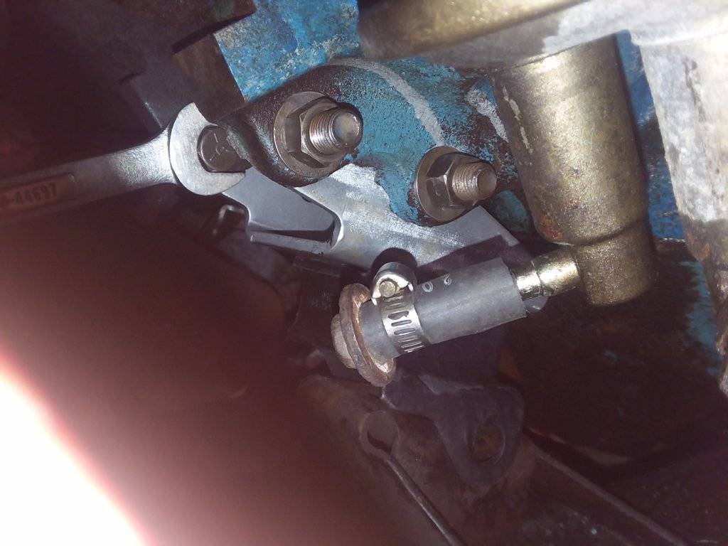

Couldn't get 1/2 ratchet on front nuts. Had to make do with 3/8 breaker bar, 5/8 short socket and cheater pipe to break it loose.
LS Mount & Bracket removed
Another angle

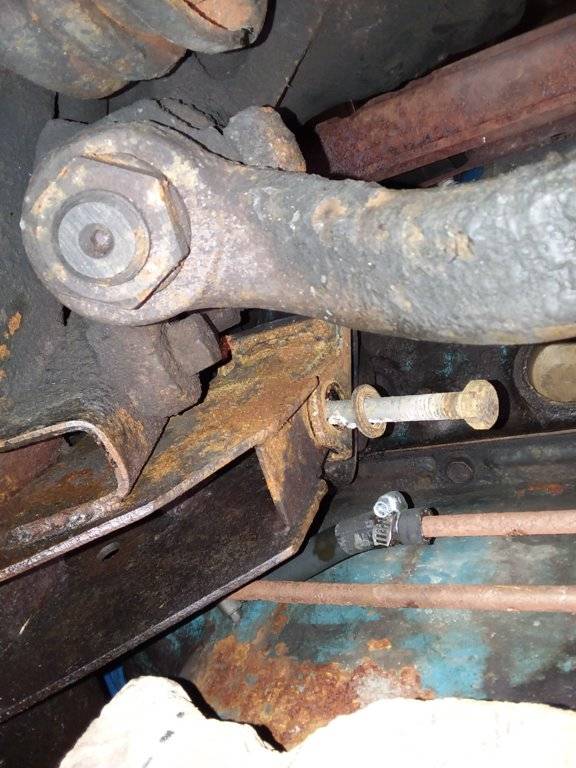

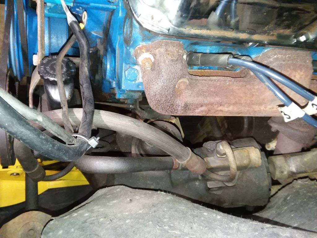

Right Side Motor Mount, subframe bolt

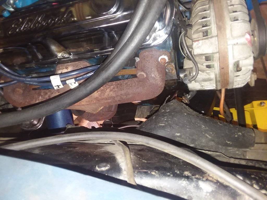

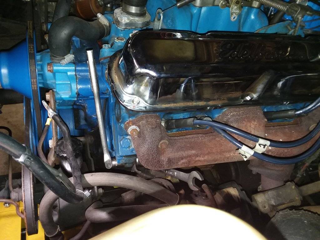

I removed the lower radiator hose, so clearance around the back of the fuel pump was not a big issue.

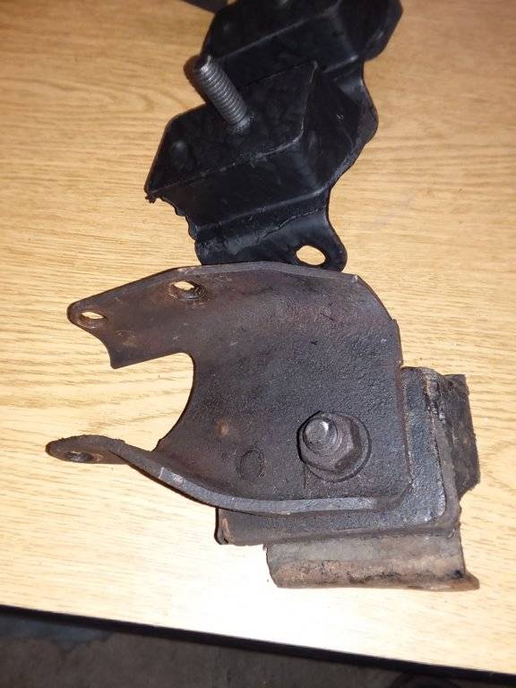

It's also a pain that one of the 360 mount brackets is different from 318. I think it's the right side, but I'll certainly take correction on that if wrong.
1972 Fury LS 360 Mount & Bracket
1970 Fury LS Bracket 318
Don't have pic of 1970 318 RS Bracket, but I've always thought it was stupid of Chrysler to make the any of the SB brackets different

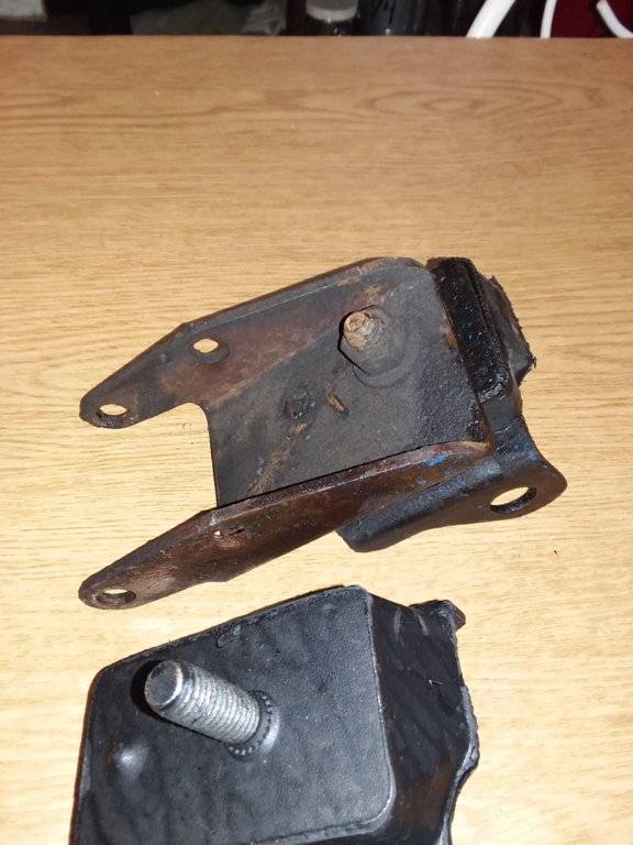

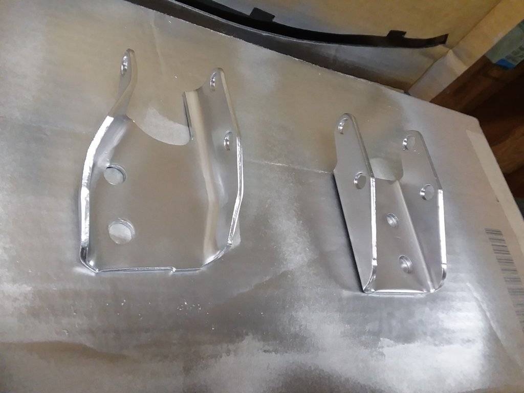

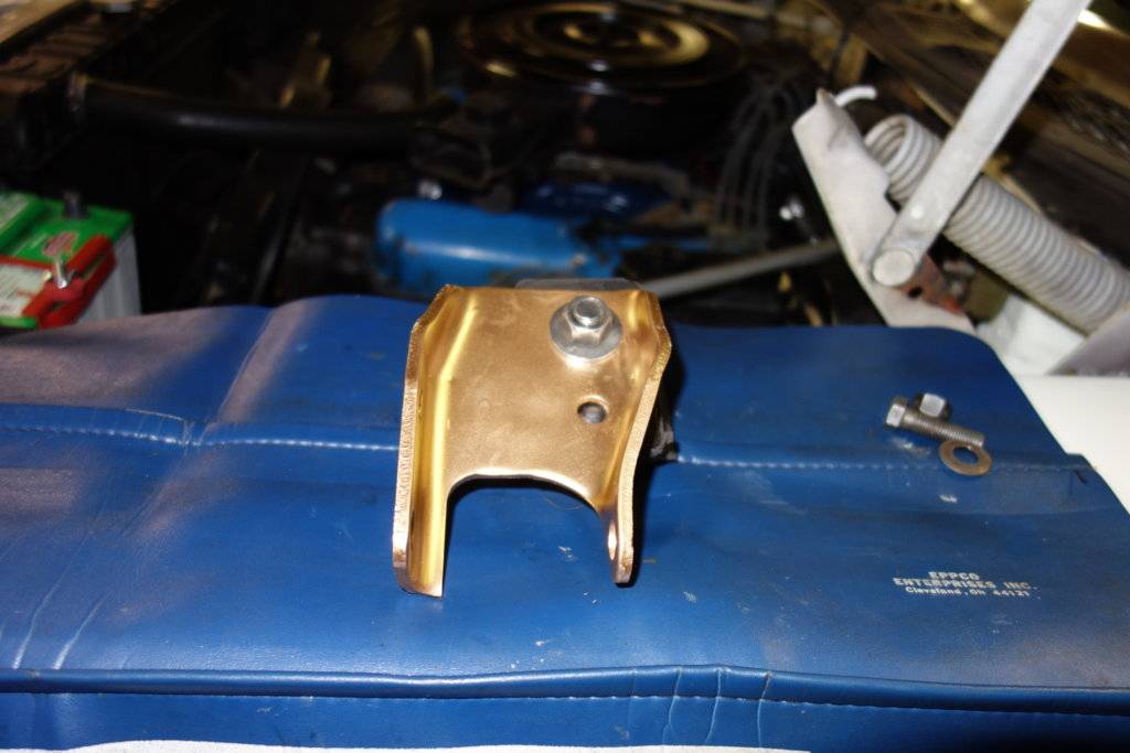

Motor Mount Bracket Clean Up

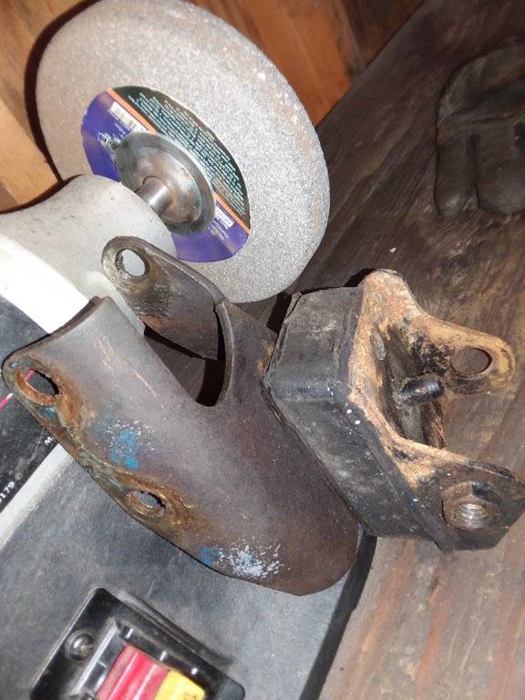

LS Bracket after I tried to remove the motor mount in a vise

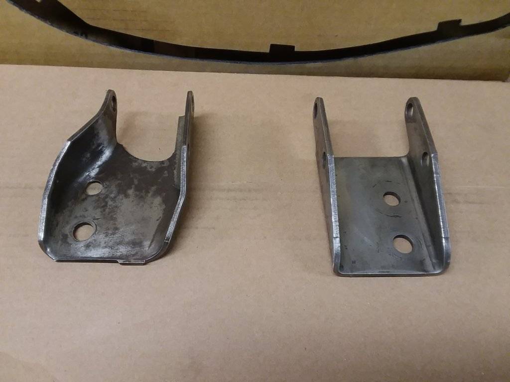

After wire wheel and 240 grit sandpaper. More rust on Left side mount.

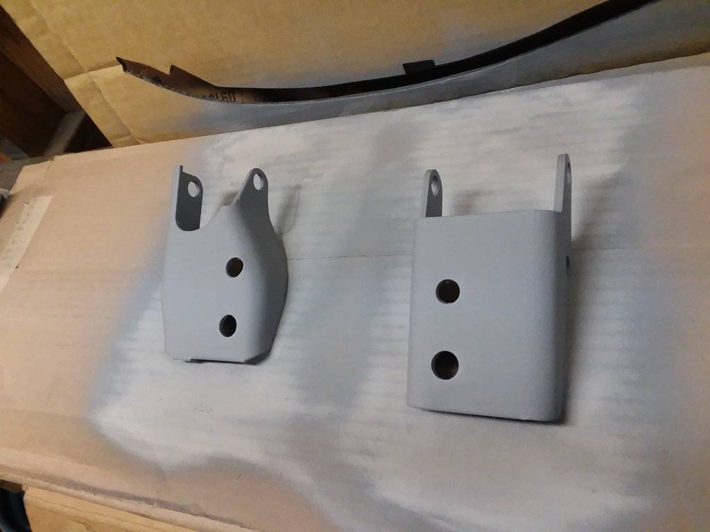

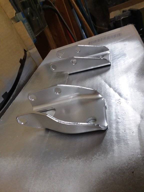

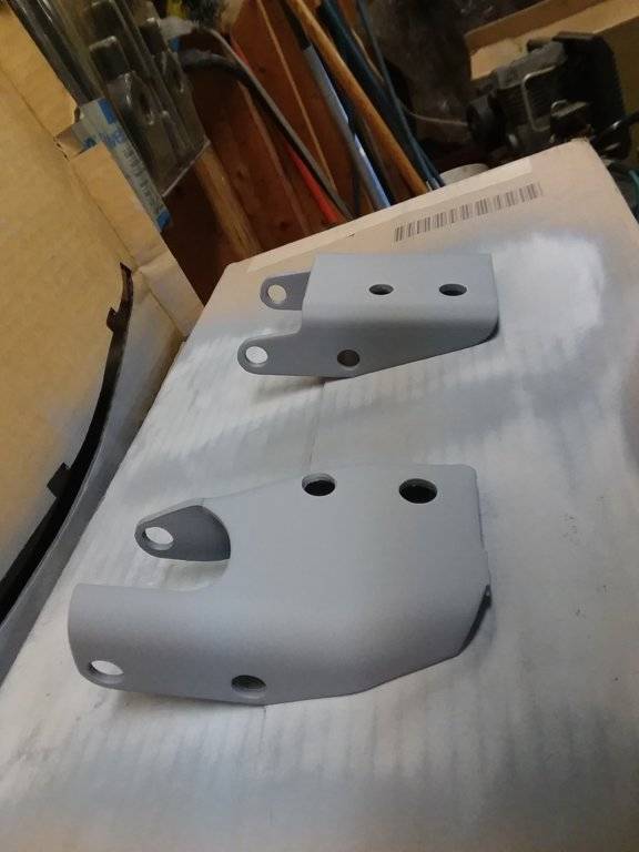

Grey Primer, 2 coats, both sides

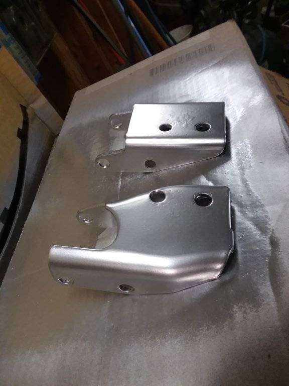

Red Devil Metallic Finish, 2 costs, both sides (Why not black? Fury isn't factory original and silver shows up better in pictures)
360: LS is curved on sides, RS is straight on both sides, but both mount behind block lugs.

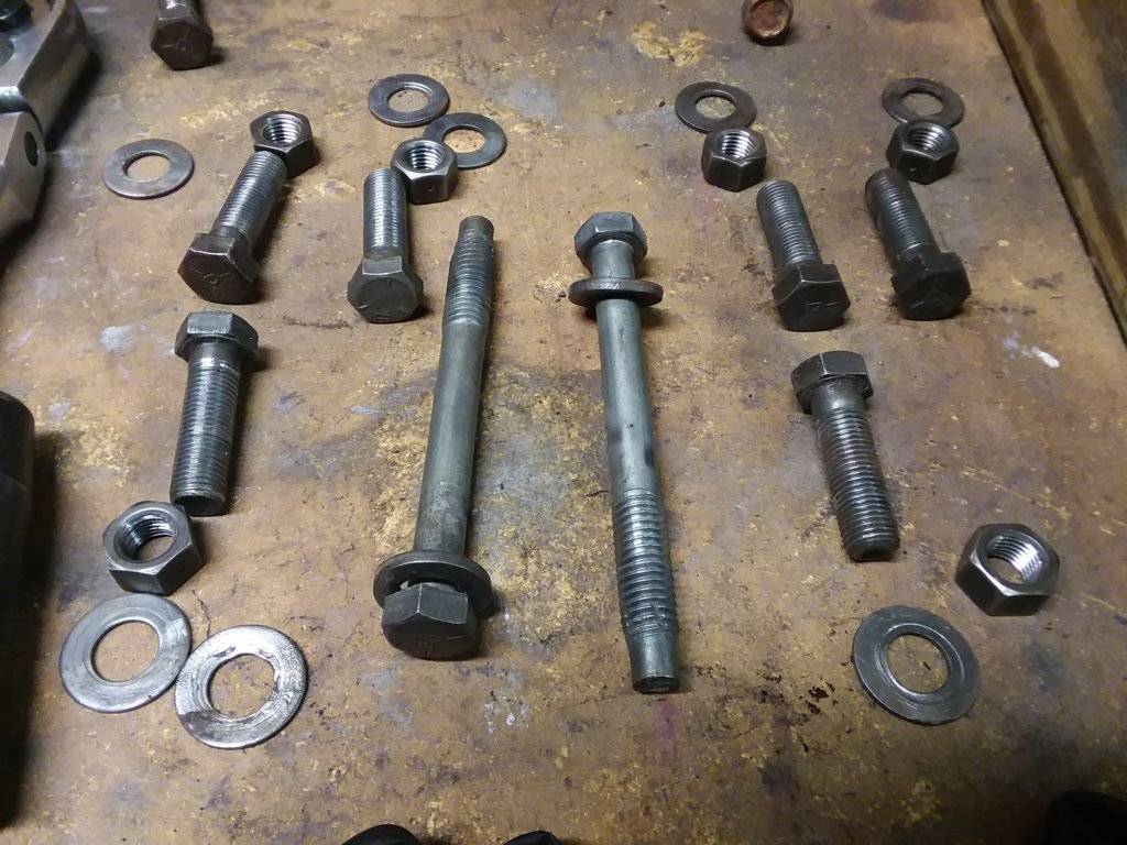

Bolts, nuts and washers: wire wheel, tap & die
What do you do in between coats of paint? Clean 46 years of rust and oil off engine mount bolts, nuts, and washers
Throw 2 bolts and 2 nuts into the recycling can because rust and thread damage are just too much. Then scrounge bolt boxes and spare parts for matches and clean those. BTW, you need a good radio station while doing this. Very dull stuff. I once watched a master engine builder doing a video on rebuilding a 440. He looked at the camera and said, "If you don't like cleaning, you better get another hobby." Then he went back work.

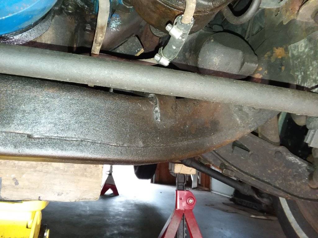

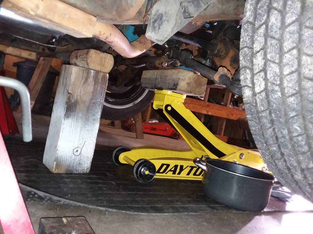

Jack and wood block under engine oil pan: Room to Move

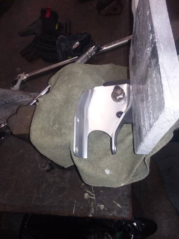

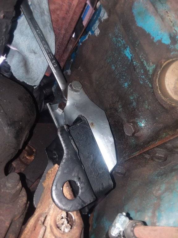

Install motor mounts on brackets @ 75'lbs in a vise. Mount to bracket stud is completely inaccessible, once bracket installed. Wood block kept motor mount aligned with bracket.
LS from Rear: bolts installed at 55"lbs. Cleaned up bolts make install much easier than removal.
RS from front
Another view

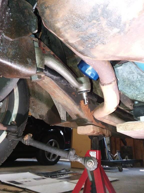

Center Link has to be removed 1st. LS
RS
Removed cotter pins and castle nuts. Pickle Fork & Sledge to knock center link off pitman, idler, and inner Tie Rod Ends
Idler & ITRE. Ugh, seen this view before
Pitman & ITRE. This view's new

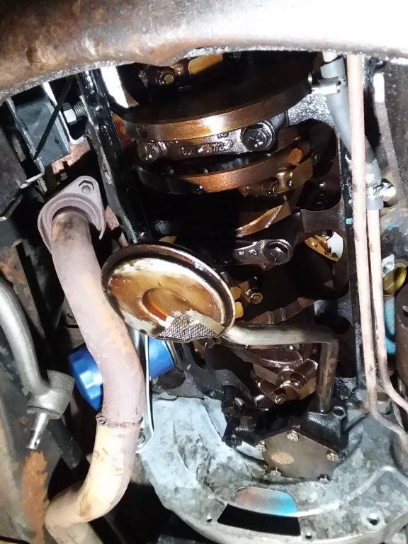

1/2" short socket, swivel, 10" extension, and 3/8 air ratchet made short work of the oil pan bolts with engine lifted a little above normal position. View of 360 V8 pickup and oil pump with pan down
Most important discovery of the day: new double roller timing chain. Yes!
Close up

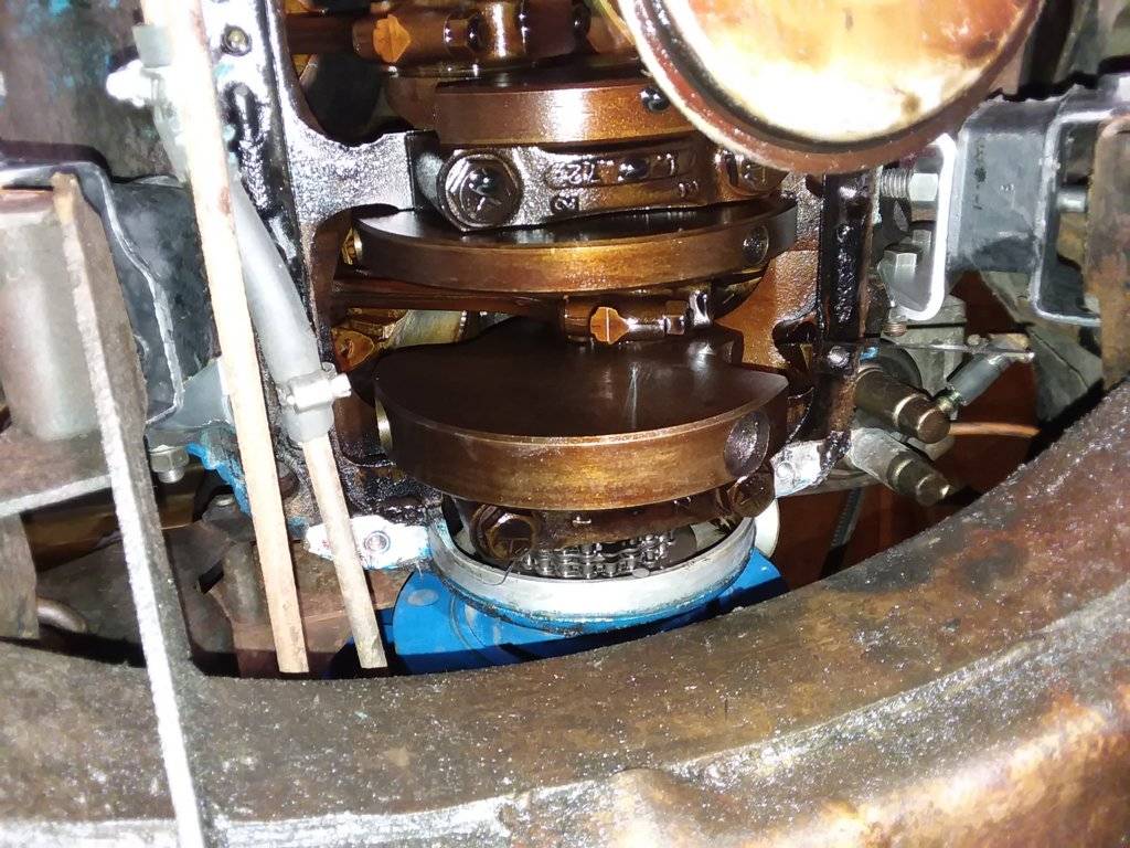

Block: RS motor mount & dipstick

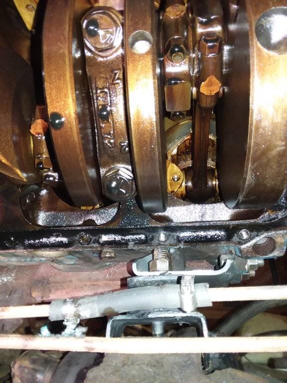

LS motor mount. #1 connecting rod showing
Block oil pan rail, RS
Block oil pan rail, LS

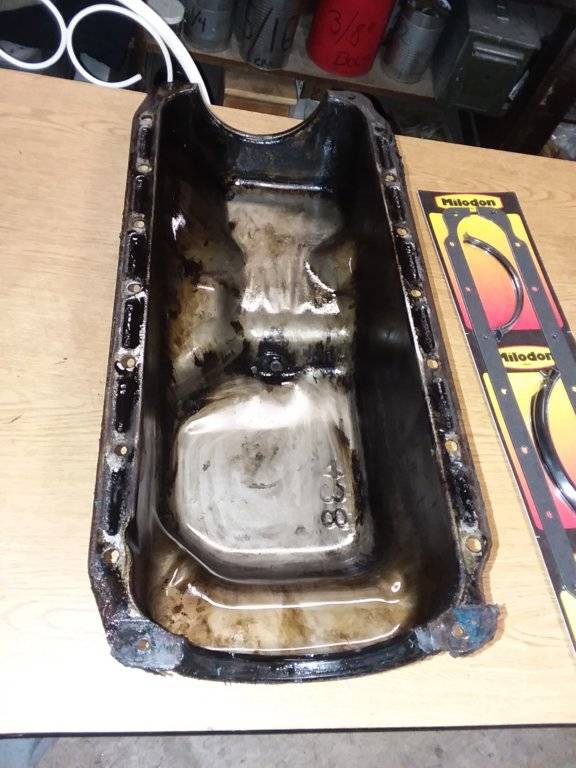

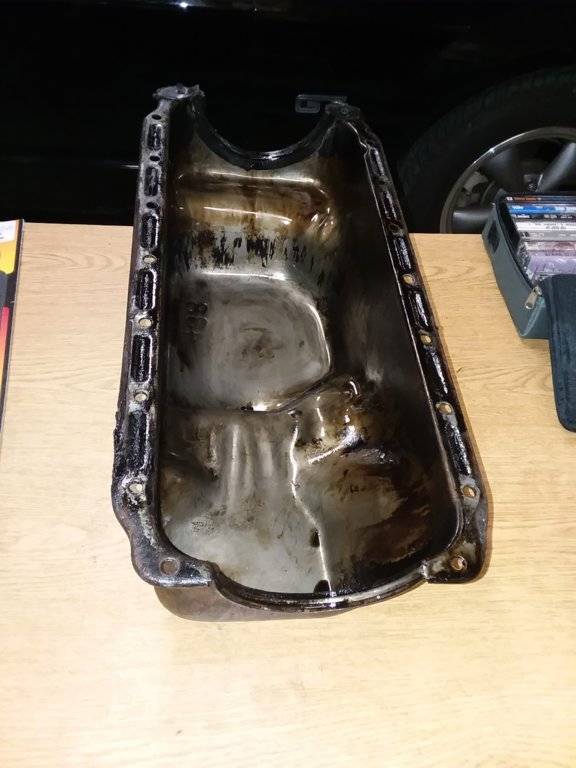

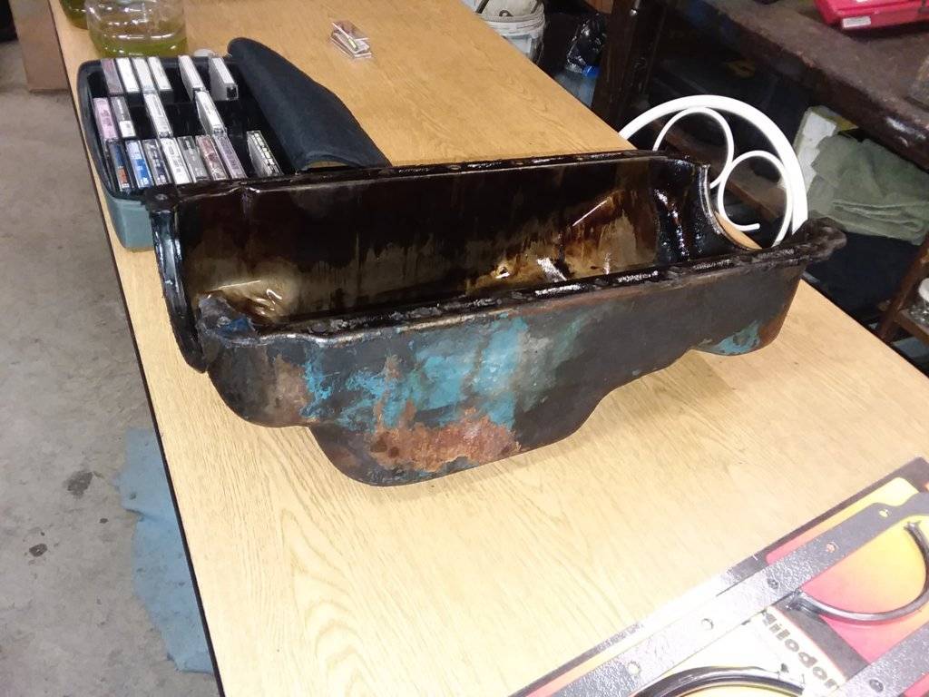

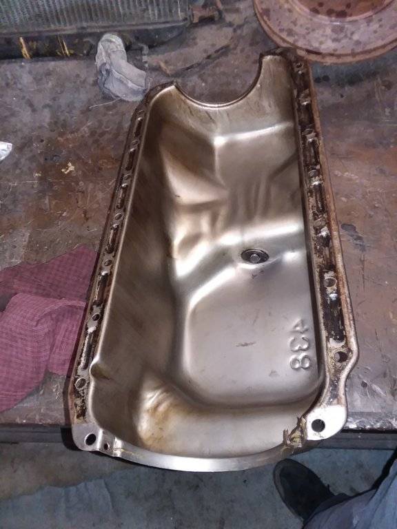

1972 360 V8 Oil Pan
Wiped with rag. Almost no debris.
Where were all the broken valve seals? In the oil pickup below the screen. Look what I scraped out of the pickup with a screwdriver and a piece of bent coat hanger:
Not sure what the silver pieces are. Feel like very flexible plastic. Definitely not metal or rubber.
Oil pump is going to have to come down to remove & fully clean out the pickup

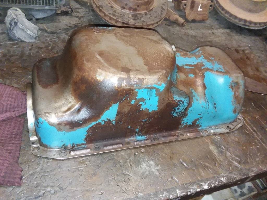

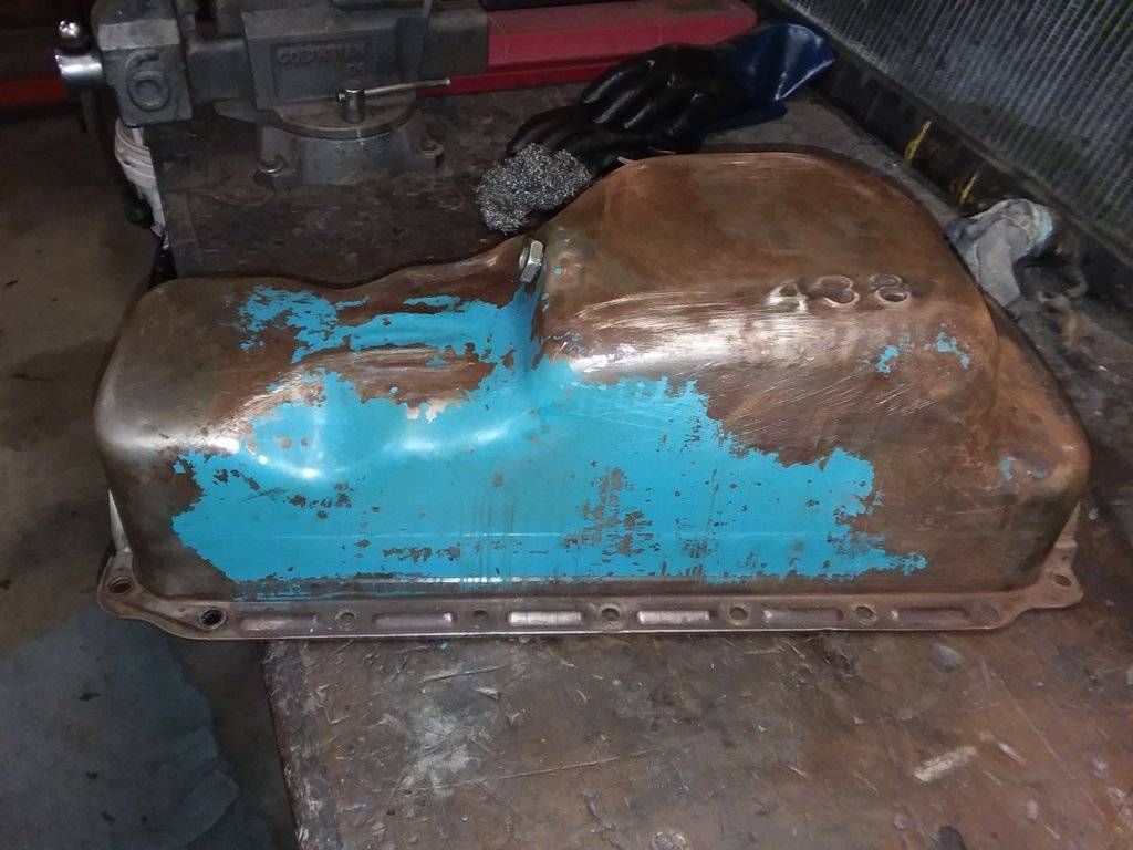

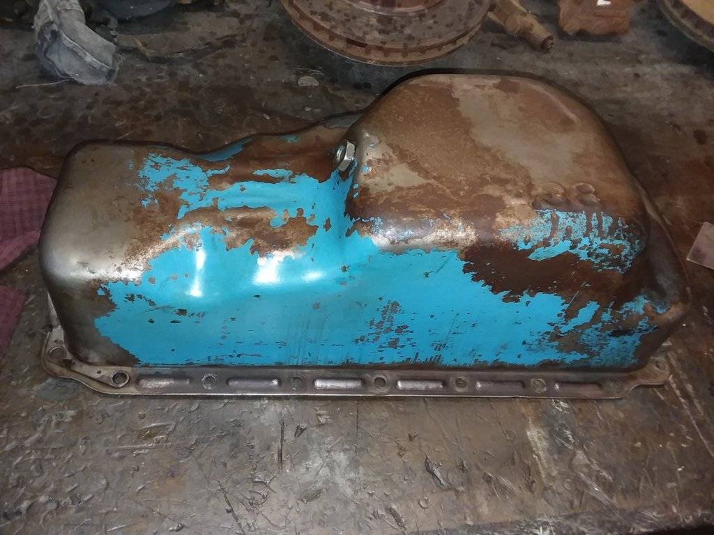

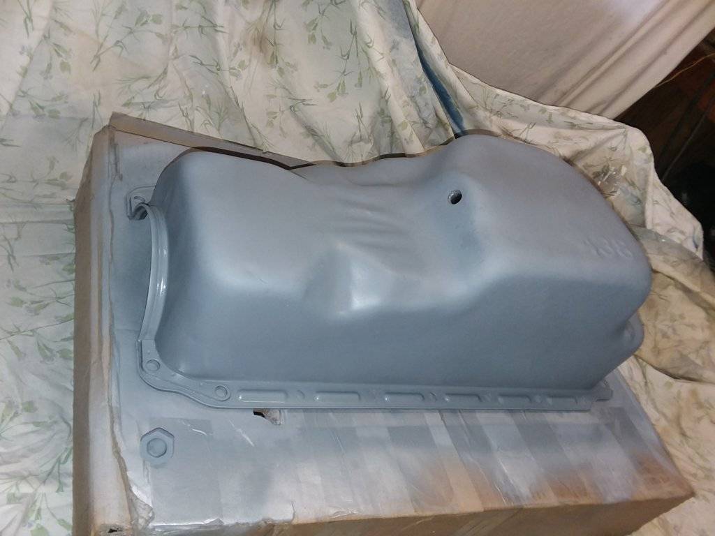

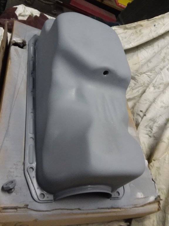

Started on pan cleanup. Rags, chemicals, and steel scrub pads
Not perfect, but the bulk of the grease is off it now
With grease embedded in rust, had to resort to 60 grit sandpaper
Hope to detail it tomorrow and get a coat of primer on it

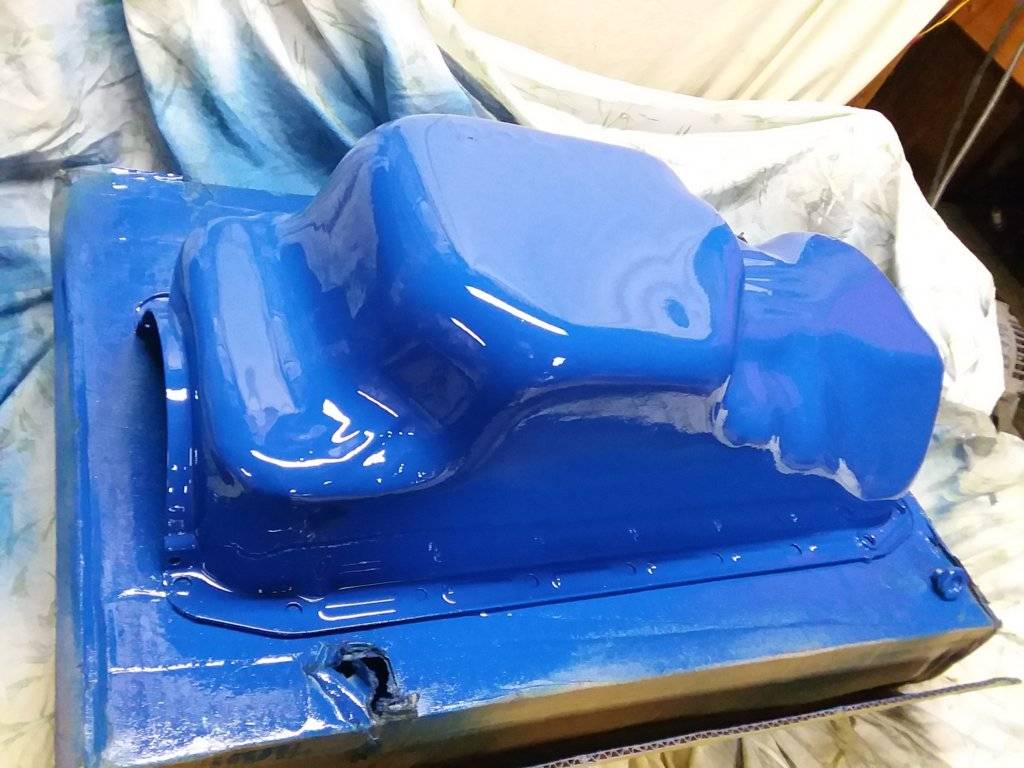

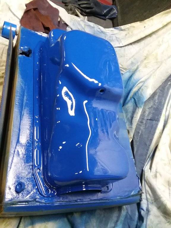

Oil Pan Paint
Advance Auto did not have Chrysler engine blue, so I tried the lightest shade of Ford engine blue. Still too dark
At least it's underneath. One day, after I do the 440 in convertible, I'll pull this 360 engine and detail it correctly.
