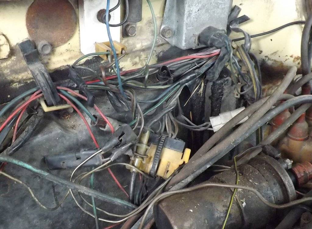

Hey Ben, quick question on your car for my own use, does your electronic ignition harness plug in like on my 73? Check my pic, you will see a bulkhead connector plugging into another harness piece with a zip tie around it. I ask because I want to replace mine and I an wondering if it is only in 73 cars, I'm hoping it is in others though. My 72 and 73 harnesses out of my NYB's don't have this plug.
Hey Ben, quick question on your car for my own use, does your electronic ignition harness plug in like on my 73? Check my pic, you will see a bulkhead connector plugging into another harness piece with a zip tie around it. I ask because I want to replace mine and I an wondering if it is only in 73 cars, I'm hoping it is in others though. My 72 and 73 harnesses out of my NYB's don't have this plug.View attachment 227383
Hey Gary. My car was point ignition 360 V8. Build date 5-72. I don't think 72 cars are going to help you unless big block cars got electronic ignition.

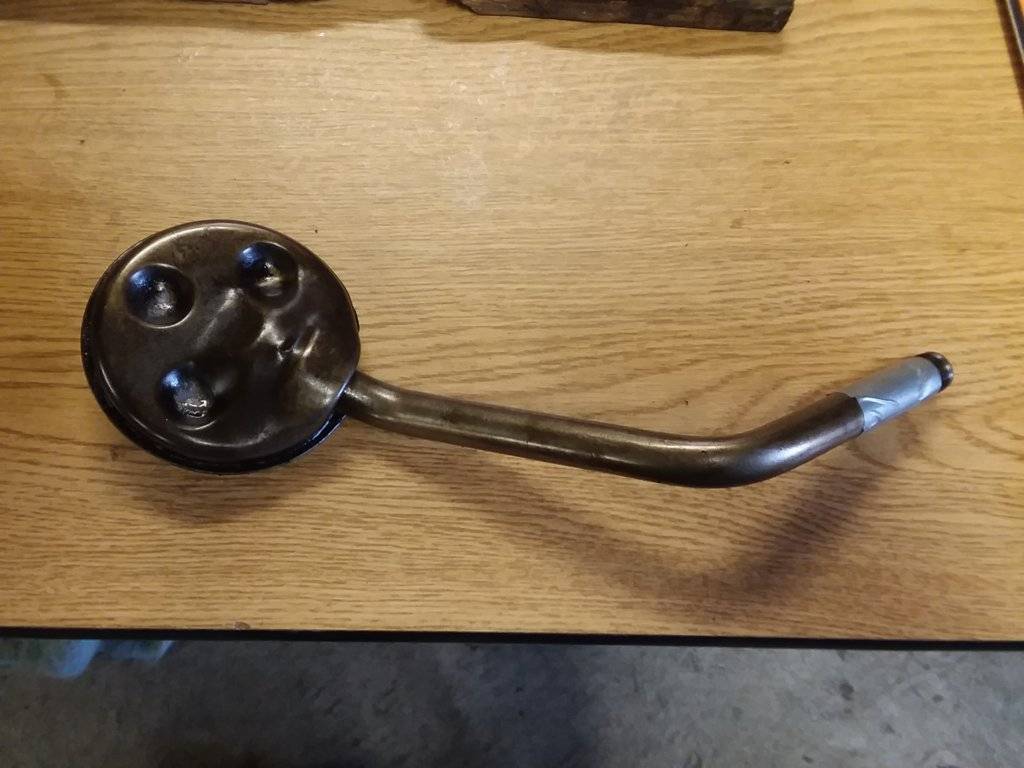

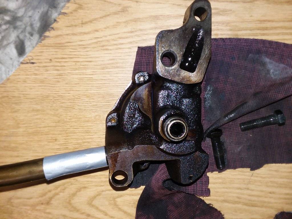

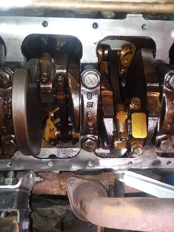

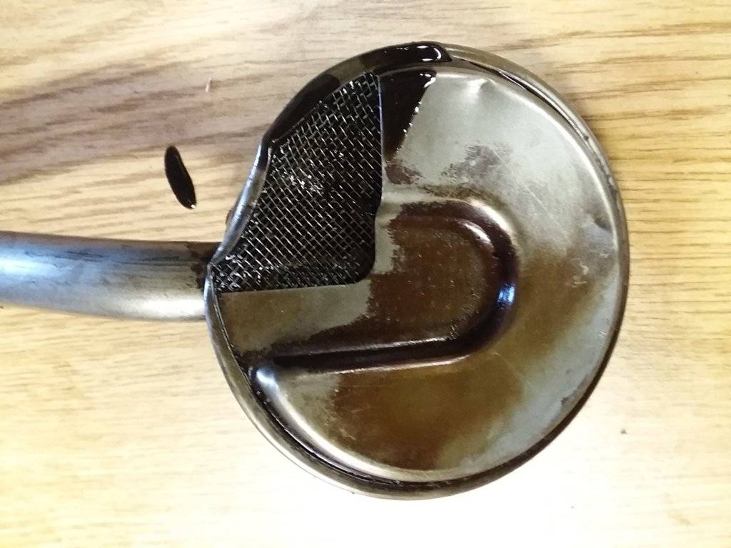

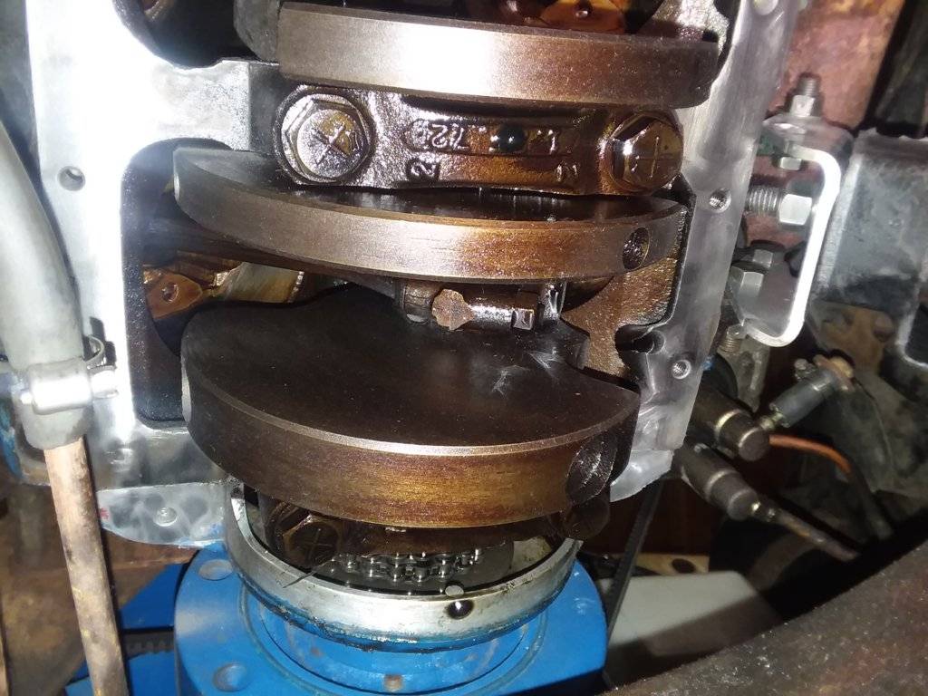

Oil Pump & Pickup: removed. I know, 2 bolts, big deal. Pickup unscrews by hand.

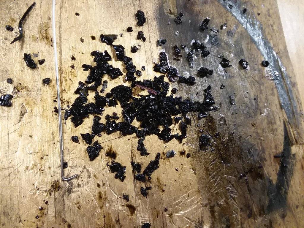

After about 30 minutes of shaking and knocking against the board and more scraping, here is what came out over that 30 minutes.
This is in addition to what I scraped out the other day
Who knew it could hold so much junk. Must have been getting oil only thru this opening.

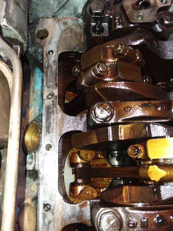

Scraped engine block oil pan rails, paint scraper with straight blade
Right side

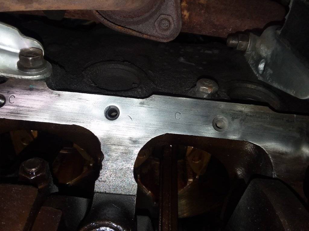

Right rear. Interesting that Chrysler stamped C along the pan rails. (I saw it at least twice. C in picture is beside engine to trans support strut bolt) Wonder what it means?

C marks are evenly spaced down both pan rails

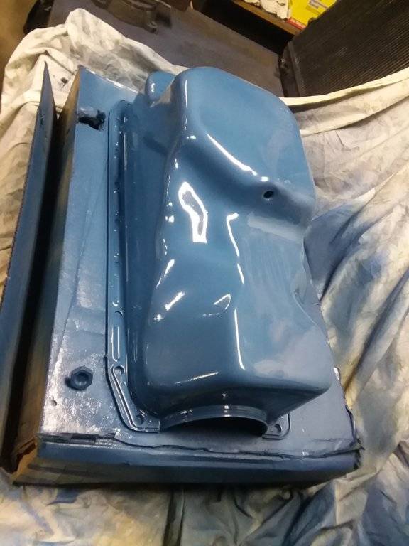

Cleaned pain rails with die grinder and Roloc discs, 60 grit sandpaper in stubborn spots, 240 grit for general clean up
Oil Pan with Duplicolor DE1631. Not perfect, but a lot closer than Ford engine blue

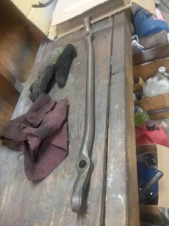

Cleaned the center link. Learned one interesting thing, center link has a casting number.
It's at pitman arm end
Now we can ID a 1972 Fury Center Link at swap meets. Whoopee.

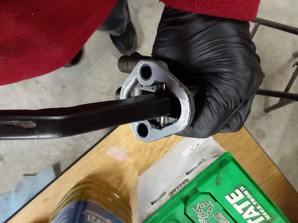

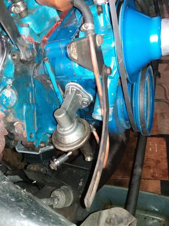

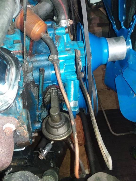

Addressed another leak today. Fuel pump oiling lower radiator hose.

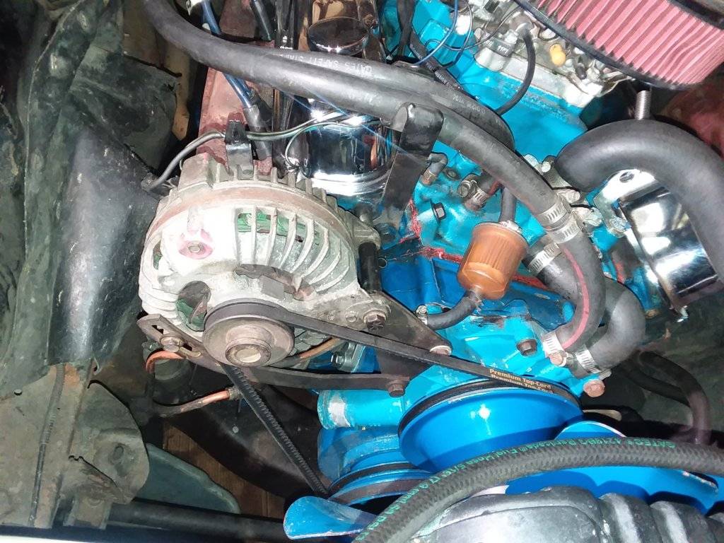

Alternator removed
Carter fuel pump, nothing wrong with it. Bolts installed oily. Had either loosened or were installed with too little torque.

Fuel Pump installed with new gasket, torque 30'lbs
Fuel line installed. Someone used copper instead of steel.
Alternator installed. You'd hardly know I did anything.

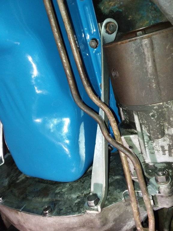

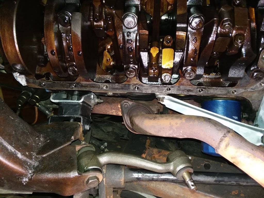

Finally got my replacement hydraulic jack cylinder for my engine crane. Tired of this job so stayed in garage past 9pm to get the oil pan installed and the motor mount lower bolts installed
Oil Pan: installed 200"lbs per bolt. Had to lift the engine to max height without crushing the distributor against the firewall. Next time I think I'd remove the lower bolt from the trans mount, but I was trying to use the trans mount to keep the engine somewhat centered.
Surprising that the pan looked blue gray on the workbench, but fully cured, it came out the right color.
LS motor mount, lower bolt installed at 50'lbs. Crane was good for centering the mounts on the subframe mounts.
RS motor mount, same deal, 360 block does not have a mount for the open hole pictured
Milodon gasket set I used. Summit Racing, purchased on ebay
Basically, I used RTV to attach the rear rubber to the rear main and attach the front rubber to the oil pan. I used twist ties to keep the rail gaskets in place during install and removed the twist ties before final tighten.

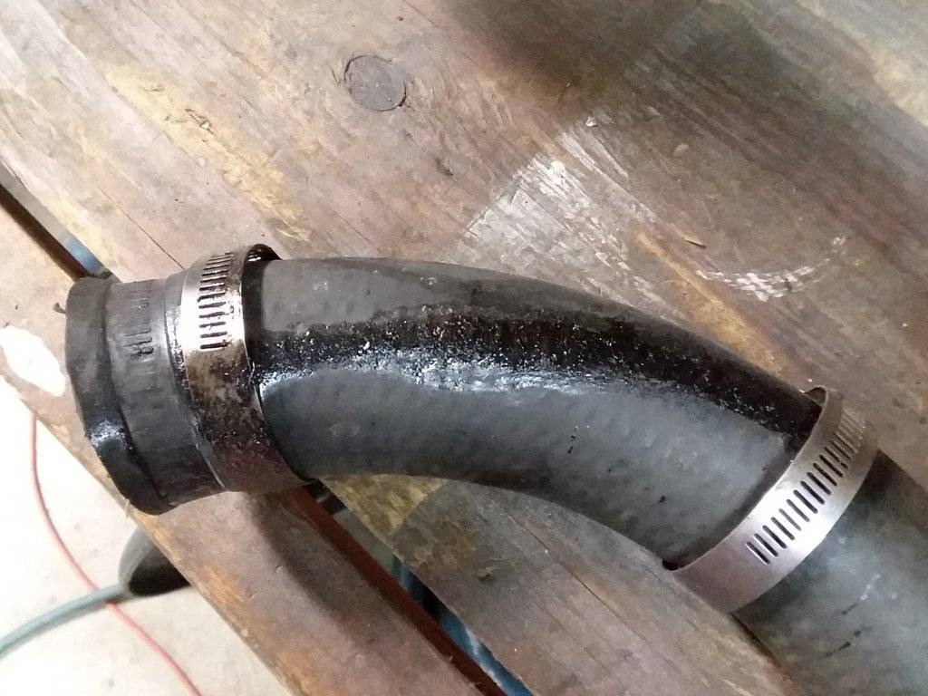

Then there is that hose on the transmission line...

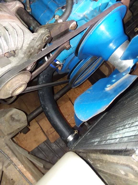

NAPA price matched Advance on a 745 hose, $13.99. After I cut 1.5 inches off each end, it fit perfectly. I added back my coolant.
Also, added 5 quarts of NAPA 20W50. Works great in Virginia, not too cold for extra thick oil. That and a NAPA 1515 filter and my engine is happy.
