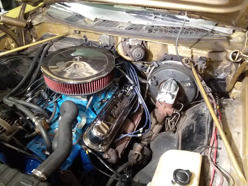

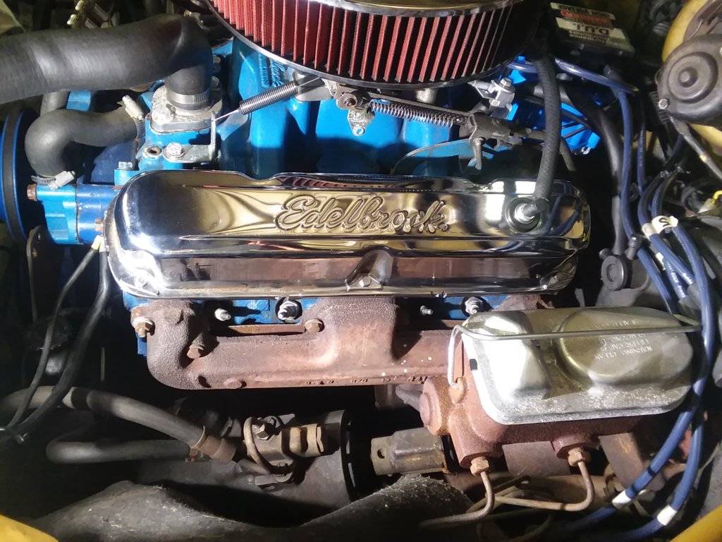

Right Side Valve Cover

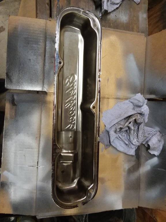

Beginning: cleaned all oil off with die grinder, Roloc discs, and sandpaper

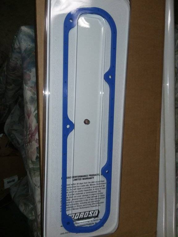

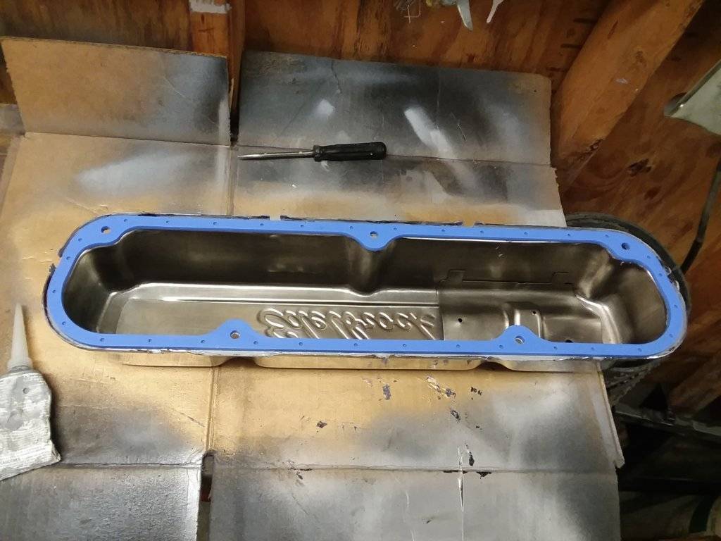

Moroso steel core gaskets
Valve Cover: cleaned off lots of red silicone
Permatex Ultra Grey RTV to hold Gasket in place
Valve Cover installed, still need breather
RS finished

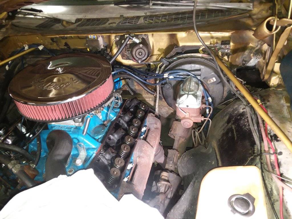

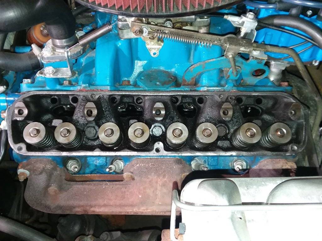

Left side
These pics should give a better progression

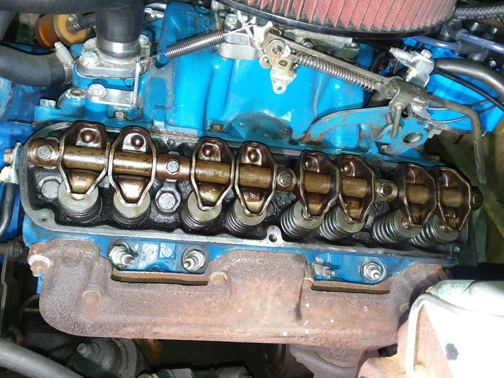

Oily beginning
After die grinder, Roloc discs, and 60 grit sandpaper

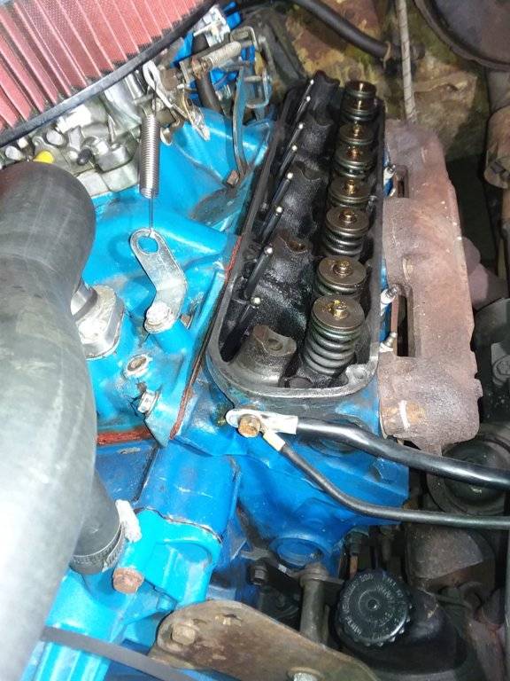

Pushrods installed (below), can see lifters thru large drain holes in head (see above)
Rocker Shaft, surprised FSM bolt torque spec only 210"lbs

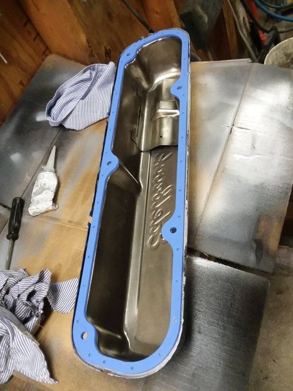

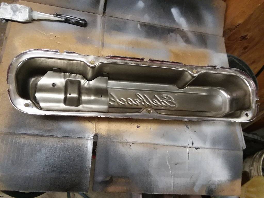

LS Valve Cover, clean, Roloc discs and die grinder really help with fast silicone removal
Permatex Ultra Grey RTV to hold Moroso gasket
Mounted at FSM spec 40"lbs, used torque spreaders to help seal the deal
LS Finished

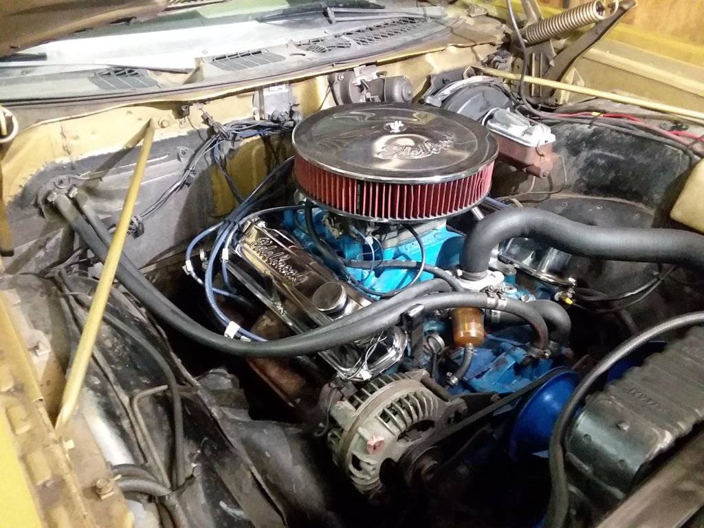

Reinstalled fan, pulley, and belt
Test drive: still a great driver. Only time and more miles will tell if it has stopped using oil.

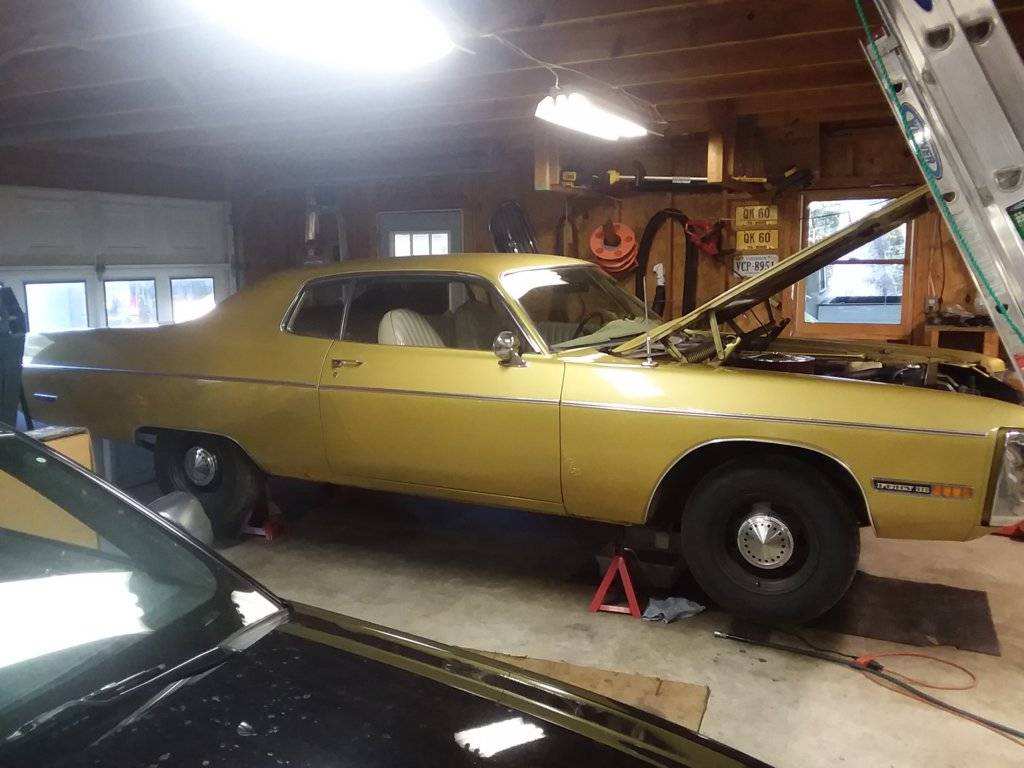

Back in the air:
Upcoming Repairs:
Oil Pan Gasket
Motor Mounts

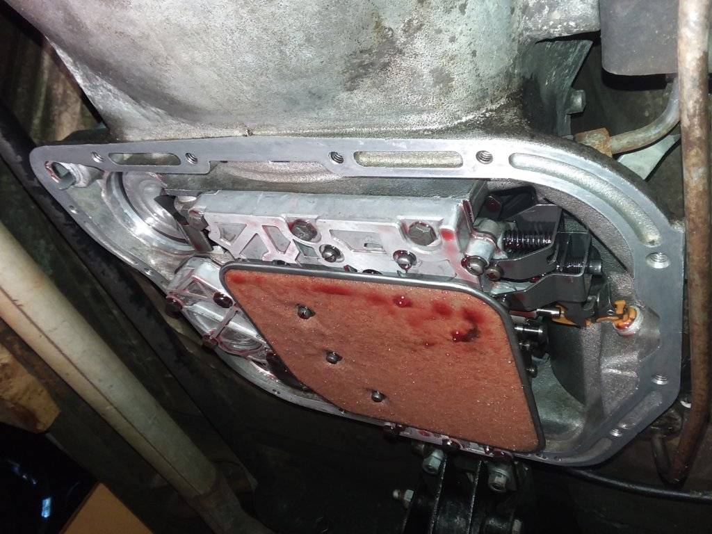

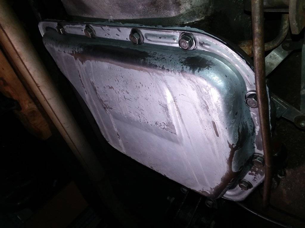

Trans Pan Gasket (new one leaking)
Fuel Hoses Leaking at fuel pump
Trans: shift linkage dry at seal.

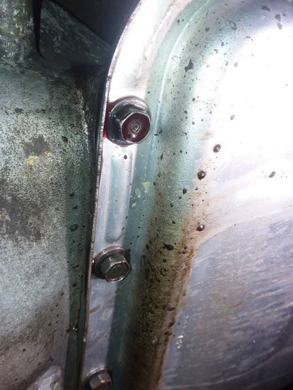

Bolts at left front where trans pan leaking

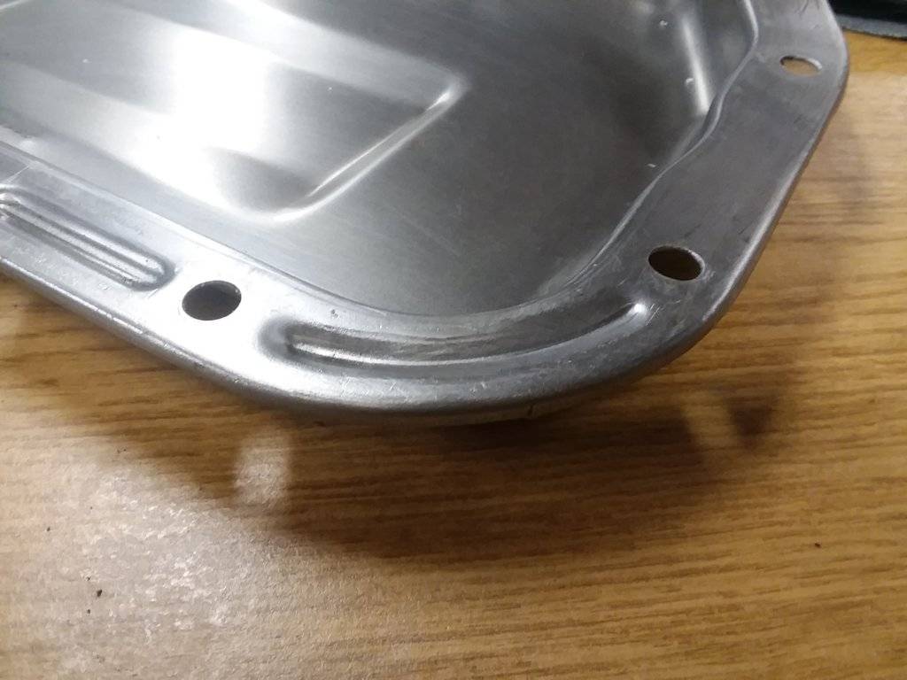

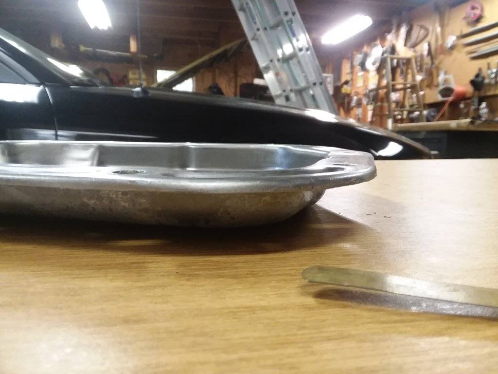

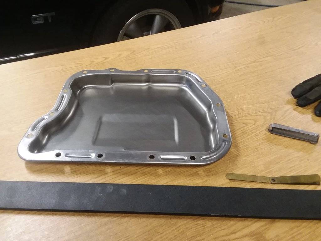

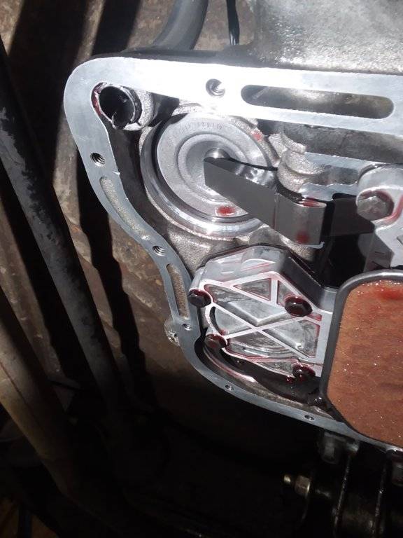

Trans Pan: removed and cleaned again

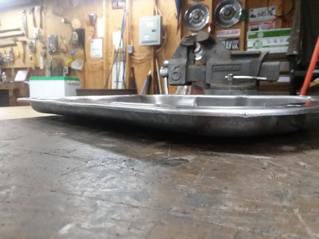

Pan: check with straight edge and .010” feeler gage. Left front corner bent down slightly. Otherwise straight. No dimples at bolt holes.
Bend up slightly in vise. Gap under straight edge closed.
Hope that with a little Permatex at smiley face area, and elsewhere to keep gasket in place, no more puddles under trans after car sits a day or two.

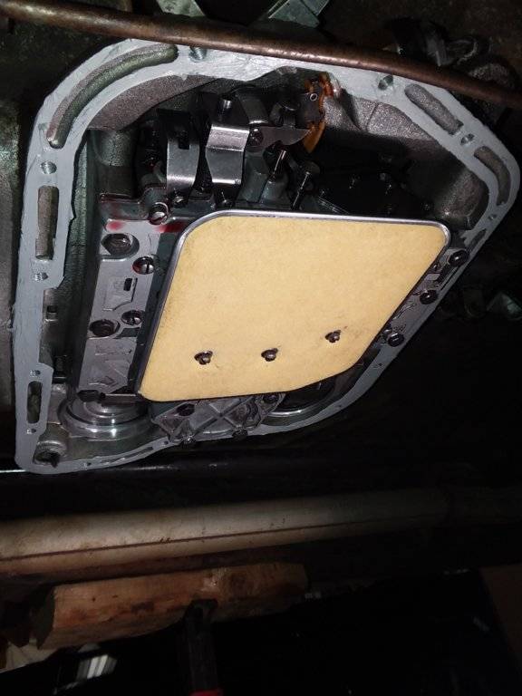

Filter and mounting surface look normal

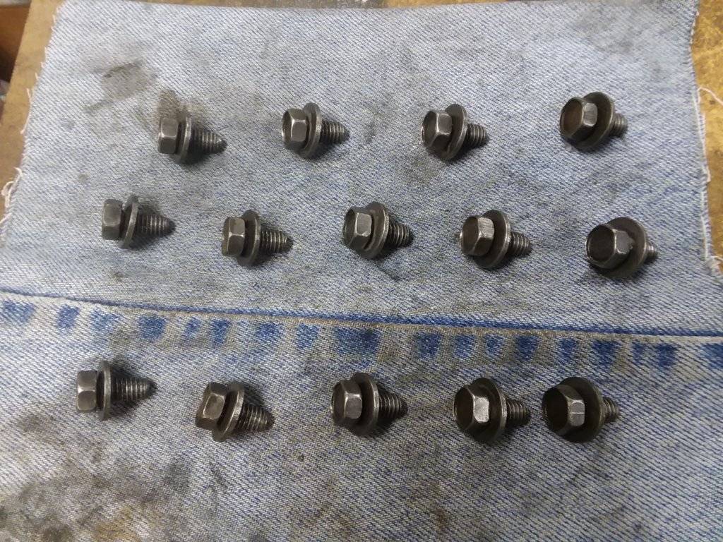

Pan Bolts: after wire wheel and Gunk Brake Cleaner

Had to work fairly late today. The trans pan mounting surfaces got a good sanding with 240 grit sandpaper and the mounting bolt holes got several sprays of Gunk Brake Cleaner. I left the boltholes to dry overnight.

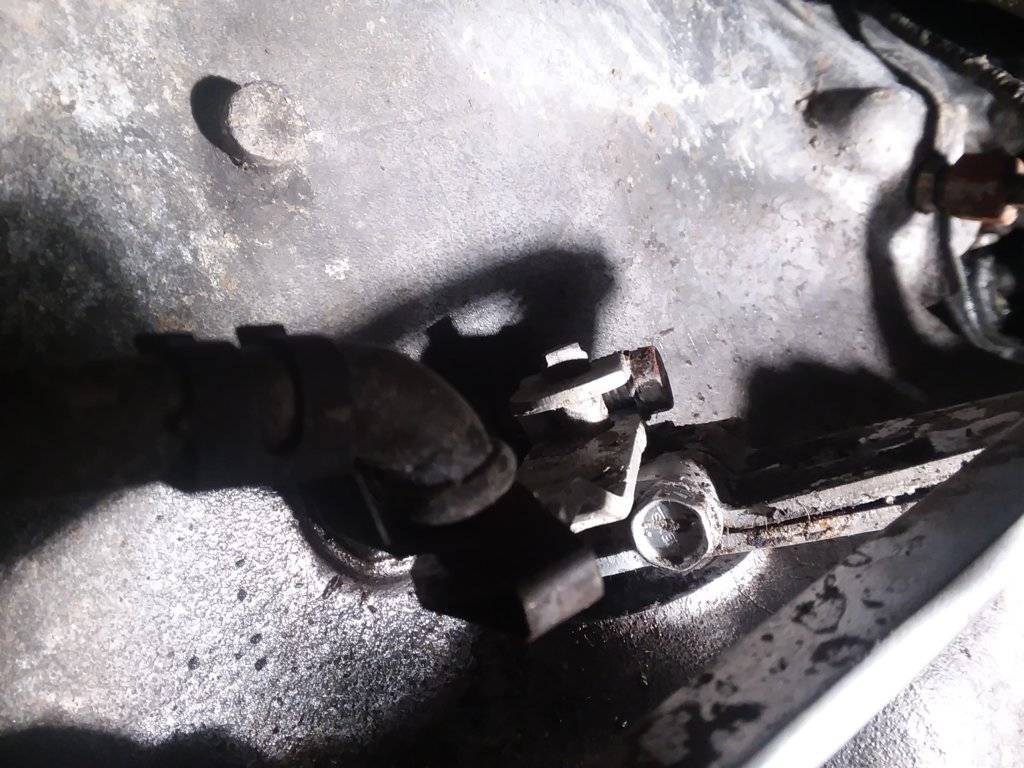

I also pulled the leaking fuel hose between the fuel filter and the fuel pump. I left the filter to drain into a small tub overnight.

Trans pan: Permatex Ultra Grey both sides of NAPA 1-7957 rubber gasket. Hope to alleviate the puddles from sitting a couple days. No leaks while driving or sitting 5 hours. Shift seal, torque converter seal, and dipstick seal are OK.

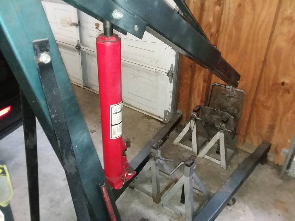

Had a nifty plan to use my cherry picker to lift the front of the engine and make motor mounts easier, except that my 3-ton hydraulic jack gave out. No lift. Anyone know where to get another?
