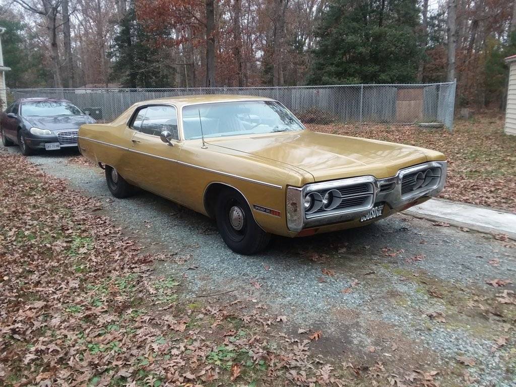

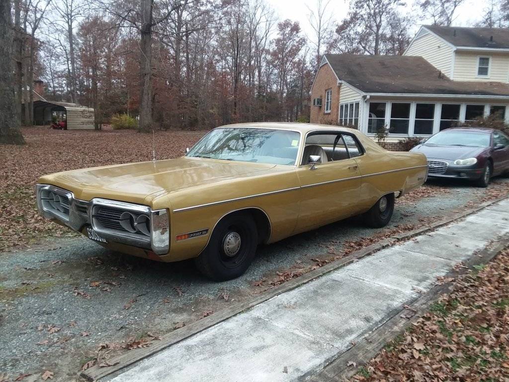

1972 Fury III 360 101498 miles

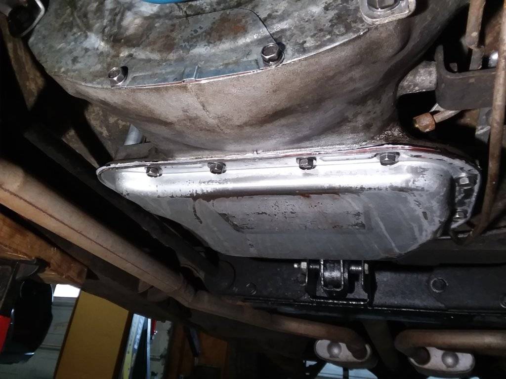

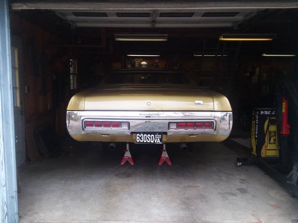

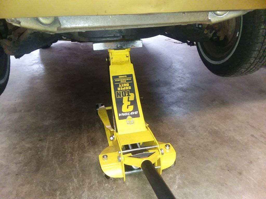

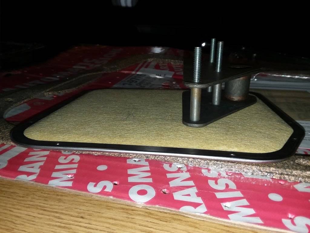

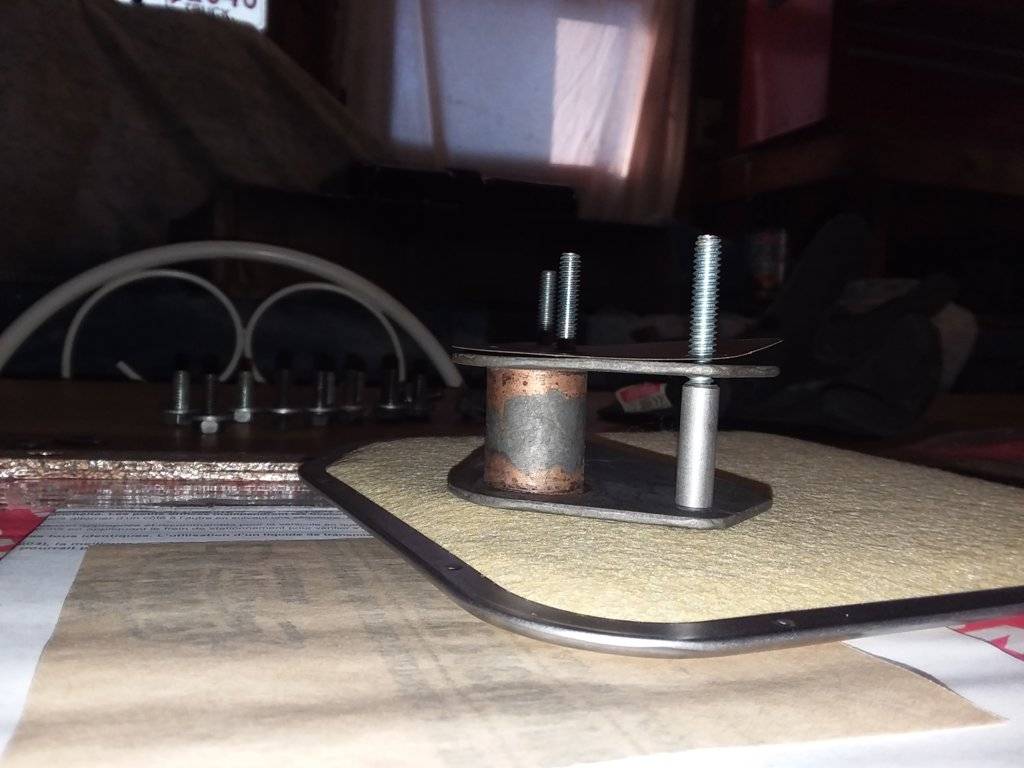

Morning's work: Filter Adapter for deep well
Not sure why phone cam made pics look dark? Plenty of light in garage

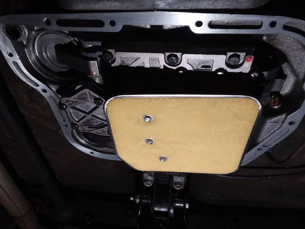

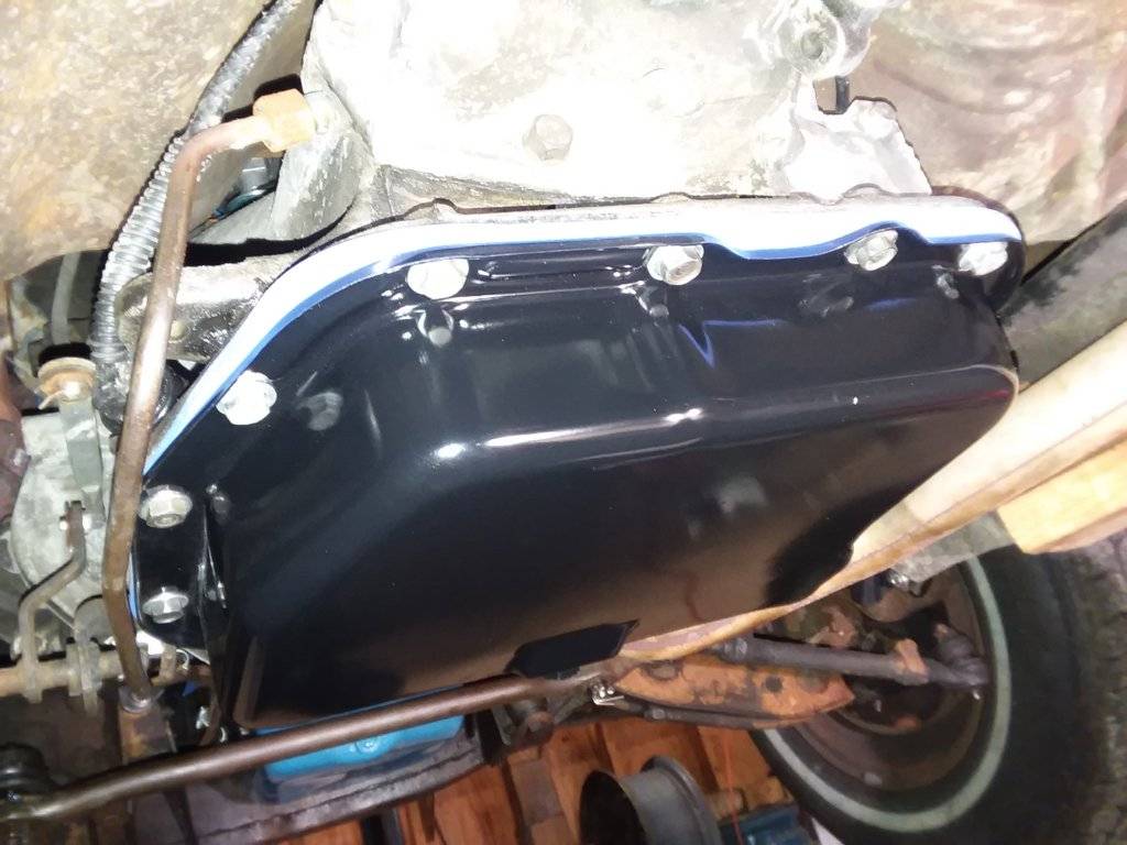

Filter & Adapter Mounted, 35"lbs, 5/16" bolt heads

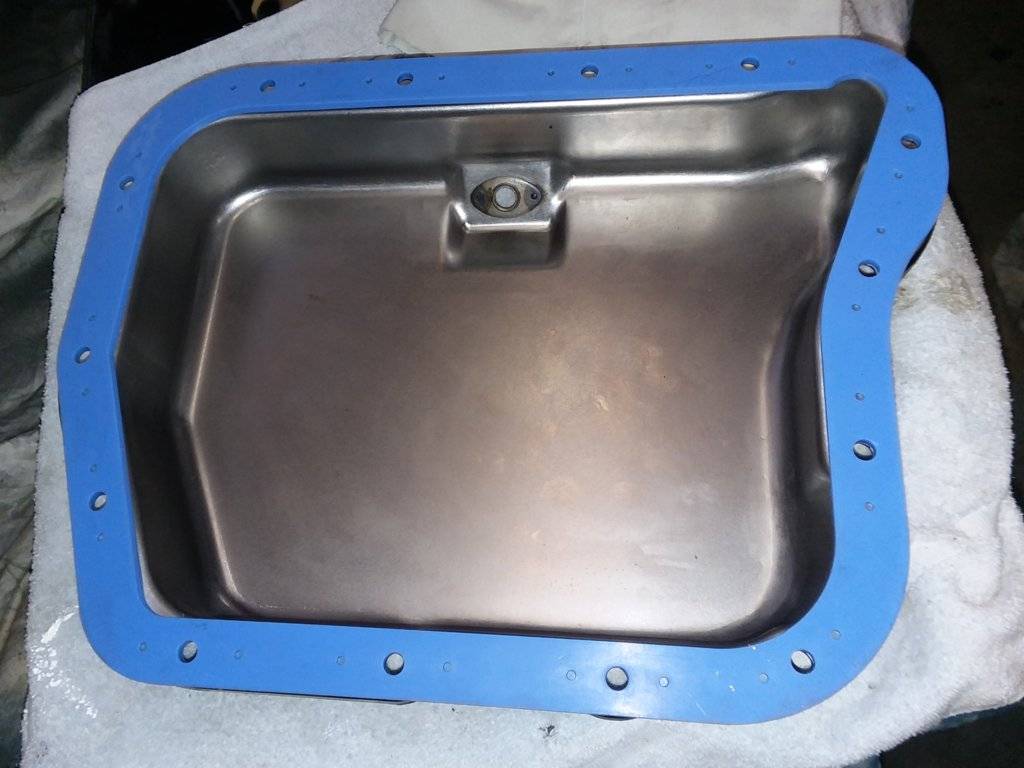

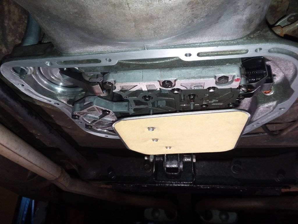

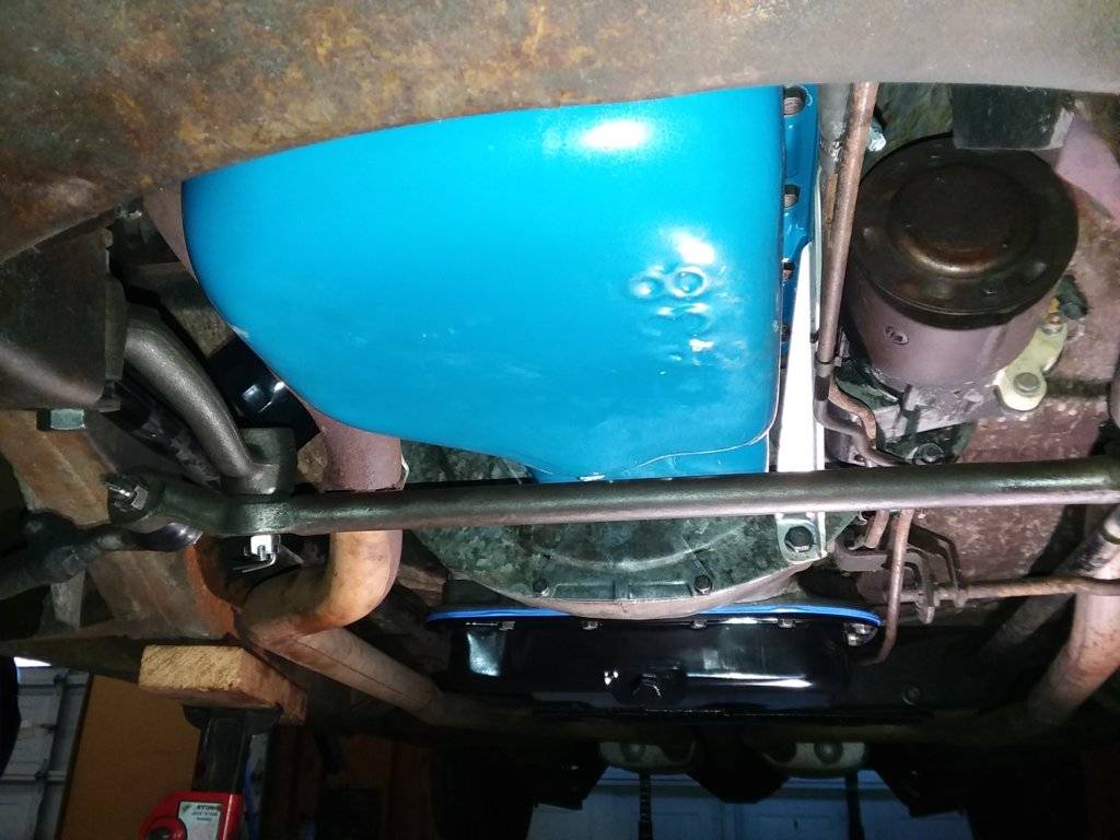

Trans Pan

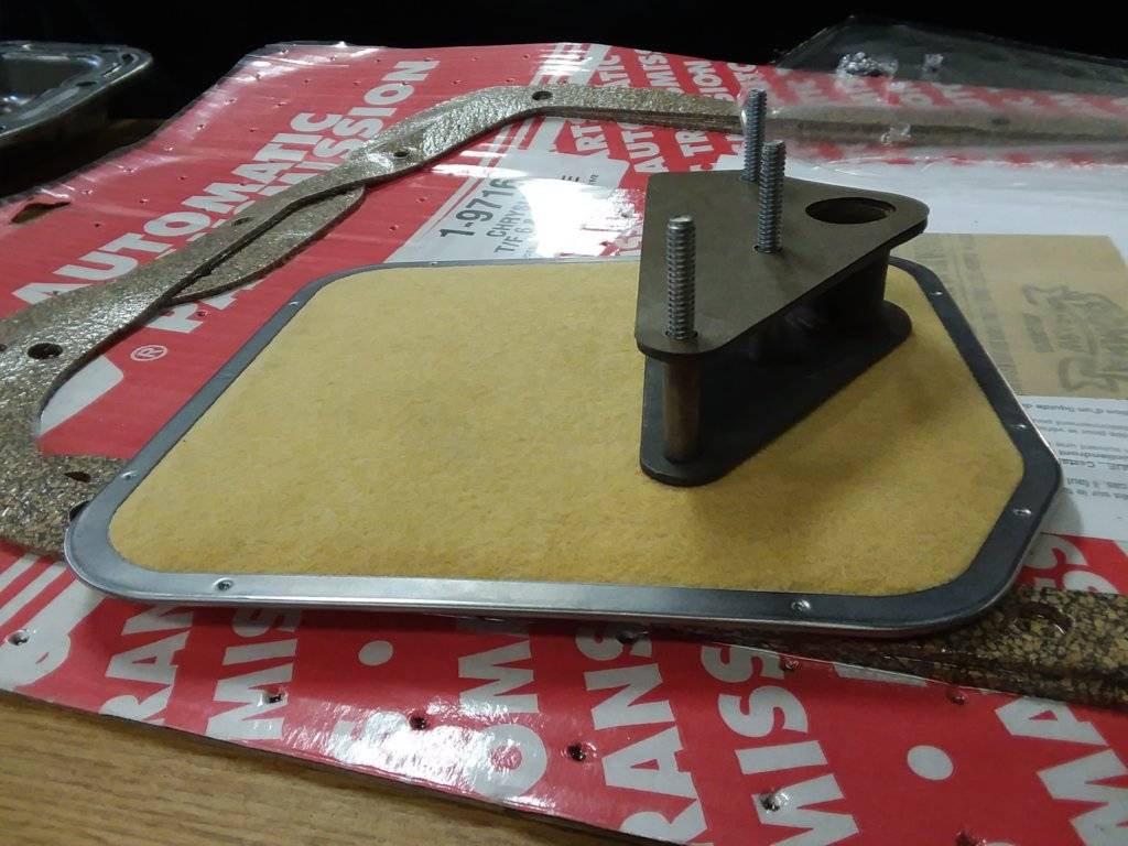

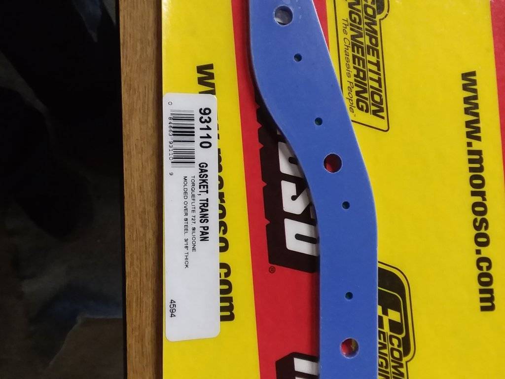

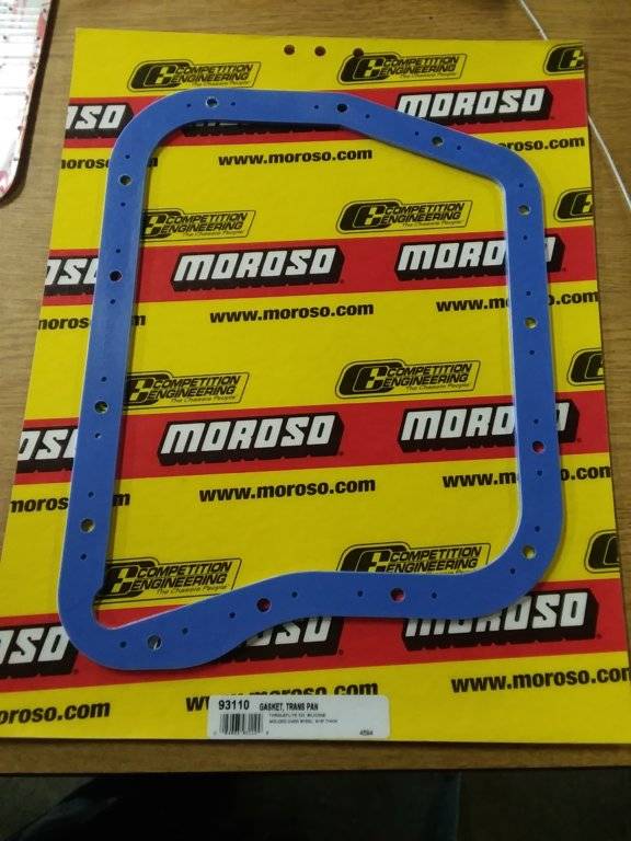

Moroso 93110 Steel Core 3/16 gasket

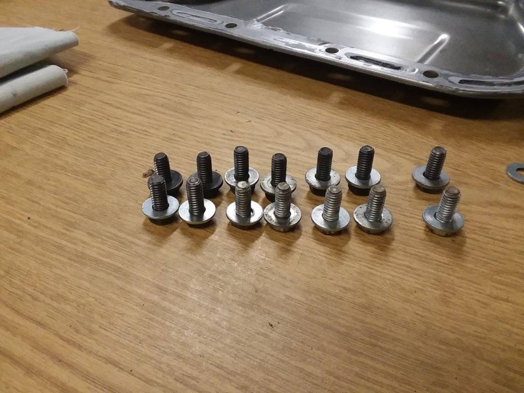

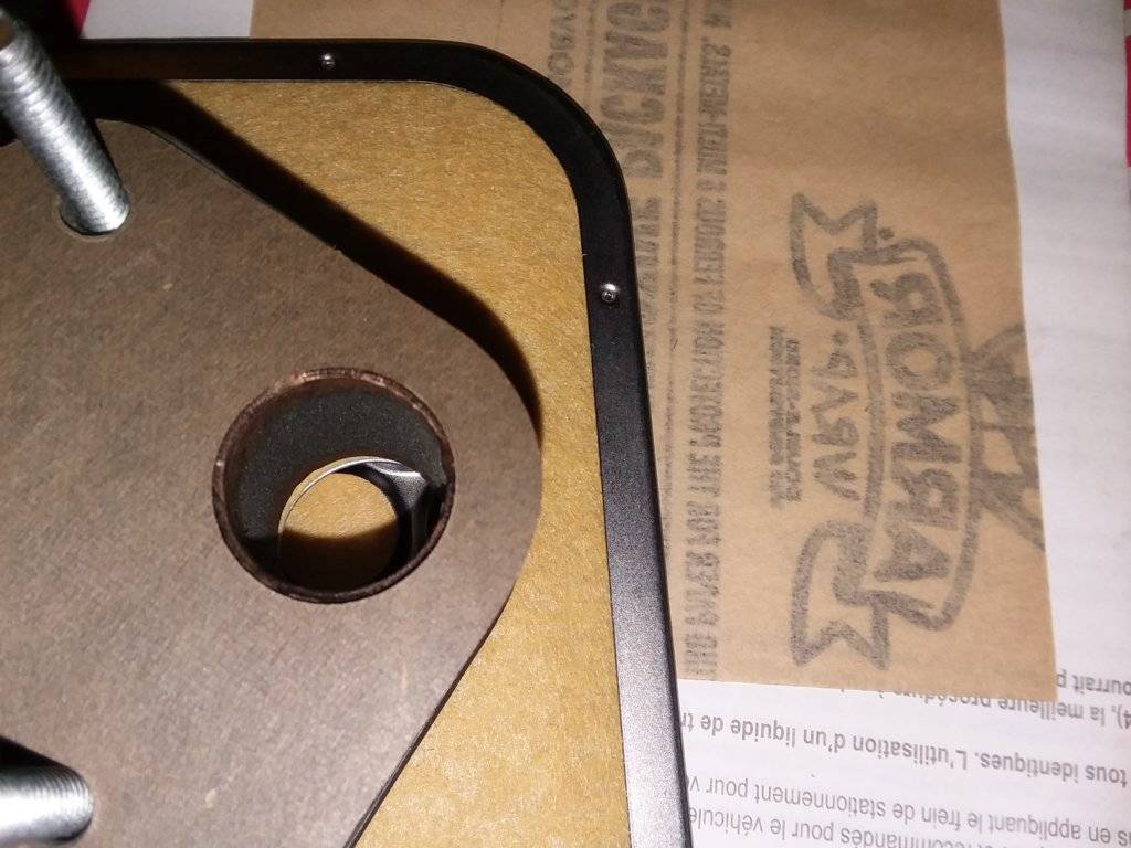

Original Mounting bolts have 5/16 coarse thread with 5/8" thread length. Need to go to 3/4" thread length to accommodate the thicker gasket. 3/4" diameter washers. Pulled out the 5/16 bolt can and came up with this. Cleaned all on wire wheel:

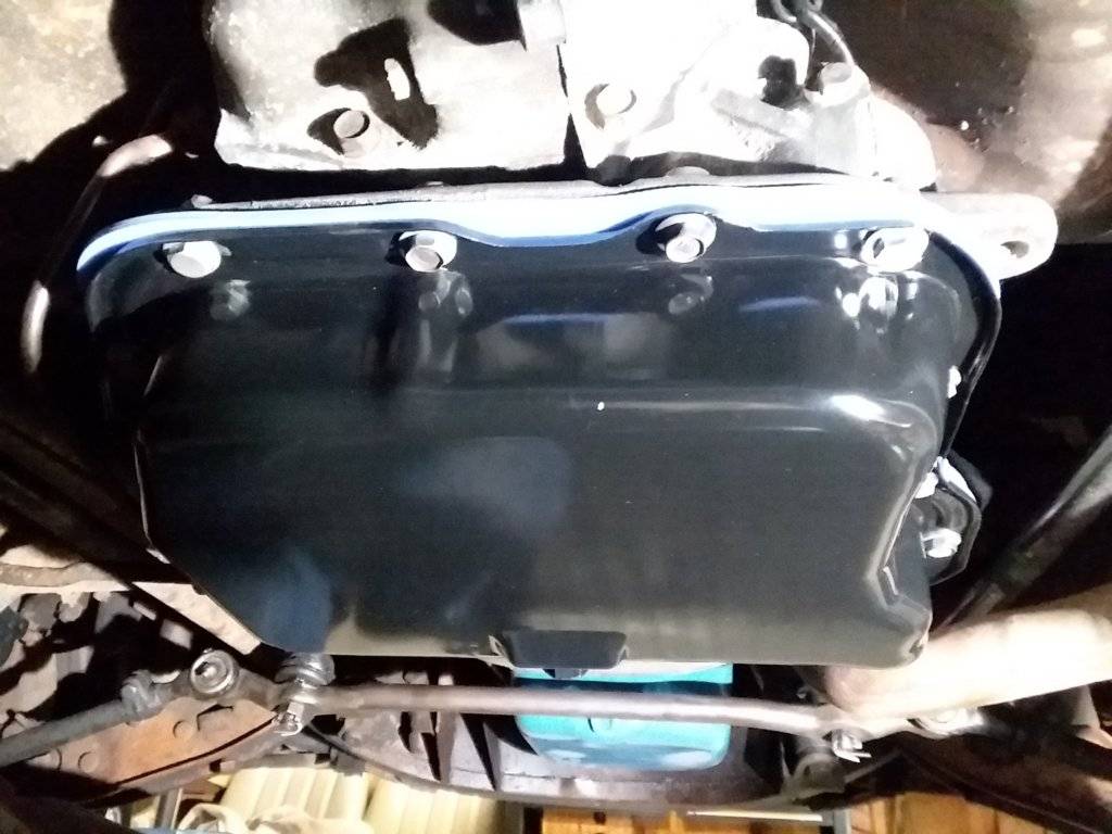

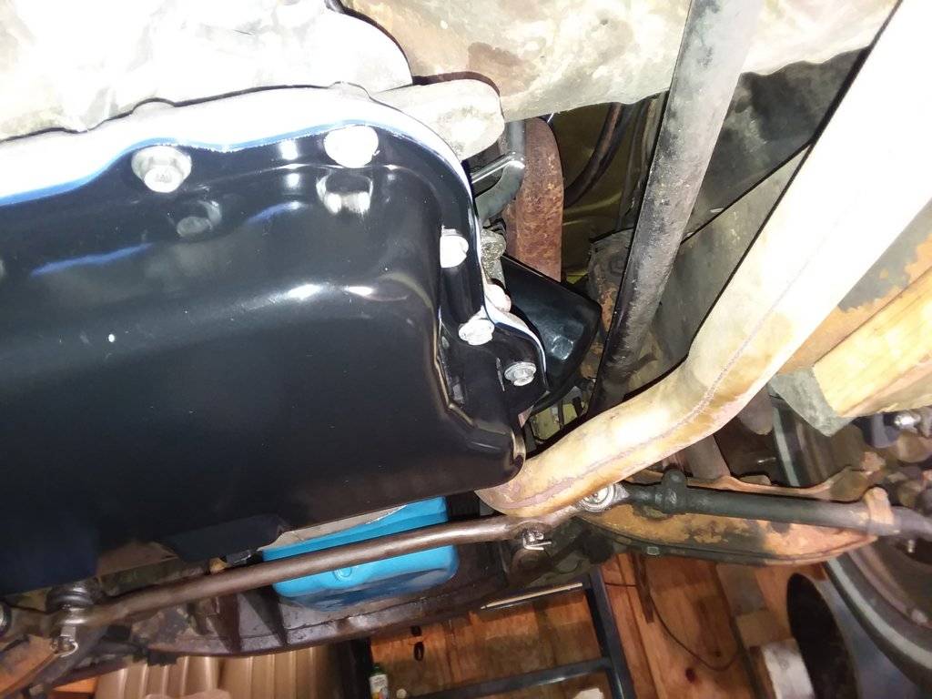

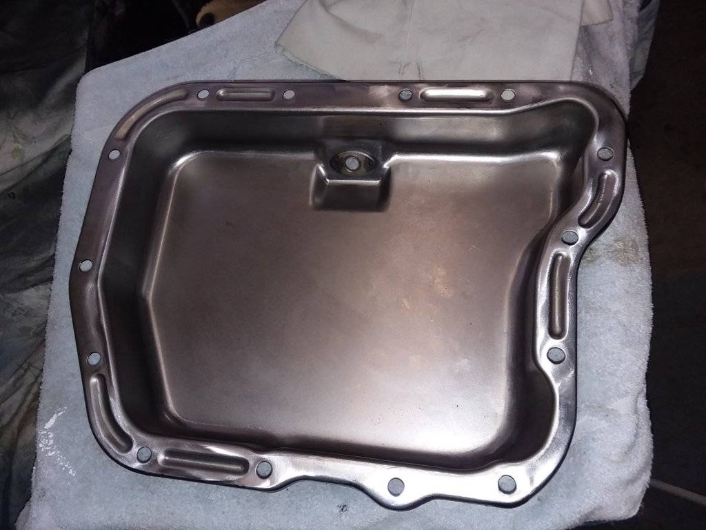

Trans Pan & Gasket

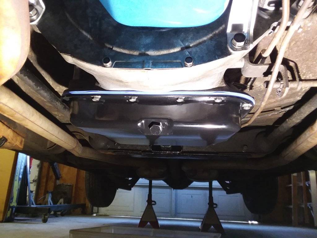

Trans pan mounted at 150"lbs
Looks better than the starting point

6 quarts Dexron added
Up
Going Down
Trans oil being added
1972 Fury III, after strong test drive
Thus far no leaks, but took 6 quarts rather than 5.5 I expected. Same dipstick and tube. Maybe pan gives more than 1 additional quart capacity. Pan waited 31 years to be used, but finally it's mounted on a car, where it belongs.
Very nice car. Dog dish caps always look cool. Interesting that you found it in Indiana and took it to Virginia. I did exactly the opposite with my Newport.

BTW: no trans pan leaks thus far. :thumbsup:
