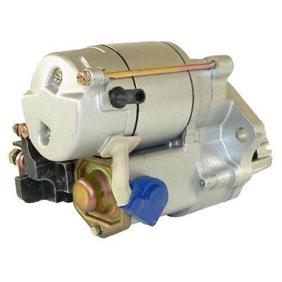

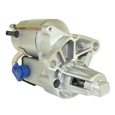

ebay order
1994 5.9L Magnum Starter, New, $81.16
New Starter DODGE RAM PICKUPS 5.9L V8 1994 1995 94 95 | eBay

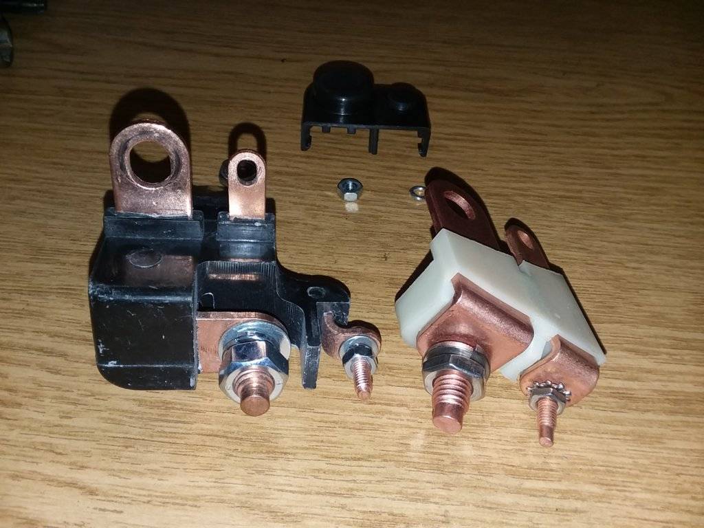

Also ordered this adapter, $10. Mounting position shown doesn't have the terminal block, but if it doesn't work, I can throw it on a parts shelf for future use. Thanks for the advice & Happy New Year!

For my big blocks, I take off the black plastic terminal and I'm good to go. That adapter might put it out a bit and give a cleaner angle to get at the bolts. Now I'm curious to see how it works.

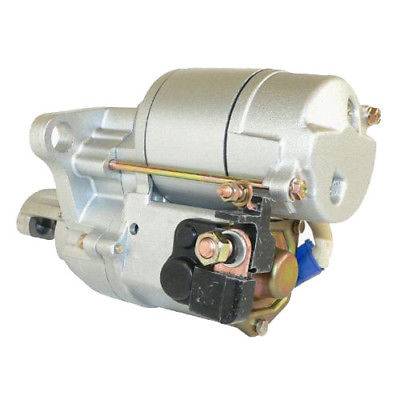

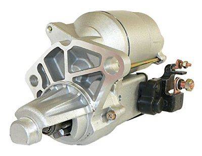

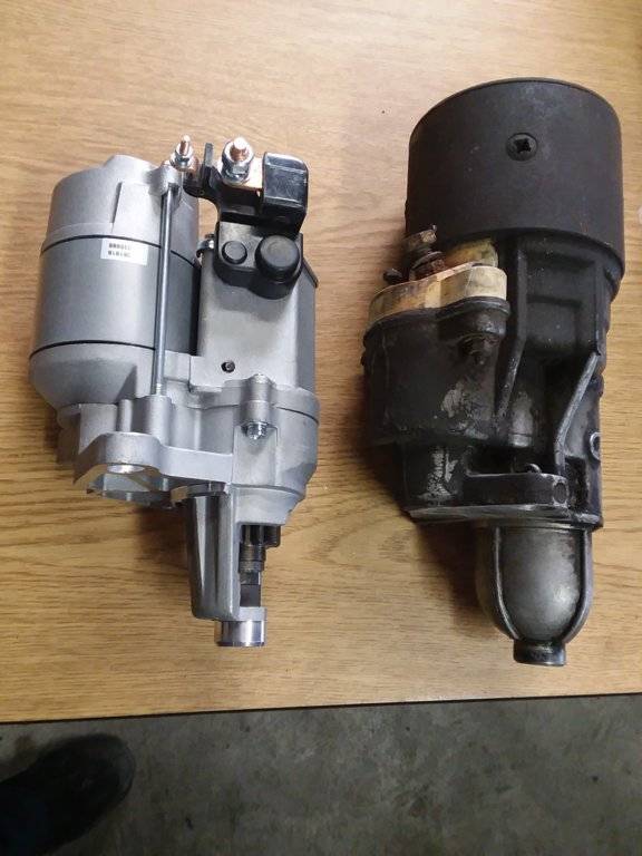

Starter 410-52033 powerpartspros1 ebay, 1994-95 360 Denso-type new mini-starter
Adapter, badvert65 ebay

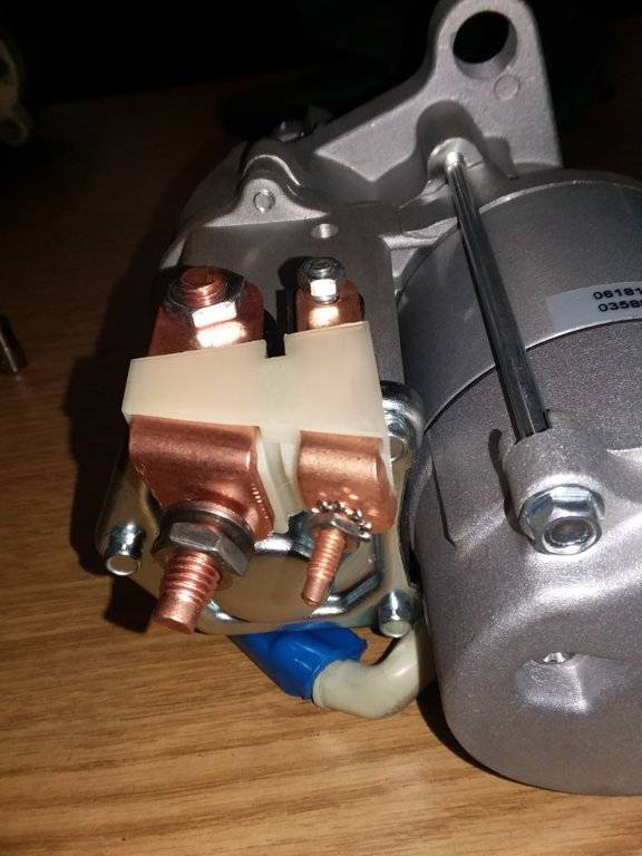

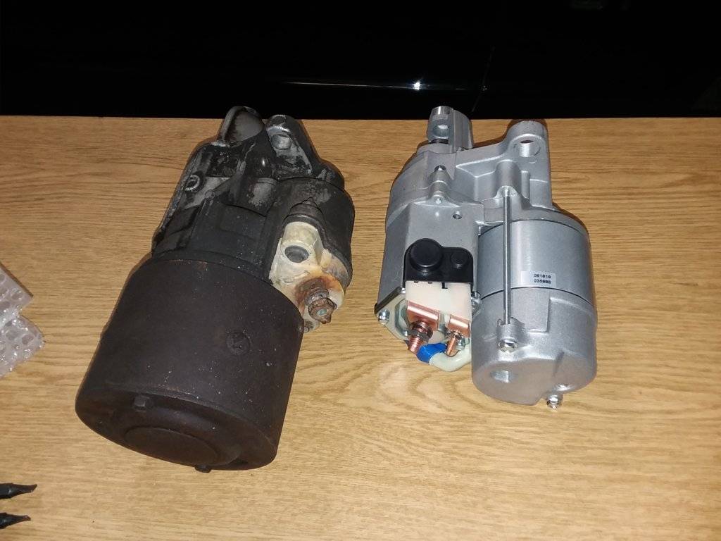

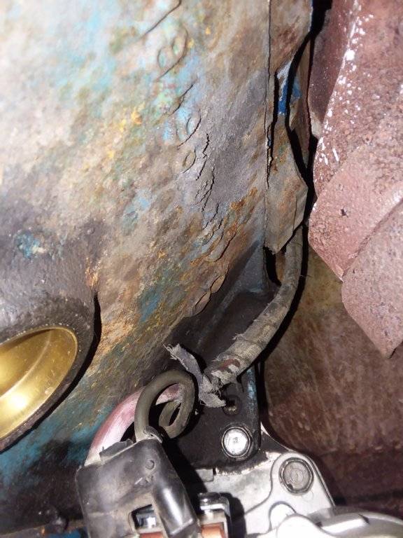

Old & new (as shipped), wire terminals on opposite sides

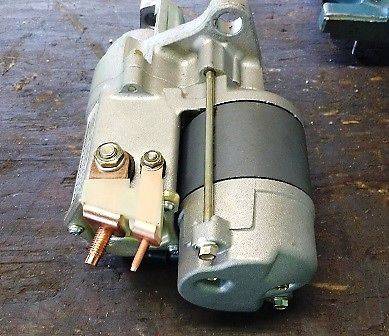

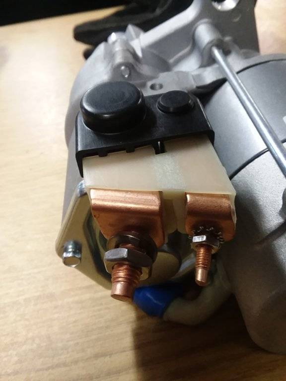

Popped off black plastic cover and removed adapter block installed on new starter, 2 nuts
New adapter on right

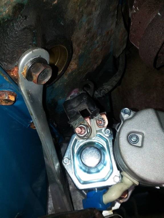

New adapter mounted
Black stud cover still fits over 2 studs
Although wires mount on opposite sides, about same length from bell housing

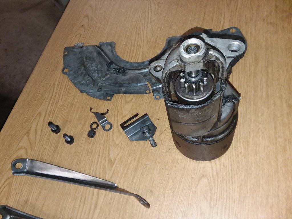

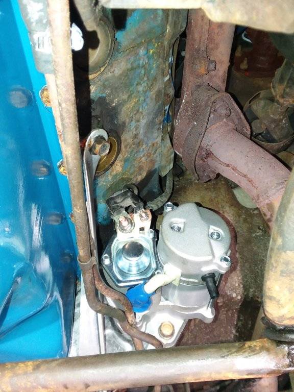

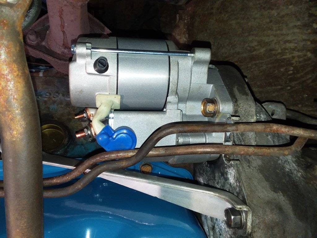

New starter, easy to mount, unlike old starter, able to get torque wrench on both bolts
Wires mounted
Wire routing
From below
Result: Fury 360 Edelbrock 1406 starts instantly. Extremely impressed. Starts like a fuel injected car.

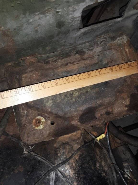

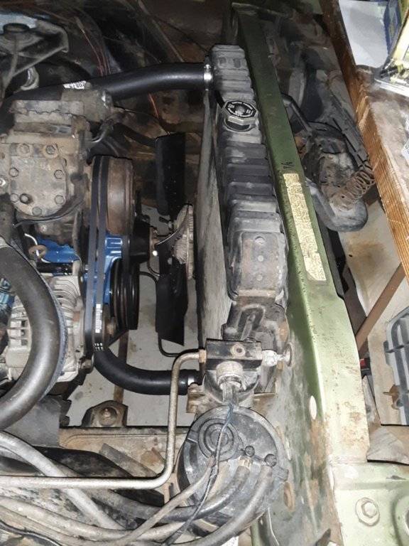

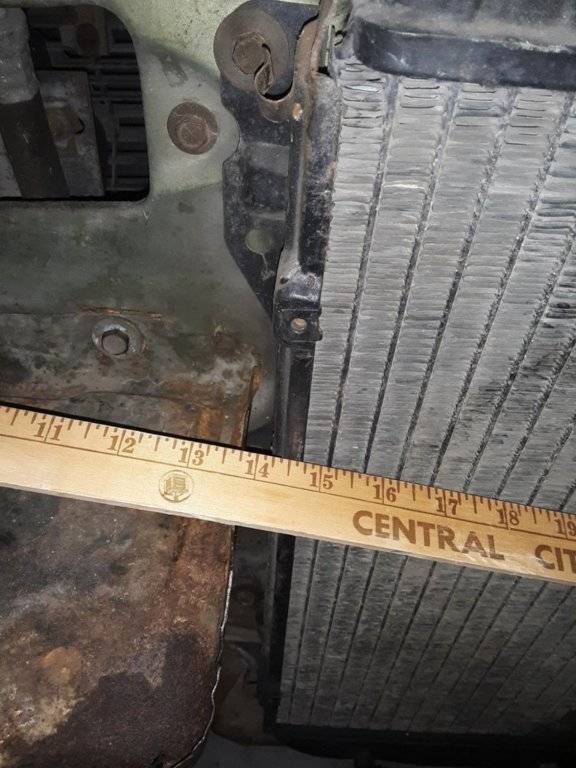

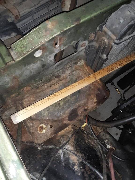

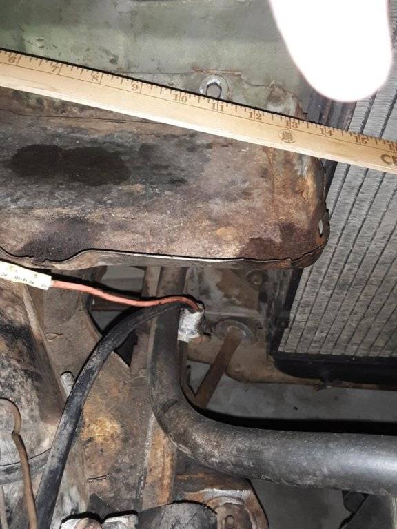

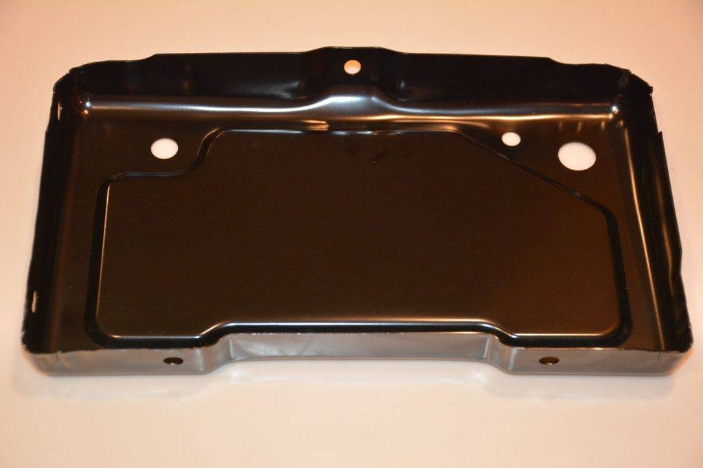

72 Fury Battery Tray. Mario @MBar has a 72 Fury with AC. He sent some pics, which prove that the AC battery tray is same as non-AC even though his car has 26" radiator yoke support, while mine has 22" radiator yoke support. Important if I unbolt my current bent radiator support and bolt on a 26" 1972/1973 radiator yoke support. Gary @Wollfen says that 69-71 radiator yoke supports are not compatible because they are taller than 72-73. 72-73 has a rubber isolator below to make up the difference in height. Mario's Pics provided for reference. Thanks Mario! Looks like you did great job on front of your engine.
He says his support strut is MIA if anybody's got one.
