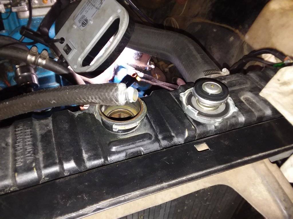

Original 22 inch non-AC radiator:

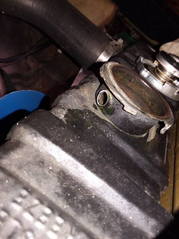

Both tanks leaking.
Reservoir fitting broke off when hose removed

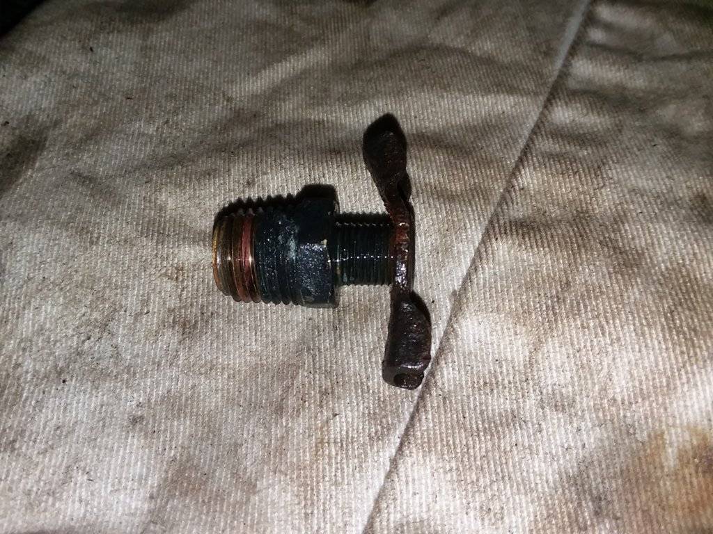

Petcock: valve stuck, butterfly just spins, removed with wrench to drain

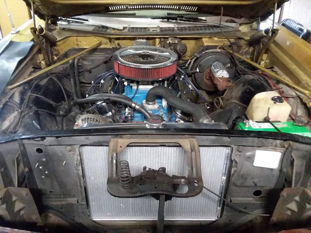

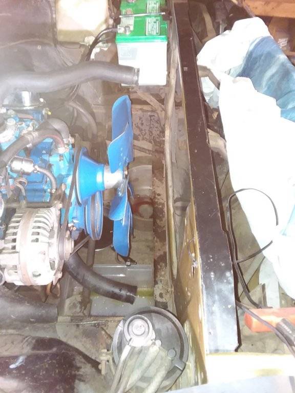

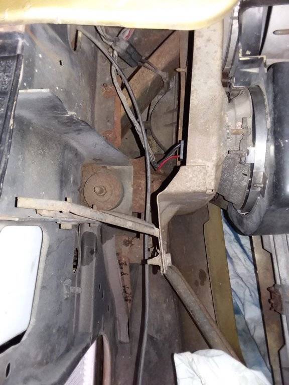

Radiator Yoke Support. Don't think the rear side should be gold.
At least the old radiator is out

Both tanks leaking.
The rear and the top of the radiator support should be gold yes, it was originally all gold on the production line and black painted into the front behind the grille.

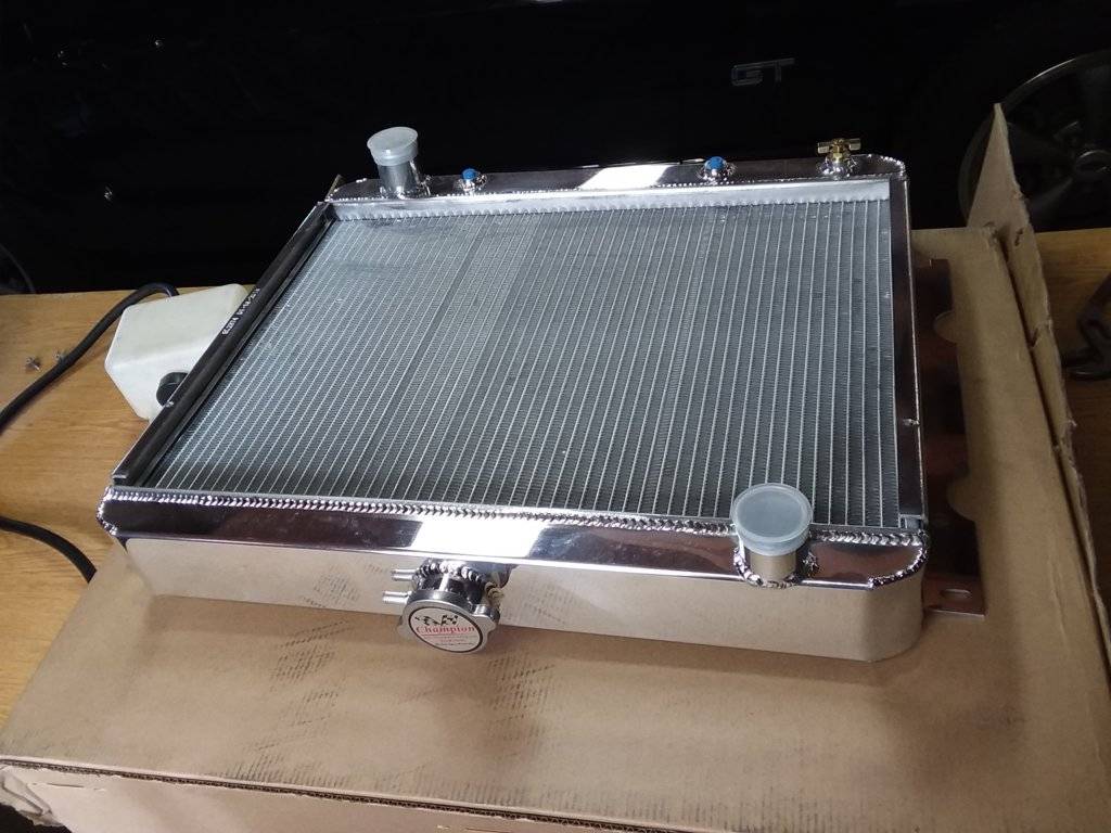

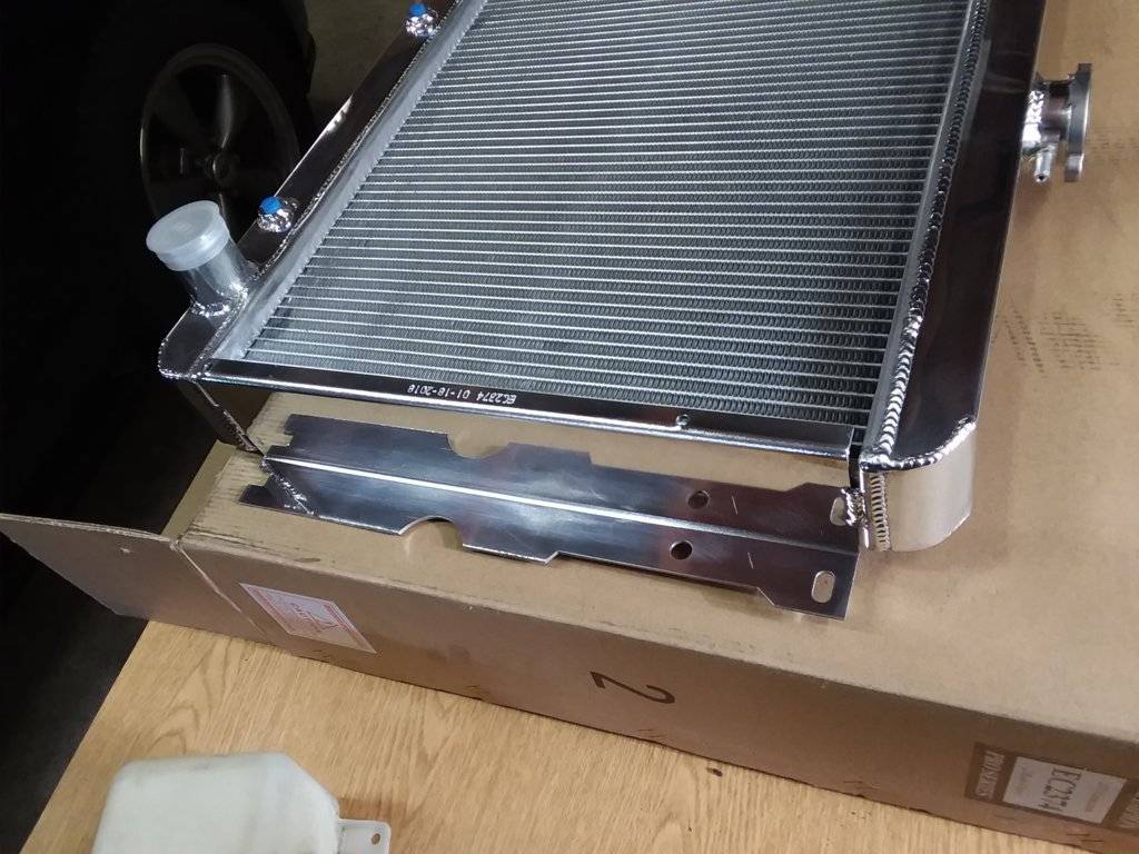

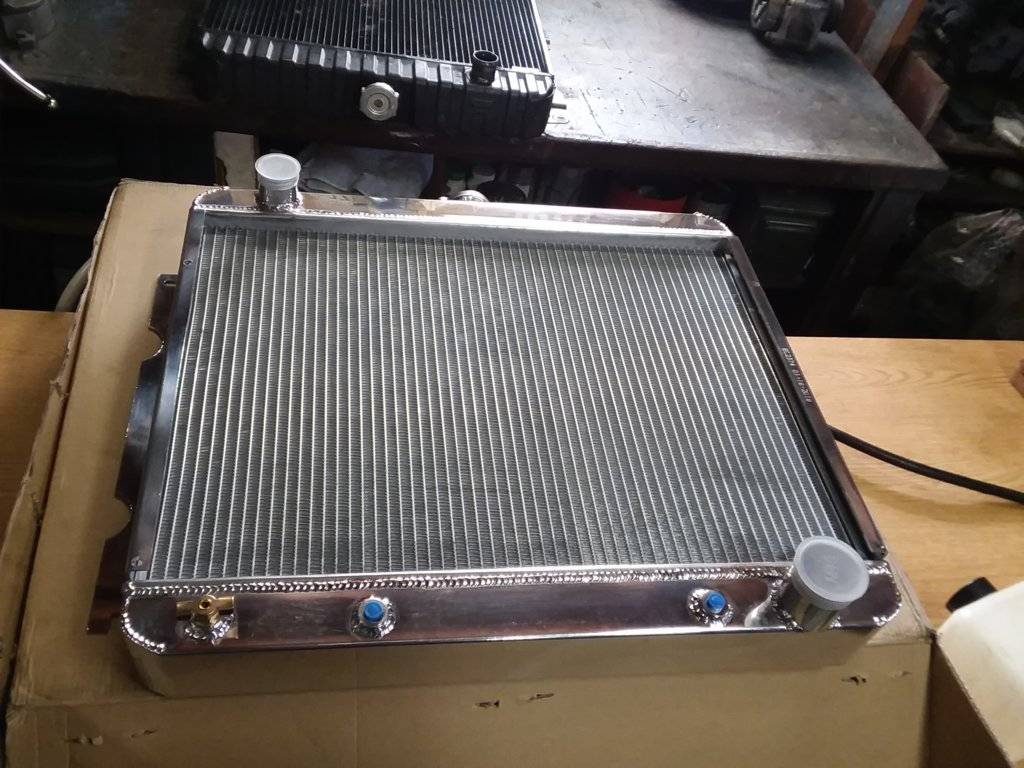

Champion EC2374 22" Aluminum, Early Mopar
Purchased from Jegs for $191.99 plus $32 for expedited ship by Fedex

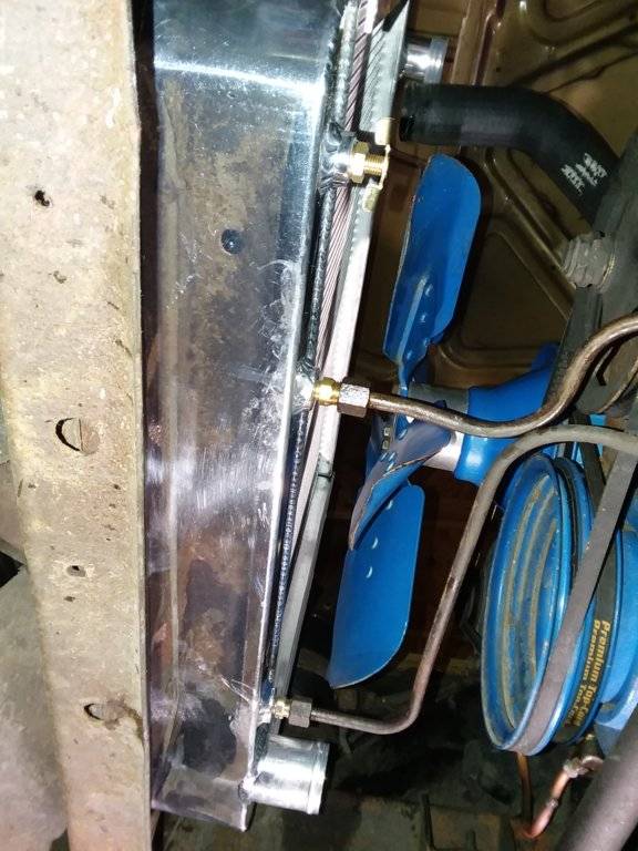

First installed my trans cooling line fittings (fittings do not come with unit, but new petcock does)

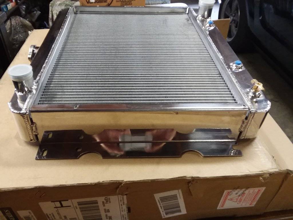

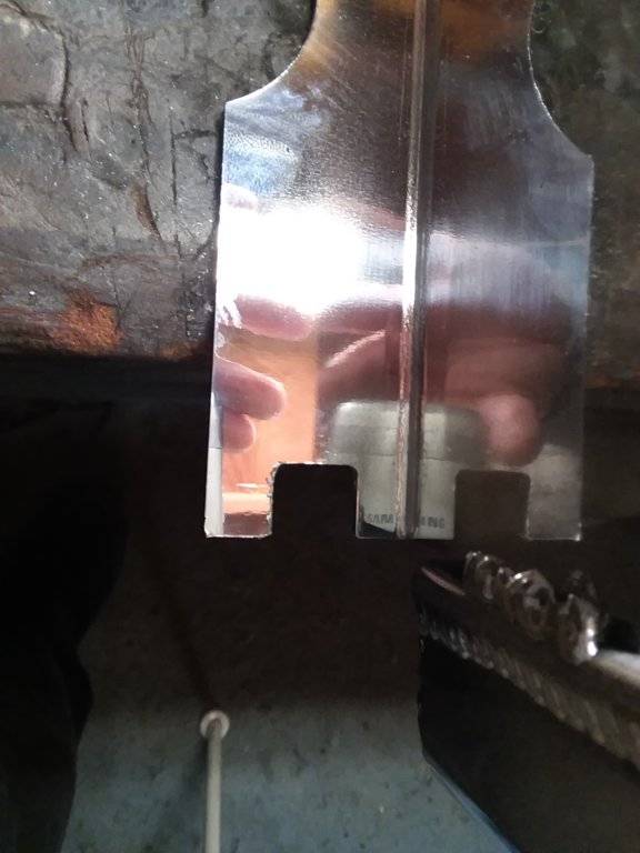

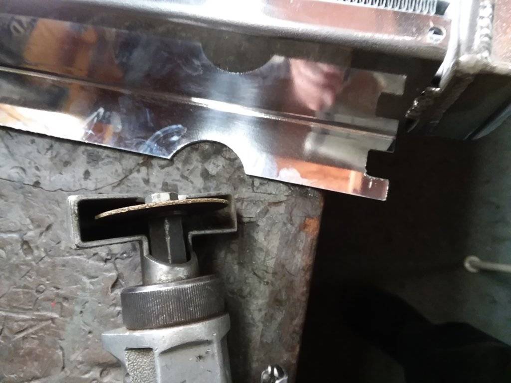

Radiator Bracket slots are about 1/8" too narrow versus the length from outside of lower mounting bolt to outside of lower mounting bolt. Used exhaust cut off wheel to take the 1/8 inch out of the outside of the left side slot.
After a little clean up

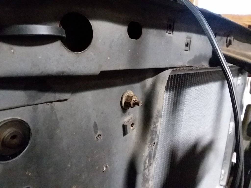

Upper Mounting Bolts:
Slots on radiator brackets do not match any holes in radiator yoke support, so drilled two 1/4 inch holes for upper mounting bolts
Right side

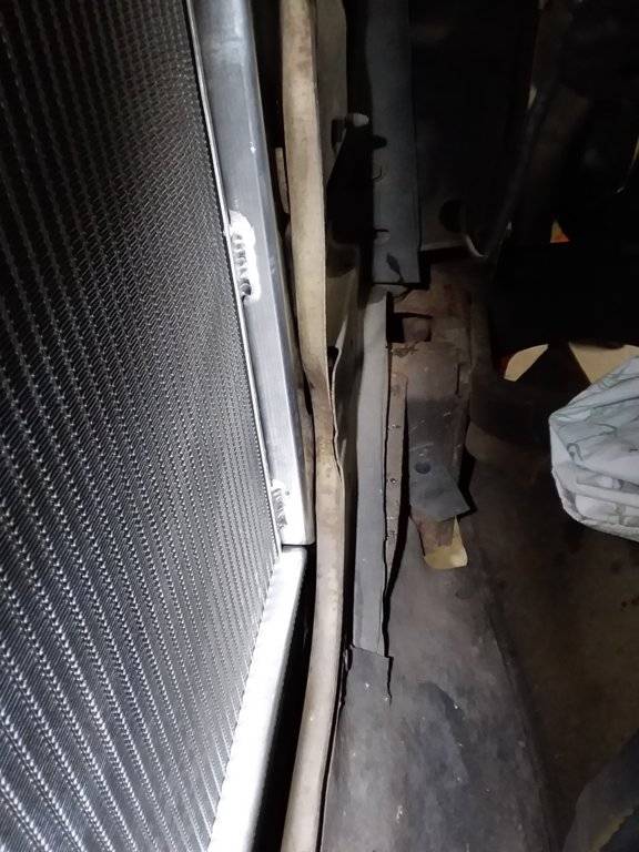

Nut at front of right side mounting bolt. Non AC radiator yoke support is 22 inches wide across opening for radiator. It's different than AC yoke support.

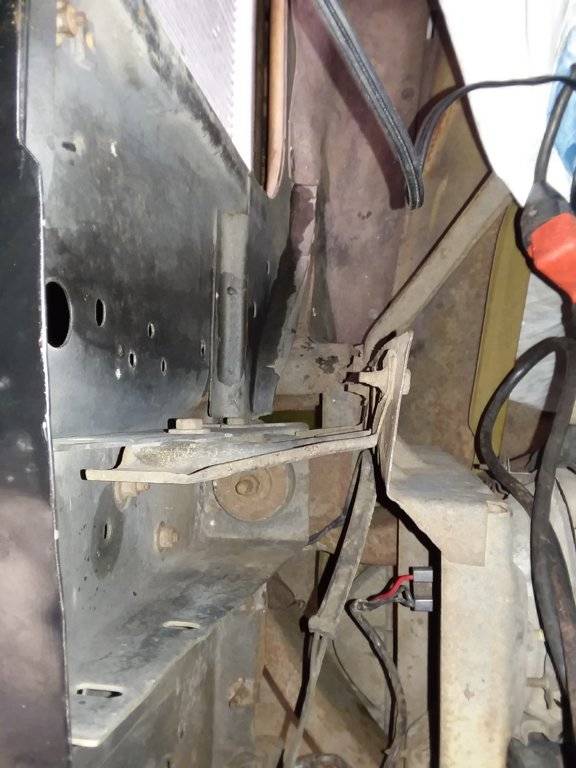

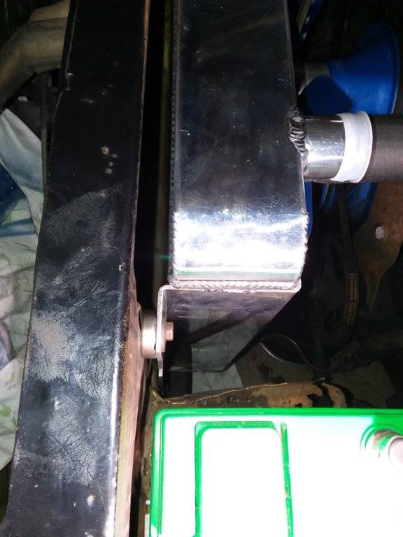

Left Side: Hmmm. Houston, we have a problem. Bracket not flush to radiator yoke support
Yoke support dented at left side bottom
Left side frame looks OK
Right side also looks undamaged
Used a 1/4 inch washer as spacer at upper left mounting bolt
Left side
Right side

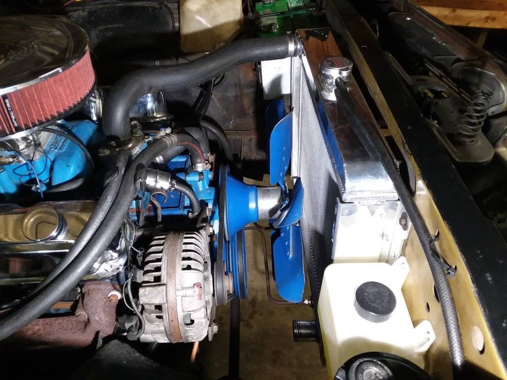

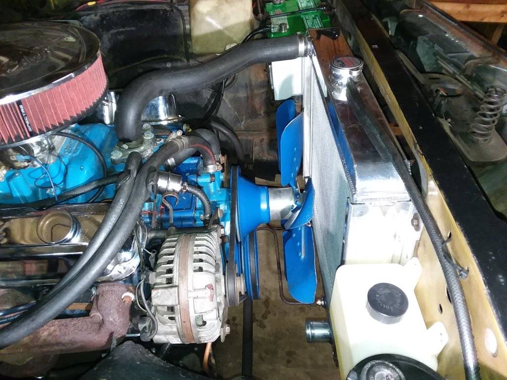

Champion EC2374 Radiator

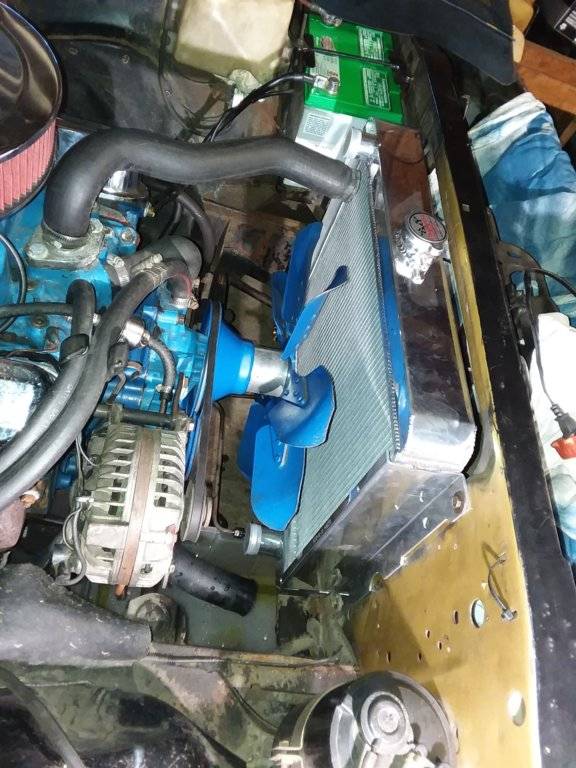

Upper tank is OEM position
Lower tank is about 2 inches above OEM

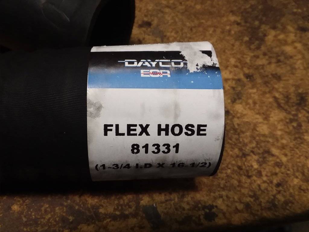

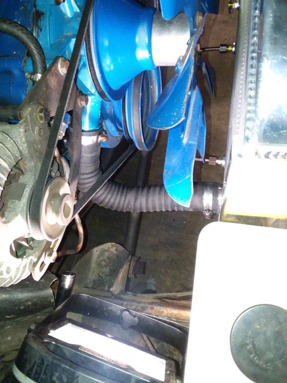

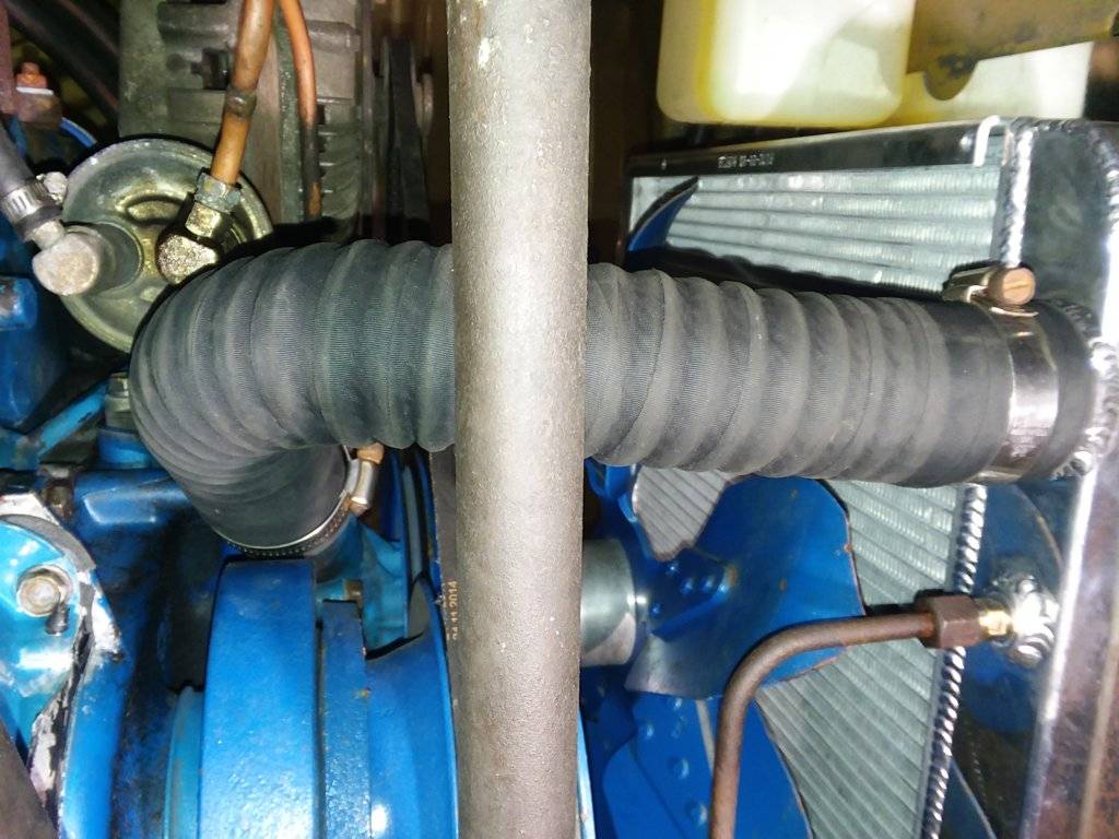

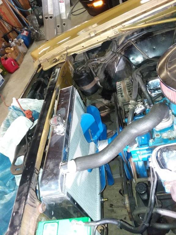

Tried to cut NAPA curved lower radiator hose to adjust for new lower tank position, but the curve isn't sharp enough. The hose flattens between the radiator and water pump fittings. It also comes too close to alternator belt.

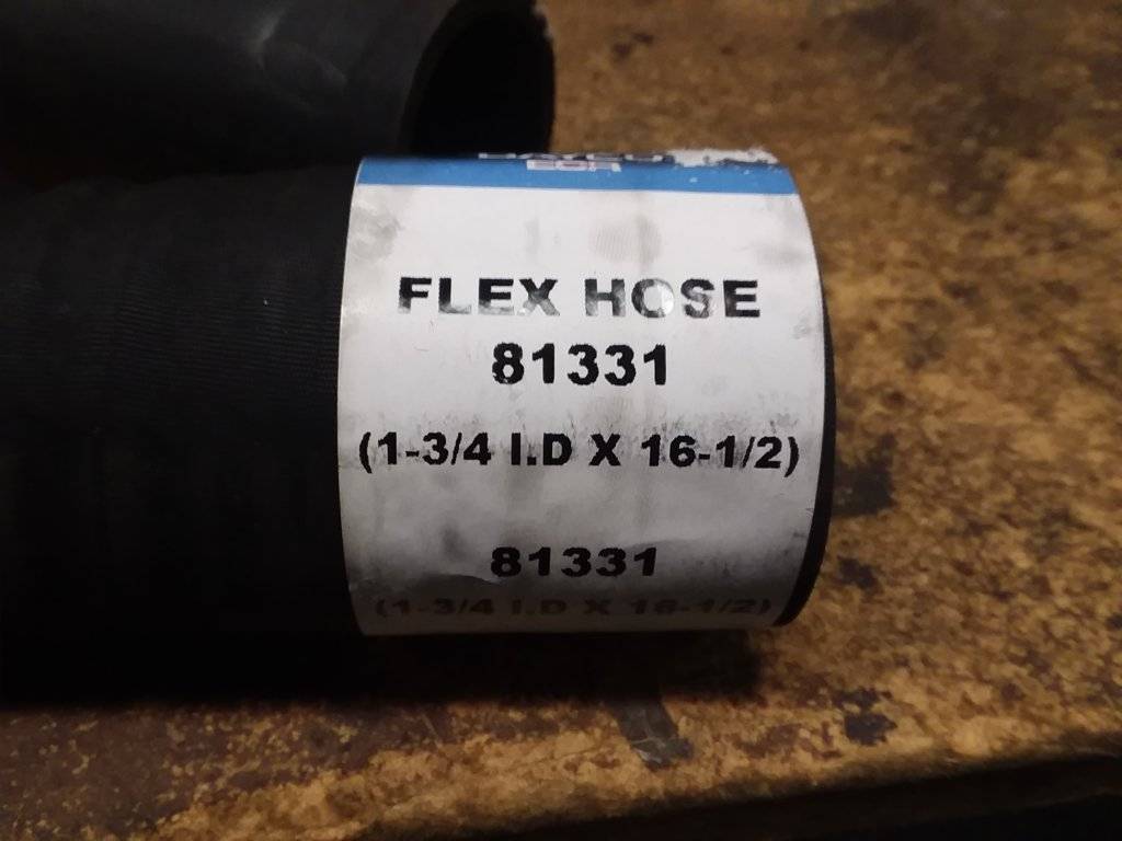

Gave up and ordered 81331 1.75" ID 16.5" length flex hose from Advance. Should have it this morning.

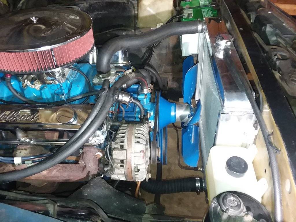

Mounted: all installed, but lower radiator hose
It didn't have a shroud from the factory? I would start looking for one, just added protection against overheating.

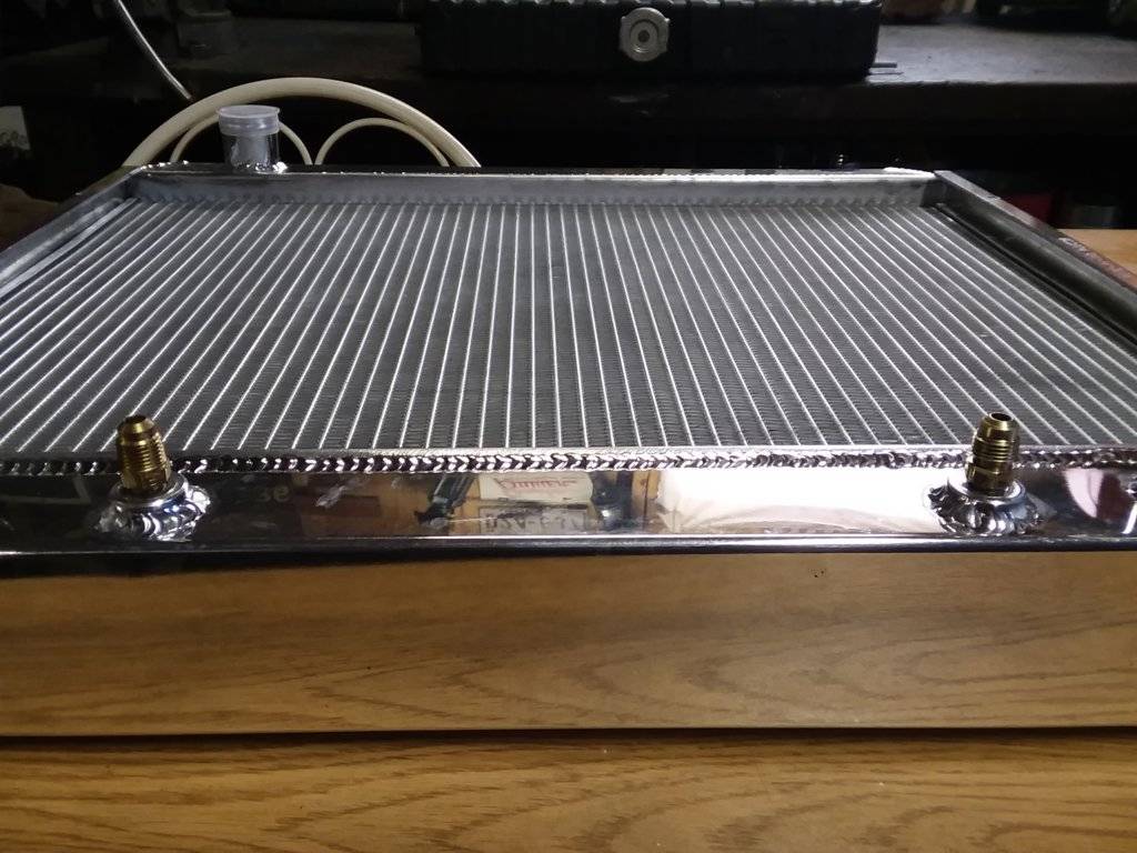

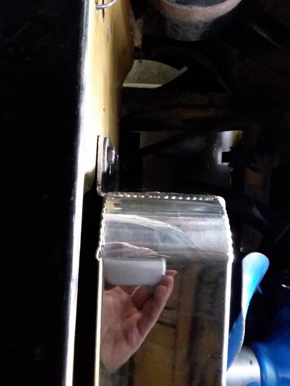

I´m not a welder, but those seams look somewhat rough.
Didn't have a shroud from factory. OEM radiator does not have brackets for shroud. Car did not overheat this summer, even on 95°F days. It never even got hot. EC2374 has brackets for shroud, so maybe I can find a shroud that fits. Either way, I think car will be OK.
I bought Champion because the name was mentioned in positive comments on the forum. I'm not a welder either. Skoien says that his EC2374 has held up well for last two years. Hope mine lasts.
Lower Radiator Hose, Dayco 81331. Old hose above. Could not get it to stop kinking, no matter how far I cut it down.
LRH mounted. Plenty of alternator belt clearance, no kinks, solution to raised lower tank
Champion Radiator fully operational

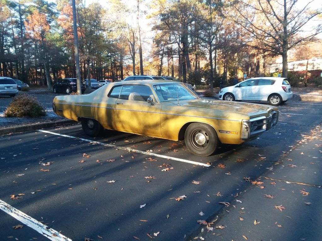

1972 Fury III after excellent test drive. Car has been a lot of work, but it is awesome to drive!
I've seen a lot worse although not on a tank (handicap ramp railings @ bank ATM).
Maybe I'll end up recoring my OEM radiator. For now, I'm happy that the car is rolling and that I can take Aidan1976 for a ride when he gets here this weekend.
The temp was 28°F this morning. 72 Fury started on second turn of the key. I let it warm up for a couple minutes and then headed out on the road to work, 68 miles round trip. Temp gage stayed in same position as always, which is about 1/4 of the way across the dial from the C mark. Car has decent power and is an awesome cruiser, really enjoyable to drive. Cooling system did not leak a drop. This car has stolen my heart. Lots of fun and it holds its own in the fast lane at 75mph.

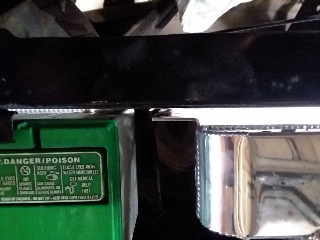

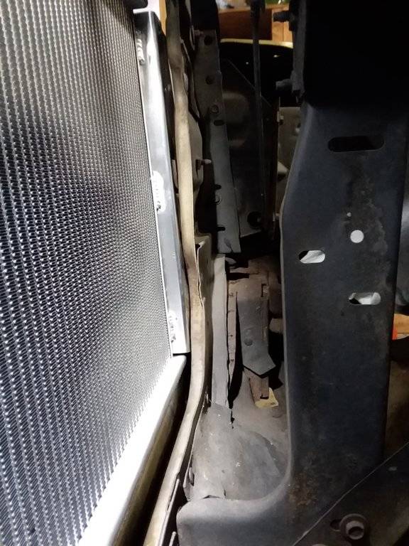

In one photo I can see a slight view for comparison and the aluminum radiator is wider but did you line the two up for a height comparison before installing?
I was going to say just lower it down to correct the lower hose problem but from the pictures it appears that the top tank is already lower than the original and lowering may cause problems with the top hose. For the hot weather you will want to close up that gap at the top tank vs radiator support, air will take the path of least resistance and if you stick a length of black Home Depot pipe insulation tubing to close up the gap it will keep the air going into the radiator and not over it.

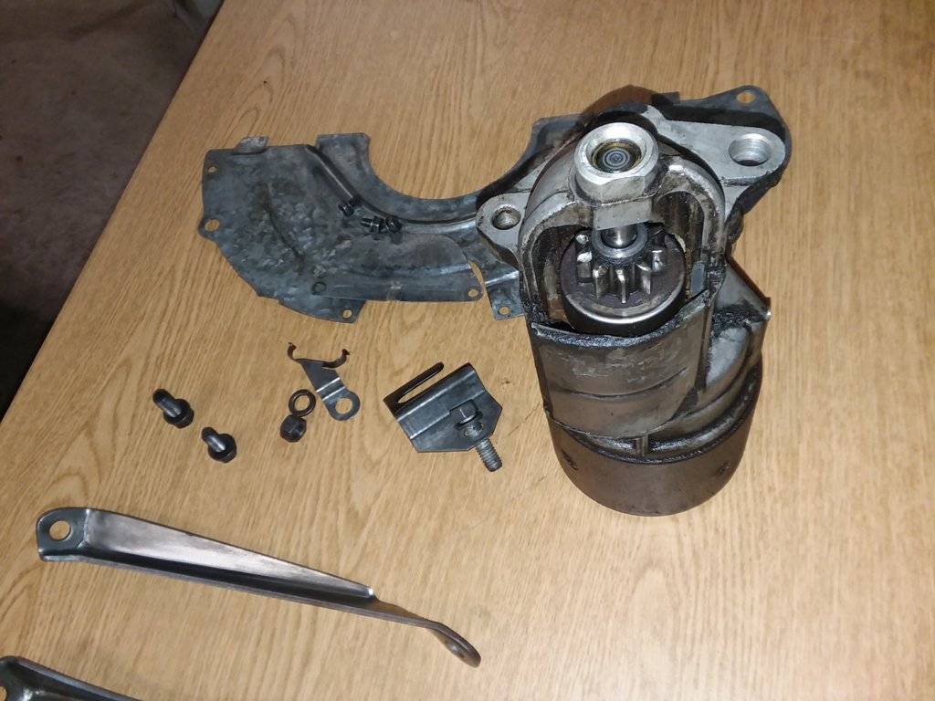

The temperature was about 25°F when I first walked out to start it. The car took a long time to start, lots of turns of the starter. Battery is not weak. Starter turned at same rate the whole time. @barnfind recommended a mini starter from the Magnum engine.
Are all the Magnum starters the same from 1993 to 2003?
If not, which year is the best to buy or pull from a junkyard?
I researched some other threads, and people were concerned with the sound of the Chrysler gear reduction starter, versus the later high torque mini starter. I don’t care about that. I just want the car to start quickly in cold weather. Before I go adjusting the electric choke, which I don’t want to do because everything works fine once it started, I’d like to try a Magnum mini starter. Thanks for your advice as always. Ben
