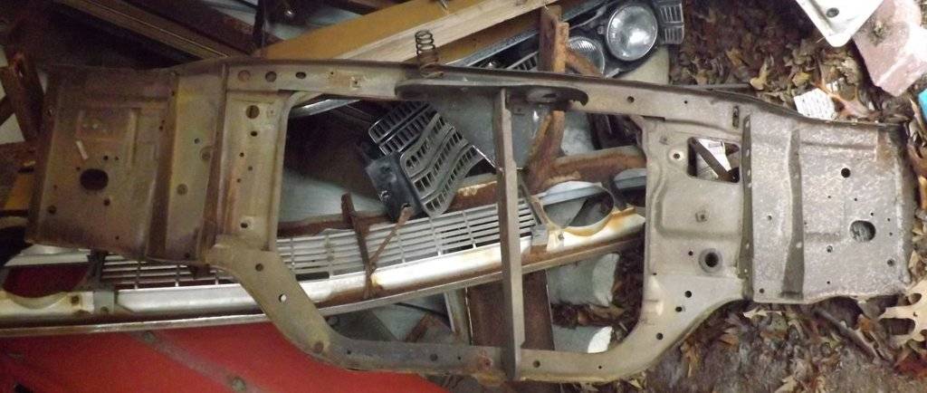

Good luck Ben, the fold away headlights will certainly set the car off. Here is a pic of the radiator support, it is solid. I will take the hood release bracketry off before it goes, @Moseman can let me know if he wants it say, $75 plus shipping. Also i should have a spare battery tray support bracket if you are interested?
I would be interested in the radiator support if not taken if it is for 1972 fury
Hey Gary. Thanks for the pics! Appreciate you looking. $75 is a fair price. I'm not sure if @Moseman reads this thread. Maybe send him a PM.

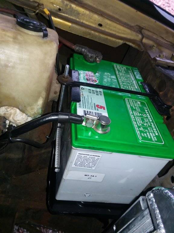

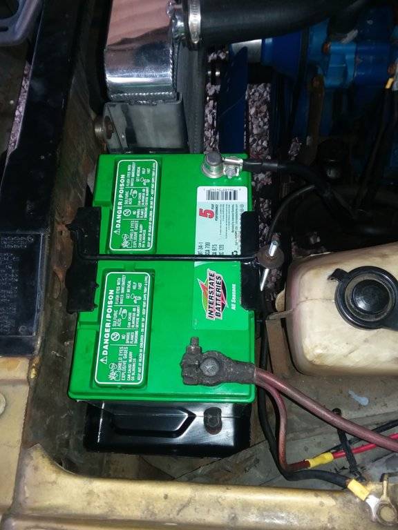

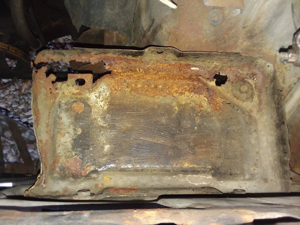

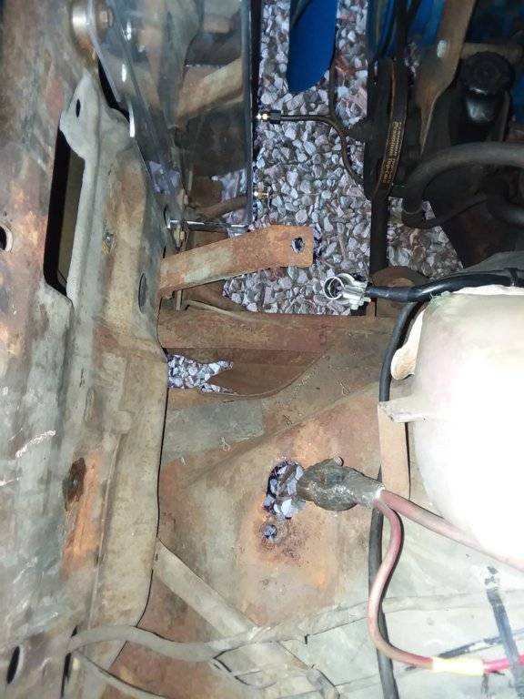

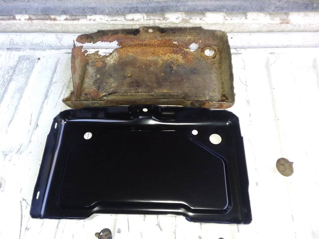

Battery Tray
New tray is a match.
Old tray: rust holes
Old beside new

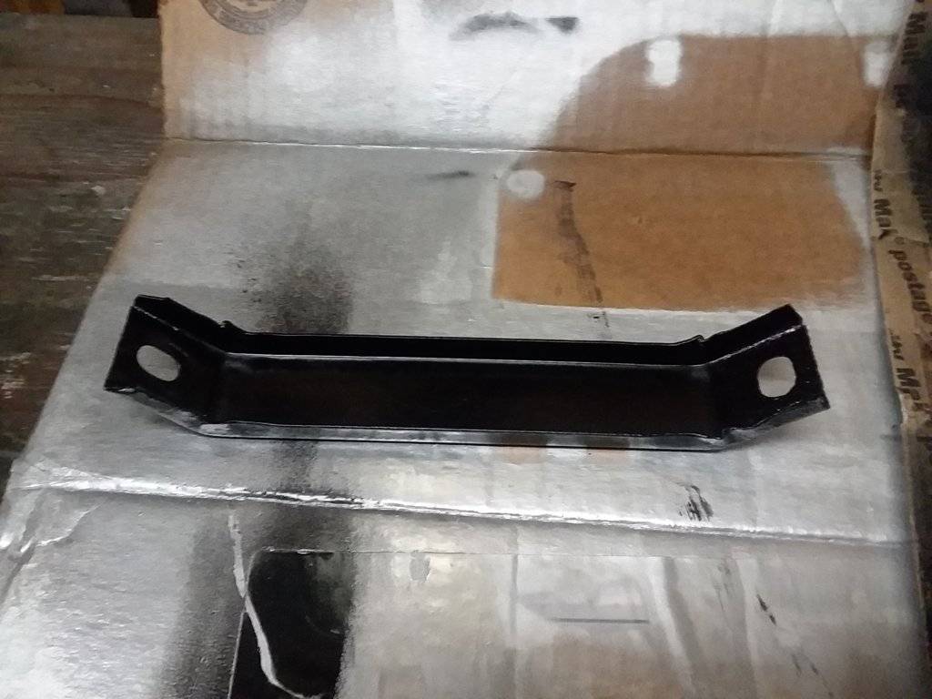

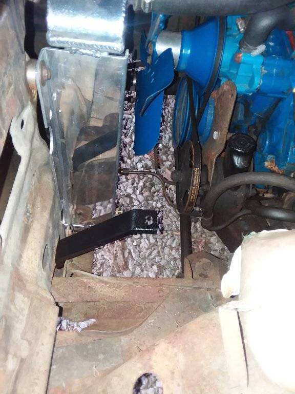

Stopped to paint support strut from radiator support panel. It's removed and in garage with 2 coats of Krylon gloss black.
Battery tray was after work.

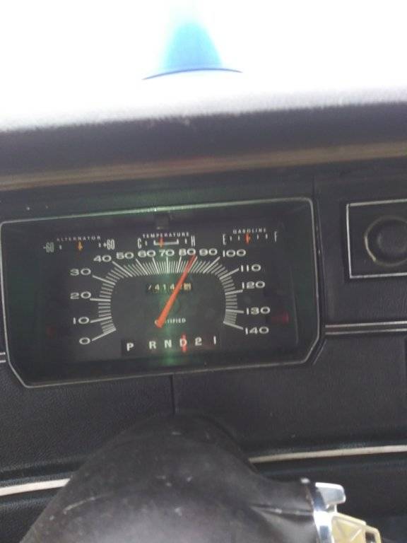

Speedometer noise:
Drive to work: Temperature was 31°F. Speedometer made a serious rattle for the first 10 to 15 minutes of driving. Speedometer needle was bouncing side to side, at a range of about 10 to 15 mph. After that, the rattle went away, and then returned. This process repeated itself several times, until the rattle was gone after about 20 minutes
Drive home: temperature above freezing, no noise from speedometer?

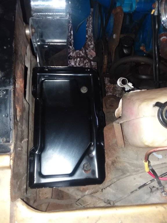

Battery Tray, Install
Support strut, after clean and coat with Krylon black
Support strut installed on radiator support panel

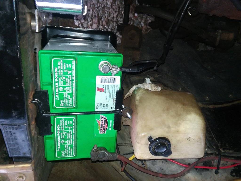

Battery Tray, new: 5/16 drill bit to slot both radiator support panel bolt holes toward radiator. I had to do this because the mounting bracket for my Champion aluminum radiator protrudes farther toward the outside of the car than the stock radiator bracket, so the new battery tray needed to mount slightly to the left of where it normally mounts. It's only about 1/4" off. NBD to slot the 2 holes. Rear bolt holes on tray lined up with strut and wheel well just fine. Now I have 4 mounting bolts instead of 2
Battery reinstalled.

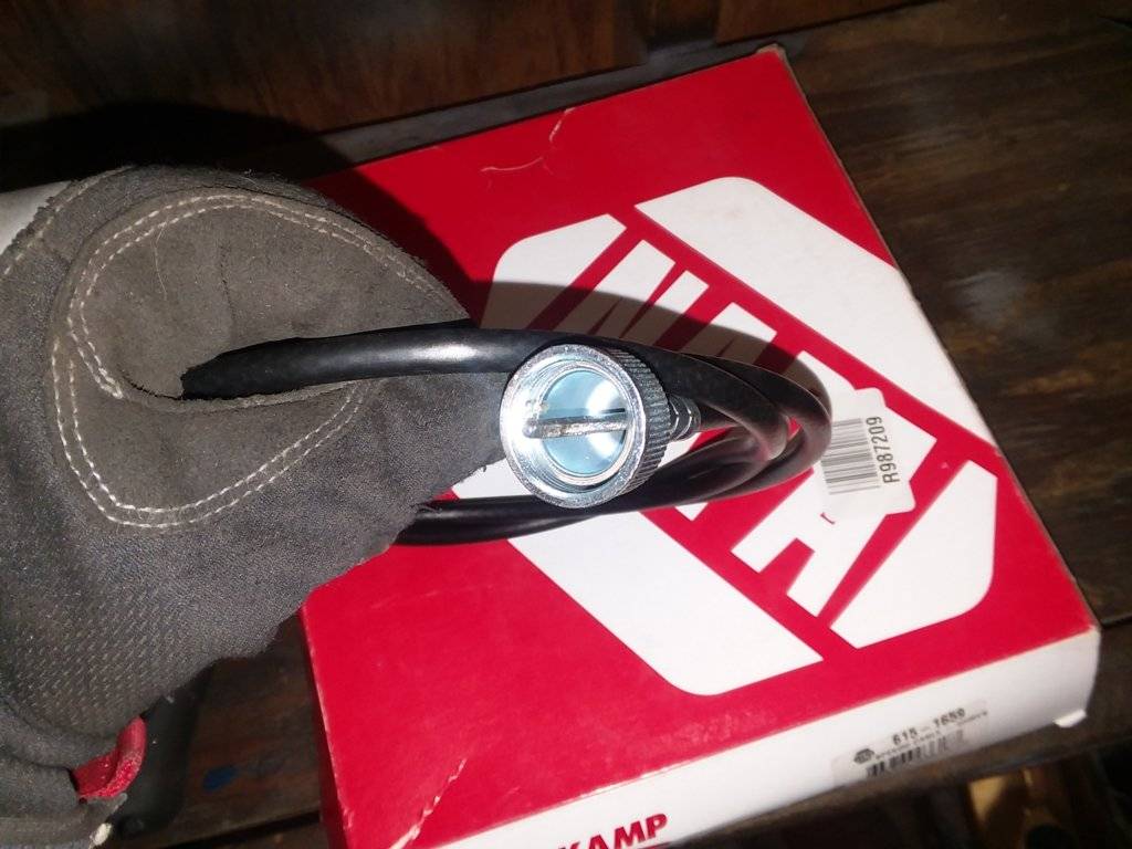

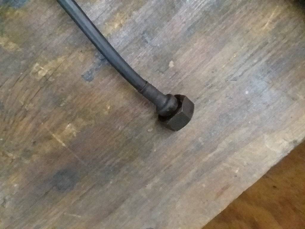

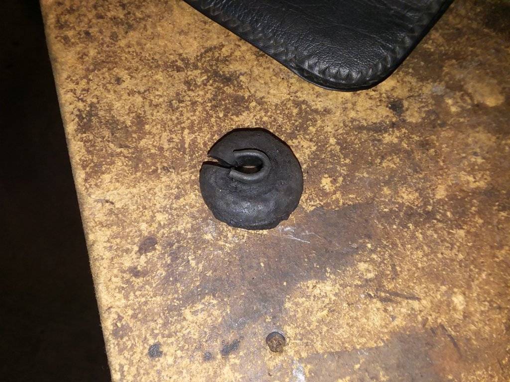

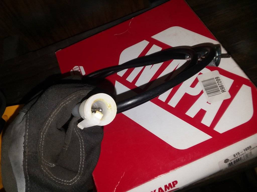

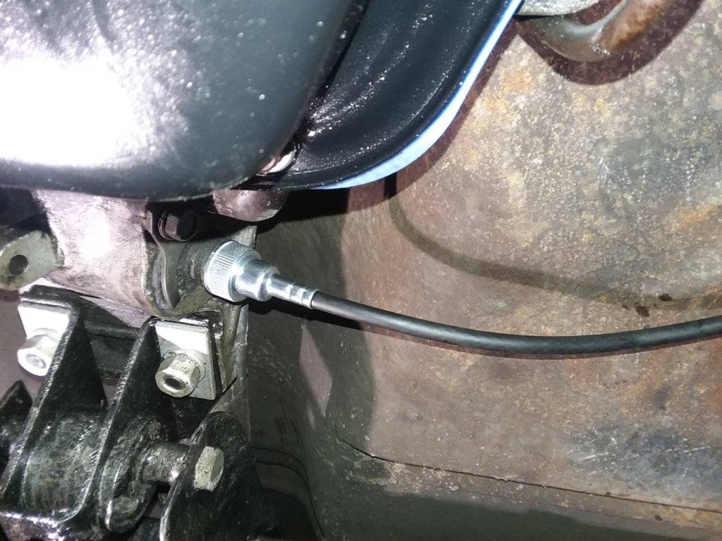

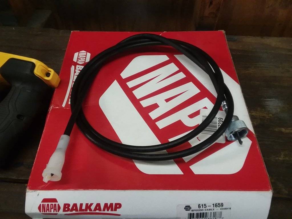

New Speedometer Cable, NAPA Balkamp 615-1659. $21.05 including tax. In stock at local warehouse.
Cable & Ends
Speedo fitting
Trans Fitting
Differences from original: NAPA cable is 7" longer and does not have hex fitting to mount at trans
Original
New cable at trans

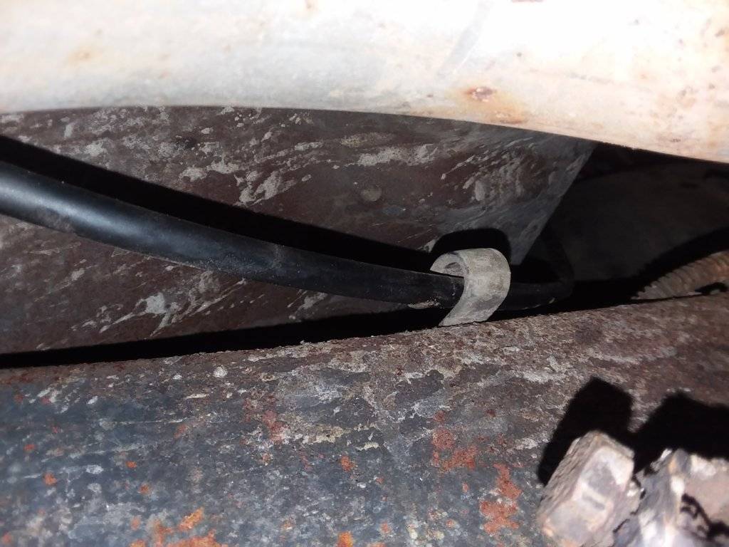

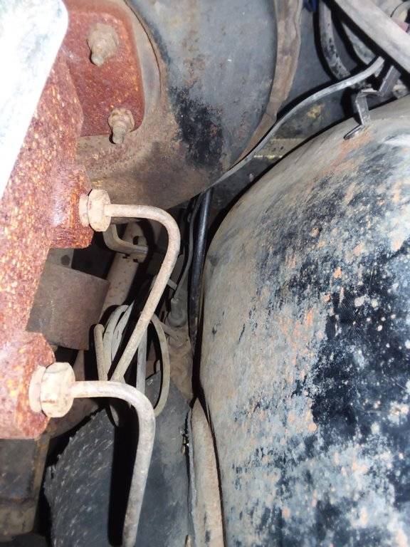

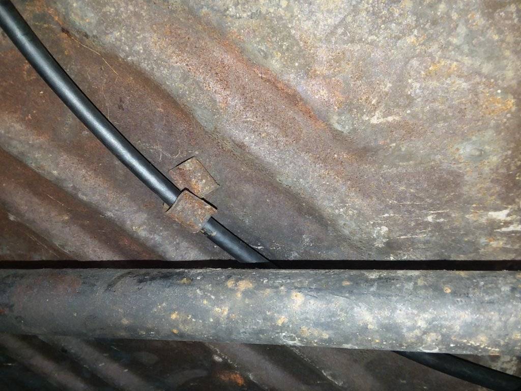

Routing clips under driver floor pan keep cable away from torsion bar and exhaust.
Hard to get pic of firewall opening under booster. Bend that takes up extra 7 inches.
Slotted firewall grommet to get it over new cable. Begin install engine side, pull passenger side thru with needle nose pliers
Install new cable under dash is a right arm only job, blind, while lying under dash. Cable end feeds thru a hole in a metal panel above steering column and into a conical fitting at rear of speedometer. Install at speedo required several attempts and several cuss words. Need to replace leaking fuel pump before test drive, gas leak. Hope new cable works!

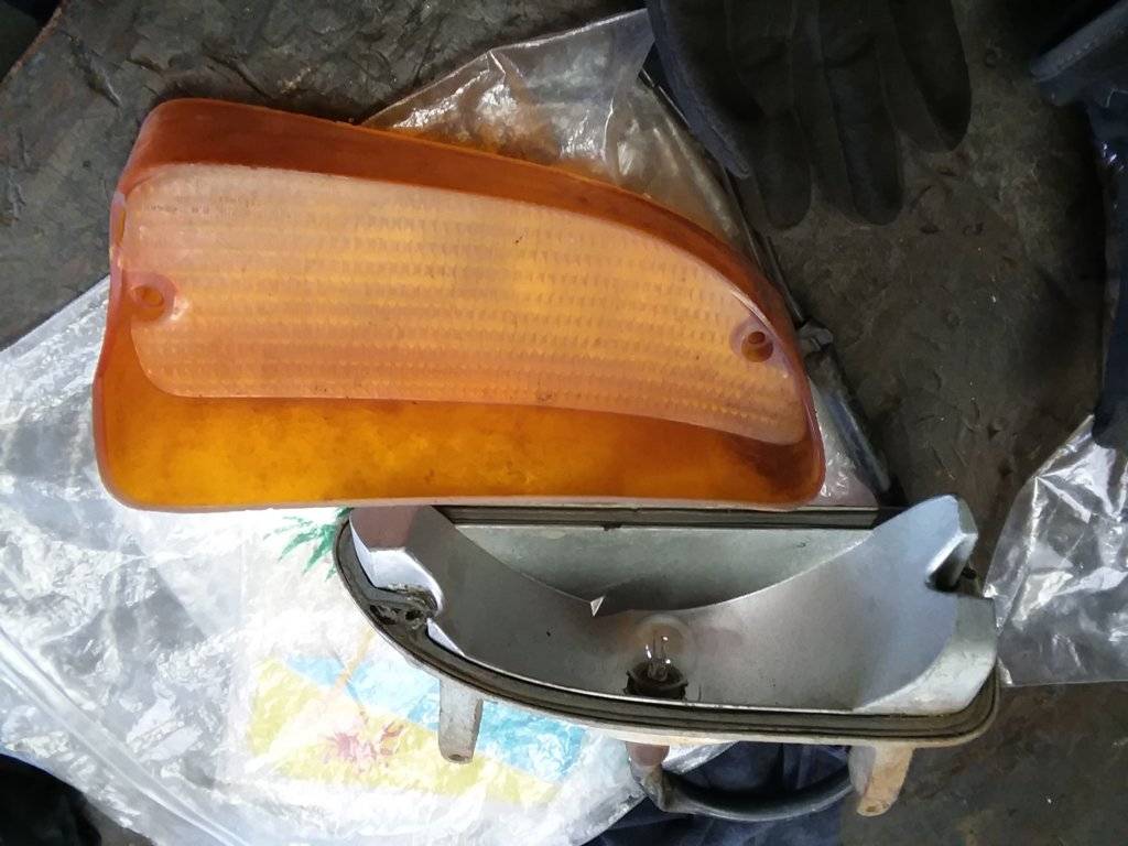

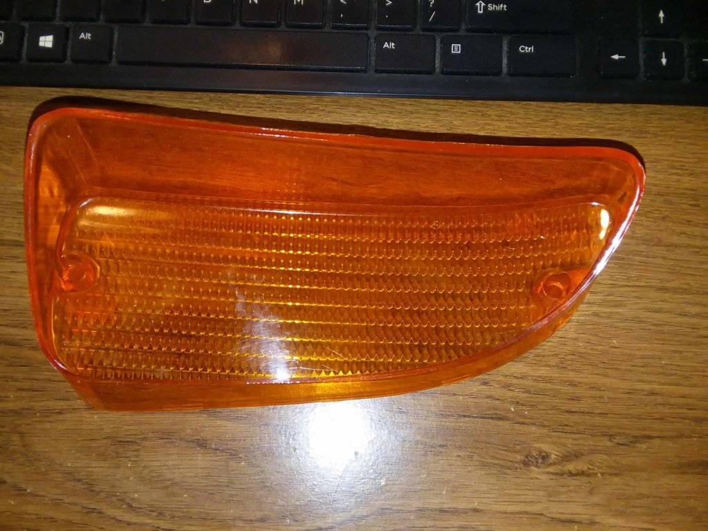

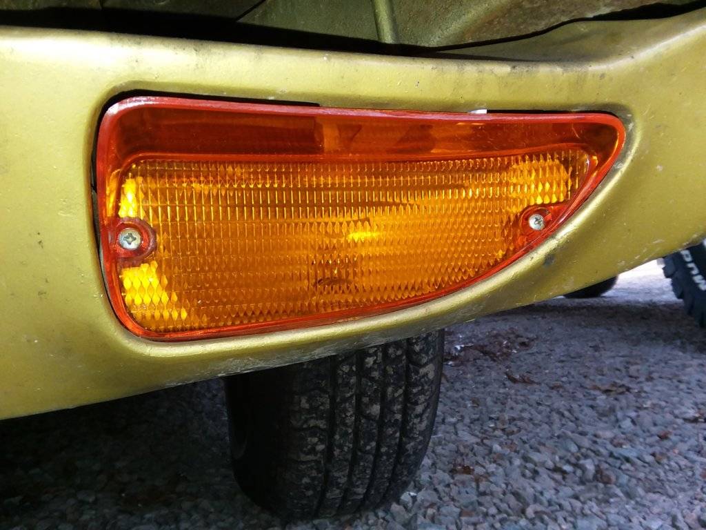

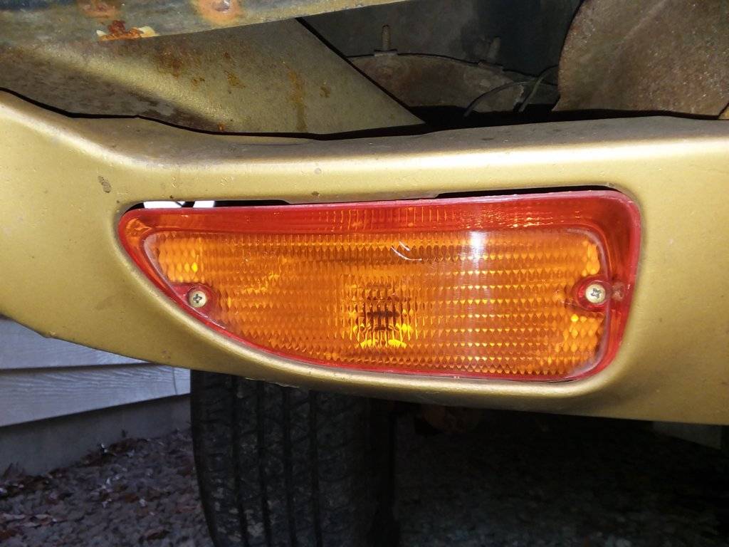

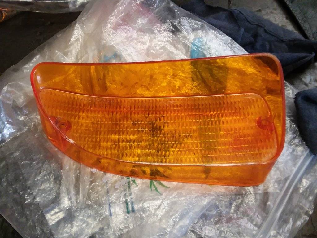

Paid $20 for a used right front turn signal lens.
Old lens with housing. Someone did not know how to remove a lens, 2 phillips head screws. Both sides are like this. Big chip at flange. Someone should not be allowed to own Mopar, but relegated to GM.
Used lens after cleanup with Meguiars Plastic-X
It mounted on the stock gasket just fine.
Purchased Left Side NOS for $32. Waiting for deliver.
Nice job! How did you repair the chip?
I didn't. I paid $20 for another lens that wasn't chipped. The lens were chipped when I got the car.

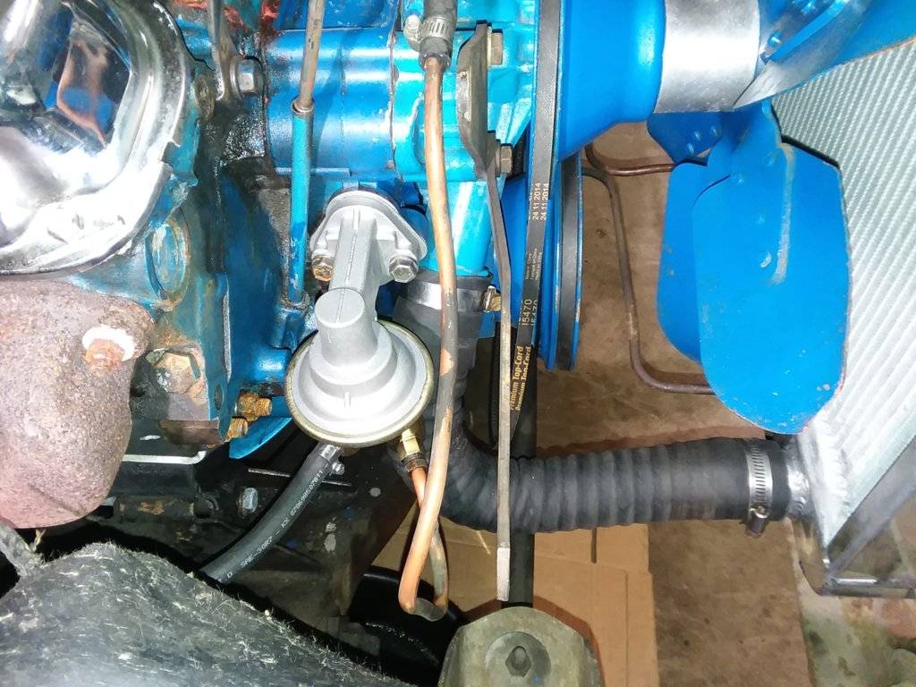

Test Drive: 47°F, new fuel pump installed, speedometer worked OK. Steady needle and no noise. NAPA speedo cable seems an affordable solution at $19.99.
Won't bore you with particulars on fuel pump. Carquest model 360592. It's like $20 in price. Hope it lasts.

· I drove to work this morning. The temperature was 30°F. Old cable made noise below freezing so this is the real test.
· Speedometer Cable: the new cable made no noise. It was great not to hear grinding from my speedometer or see crazy bouncing needle.
· Speedometer needle bounces a little on hard acceleration. It didn’t just go straight up the dial, but this problem is minimal.
· Once the car reaches cruising speed, the needle is steady and does not fluctuate.
· My drive to work is 68 miles round-trip. In a 70 mph zone, I cruised with traffic at 80 mph. The 72 Fury was a blast to drive. The steering is not loose, so the car didn’t float all over the road, but stayed in lane.
· At one point traffic got up to 85 mph, but my 72 Fury 360/727 had no problem keeping up. Speedometer needle held steady at 85 mph. High gear 8.25 rear. Don't know ratio.
Overall, at $21.05 including tax, Napa 615 – 1659 is a valid solution to the problem.

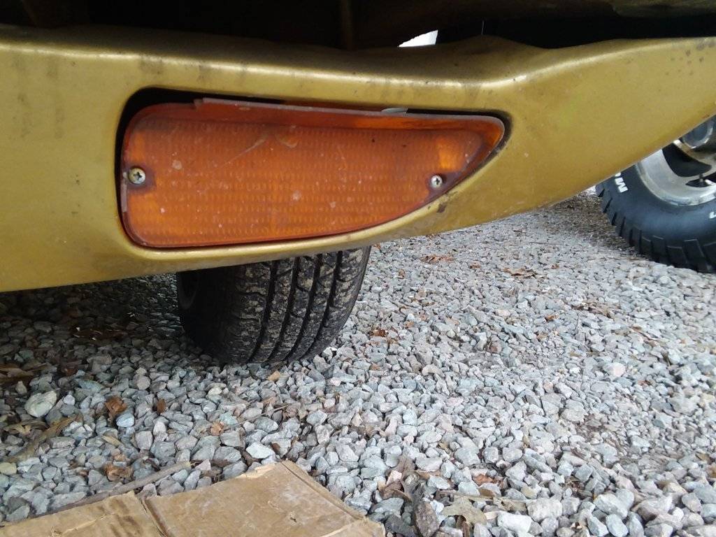

Received NOS LF turn signal lens in mail. $32 including ship from ebay. Sweet. Just fun to hold an NOS part.
Lens had a long journey. With origin in Dallas, ebay seller in Washington state, and me in Virginia, this lens has traveled over 5000 miles in 37 years to reach it's intended destination: a 1972 Plymouth Fury.

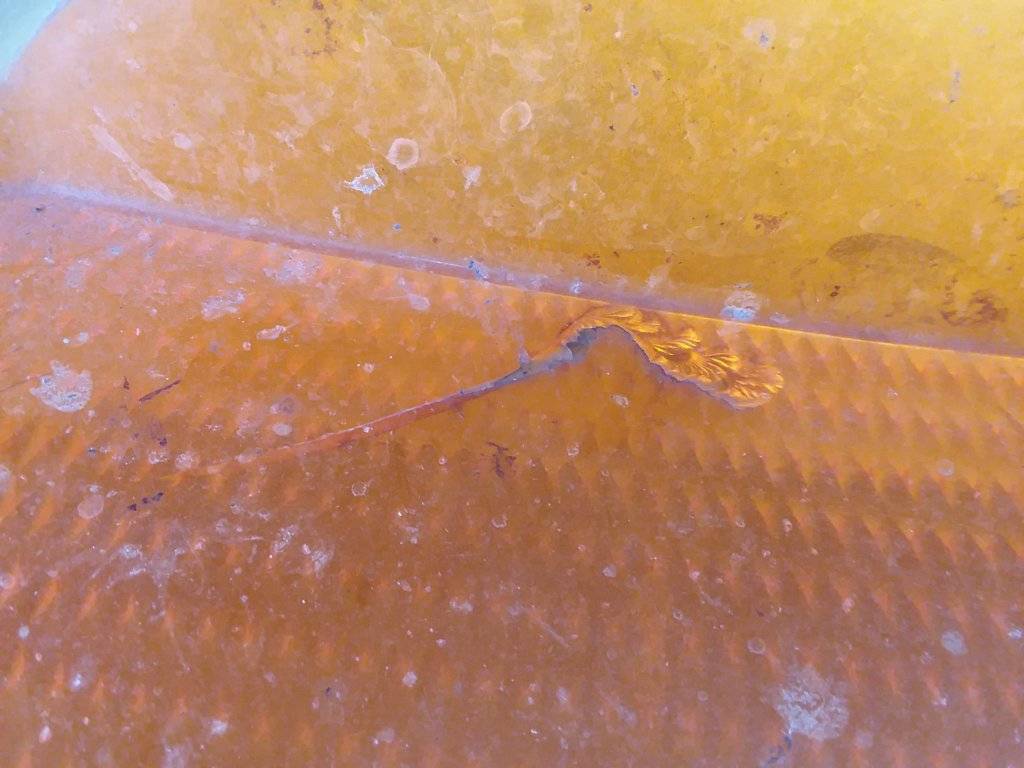

Old turn signal lens
Biggest crack
Big chip from idiot previous owner armed with flat blade screwdriver
NOS installed
Right side, used but cleaned up

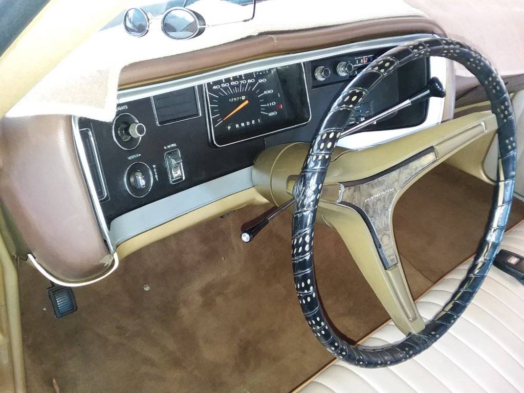

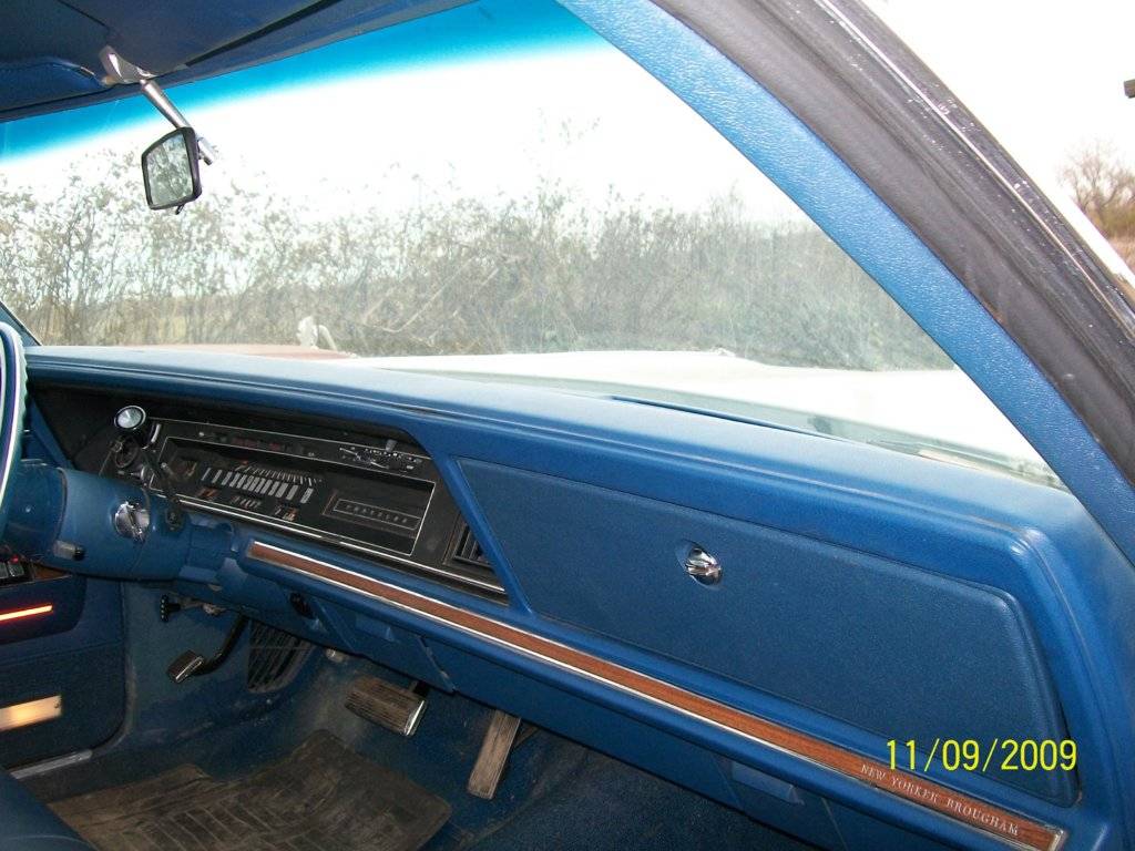

I posted this in interior forum. Copied here.

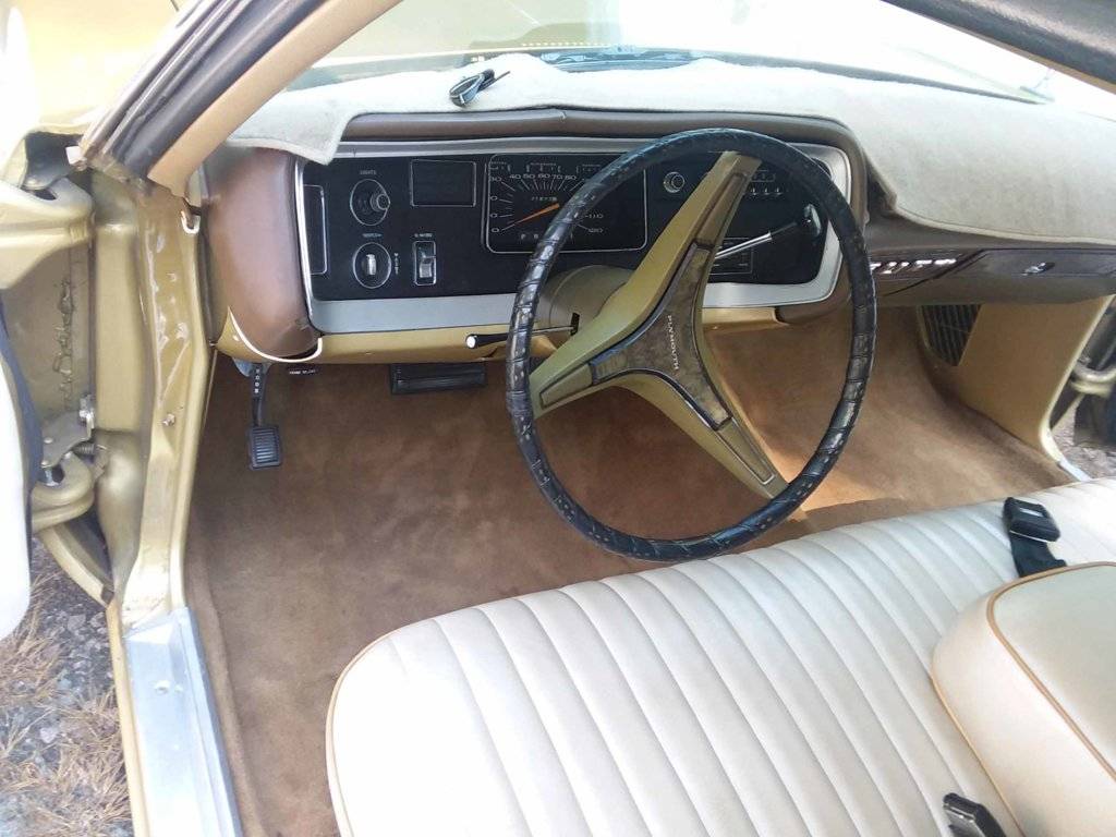

· The dash pad in my 1972 Fury is pretty ugly. It’s got big cracks in the pad material and needs to be recovered. I have not pulled the dash pad off the dash shell to inspect it closely, so this is a hypothetical question:
· If I did decide to replace the dash pad for whatever reason, would the dash pad from a 1972 Dodge Polara/Monaco be the same? In other words, are the 2 Dash pads interchangeable? What other years are interchangeable with 1972 Fury dash pad?
· The Dodge and Plymouth dash shells look the same to me. The Chrysler dash shell does look different.
· Please note: this is not a want ad. This question has to do with, when I get to pulling my dash apart, what are my options.
· As always, thanks for your help. FCBO is a great source for information. It’s a privilege to be a member here. Ben

1971-1972 New Yorker (From internet)

If not a Fury dash, it could be from a Polara/Monaco. I recommend Murray Park (cbodies.com), he at least had a correct dash pad available some time ago.
