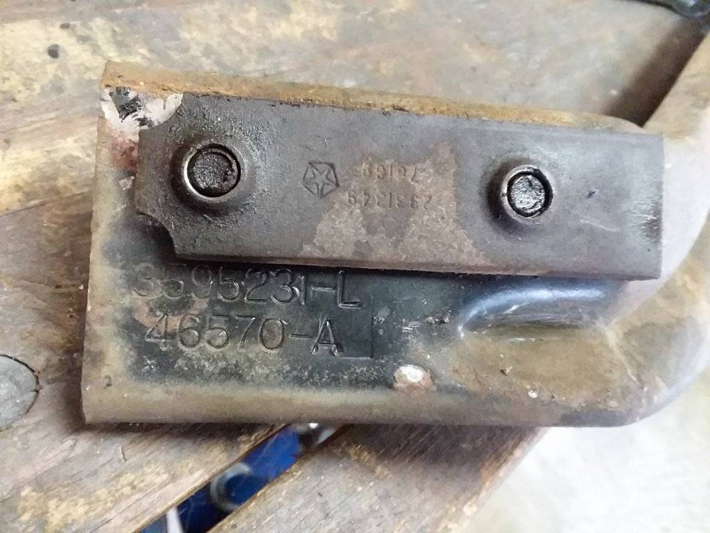

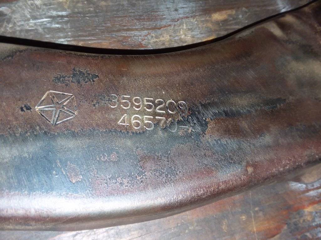

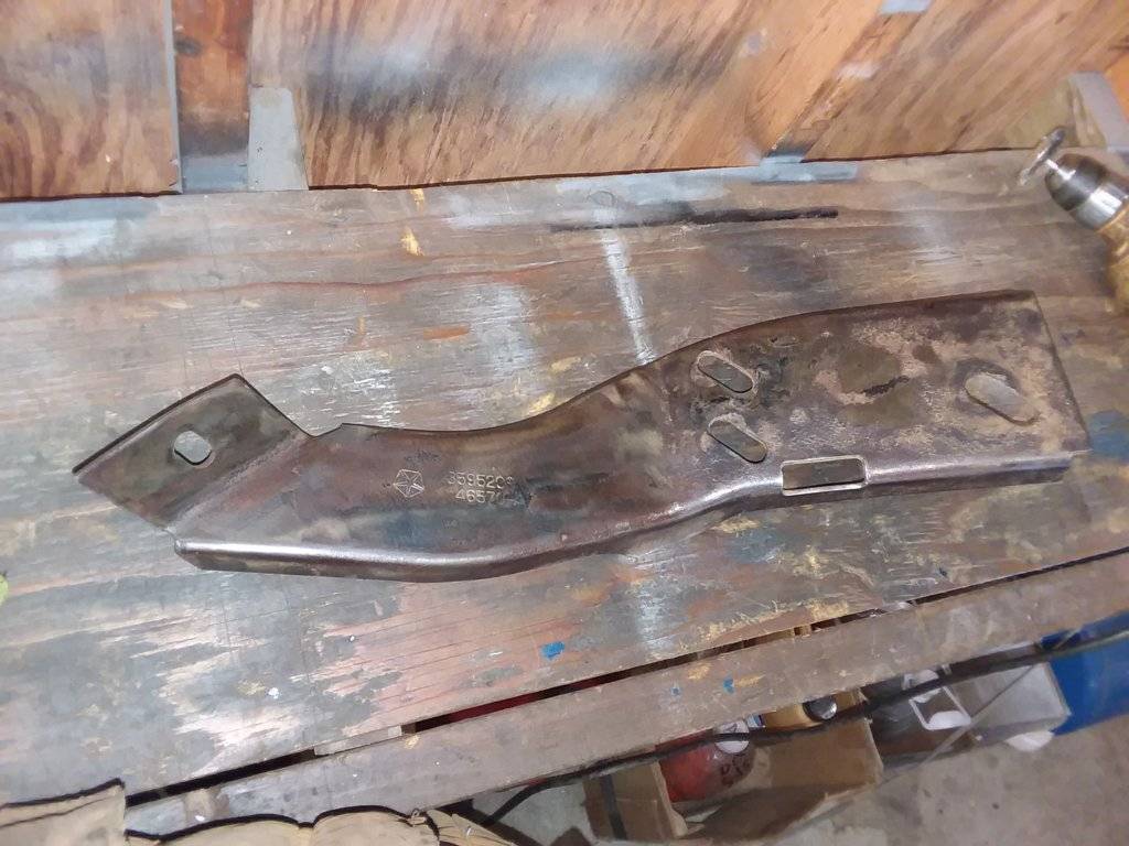

Part number and pentastar from that bracket

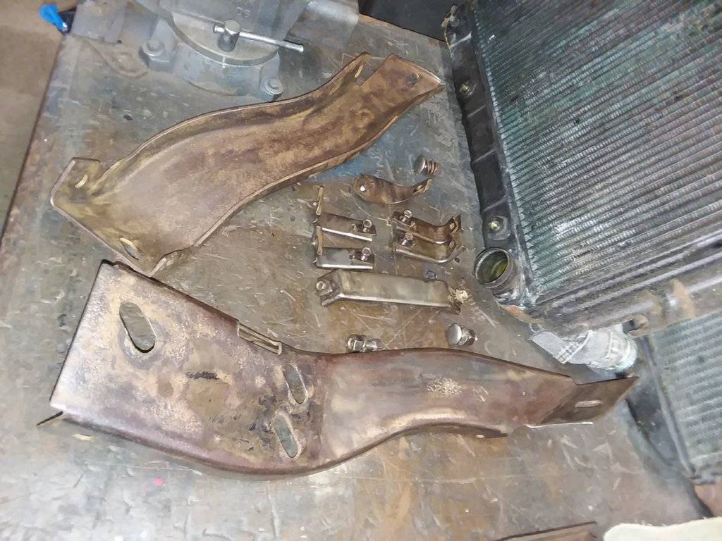

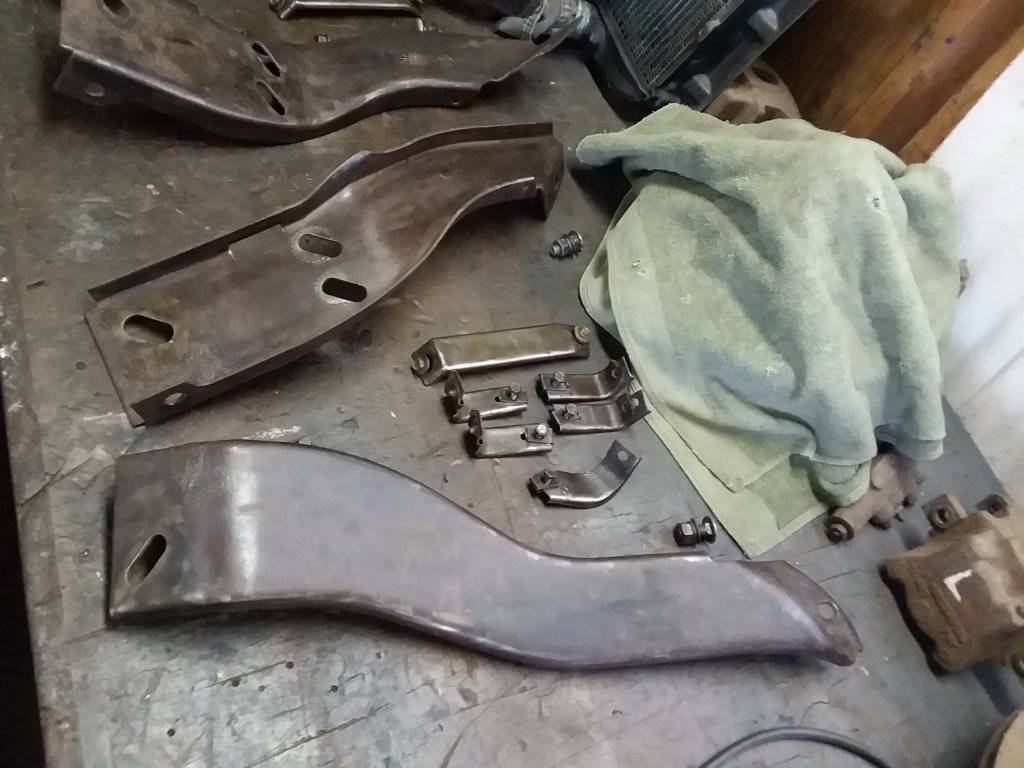

LS lower bumper brackets, upper bumper bracket, grill brackets, and fasteners
RS, same. Not perfect, but good enough to hold paint.
Lower bumper bracket bolts, 3 each side.
Will do center bumper brackets tomorrow. Then paint.

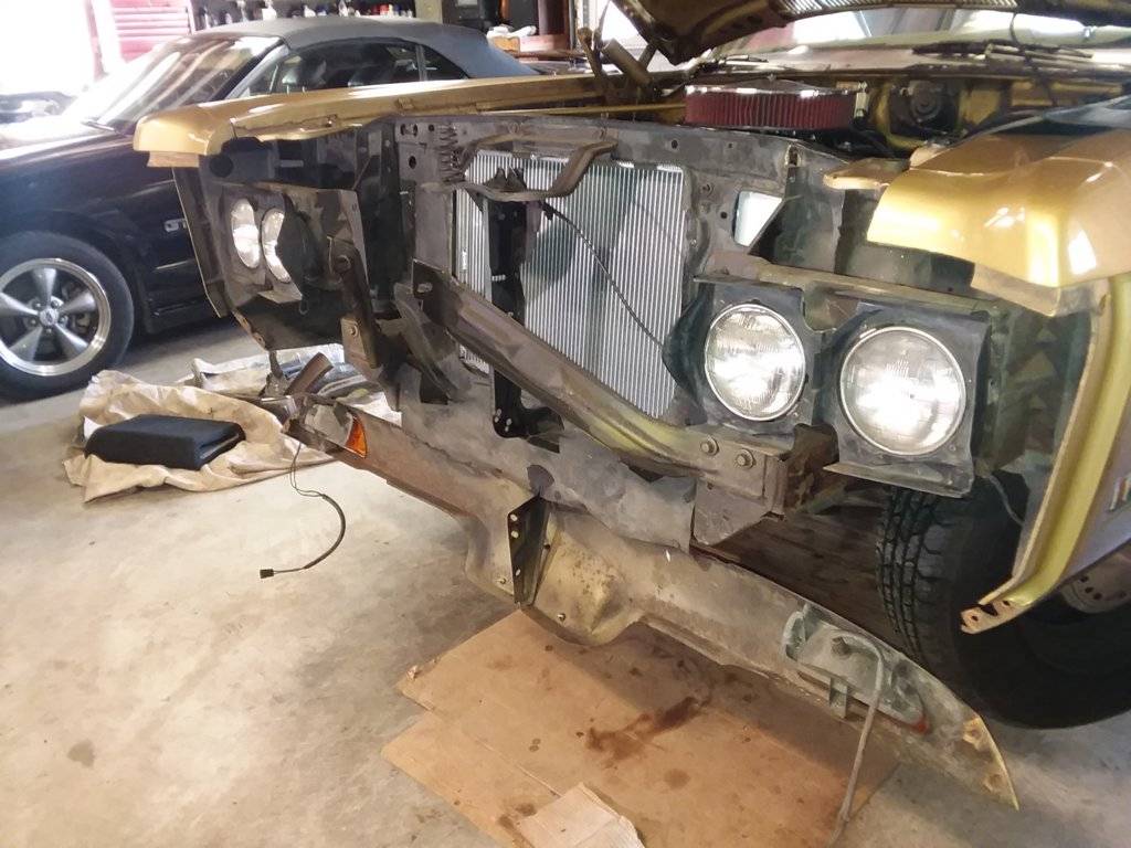

Grill removed

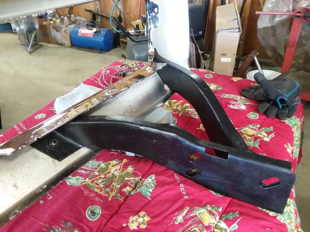

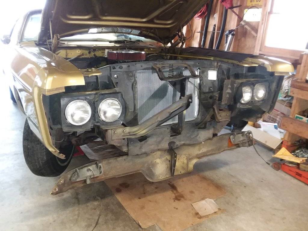

Bumper removed, center support brackets in place, valence hanging by lower rock shield

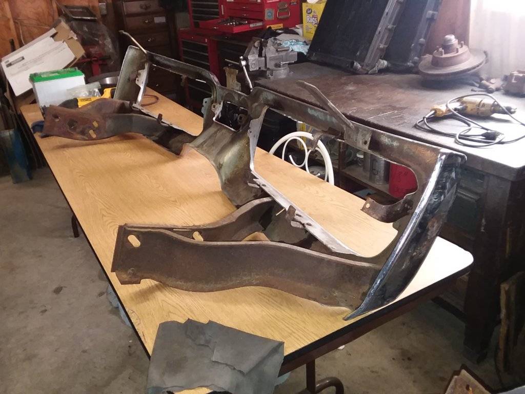

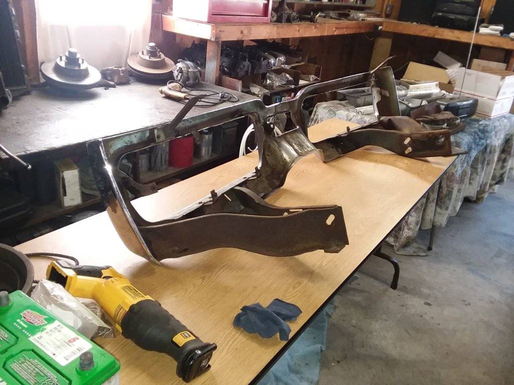

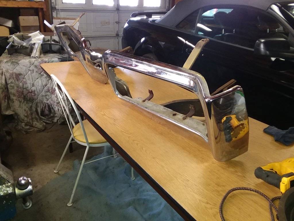

Bumper on work table

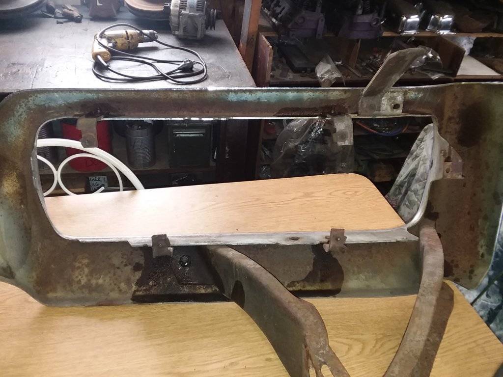

Grill mounts from behind. Supposed to be same for hidden headlight grill.
72 Bumper: WD40 soaking bolts and nuts for brackets overnight
Removed center brackets from front of subframe, 2 bolts each side. Chrysler used bar instead of nuts at rear side of subframe.

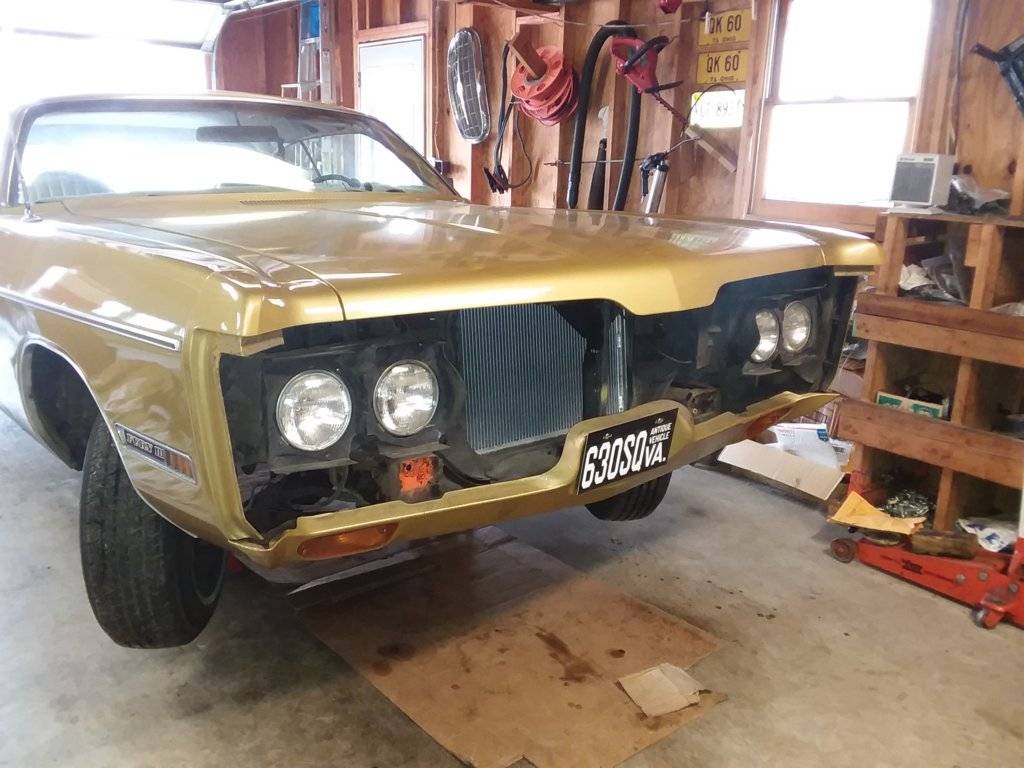

Valence reattached so Fury can be moved out of garage

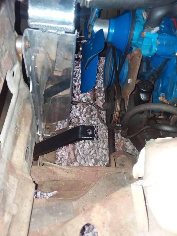

Battery Tray, Install
Support strut, after clean and coat with Krylon black
Support strut installed on radiator support panel

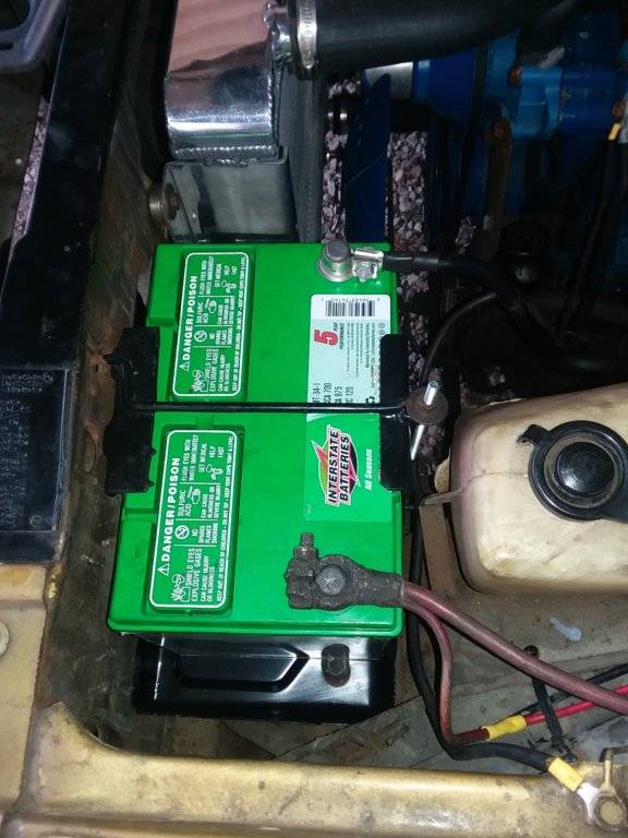

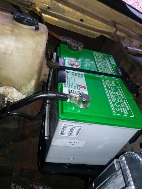

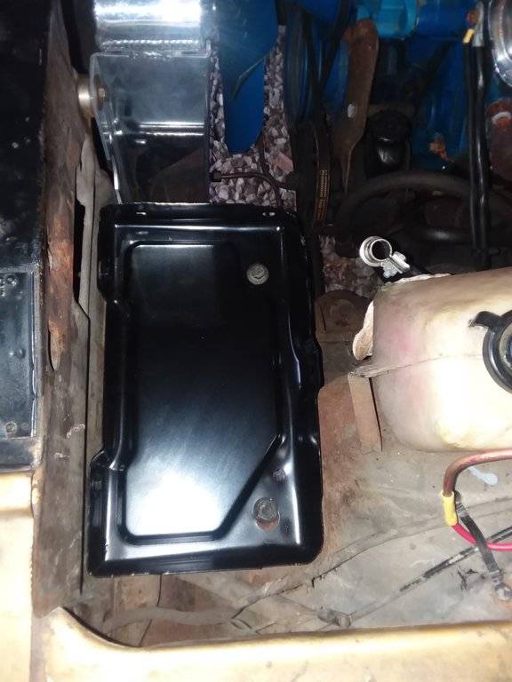

Battery Tray, new: 5/16 drill bit to slot both radiator support panel bolt holes toward radiator. I had to do this because the mounting bracket for my Champion aluminum radiator protrudes farther toward the outside of the car than the stock radiator bracket, so the new battery tray needed to mount slightly to the left of where it normally mounts. It's only about 1/4" off. NBD to slot the 2 holes. Rear bolt holes on tray lined up with strut and wheel well just fine. Now I have 4 mounting bolts instead of 2 View attachment 248610
Battery reinstalled.

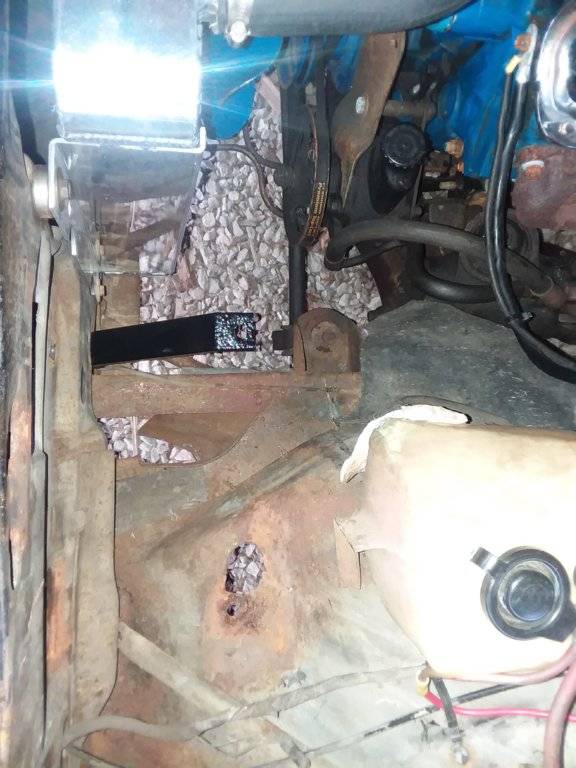

What is the round hole in the wheel arch hidden under battery tray used for? Mine is rusted around the edges and thought the wheel arch had rusted through. Was going to patch hole, but looks like it is there for a reason? If so, will just tidy up edges with Dremel . Thanks
Do not know why hole is there. Had same question when I saw it. WTF? Just a way to quickly rust a corner of a battery tray. See no harm in a patch.

It's from a leaky battery, acid eats through the metal, and through the wheel well, and then the fender.
Mine will need to be patched too at some point Before that:

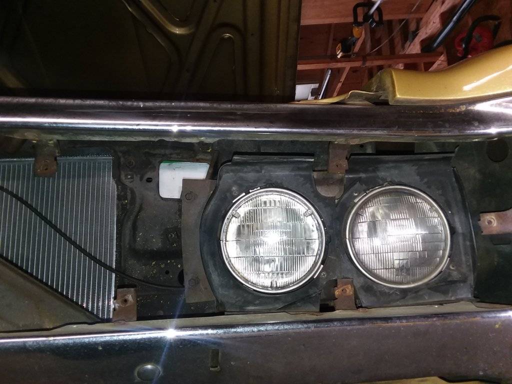

Awaiting hidden headlight grill parts from Montana and grill motor being rebuilt in Texas

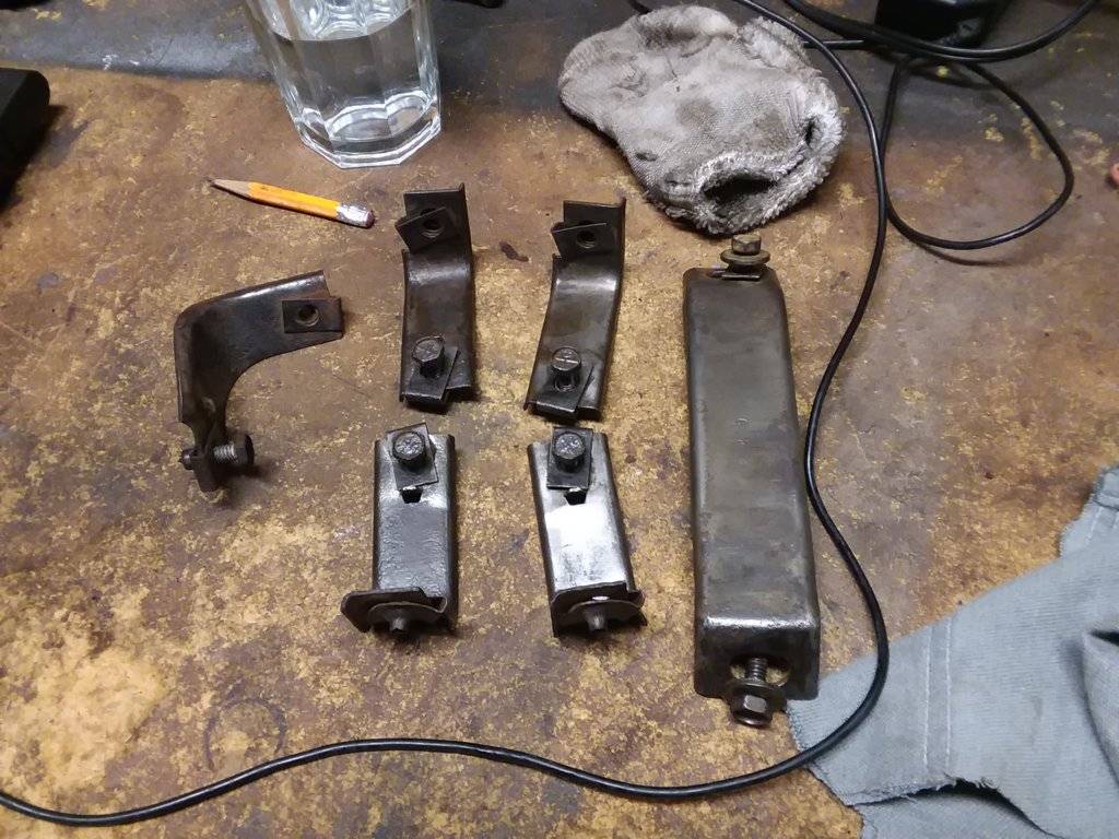

Weather warmed up enough for some bumper bracket paint
POR 15 Chassis Black is supposed to be best applied in 2 thin coats at temps above 55°F

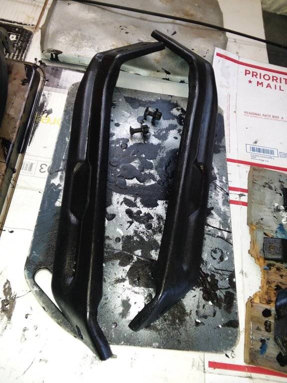

Bumper Brackets, Grill brackets, assorts nuts, bolts and washers, drying after 2nd coat.

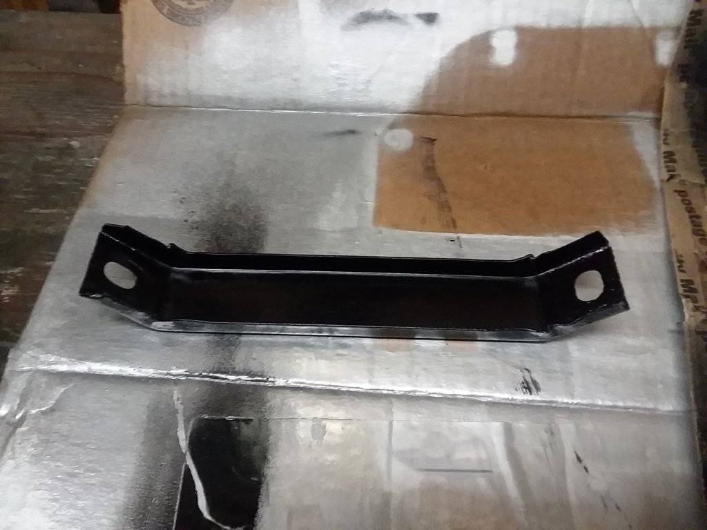

Center brackets
Grill Brackets

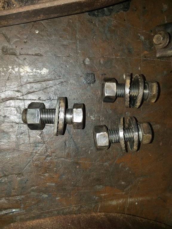

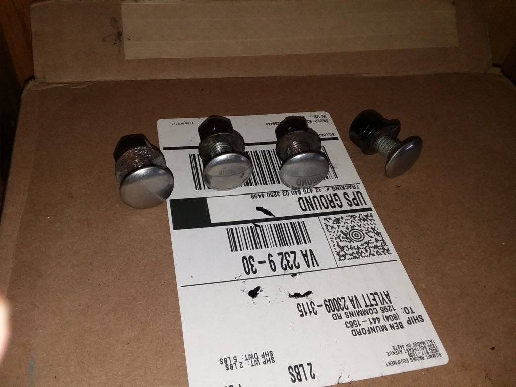

Carriage type bumper bolts

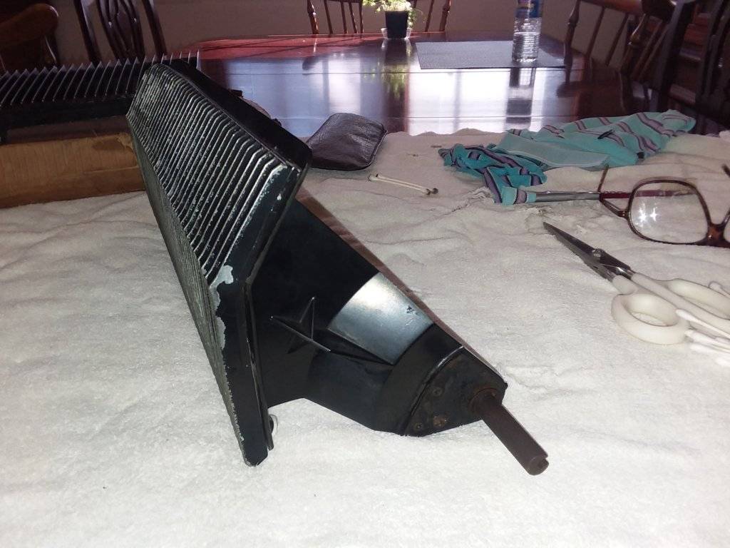

Mounting bracket for grill motor
Begin install bumper brackets, finger tight, because need 4 more fasteners, which I cleaned up and painted today, so not yet installed. Need all fasteners installed before torque fasteners

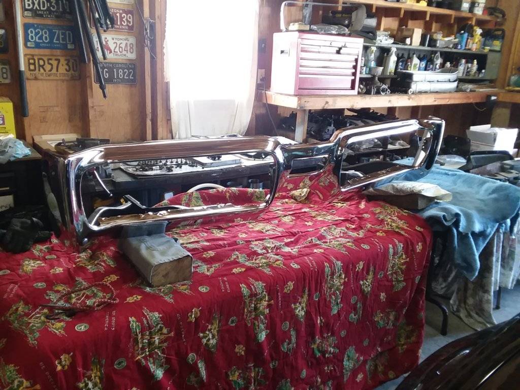

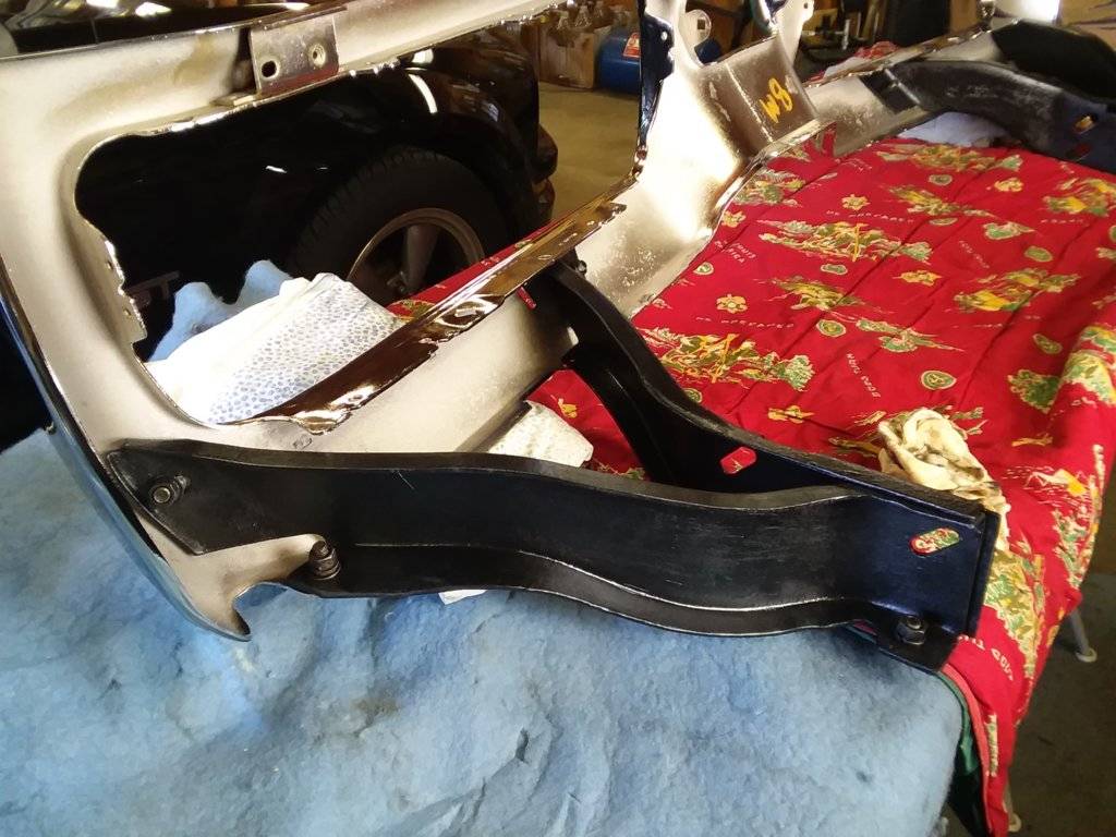

Hanlon Plating rechromed bumper for $450.
Right side
Left Side
Rear View

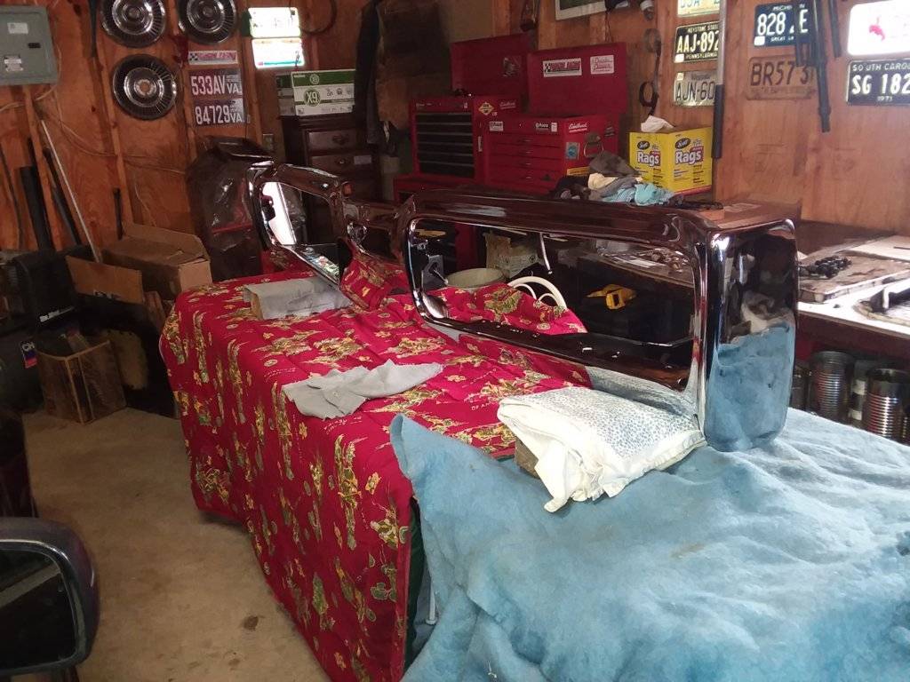

Rechromed bumper
Very nice! That bumper looks like it could blind someone if the light hits it right!

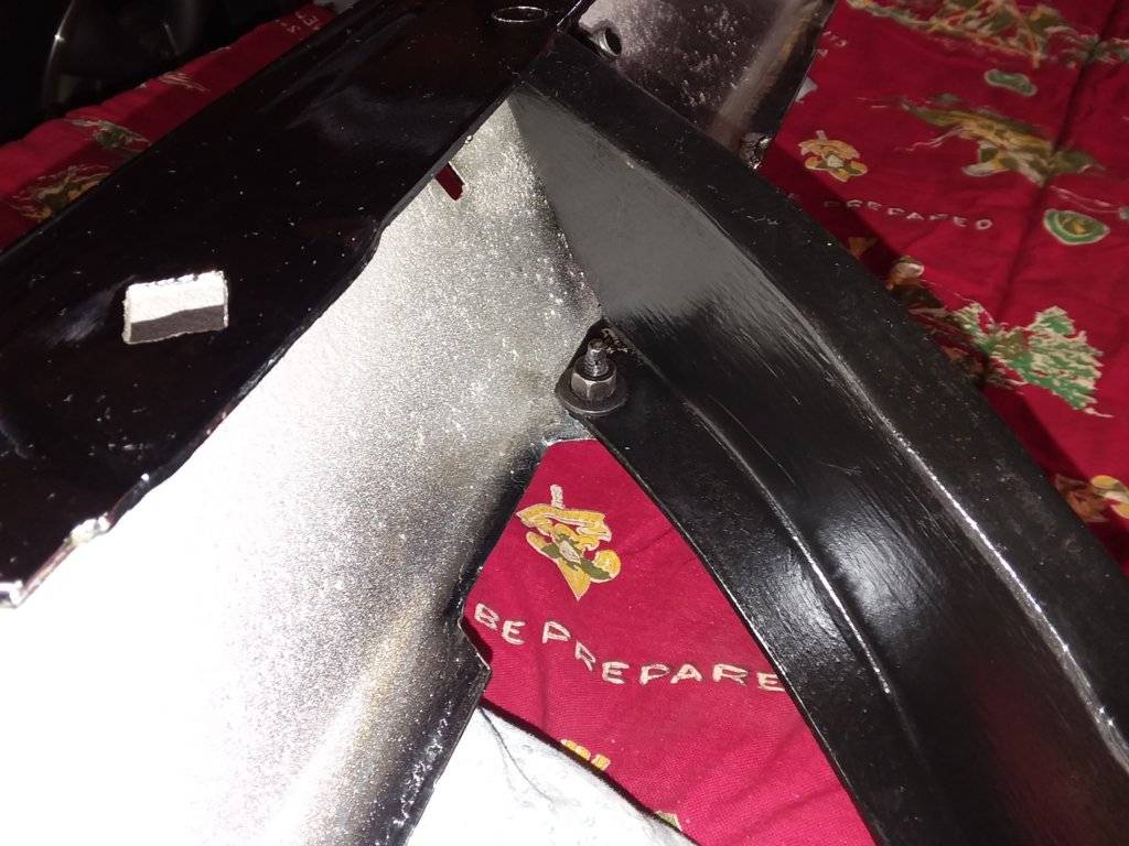

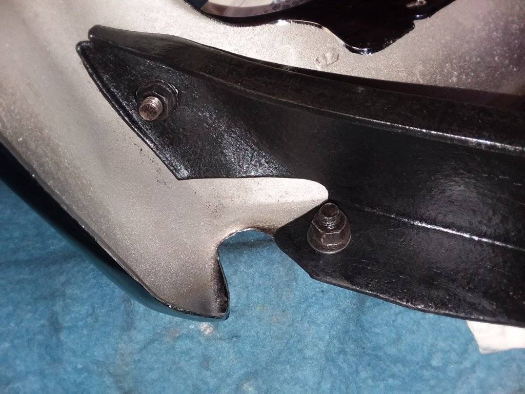

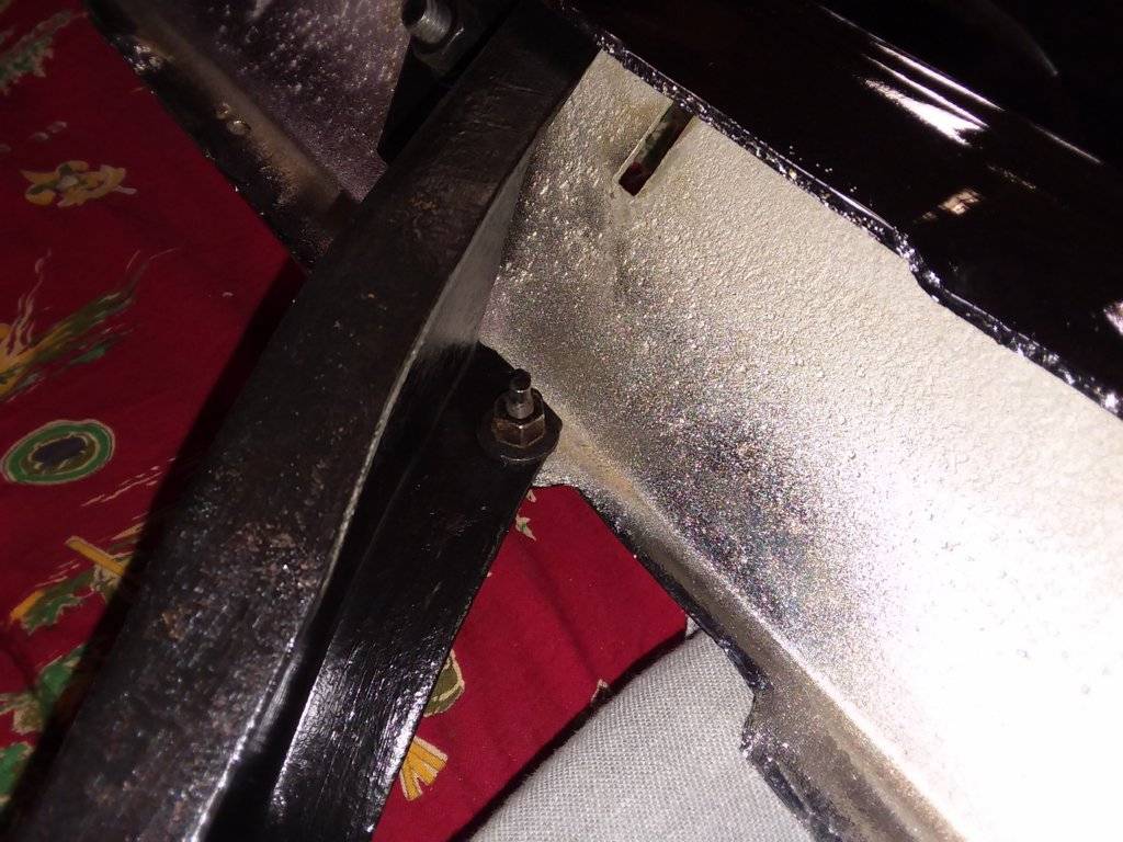

Alignment: rear diagonal slot must stay aligned
Torque bumper bracket bolts and nuts 15-20'lbs, 2 rotations each side. Tighten all to 15, then all to 20. Tighter might have spun the carriage bolts in their square fittings. 1/4" thread inside bracket bolt. Kept that at 15.

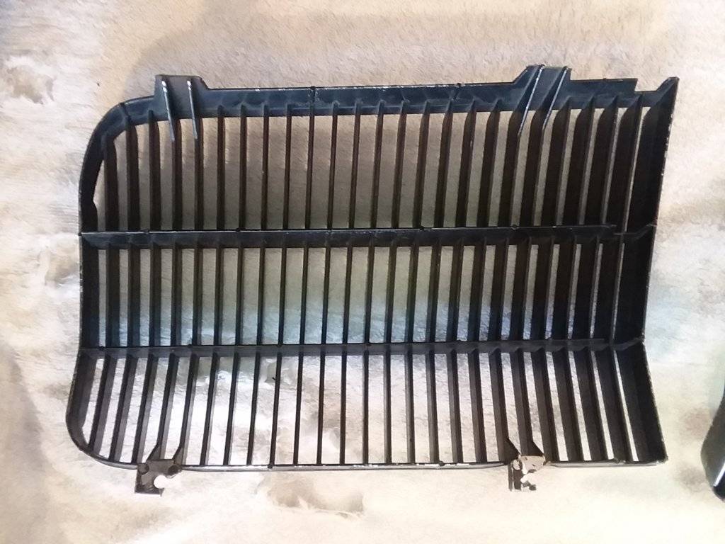

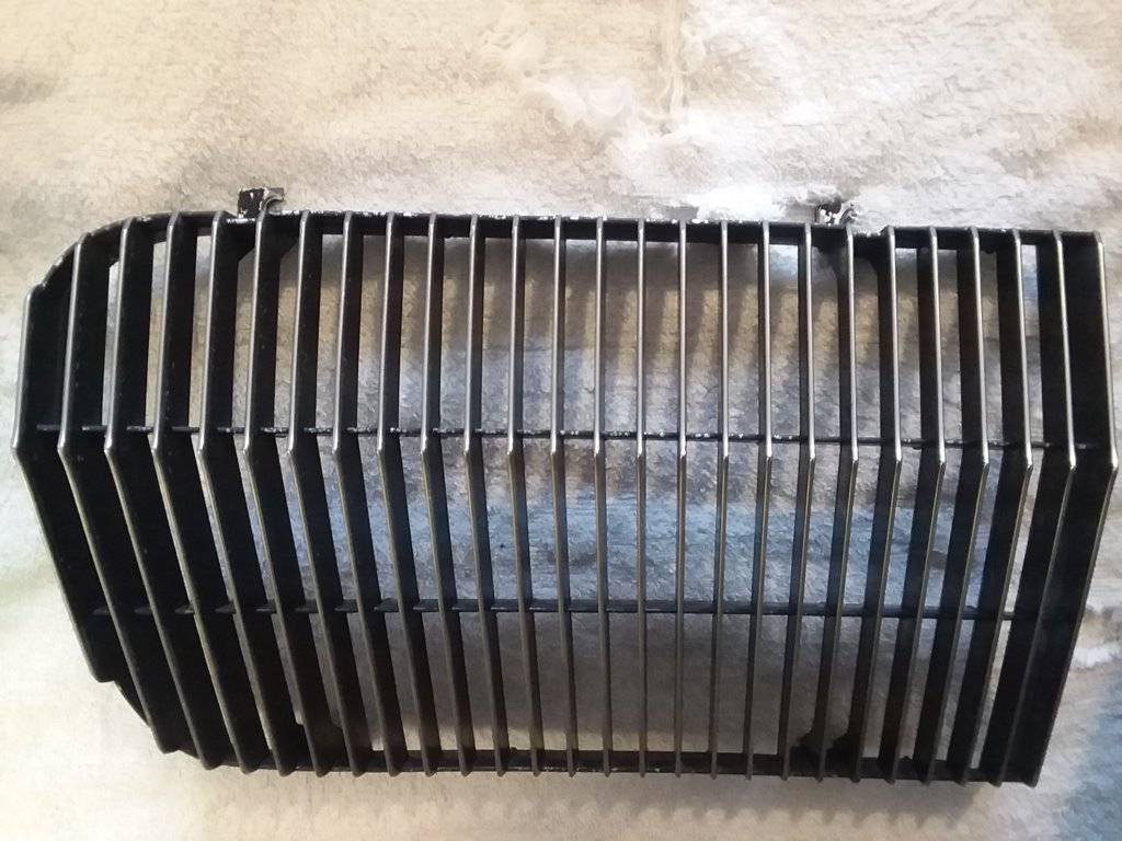

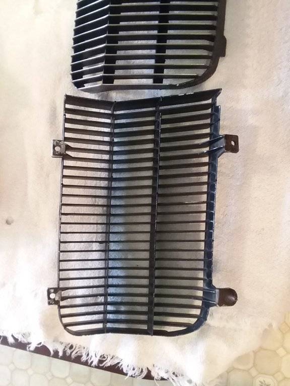

Next Step: I have NOS grill frames coming from @marty mopar. $310 + $110 ship, Fedex ground, Arizona to Virginia. Montana Contact for repaired grill frames fell apart. Don't have anything from him. @kyle340 sent grill frames. Right side definitely repairable. Left side not so much: many tabs broken. Marty had matching pair NOS grill frames sitting on his shelf so decided to spend big money and get something with no broken tabs to repair and no warpage. Will uses Kyle's flip up grills and still looking at finding good left side stationary grill.

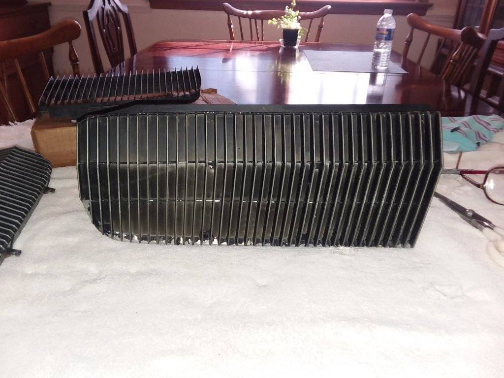

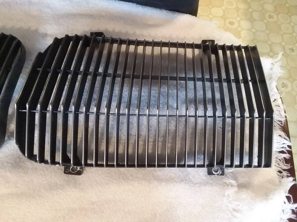

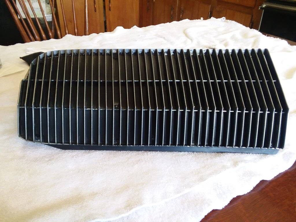

Begin Grill Cleanup. Sink, Dawn, warm water, soft sponges, Q-tips
Center sections. Thanks Dan! @IMFURYS

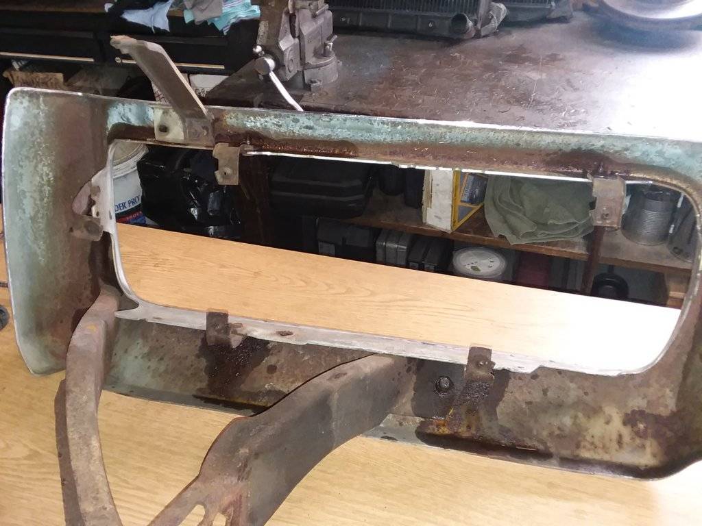

Right Side (nice, has all mounting tabs)

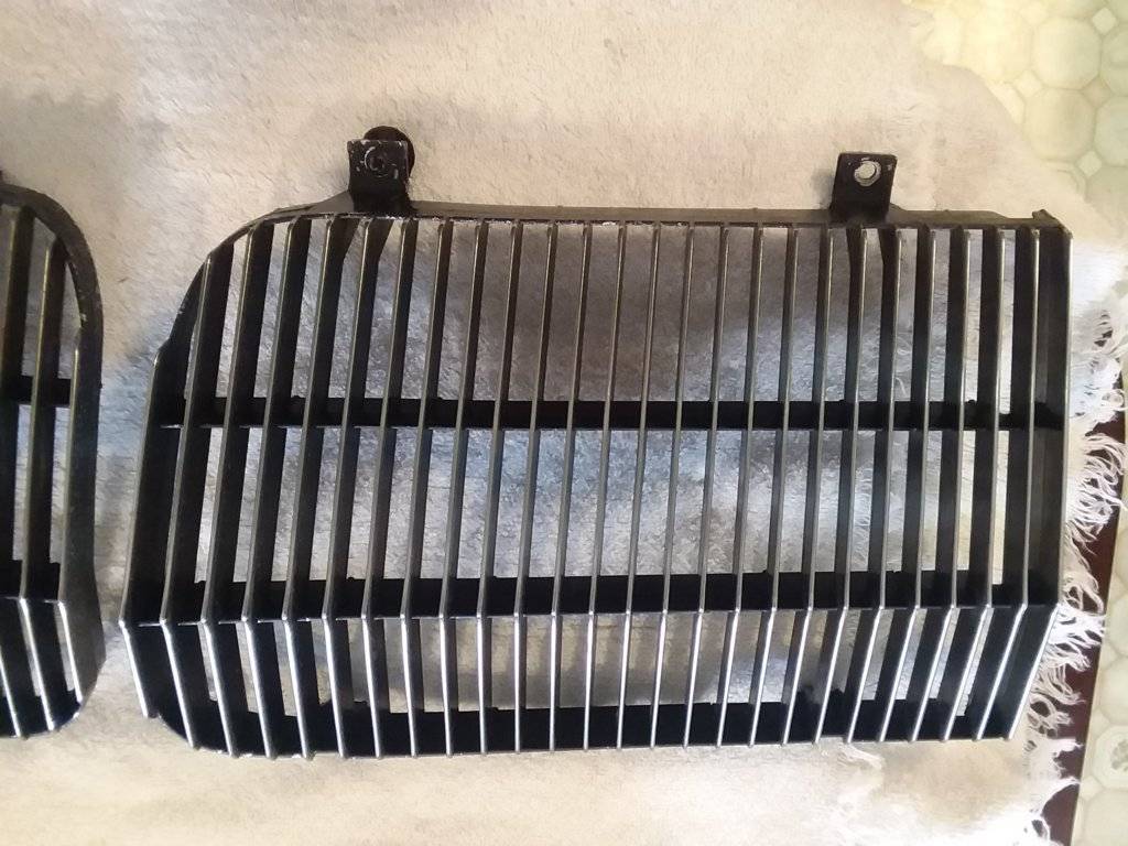

Left side (all tabs broken) Need to add angle brackets

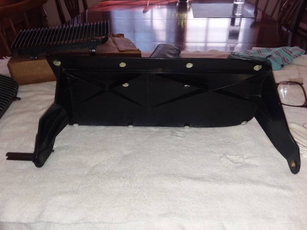

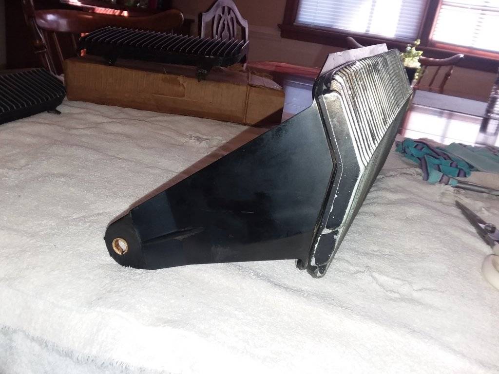

Right side flip up grill (looks better than picture) Thanks @kyle340
Need to clean left side flip up grill, black touch up paint all pieces, and add brackets to left side center grill
View attachment 272828 View attachment 272829 View attachment 272830
View attachment 272839 View attachment 272840

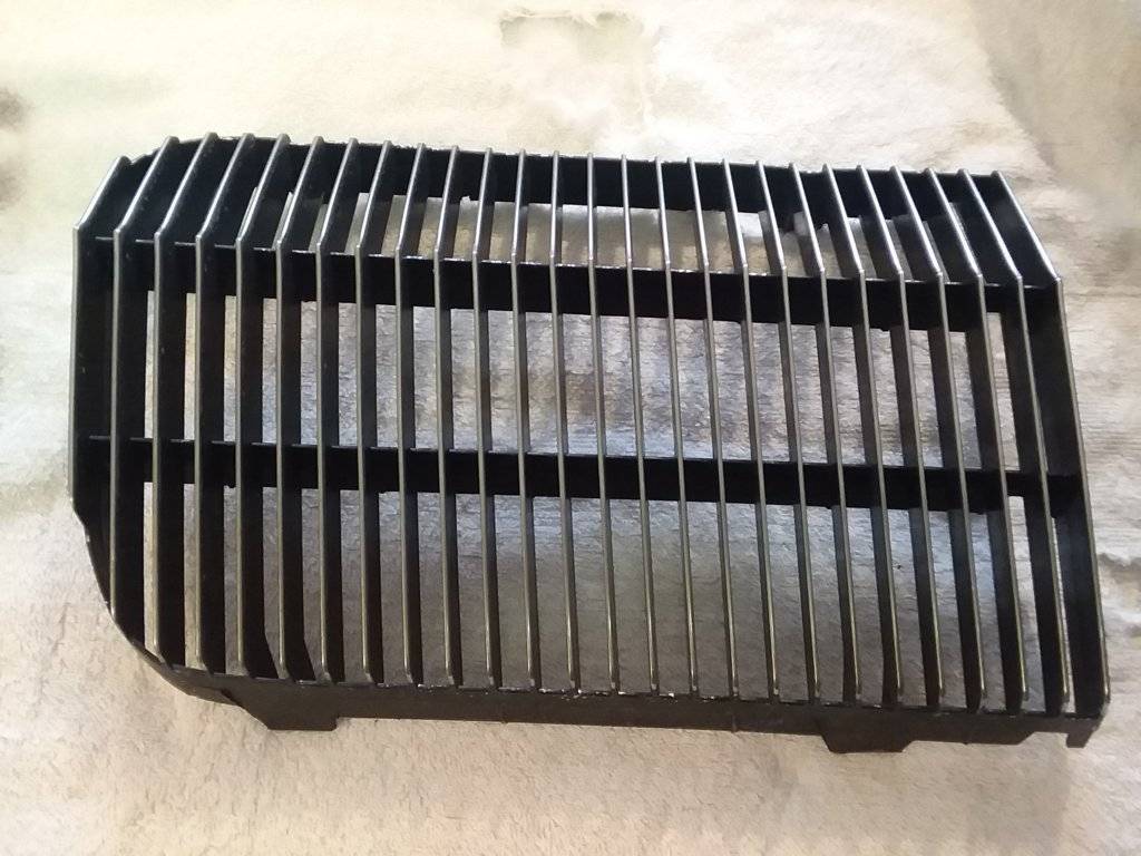

Another day of cleanup. Worked on left side flip up grill for a couple hours. Also soaking machine screws and tab mounting clips in rust remover. I'm supposed to receive grill frames from Marty tomorrow, so I hope to be able to starting setting up the grill on the bumper soon.
