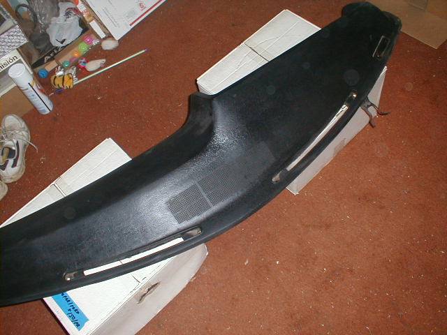

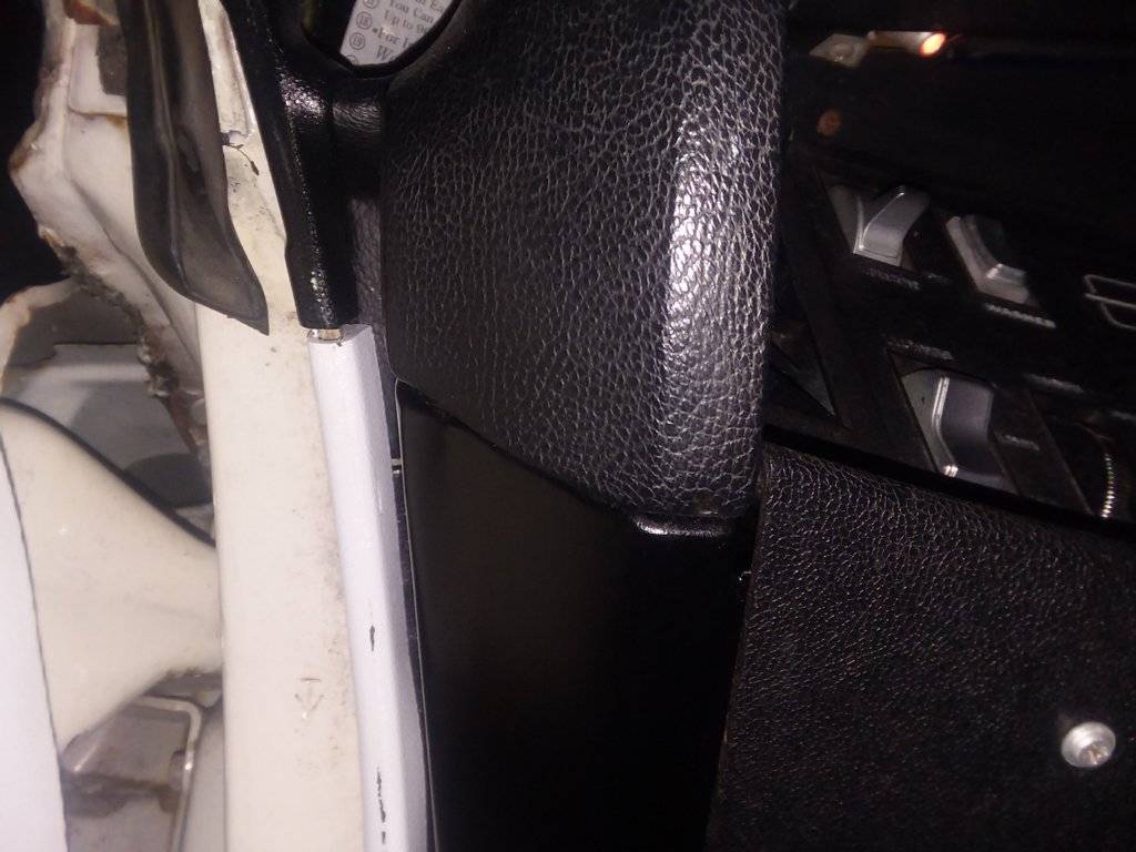

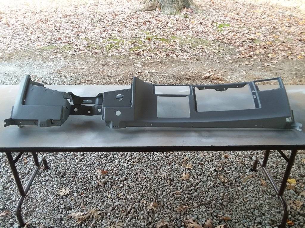

Terminology: when I buying parts for another car, vendors called this part the dash shell. (This is from when I restored the dash on my 1970 Fury convertible)
This part was called the dash pad, backing plate included

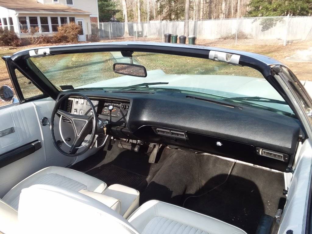

What everything looked like when I combined the 2 pieces along with the rest of the dash assembly
As you can see from the pic above and below, the 1970 Dash pad has actual corners at the instrument panel

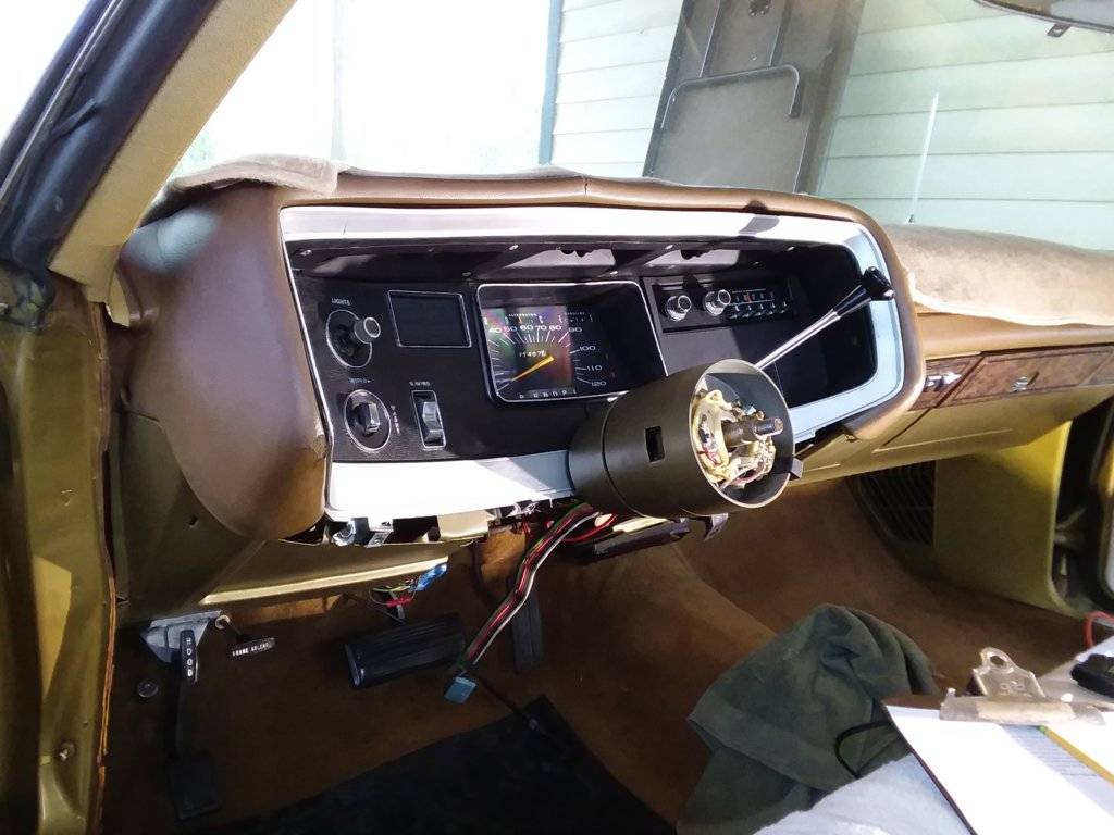

My 1972 dash pad looks more curved as it surrounds the instrument cluster.

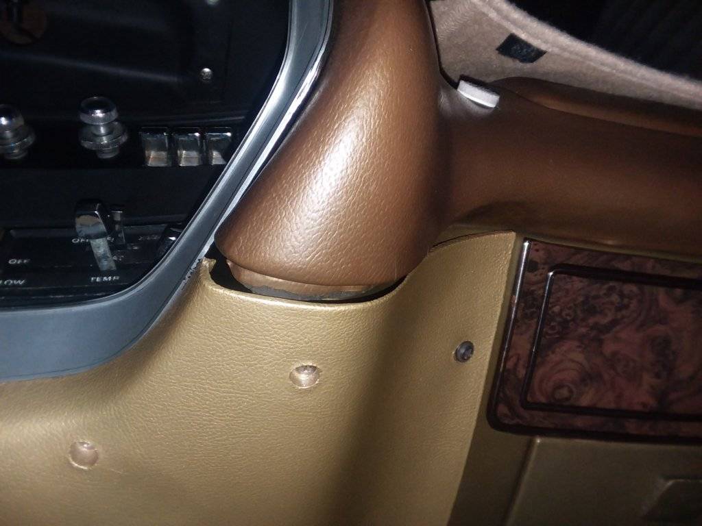

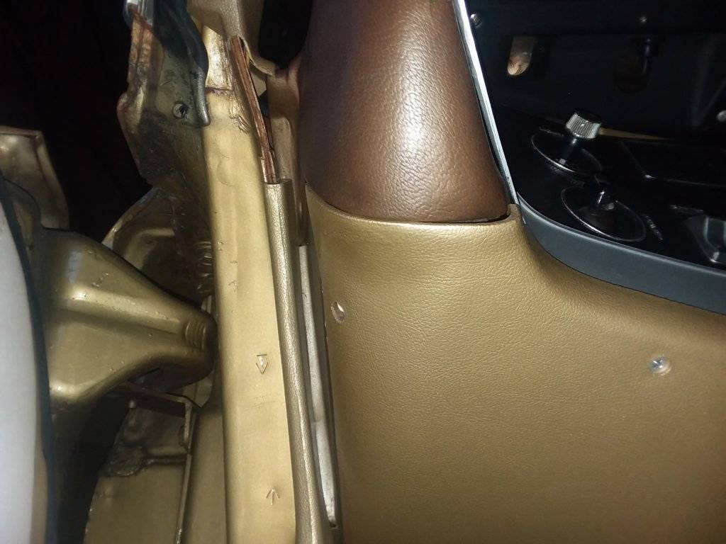

My interior is originally Y5=Medium Gold. Not sure if the brown dash pad is factory or a replacement from a junkyard. I do know that I think the color is ugly, but maybe Chrysler didn't like the idea of a gold dash pad? Could also have gone with black or off-white/cream. My current pad has distortion/shrinkage. Plastic under dash panel is from 1973 Fury. Supposed to be same as 1972.
Plan is to pull the whole dash and- like @MN72Fury said - have abcmoparts recover the pad/backing plate correctly, while I work thru the rest. Plan to do hidden headlight conversion first, before I do the dash. thanks @ImpJay for confirming that only 1972-3 Plymouth or Dodge will work.

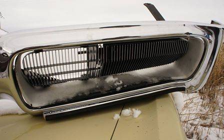

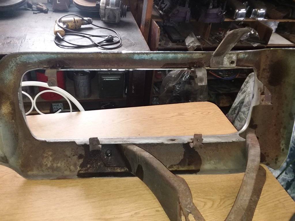

Hidden Headlight Grill
I have a friend in Montana who is doing some epoxy work on this grill. I bought the grill and bumper for $200. Mike is going to remove grill, epoxy repair mounting tabs, and pack the grill for ship. In return, he gets to keep the bumper for his 1972 Fury. My bumper is going to Hanlon plating in Richmond, VA. No bumper guards on mine.
Dan @IMFURYS is helping me with a couple of the center grill pieces (beside the headlight cover pieces) that he has.
Parts acquisition is ongoing.
I intend to paint the grills black.
Does anyone know if the grill surrounds are originally Mopar Argent Silver? Could also be Bright Silver.
Thanks, Ben

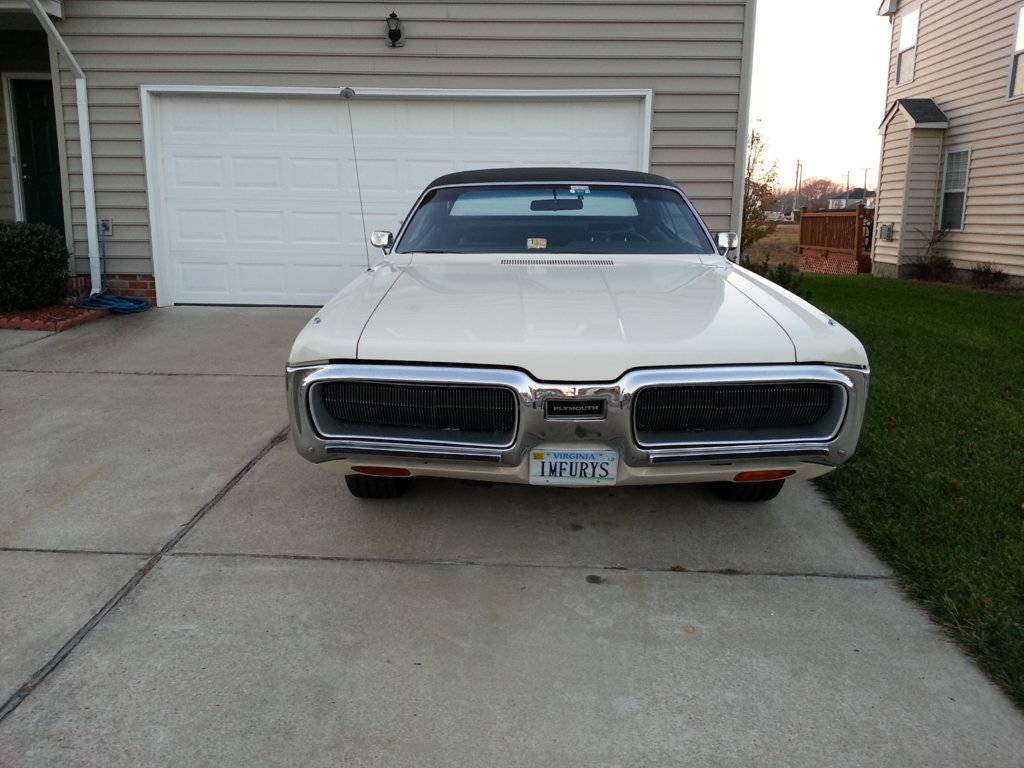

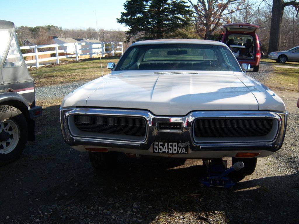

Hey Ben,
Here is a pic of my Fury from the day I purchased her with the factory grilles and a couple of pics during/after the body work. I believe it is argent silver. I'm trying to remember which website has information on which paint colors were used for different Mopar parts for different years. I'll have to see if I have it bookmarked. Hopefully these pics will help in the meantime.
Dan

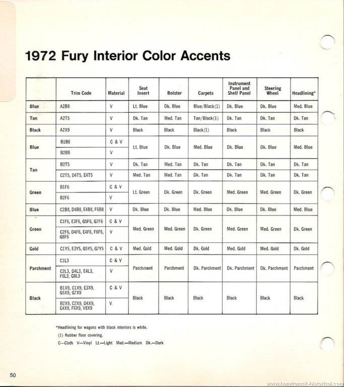

To confirm the interior color(s/shades), I recommend this from The 1970 Hamtramck Registry - 1972 Plymouth Color & Trim Book - Stripes & Interior :
I assume that the code for yours is E3Y5 or D4Y5.

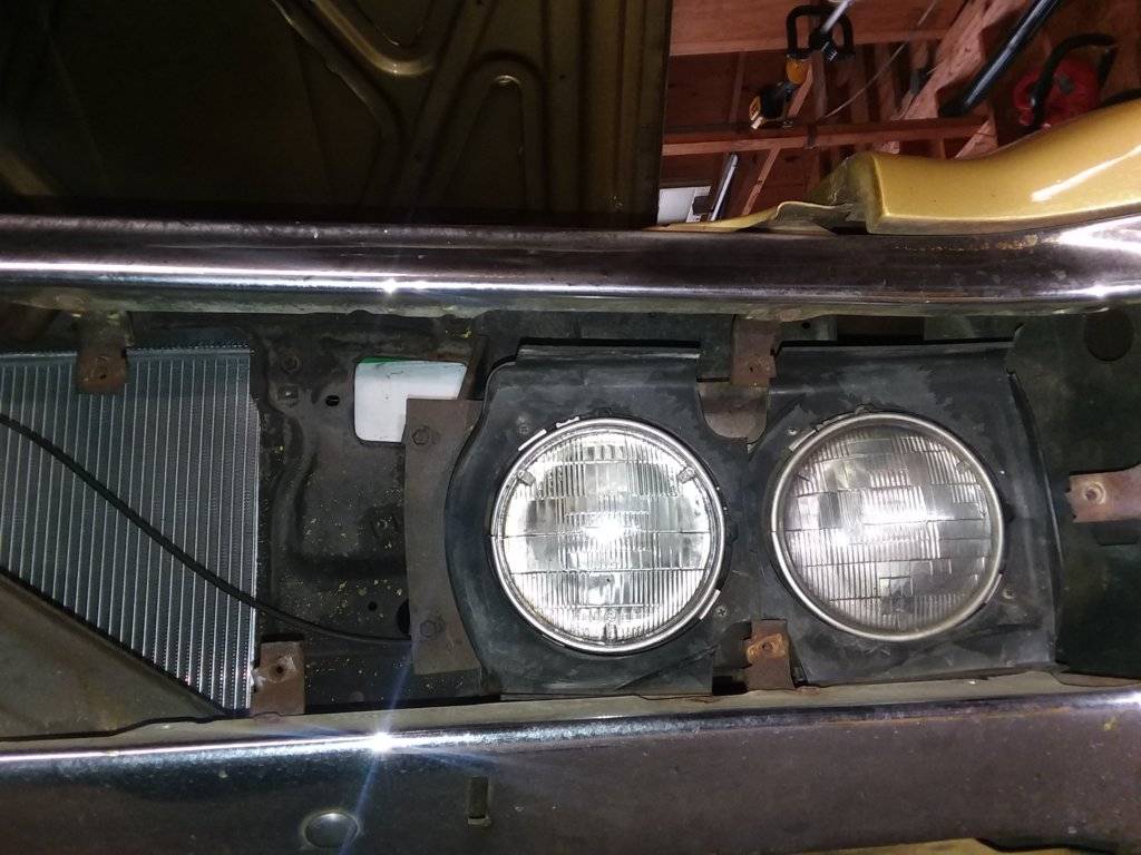

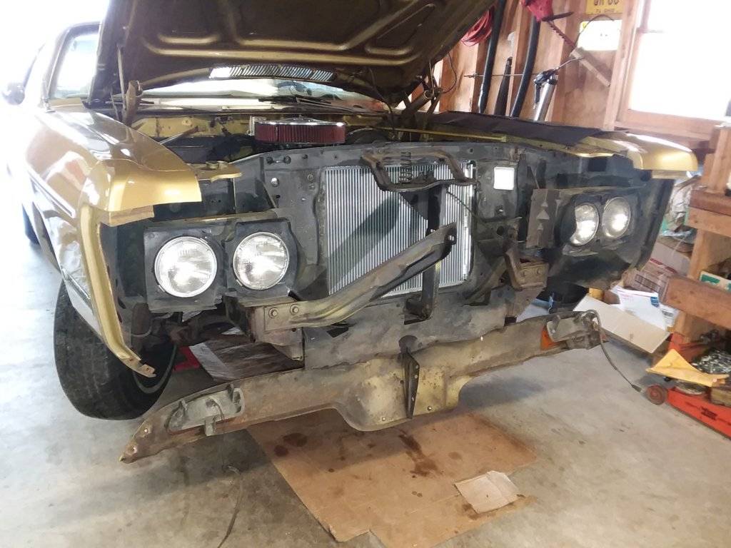

Front Bumper Remove for Rechrome
Grill removed
Bumper removed, center support brackets in place, valence hanging by lower rock shield
Bumper on work table
Grill mounts from behind. Supposed to be same for hidden headlight grill.
72 Bumper: WD40 soaking bolts and nuts for brackets overnight

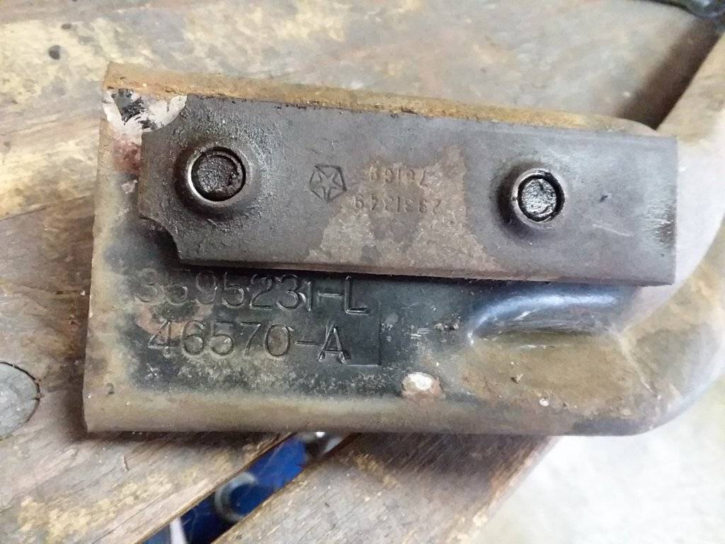

Removed center brackets from front of subframe, 2 bolts each side. Chrysler used bar instead of nuts at rear side of subframe.
Valence reattached so Fury can be moved out of garage
Thanks Jay & Triple P!

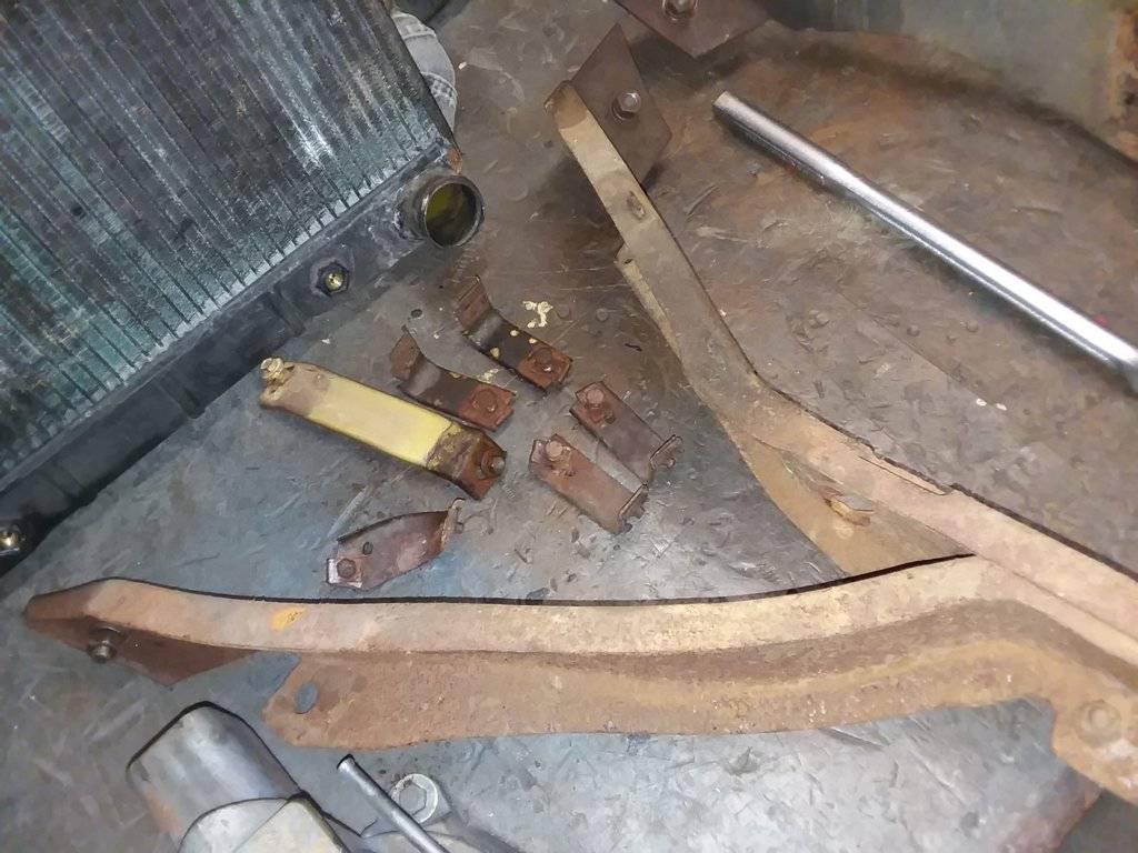

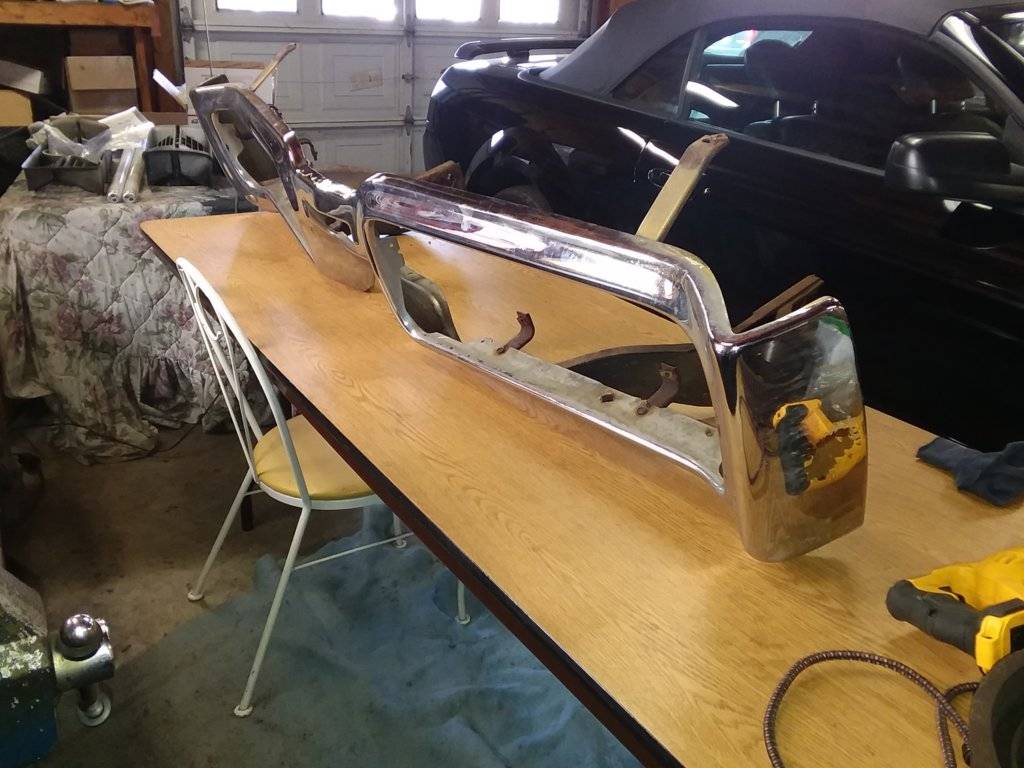

Front Bumper continued. Brackets removed. 7/16 x 14 coarse die helps on rusted carriage bolts (round chrome head, square fitting to attach at bumper).
LS Brackets
RS
Lots of rust: will drop off for rechrome tomorrow.

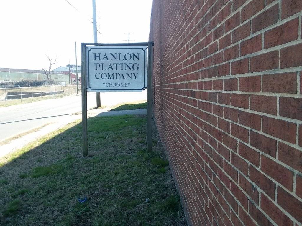

Bumper Rechrome

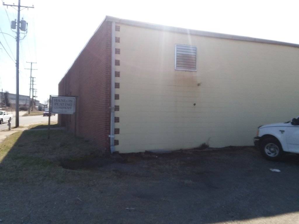

I spoke to the owner, Jeff Hanlon. He seemed knowledgeable. His family has been running the business since 1975. Looked at some chrome bumpers he had finished. Looked excellent. I asked about his one bad google review. He commented that the metal in the parts received was poor, so rechrome was not top quality. With my bumper, metal is strong, so we should be OK.
Hanlon Plating, Richmond, Virginia, Chrome, Bumper Repair, Replating, Straightening, Restoration, Automobiles, Boats, Motorcycles
