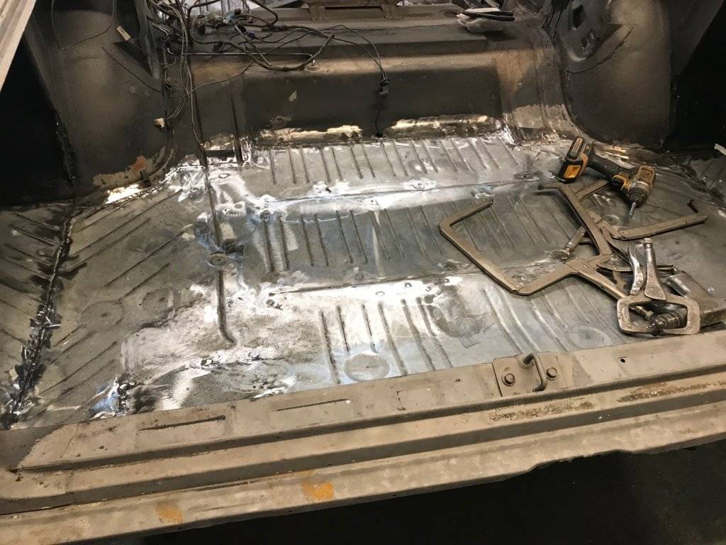

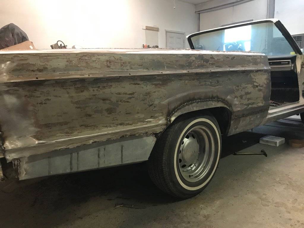

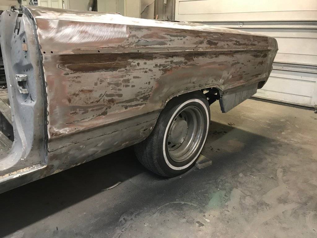

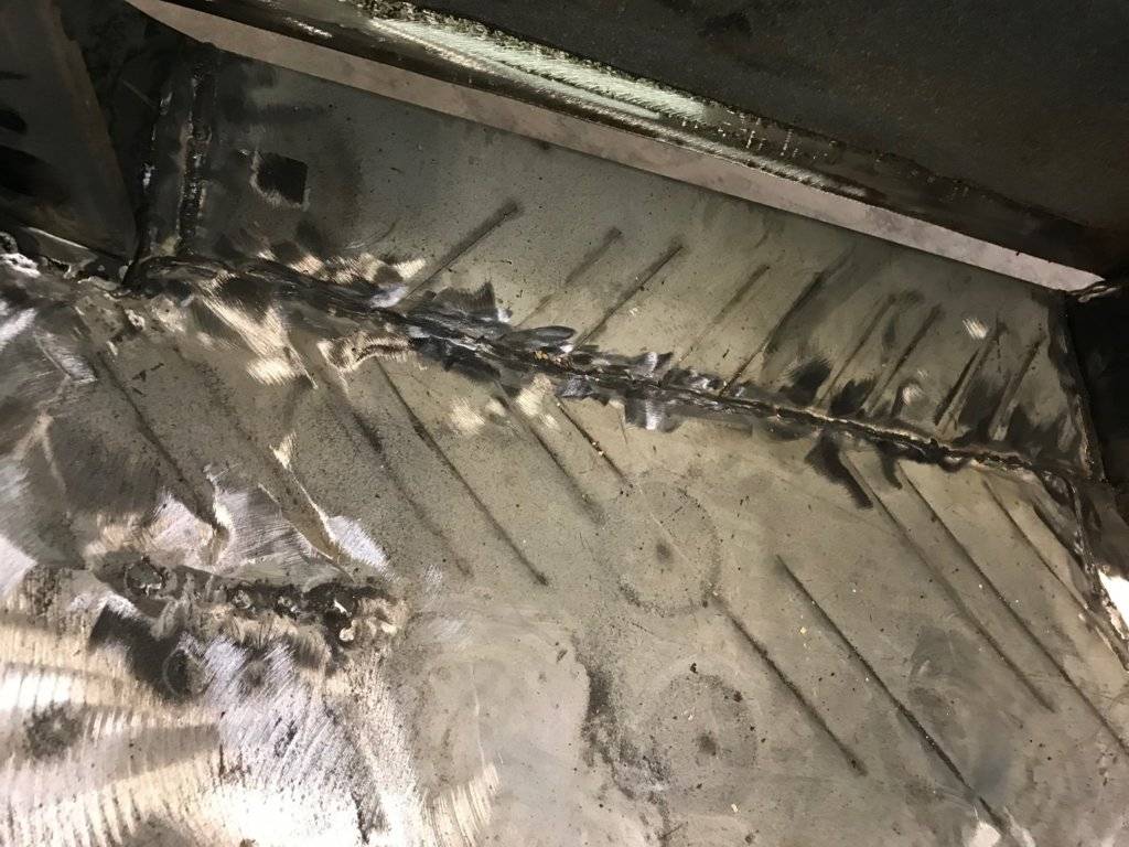

Welded in the donor quarter panels and began grinding down the welds. Also cut out and welded in the trunk pan and drops.
Next will be to temp install the fender skirts so fabrication of the lower quarter panels can begin and then weld and grind.
The donor quarter panels look much better than the bashed up panels we found under the bondo.

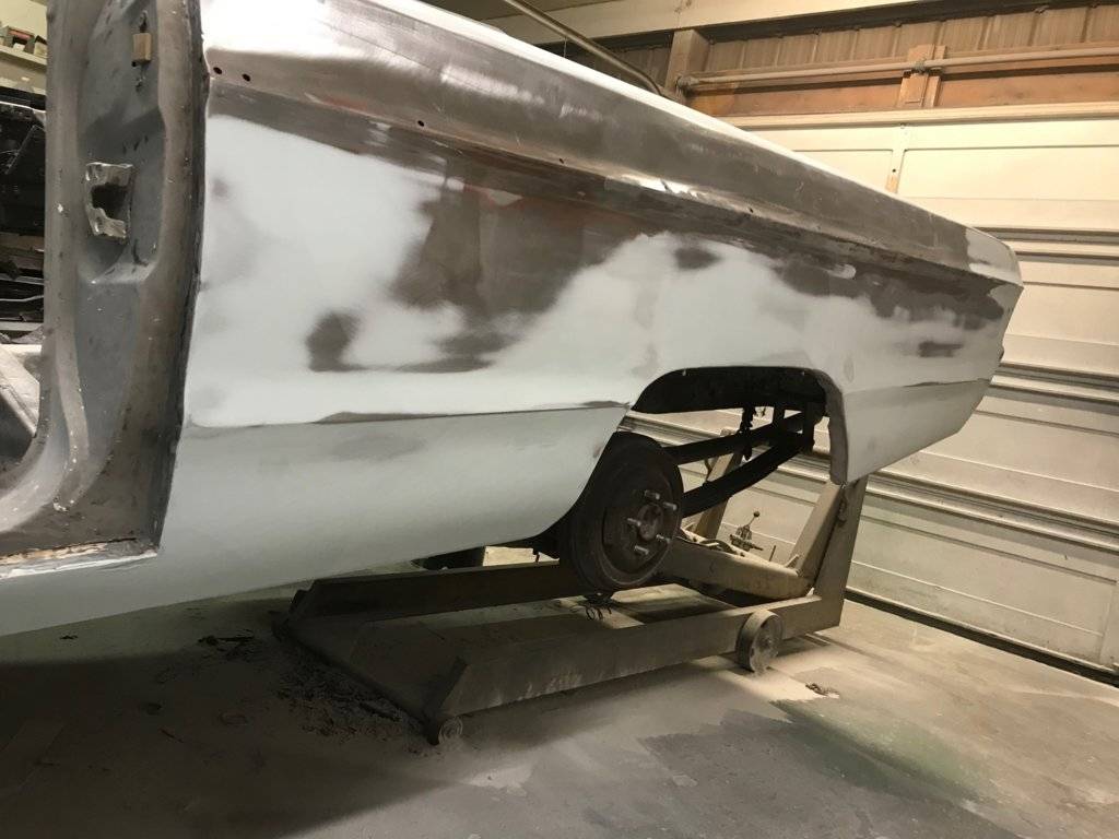

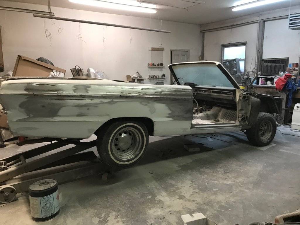

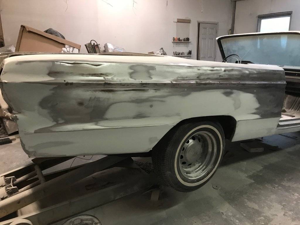

Got the lower quarters welded in and hit with the grinder. Now working on body filler and some misc welding. Repairing one of the rear seat belt mounts that somehow was ripped out by the PO and installing the Sway Bar perches salvaged from the VIP parts car.
Should be shooting primer next week. And another pic of the new trunk pan.....

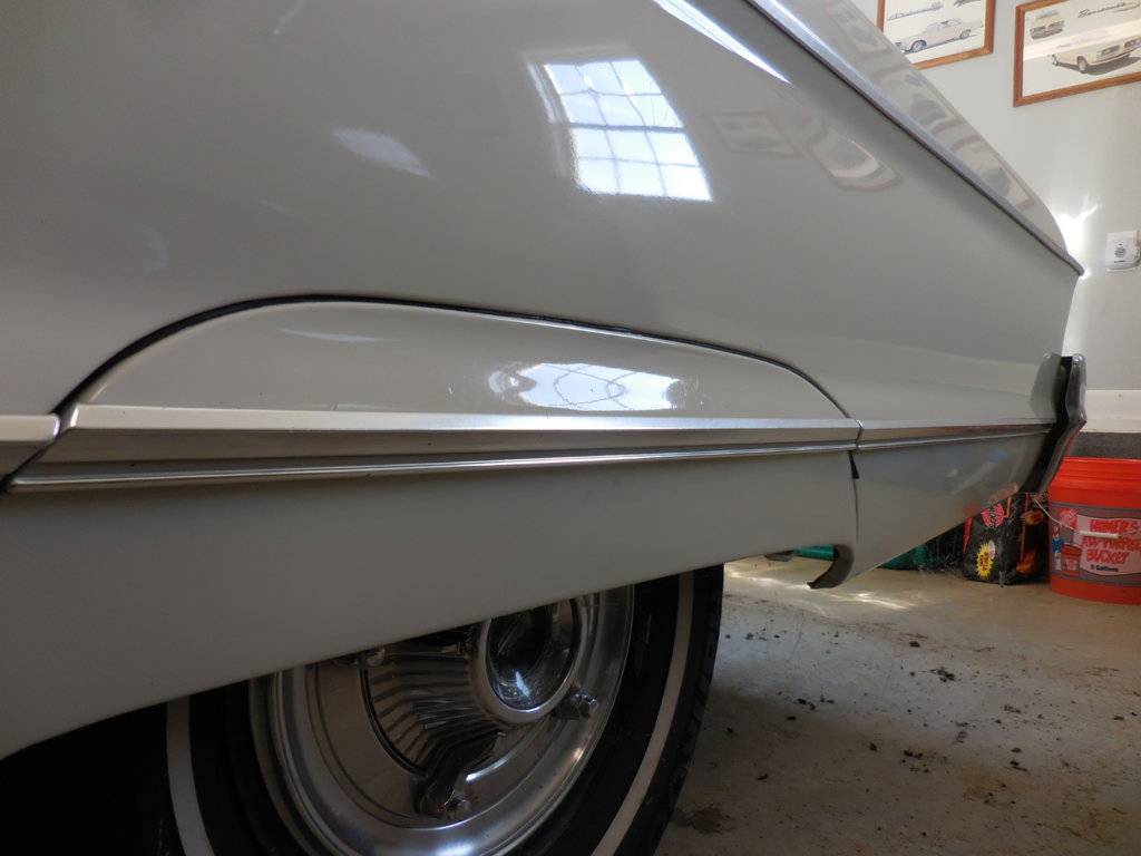

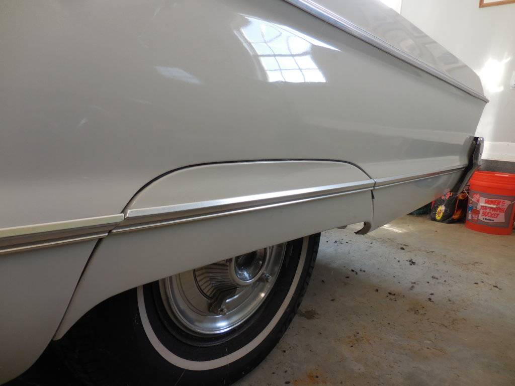

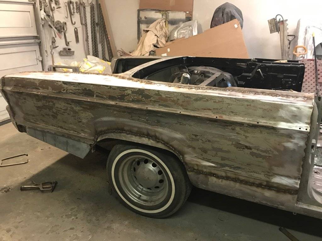

Looks great. But, should those quarters behind the wheel wells tuck in a bit farther? Just wondering if the fender skirts will fit right if the contour is a little off. Here's a couple pictures of mine from about the same angle.

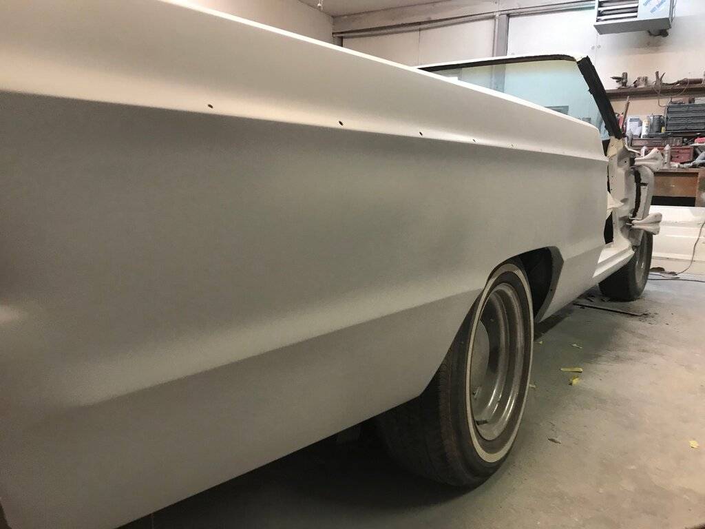

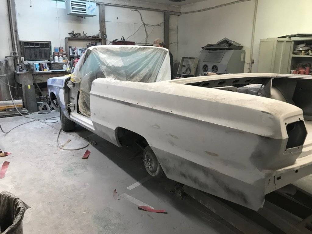

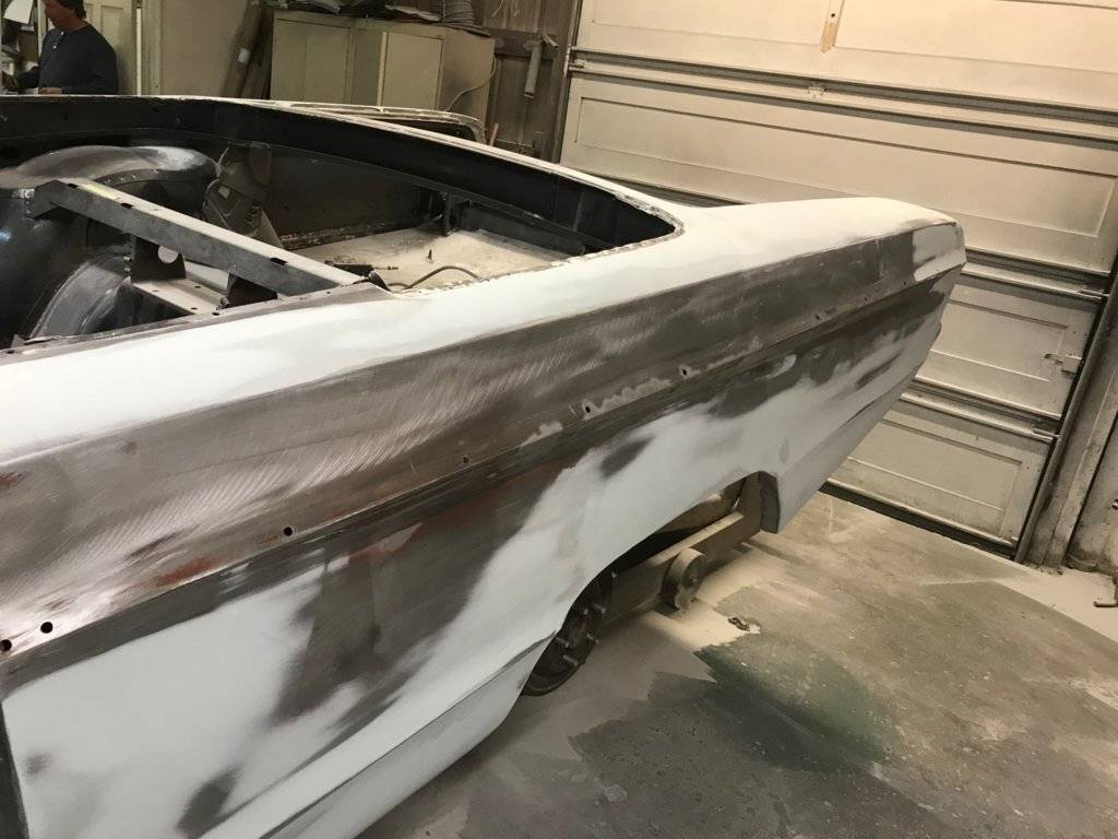

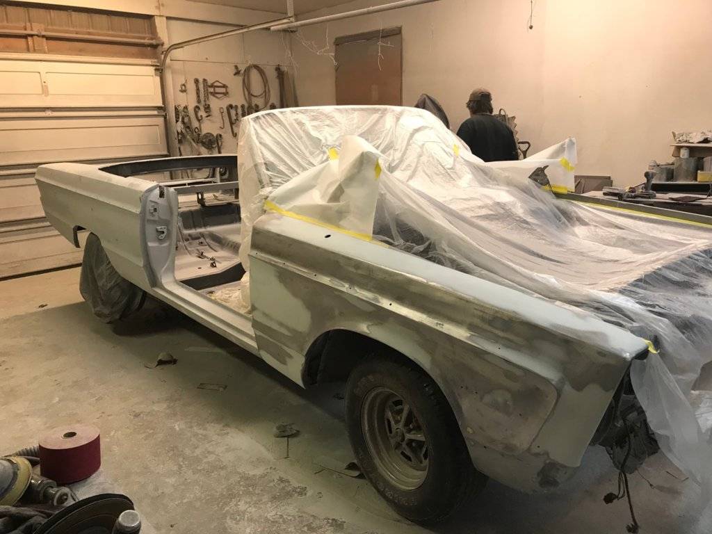

Another quick update from the body shop.
Hanging the front fenders and priming/blocking the rear quarters and trunk. The blocking reveals the low spots so a little more skim will be needed.

Things are still moving along here.

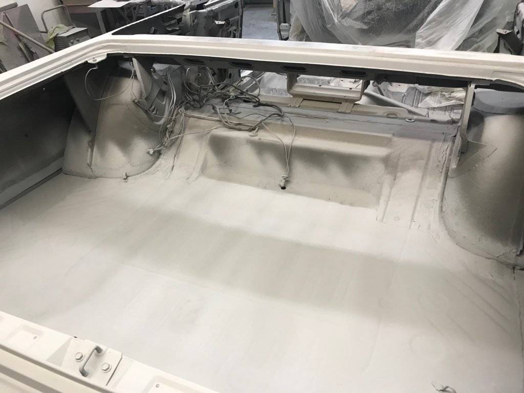

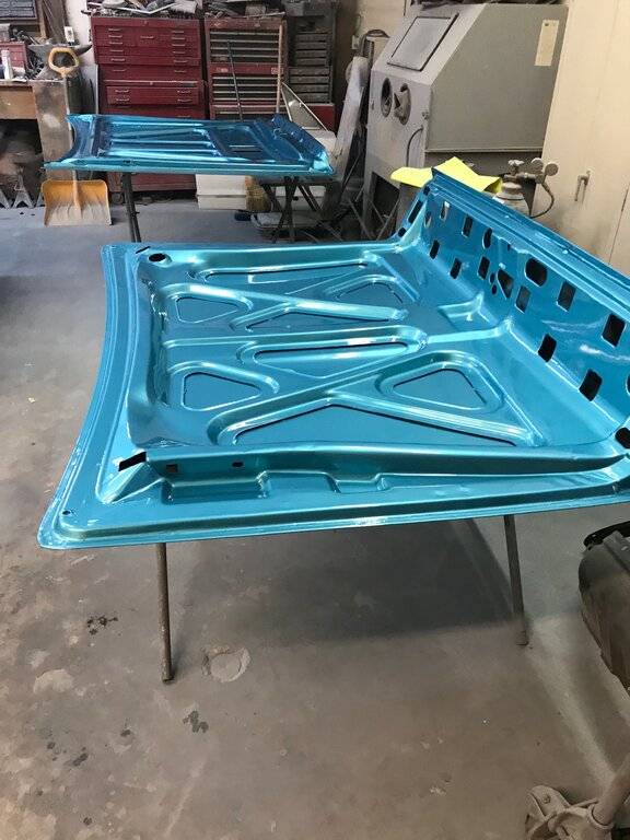

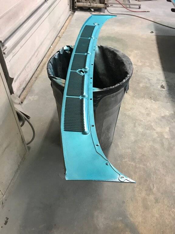

Final priming and sanding on the main body, fenders, skirts and the wiper panel. Also got the trunk caulked and ready for paint.

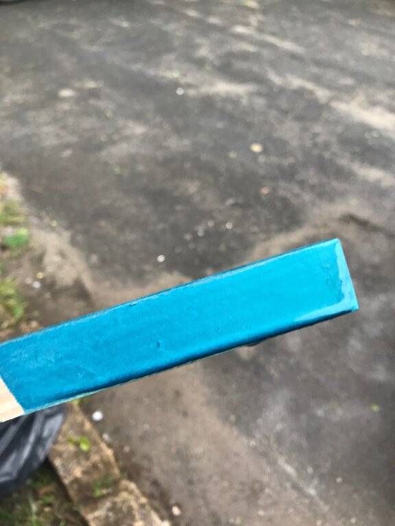

Here's a shot of one of the donor sway bar perches and we got some paint!!!!
I know, its not properly mixed and it's on a wooden stir stick but it gives us a sneak peek.....
Also we realized the trunk torsion bars from a hard top will not fit a vert so I spent some time in the pouring rain removing the set off of the vert parts car...

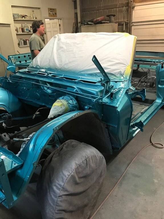

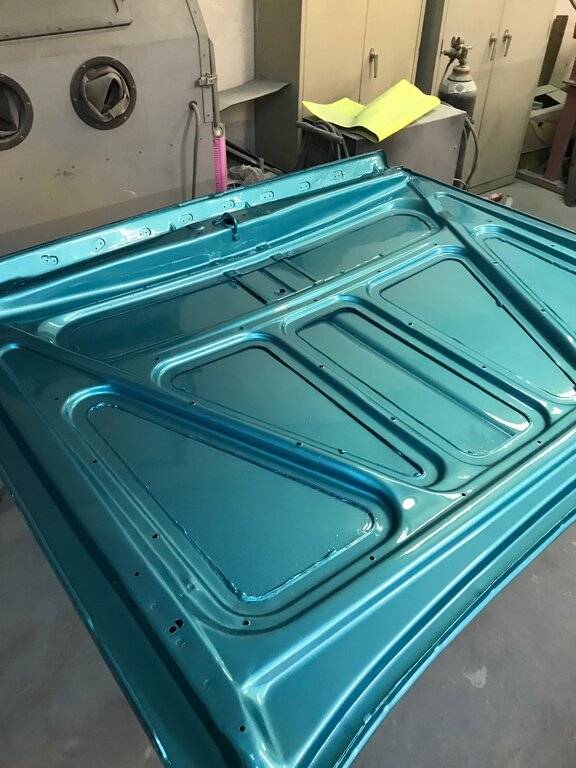

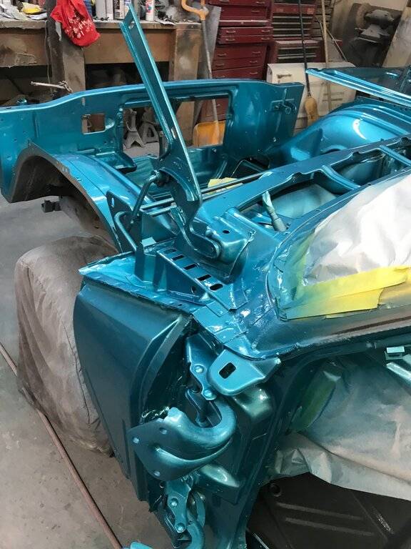

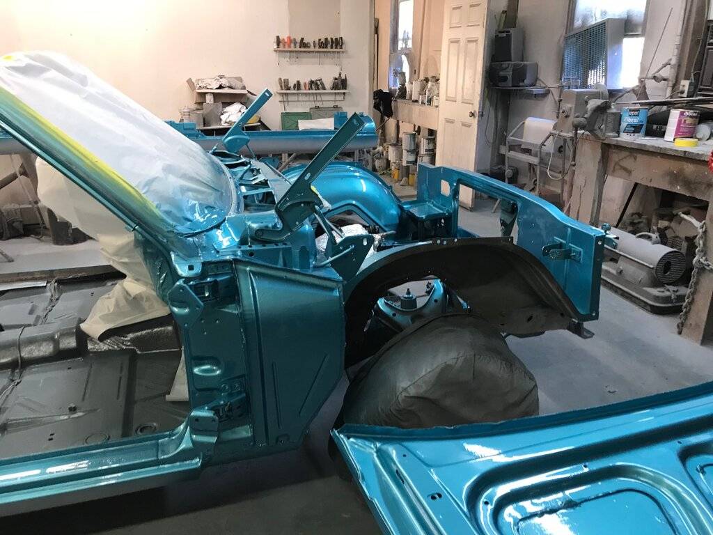

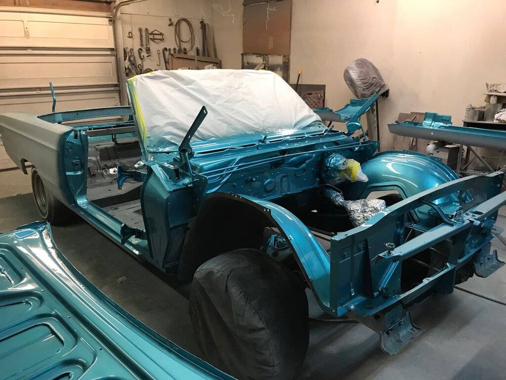

While we were here helping a friend begin the process of installing new siding on our house, John got busy at the paint shop.

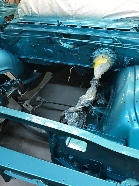

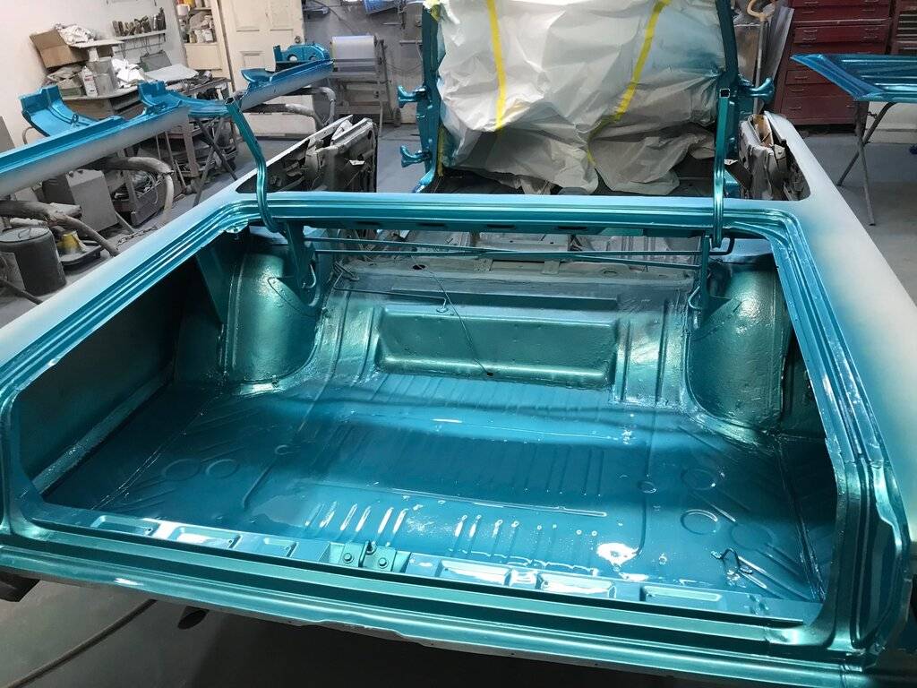

Today was cut in day- Undersides of the trunk/hood/engine bay/trunk, etc.
I've only seen this color in pictures-never in person, so there was a bit of apprehension until Steph and I rolled into the paint shop....
I'm absolutely in love with this color so I shot a few pics to share here with all the folks who've been helping us along!!!!
Opinions????
I'm absolutely in live with this color so I shot a few pics to share here with all the folks who've been helping us along!!!!
Opinions????
Beautiful! Similar to my Shamu.
