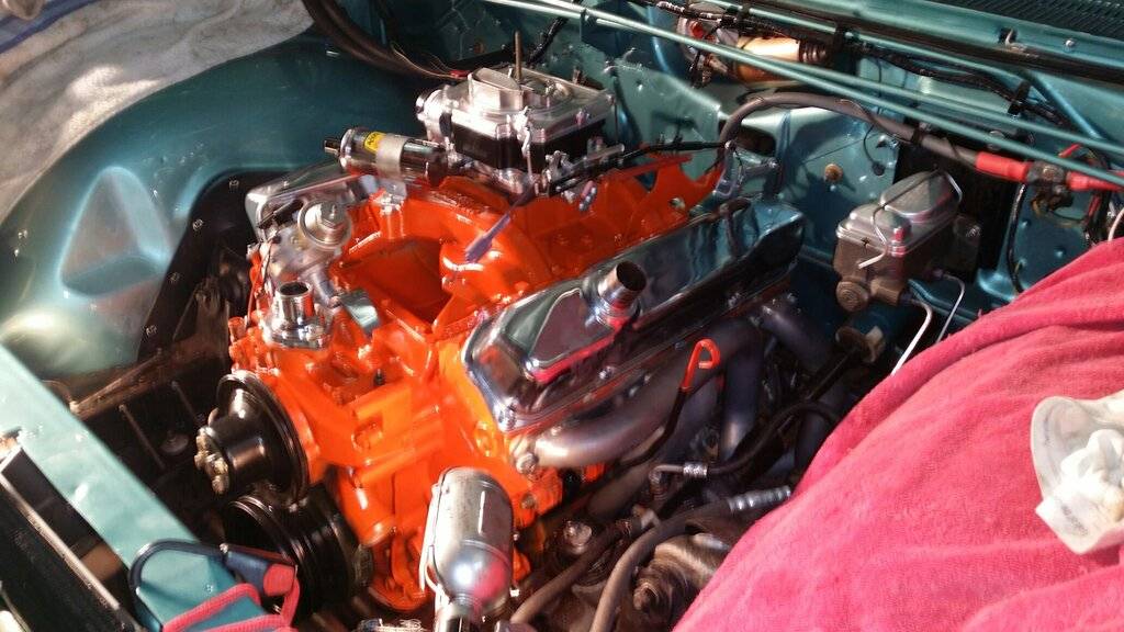

Just wanted to update you on how the engine is coming along. A lot has been done and is very close to being started for the first time AGAIN. Wiring is the next thing on the list. So far just to name a few items the top of the engine is painted again, the header gaskets and headers are on, the intake and gasket is on, the carb is on, water pump is on. All we basically need now is just the radiator, fan, wiring, and fluids as far as I know. See the pictures, they speak for the progress
