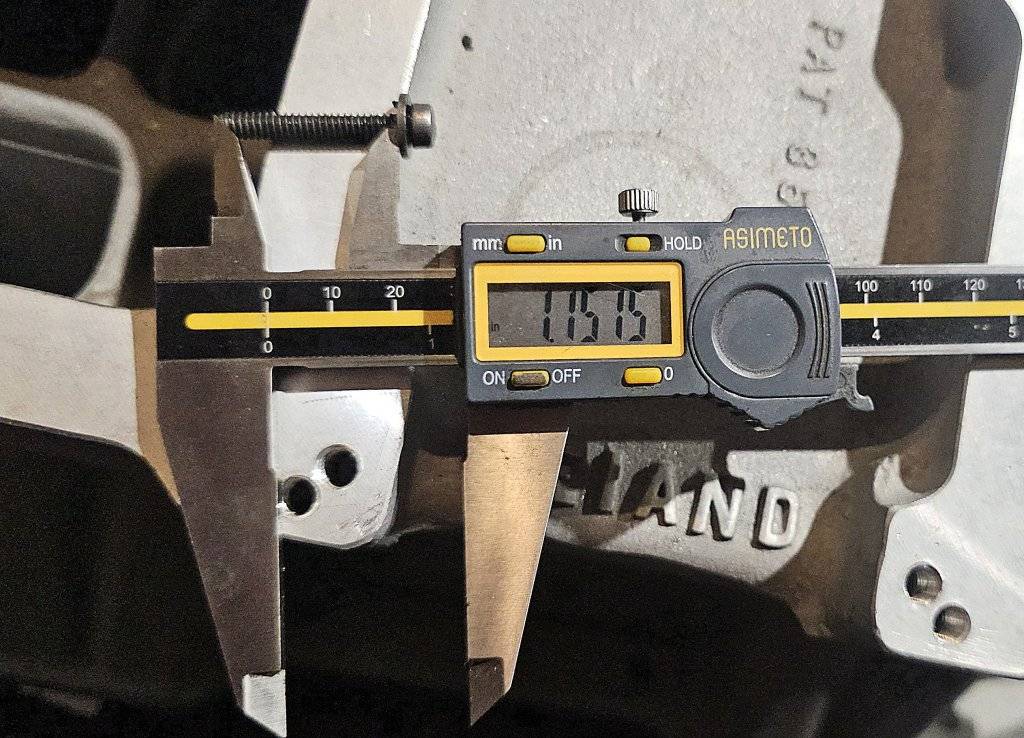

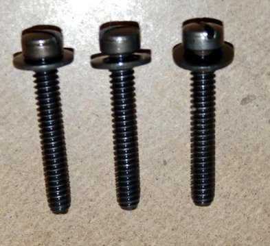

I am removing the aftermarket deep transmission pan from my 68 New Yorker and reinstalling the stock pan. The filter has a filter extension on it to set it deeper in the pan. When removing the extension for the stock pan, is there a plate, gasket or stand-off required to mount the filter in the stock location? Does the stock filter just bolt to the bottom of the valve body directly?
Thanks, you dont happen to know the bolt size/length that holds the filter to valve body do you?
I looked around a bit on the intrawebs and 10-24 does look to be correct. I can't find the correct length though. It seems to me that they are an odd length. Too long and the bolts will bottom out and not hold the filter. 1 1/8" long maybe??
You might be time and money ahead to just buy the ones on eBay.
Thanks .
I went and bought the Ebay ones. I like to have the right stuff when I can
The filter bolts / screws are 10 - 24. The length of the threaded part (from washer to end of bolt) is 1.16 inches.
